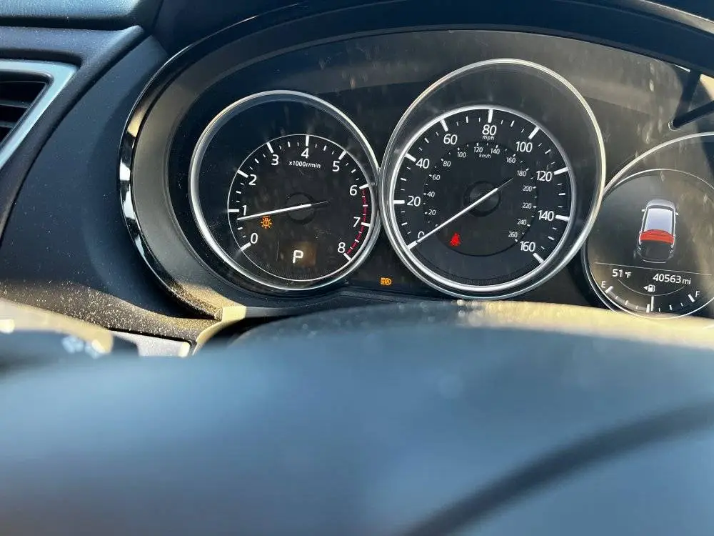

I got my CX-9 back today. I’m not thrilled. It drives mostly like I remember but there are things that don’t work now, like my heated steering wheel and the adaptive headlights. I made an appointment to take it back but this drama stinks. If anyone knows how to reset or fix these lights, I’d love a link or a DM so I can do it myself instead of waiting until 12/13 (next available time I could make). They reset them before I left but they came back after to stopped and turned the car off. 😩

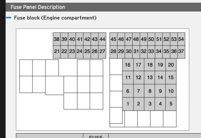

Sorry to hear that @s0n1c. If you haven't checked the fuses yet, there is a specific fuse in the engine bay fuse box for the steering wheel heater. It is Fuse #47 in the diagram below.

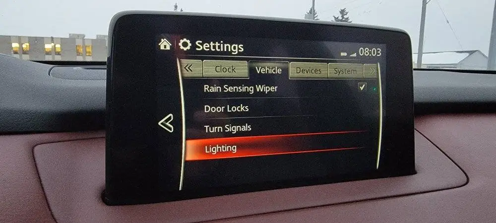

Regarding the adaptive front lighting system, I created a Resource which can be found here:
I have a 2018 as well, so I went out to my car to see exactly where you'd need to go to reset the adaptive headlights. From the Home Menu, go to Settings on the right, then switch to the Vehicle tab and select Lighting.
From here you can disable/enable adaptive lighting.

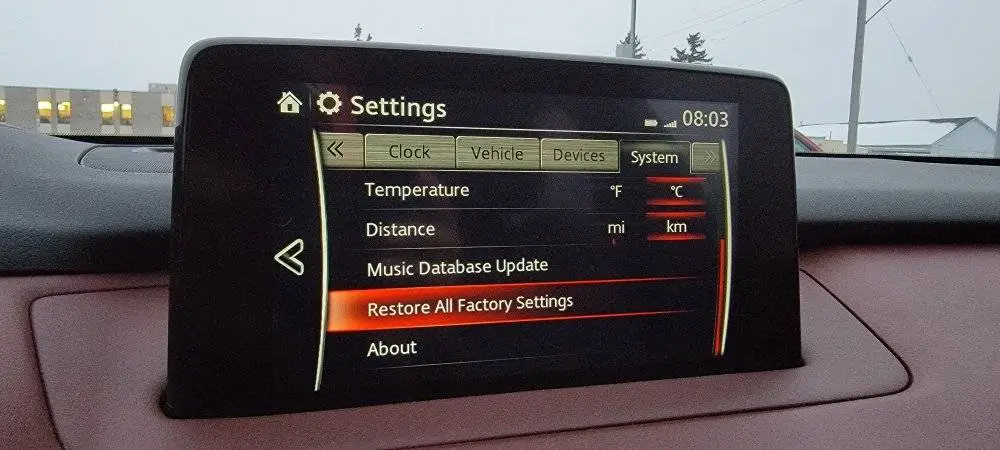

Failing that, you can try a factory reset.
If that doesn't work, I think you'd need to go back to the dealer, unfortunately. Hope this helps, though.

Thanks for the tips. I tried all of these already hoping I’d get them to go out (and my lights to pivot again), but no luck. I’ve got an appointment but it’s two weeks away. I was just hoping I could solve it myself in just a few minutes because it looks like things work, right up until they don’t 🤣
I also want to state that aside from the little things that seem out of place, my car drives and runs WAAAAAAAAY better. The idle is so calm and quiet and even with the ac on I don’t feel vibrations when sitting at a stop light. My big concern is I’m taking a 2000 mile trip starting tomorrow and the little details make me worried they missed something and I’ll end up stranded on the side of the road.
