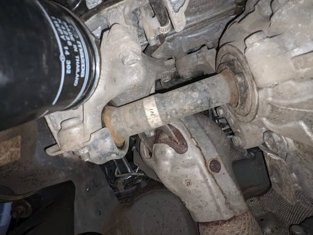

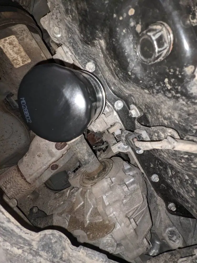

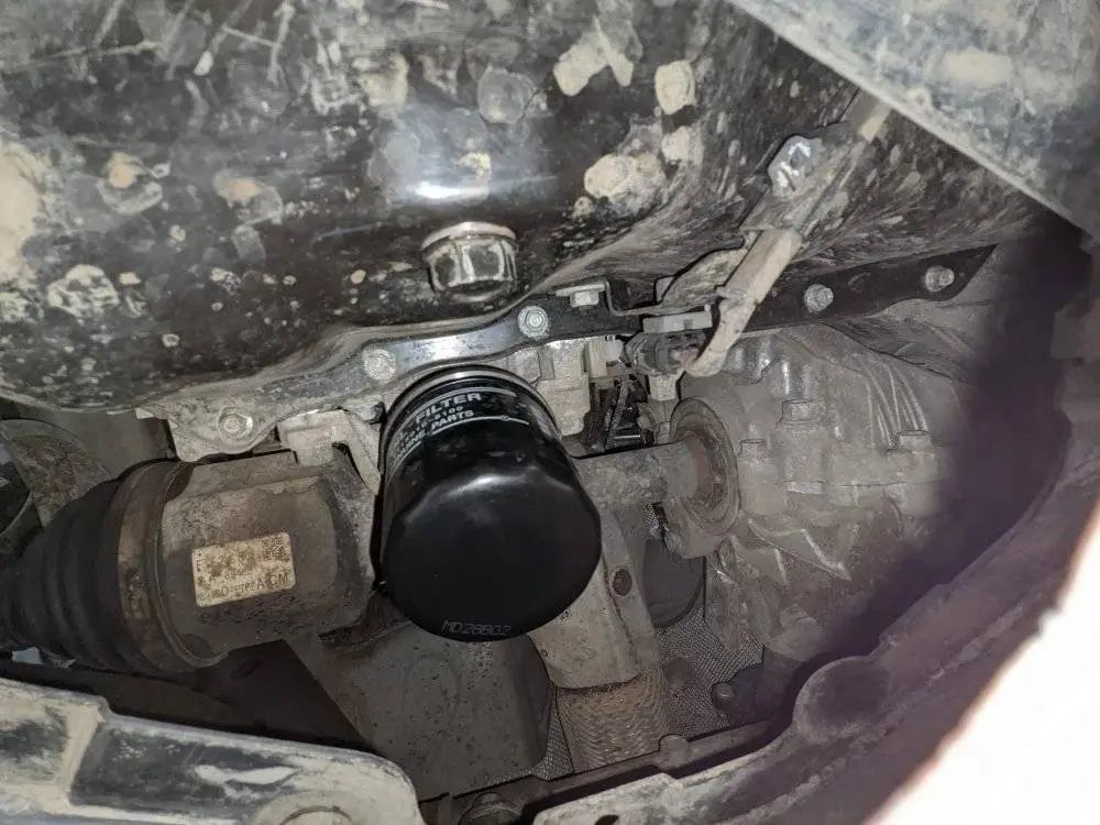

Just did my oil change couple days ago but wasn't sure where exactly to look for possible leak. I didn't find any signs of coolant residue from the access panel. Maybe someone can help me with extra eye.
From pictures your 2.5T seems to be fine. But you can check the coolant level more often that should be good enough to catch the early sign of coolant leak at this time.
Thanks, my coolant do disappear since the car was new. I usually top off to the full mark when oil change/car wash and usually it would be down to the middle between full and low by 5000 miles. I raised the issue with dealership before but they were no help.
