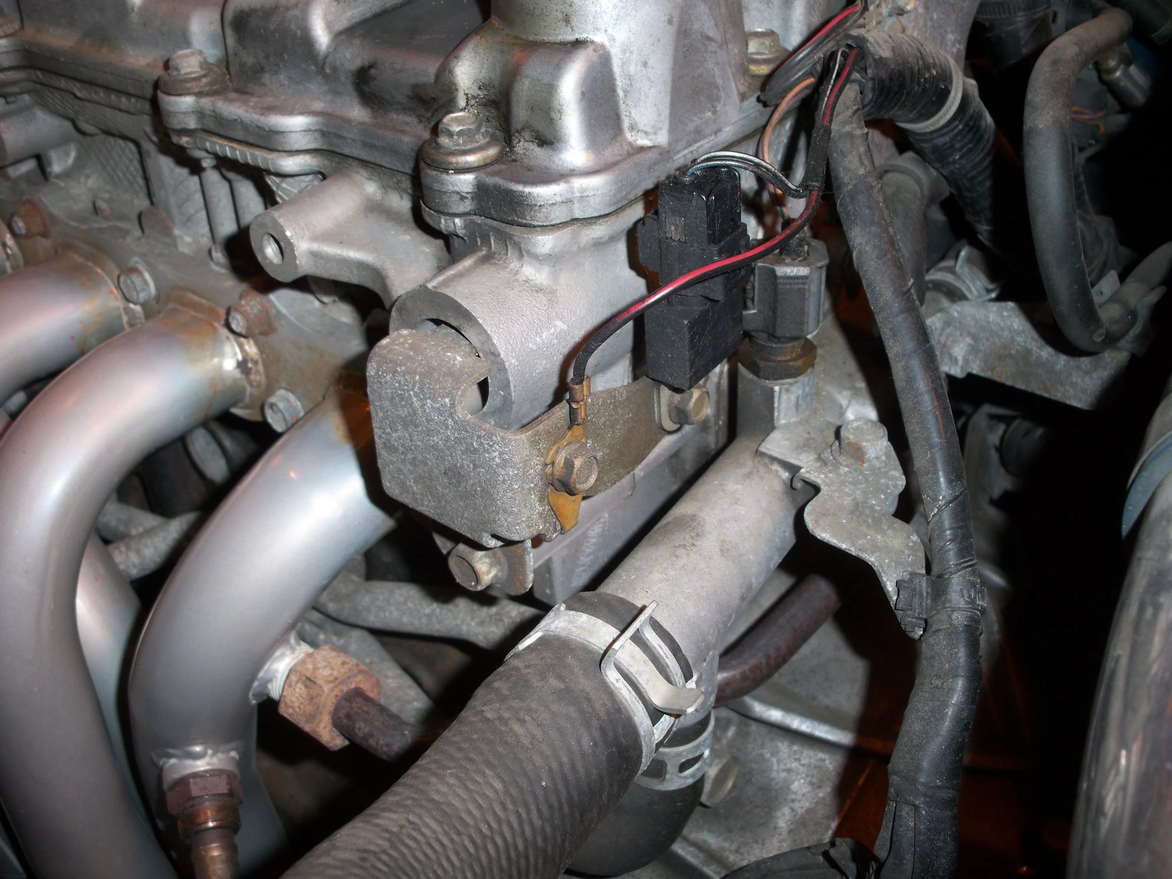

So for those who have done this, what do you do with the sensor attached to the bracket that is in the way of the new mounting location for new coil packs? What is that sensor?
That's just a capacitor for the ignition coils to ground. You don't even need it.

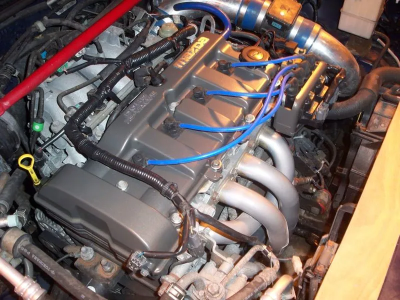

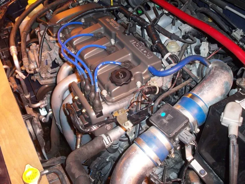

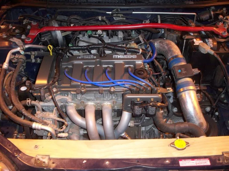

Just finished up. There's 5" of snow on the ground, and I only have 4" or so of clearance so I couldn't really do much in the way of testing. I did go for a test drive and have a couple observations. Whether they are placebos or not is debatable, as well discussed in this thread...
  1. I noticed immediately on startup that the car started quicker and smoother
  2. The car definitely seems to run smoother
  3. The car seems to rev way faster. Noticably faster... Odd, but very noticable!
  4. Felt very nice to drive. Felt like the car is finally awake from a long snooze...
Hello P5- welcome back!!!
