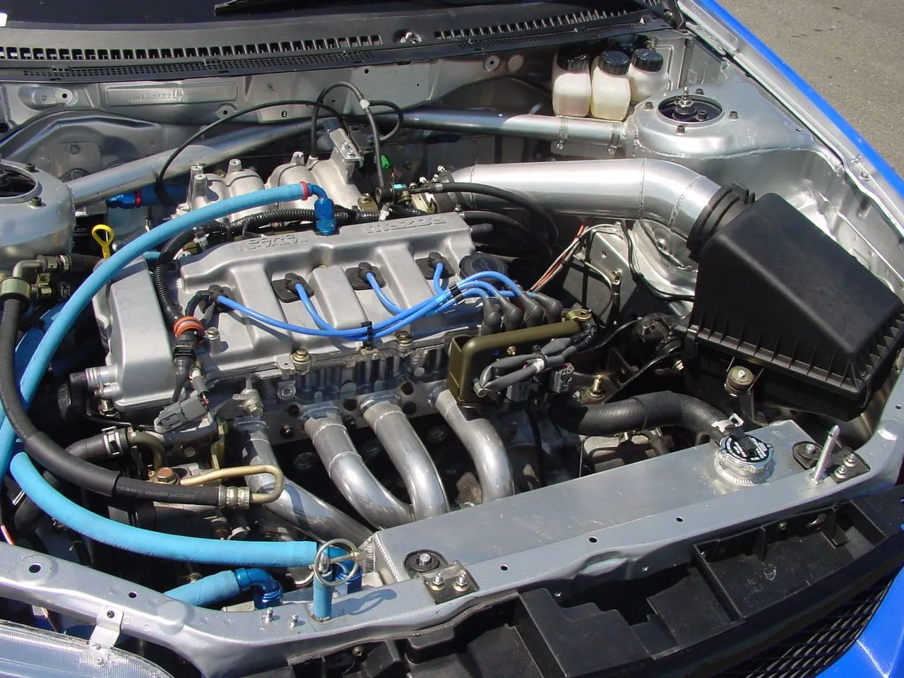

i changed mine out for two reasons: (1) because i needed a new coil pack anyway, and, at the time, the 1.8 set-up was about half the cost. now, the 1.8 coils cost twice as much as the 2.0 coils. i would have to think twice about it now. (2) mazda was running the 1.8 set-up on the world challenge protege race cars. if the set-up was good enough for them, it certainly should have been good enough for my car.
check out that engine bay (crazy)
attachment.php

Maxx Mazda has them on his built motor running 20PSI, bit of DEI reflective tape on the bracket and the coils helps and his are mounted very close to the manifold/turbo.
http://img846.imageshack.us/img846/3130/dsc06343r.jpg
The reflective tape helps, but I also clearanced the bracket to gain an extra half inch of clearance. The coils themselves are well isolated from the heat. Don't forget that the coils run hot anyways, and while I'm sure having them sit above the manifold is less than ideal, to date I've had no issues with them overheating.
And for the record, I've taken those coils to 32psi on 100 leaded and methanol ;)
