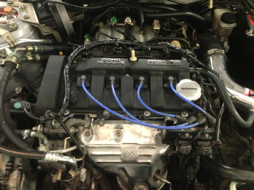

I know this is a little late but anyone still looking for a coil conversion check nology hot wires. they a coil conversion kit for the 2002-03 MP%
sorry, but the nology setup is NOT a coil conversion. its just a crappy set of ignition wires and a bracket for the stock coils to be relocated.

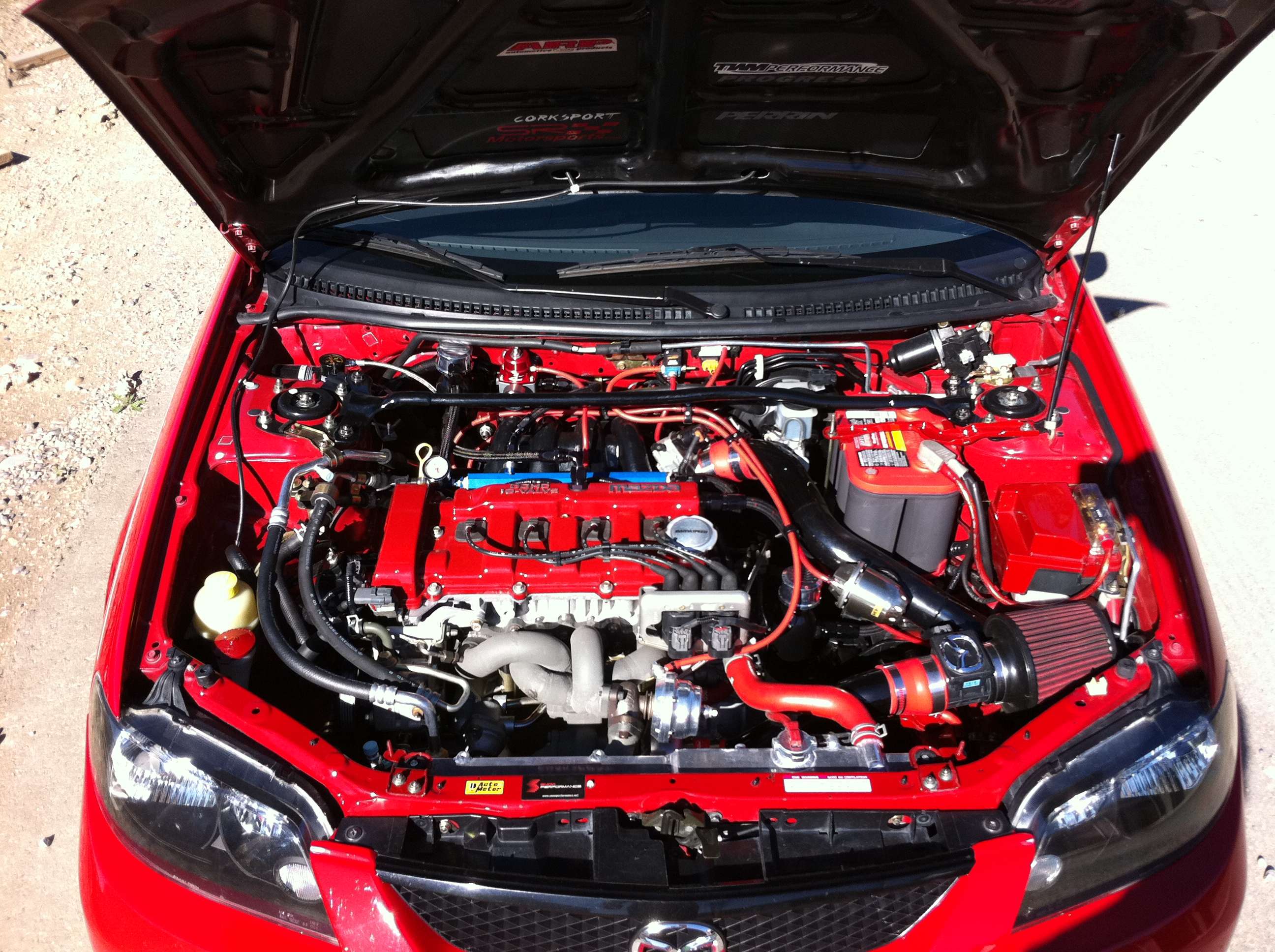

There are 3-4 1.8L coil pack and VC setups in the JY near my house right now but I couldn't bring myself to buy them because I am afraid the turbo will just cook the coils the way they are mounted
Maxx Mazda has them on his built motor running 20PSI, bit of DEI reflective tape on the bracket and the coils helps and his are mounted very close to the manifold/turbo.
http://img846.imageshack.us/img846/3130/dsc06343r.jpg
I know underhood temps willl be similar but it hits well over 100 degrees here for 3-4 months out of the year and my car is driven daily no matter what. I would hate to go through all the trouble and not even notice a difference
