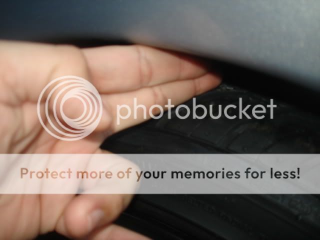

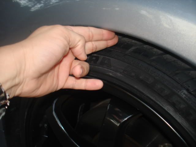

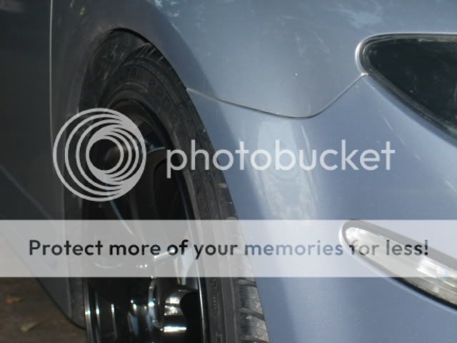

@ alca0811 - you don't have the fenders rolled? my rims are good right now with slight rubbing in the rear (only once) but they're also wider than yours...i plan to do the roll when the springs get here and although the h&rs give a 1.5ish drop i think i need the teins with a 2ish drop...my clearance is pretty bad as the first pic shows...and i think 1.5ish isn't enough.

Initially the H&R's gave me a 1.7" drop, but once settled, it was more like a 2" drop all the way around. And, no, I don't have my fenders rolled; but my 522's are only 18x8.5"
holy crap, your rear fenders are NOT rolled and you running 8.5"??? unless you are running super sunk offset, that is unheard of not to rub.
rear fender lips stick into the fender nearly 1 full inch! lol.

Remember, again, mine are only 18x8.5 so I can do that. With your 9.5 inch rim, you probably will need a fender roll and adjustable ball joints.
aha that explains it, +48 isnt all too aggressive, and from the pics looks like you have a slight tire stretch = easy tire tuck when hitting corners or rough road. clears the air. :D
uh yay dterranova, we said it many times already... you are guaranteed to need fender roll, and most likely camber adjustment. lol
