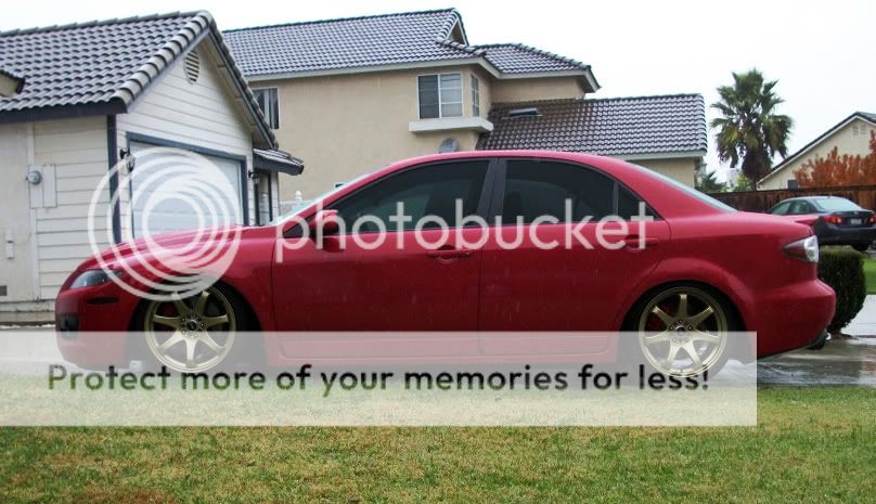

18x9.5 +25 offset on a lowered speed6? problems?
And what wheel setup are you running? Just wondering lol.
Last i saw, your running the stock wheels with a drop. Thats hardly aggressive enough to be pushing the limits of what is possible.

You are right, and wrong. I have stock wheels on 15mm spacers, lowered 1.0-1.2 inches. Not low enough to rub fender, but was enough offset for stock fender lip to carve some pretty tire ribbons. Rolled, slight pull, 100% fixed issues. Since i bent another damn wheel, i have been trying to research/follow MS6 fitment projects more as i will be getting coils soon with wider wheels and aggressive offset... i need to find the happy balance as i still track.

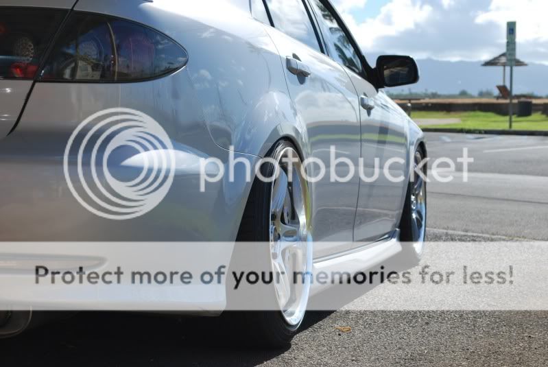

So that's what they look like on the car. When you were pm'ing me, I see now how you didn't have any problems test-fitting the 9.5/+25 wheels. It's been a while since I've been stock height so I didn't know you'd have that much room. Now all you need to do is buy some coilovers. Like I said, your rears would be almost identical to mine. Here's some incentive (just ignore the sunk fronts).
nver seen your ride GSM6, more pics!! got the fronts more flushy now?

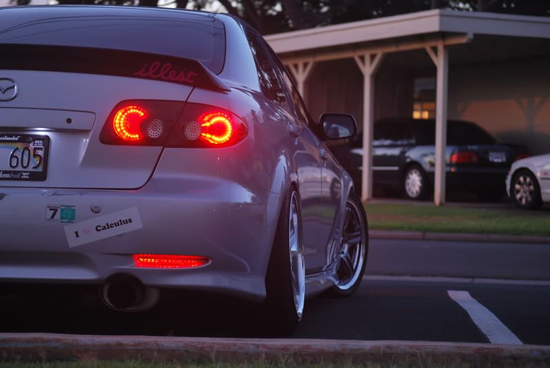

Oh yeah, for those that haven't seen my car before, those are 18x10 +44 in the rear with a 235/40/18 Volk GT-C's. Fronts are 18x8 +43 (+28 when I put spacers) and have a wide 225/40/18.

@gsm6 - your car looks great bradda...one of the best i've seen...real original s***!

Well a couple clicks here and there and imagine it looks like this in the future:
Rim choice looks fine to me.
/EndThreadJackPlusPhotoChopPlusBorednessAtNight
