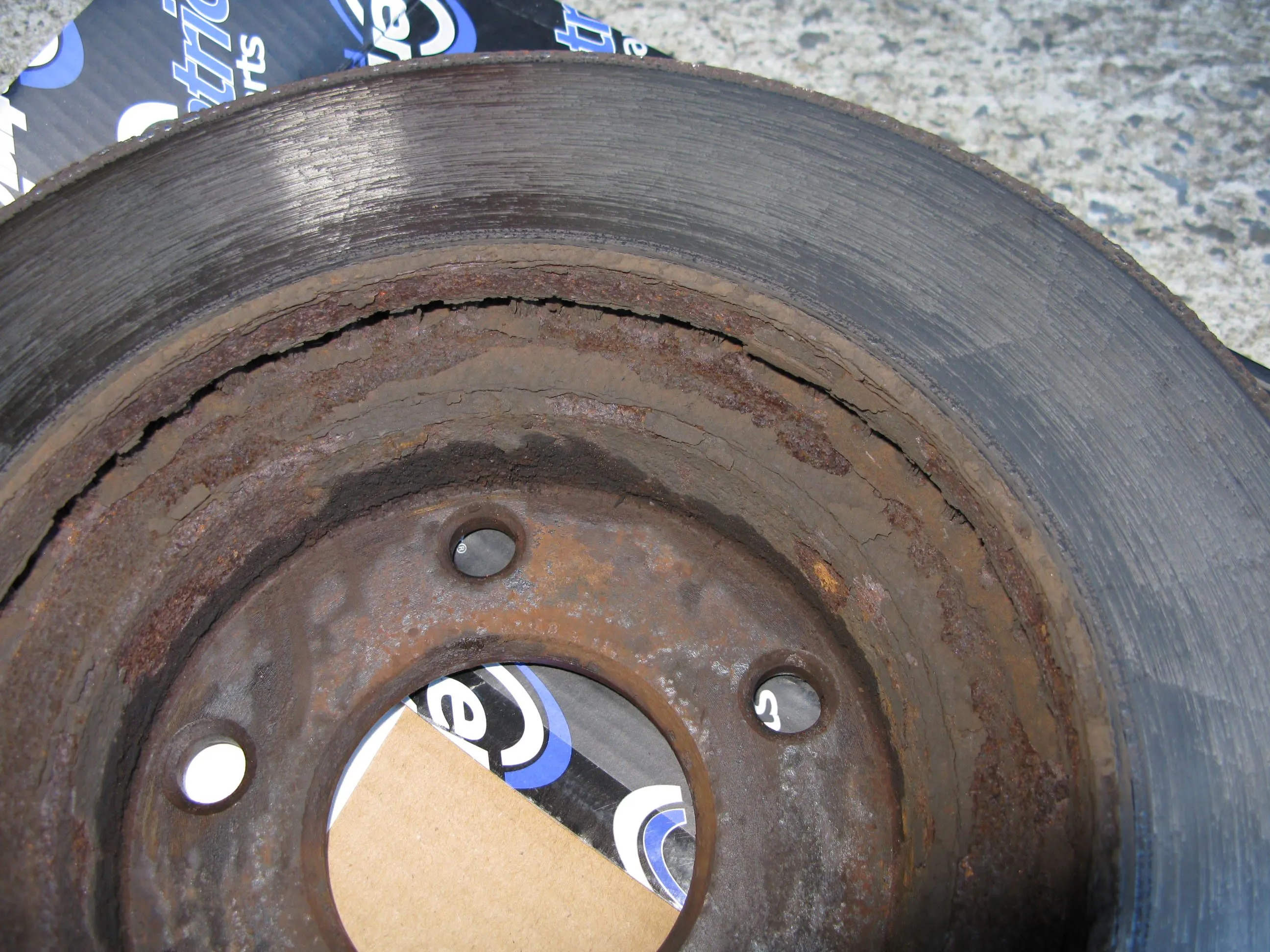

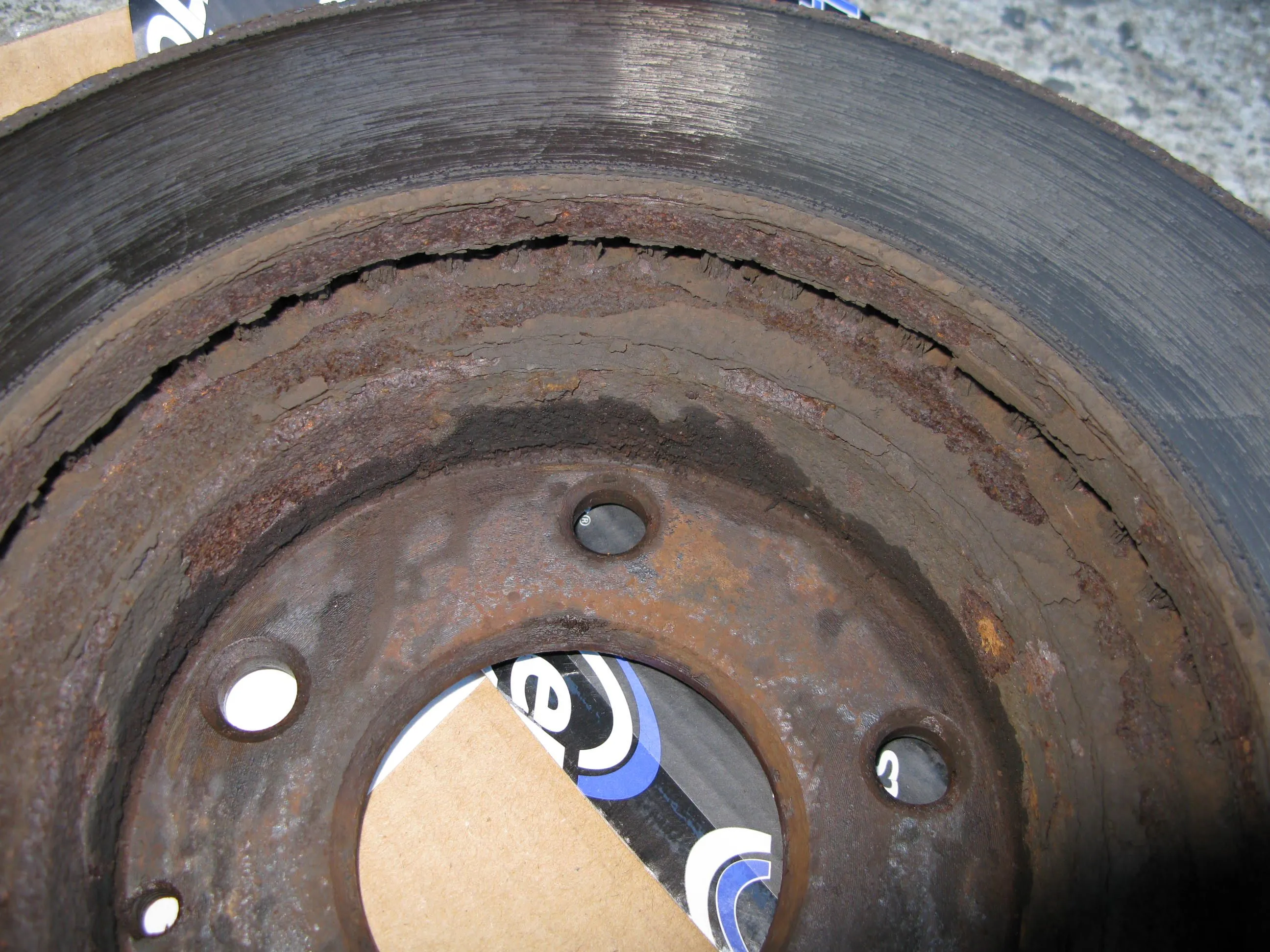

I don't know what your roads are like down there in the winter, but up here they're subjuct to a lot of salt and brime (really bad stuff for a car as far as corrosion goes). Here are my rotors after my first pad change at 60k miles off of my 2014 CX5....I would not use something like these for a second set of pads..cooling vents are virtually clogged with rust and corrosion.
attachment.php
attachment.php

What crack are you seeing?
Looks like a crack going around.Maybe it's just a shadow due to the angle of the light.Sure looked like a big crack to me.
Those are the air vents. I said they were all corroded and rusting shut.
NOW I get it! The pictures show the INSIDE of the rotor.I thought that was the outside of the rotor with a crack where the "brim" meets the "tophat" (where the braking surface meets the center hub).Said somethin' about getting my eyes examined, mumble mumble mumble.LOL
