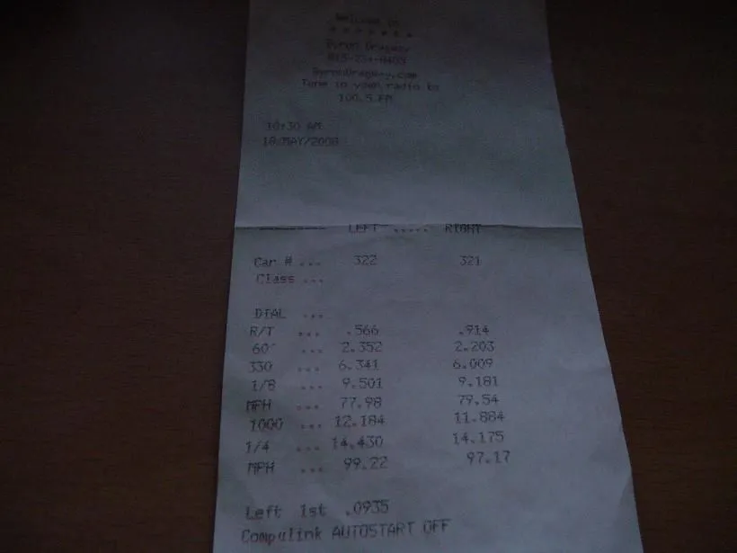

60': 2.35
1/8: 9.50
MPH: 77.98
1/4: 14.43
MPH: 99.22
mods: MM
weight: 3080 lbs (3/4 of tank of gas) + 260 lbs of me
I also hit a 100 mph on a 14.5 run later on. After reading some I should have let the car cool down more. LOL(dunno) Even with the MM I got massive wheelhop. I don't like the stock Potenzas!

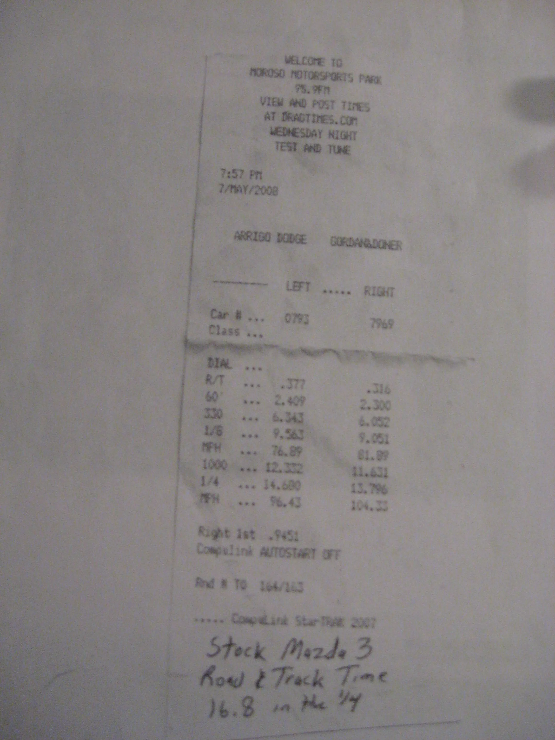

here's what i got from a n/a 3 with a little nos
Here is my slip. I am car 322. The other car was my buddy in is modded 03 Evo. Despite running a slower time....I set off the lights first. LOL
