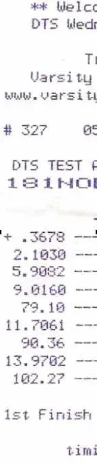

2.103, 9.016 @ 79.10, 13.970 @ 102.27 (Stock)
thank you. i was suprised how consistant i was through my traps. i think motor mount and i can run a sub 2.0 60'
Excellent 60 ft. With your ability to drive, you can really knock the ET down into the mid 13's with intake alone, probably. I have great trouble getting 2.1 60's. Mostly 2.2's even 2.3's. Care to share how you launch?
