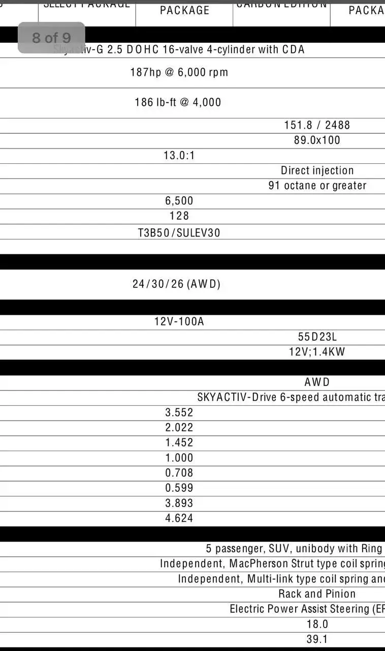

YES their is a difference. I recalled before purchasing my 2016 2.0L CX3 I read that the European versions had 14:1 compression and the N.A. version had 13:1 compression.
That may be true for the 2.0 engine, (I wouldn't know), but is it true for the 2.5 engine?
North America also gets different engines than other areas, hence the different requirements.
This earlier statement you made wasn't very specific to be honest.
I took it to mean that North America gets different versions of the same 2.5 Skyactiv engine than other parts of the world. That implies that Mazda makes a different 2.5 engine for North America than say, Australia, Japan or the UK. Somehow I doubt Mazda would go to all that trouble.
