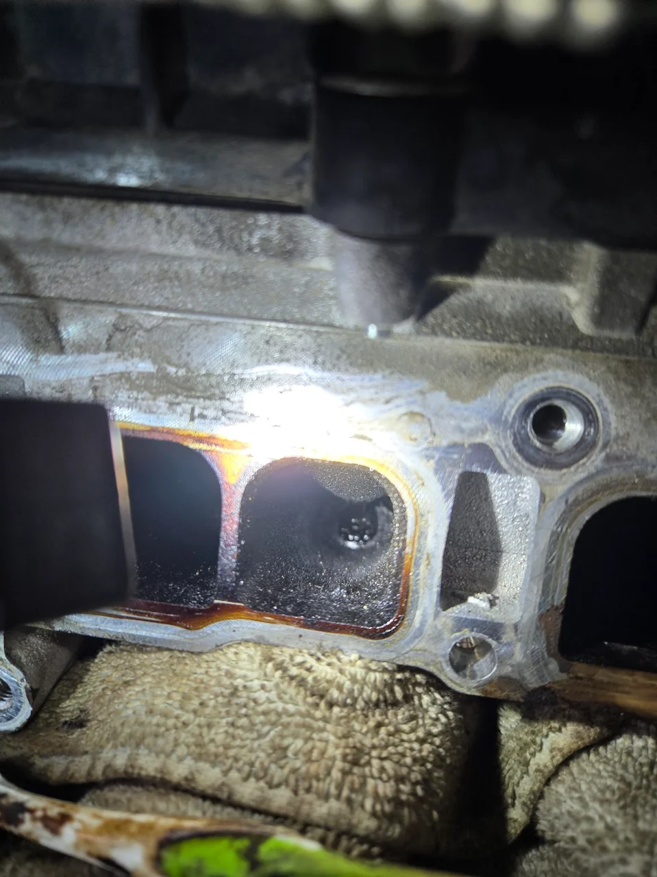

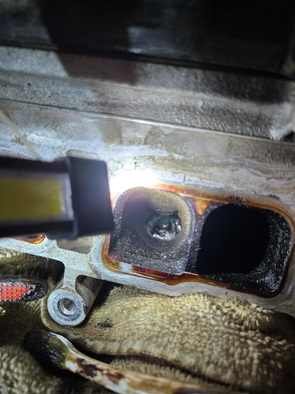

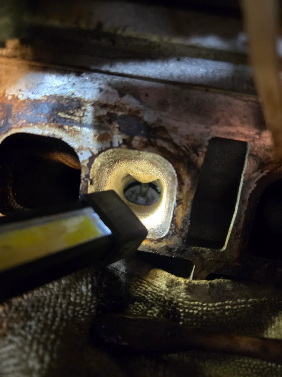

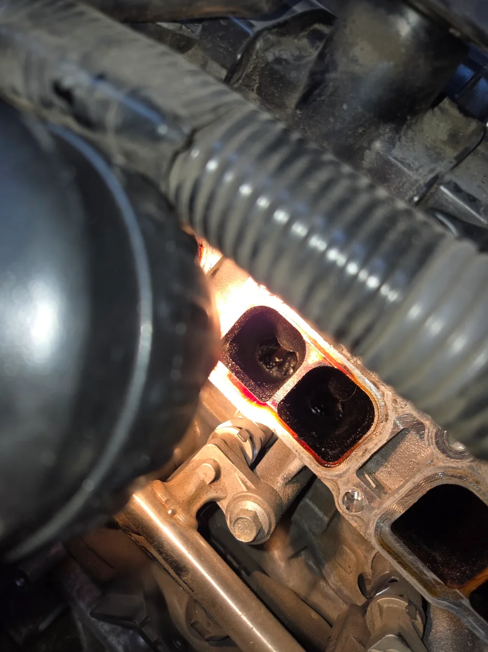

My friend helped me clean the valves and throttle body Friday evening. It was surprisingly simple to get the intake manifold off and get to the valves.
The valves were definitely dirty though I'd say the carbon buildup was more gunky than the hard carbon deposits you usually hear about but either way, they were pretty dirty. There was also a LOT of oily liquid and residue all over the inside of the intake manifold so much so that it was dripping out when we turned it over. It was much more liquid than oil but the same colour and smell.
We also cleaned the throttle body, MAP, and MAF sensors while we were at it and also replaced the PCV valve.
I took a few pictures which I will post for your interest. I couldn't get a good angle and I don't like holding my phone with dirty hands so just took a few.

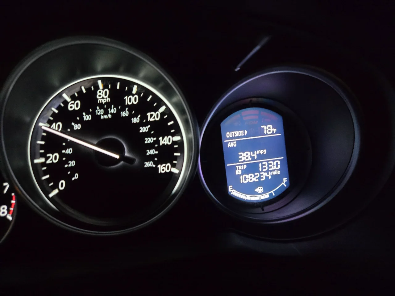

I reset the averages before heading home and I hit 38.7 MPG on the way back. Granted, it was almost perfect driving conditions for getting good mileage; 40 to 45 MPH, no traffic at all so no slowdowns or stopping at all for almost 10 miles. I reset the averages again so I can see what I get around town now. The engine also seems a little quieter and like it has a little more power.
One odd thing I noticed is that the MPG on the dashboard and the trip MPG on the infotainment system sometimes read wildly different averages. They both reset at the same time and by the time I got home and stopped the car there was a 2.5 MPG difference if I remember correctly. I'm going to assume the one on the instrument pannel is closer to correct.
