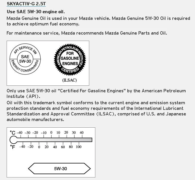

^ Exactly this. The manual specifies 5W-30 oil for the 2.5 turbo. They messed up and put in oil for the non-turbo engine instead. Contact service manager and GM asap to rectify the issue, and if you get any sort of pushback, go straight to Mazda Corporate. You can cite the Owner's Manual here:

@Eric, another thing to note about the filter is the fact that the non-turbo filter is not the same as the 2.5 turbo filter. They have separate part numbers. If the dealer put in the wrong oil, they may have also used the wrong filter. Another reason to push for an oil and filter change.
The filter part number should be listed on the invoice you received. Correct P/N for the 2.5 turbo OEM oil filter is 1WPY-14-302 (which supersedes the now discontinued PY8W-14-302).
