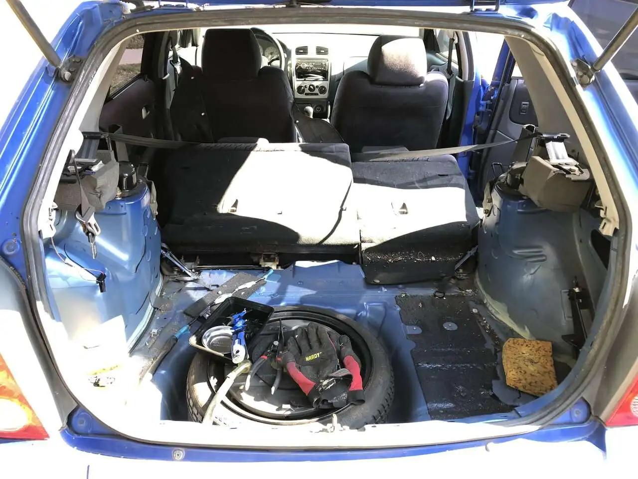

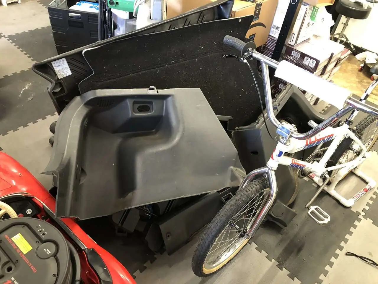

I started the suspension upgrade today beginning with gutting the rear interior panels.

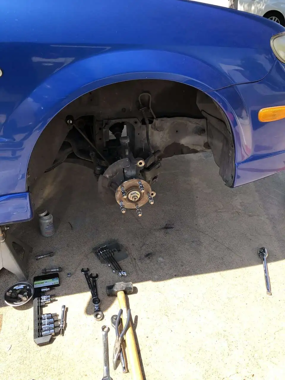

Got into the front end first, replaced the LCA on the driver side.
I pulled off the rotors and had them turned at the brake shop, then grabbed some new pads.

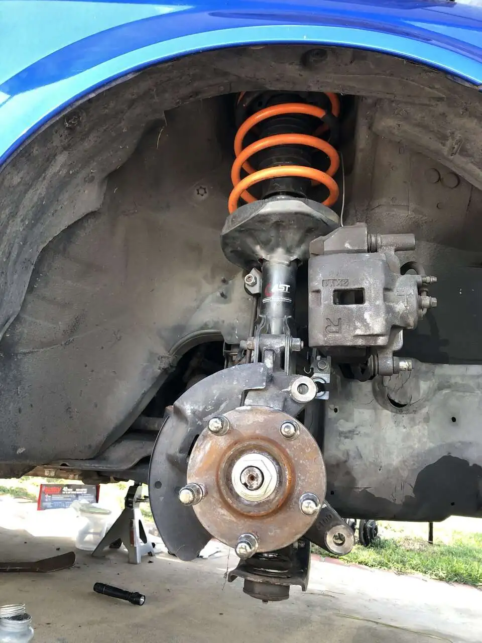

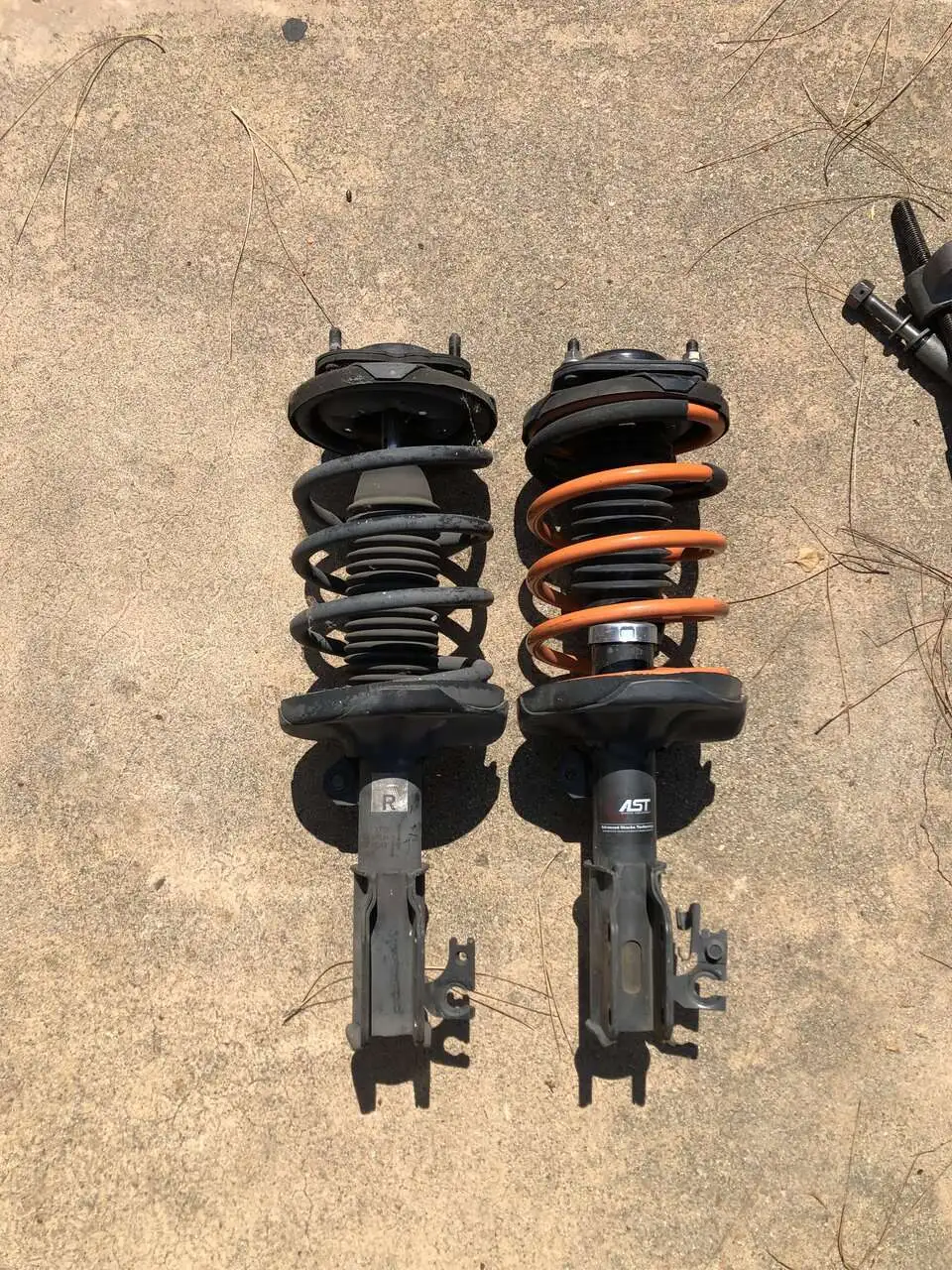

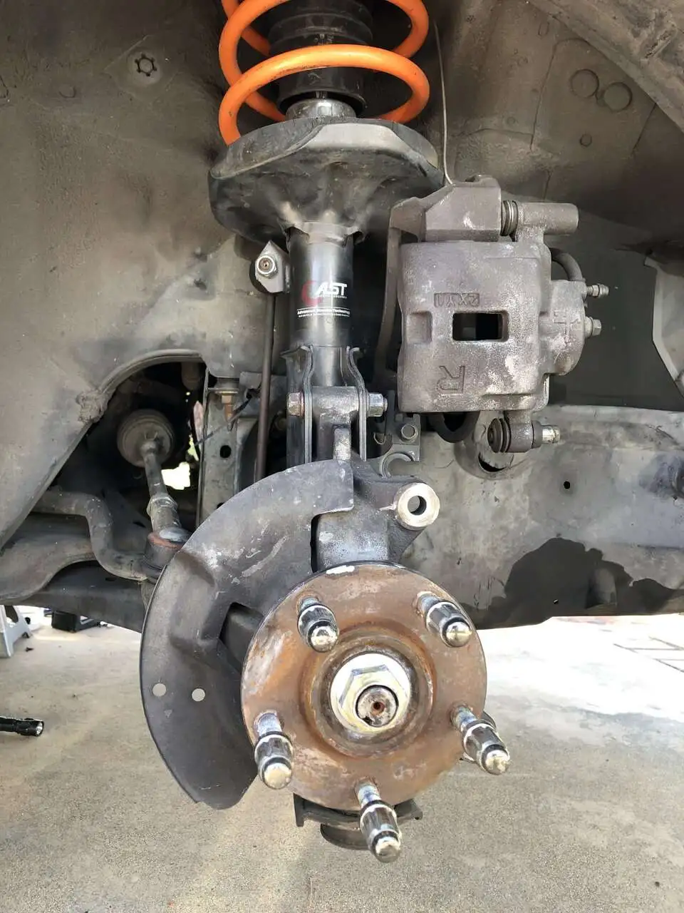

Finally got the stock front struts out and installed the AST/Megan Racing setup before I ran out of time.

Rockin’ that Hot Rod stance for now 😂

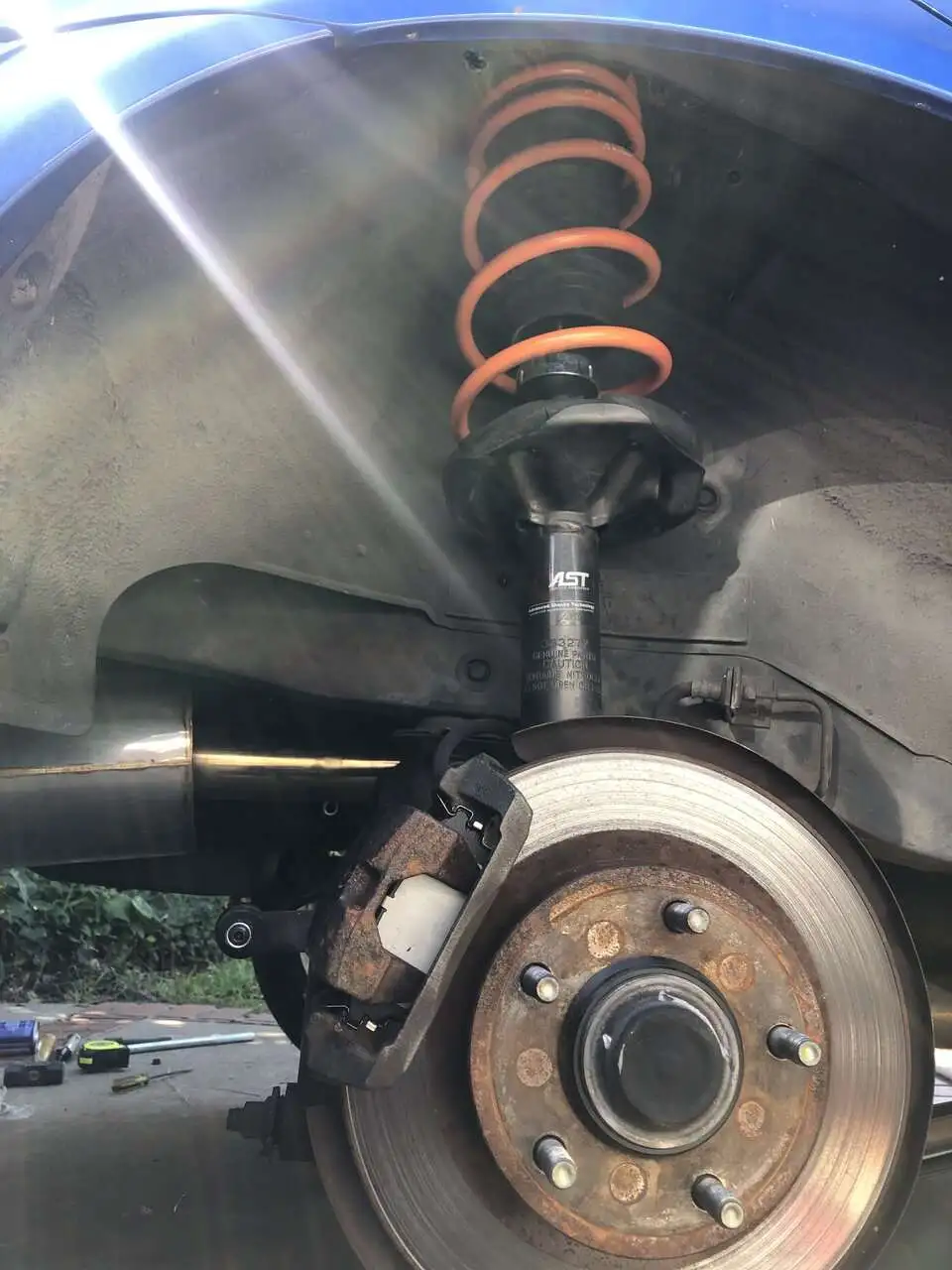

Rear struts will get changed out tomorrow, hopefully. 🤦🏼‍♂️

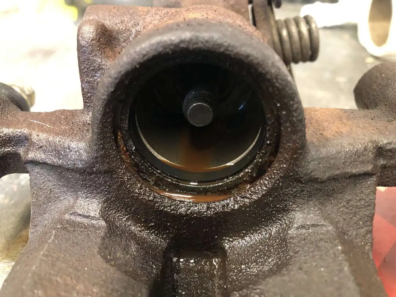

Things were going well until I tore the boot around the rear passenger side brake piston.
The new pads have a sharp clip holding the shim to the back of the pad, and the boot snagged on it as I was closing the caliper.
Oops.

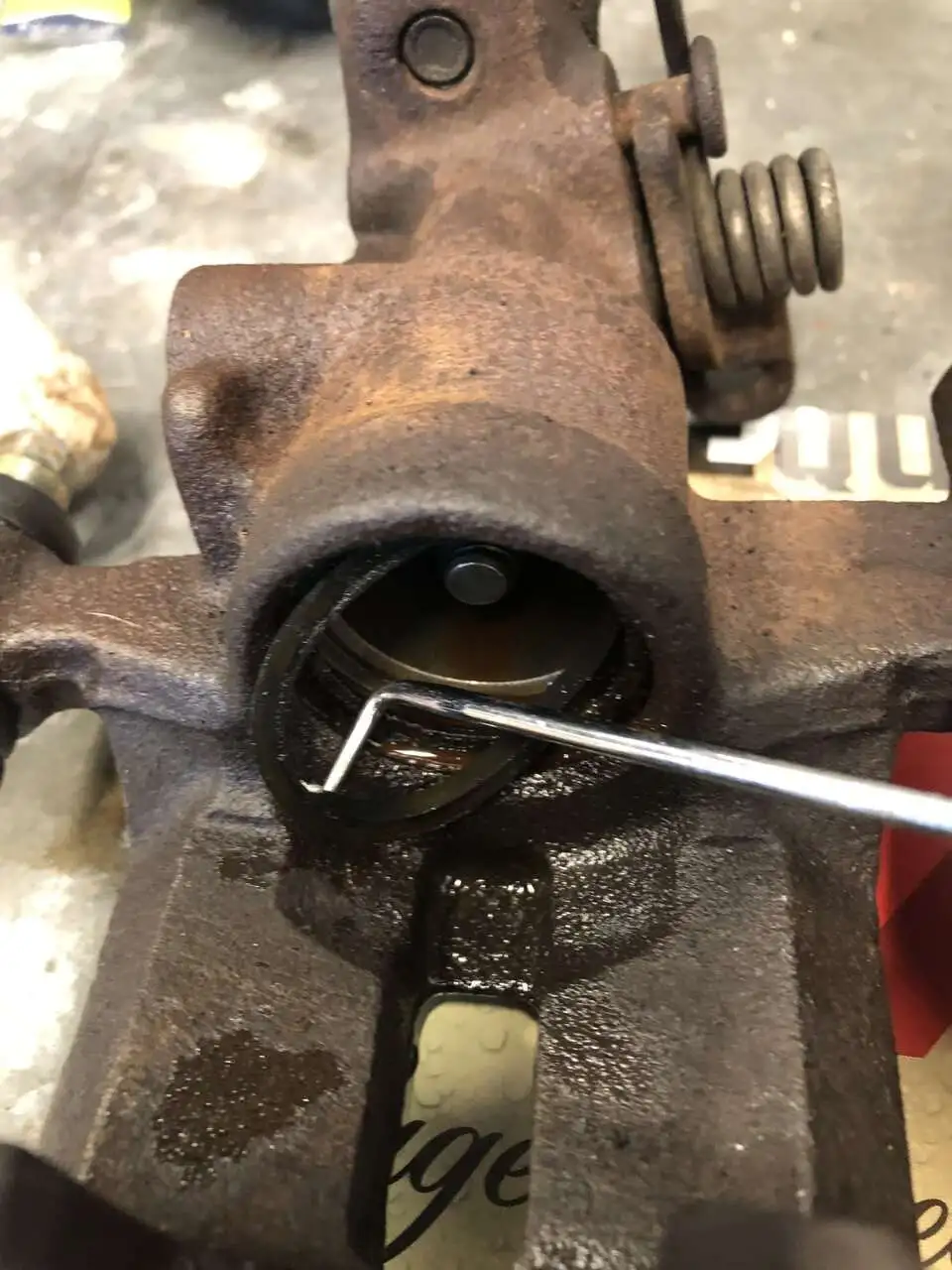

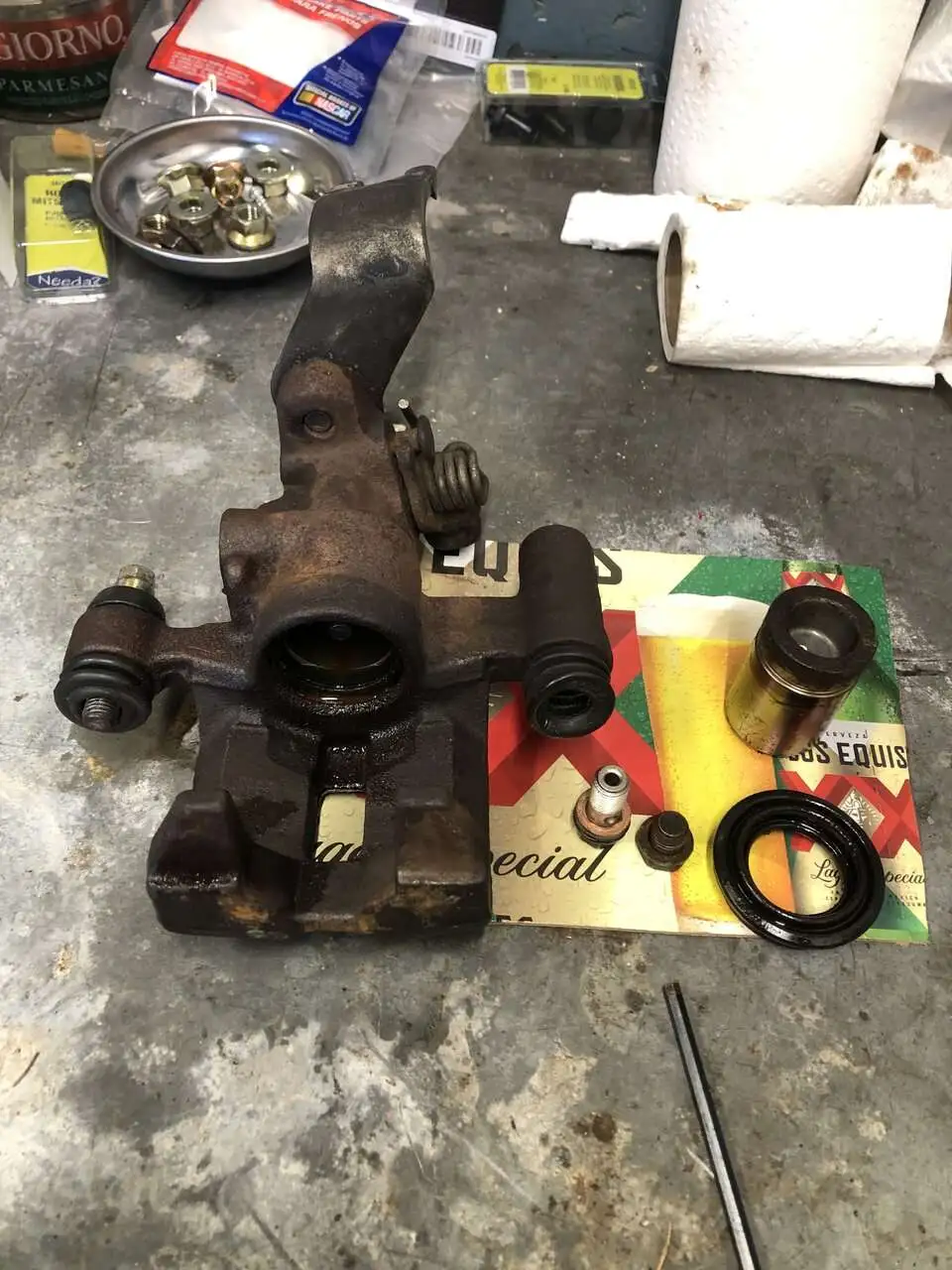

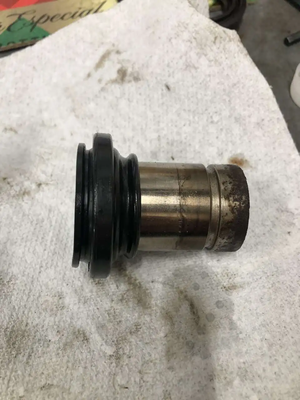

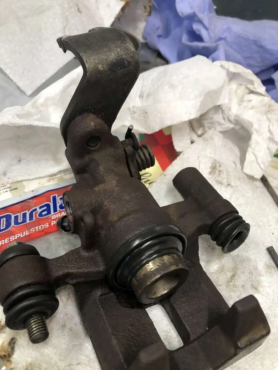

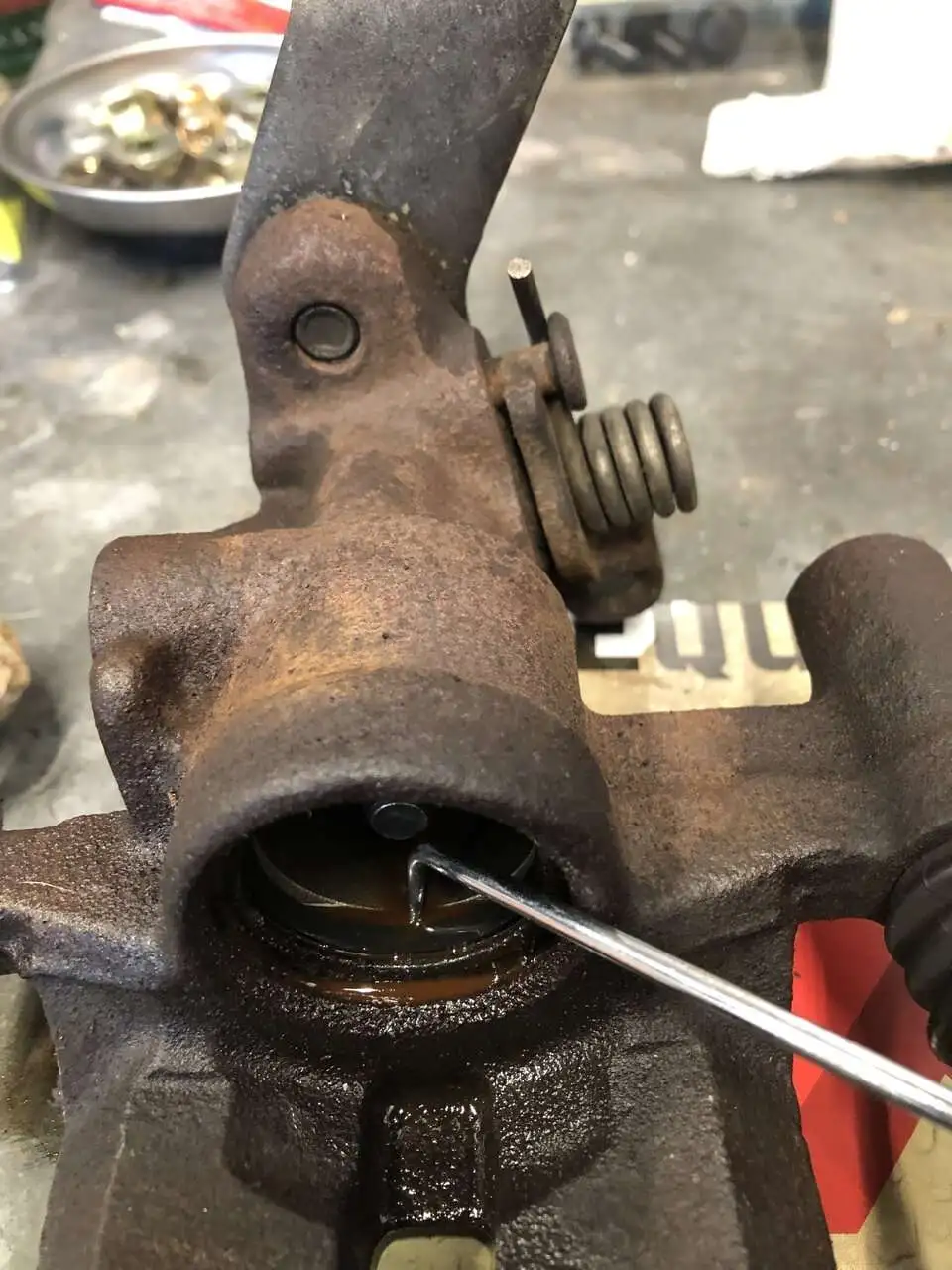

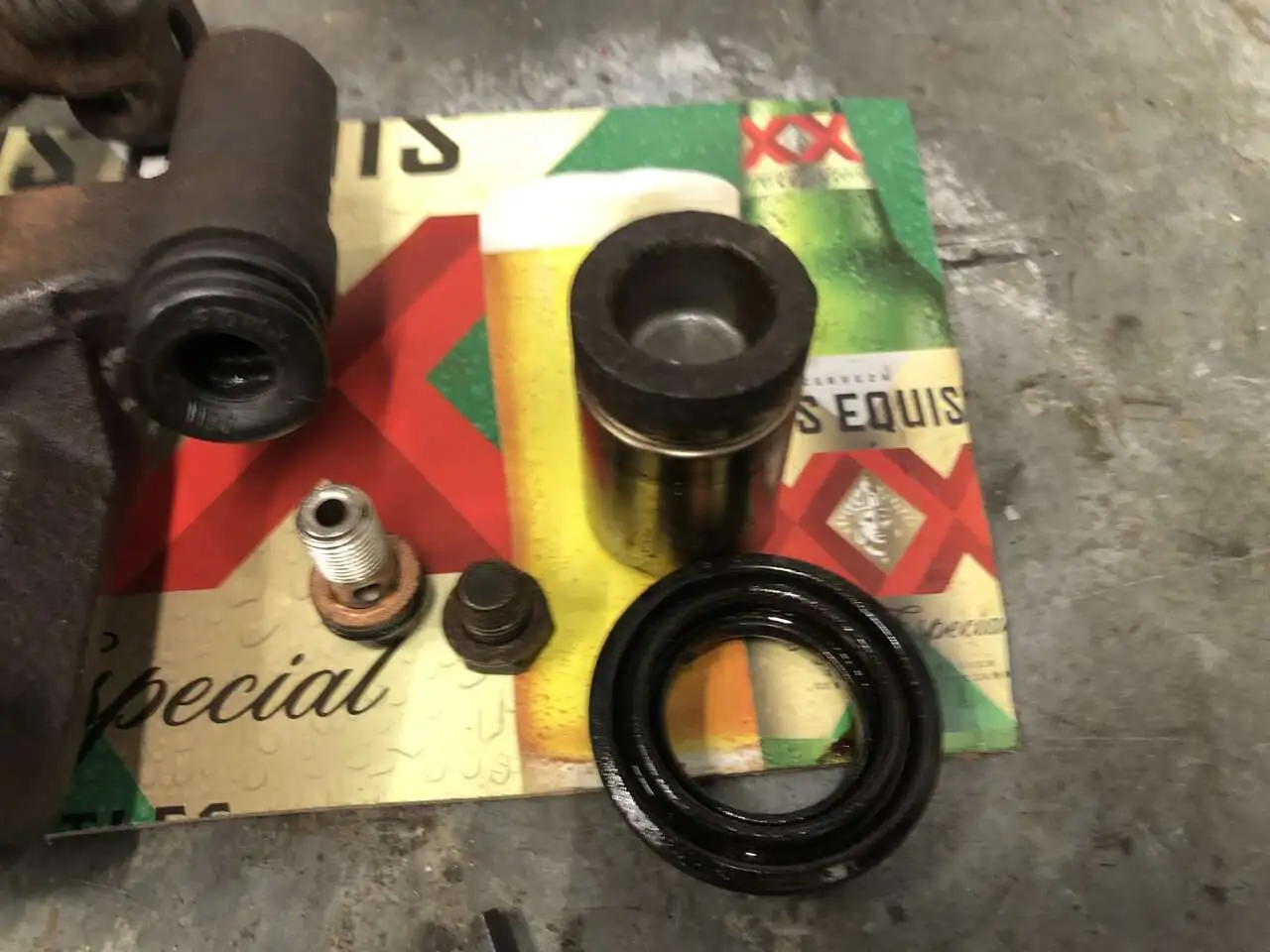

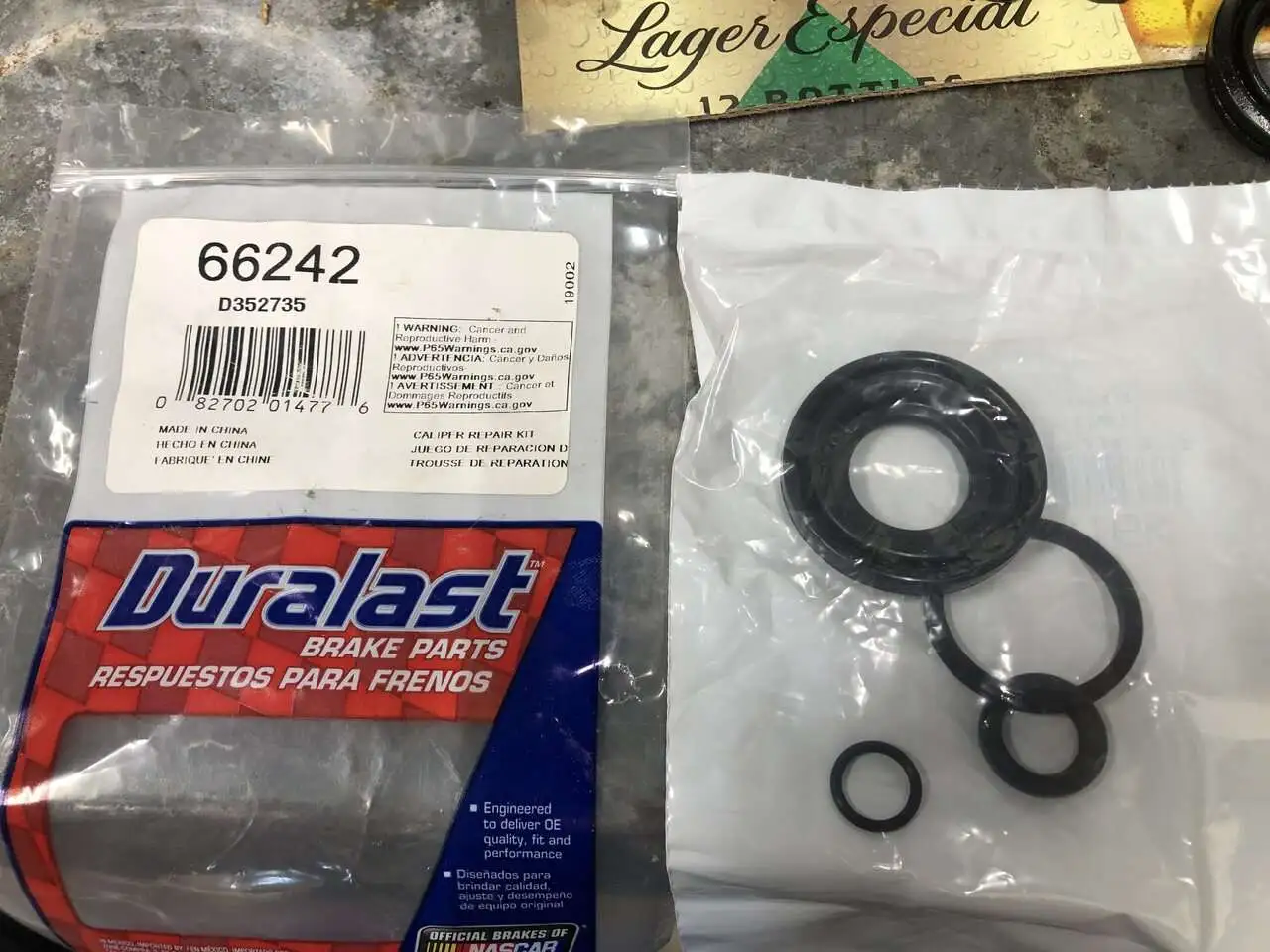

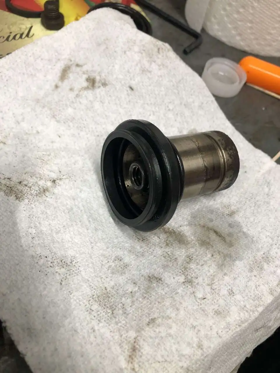

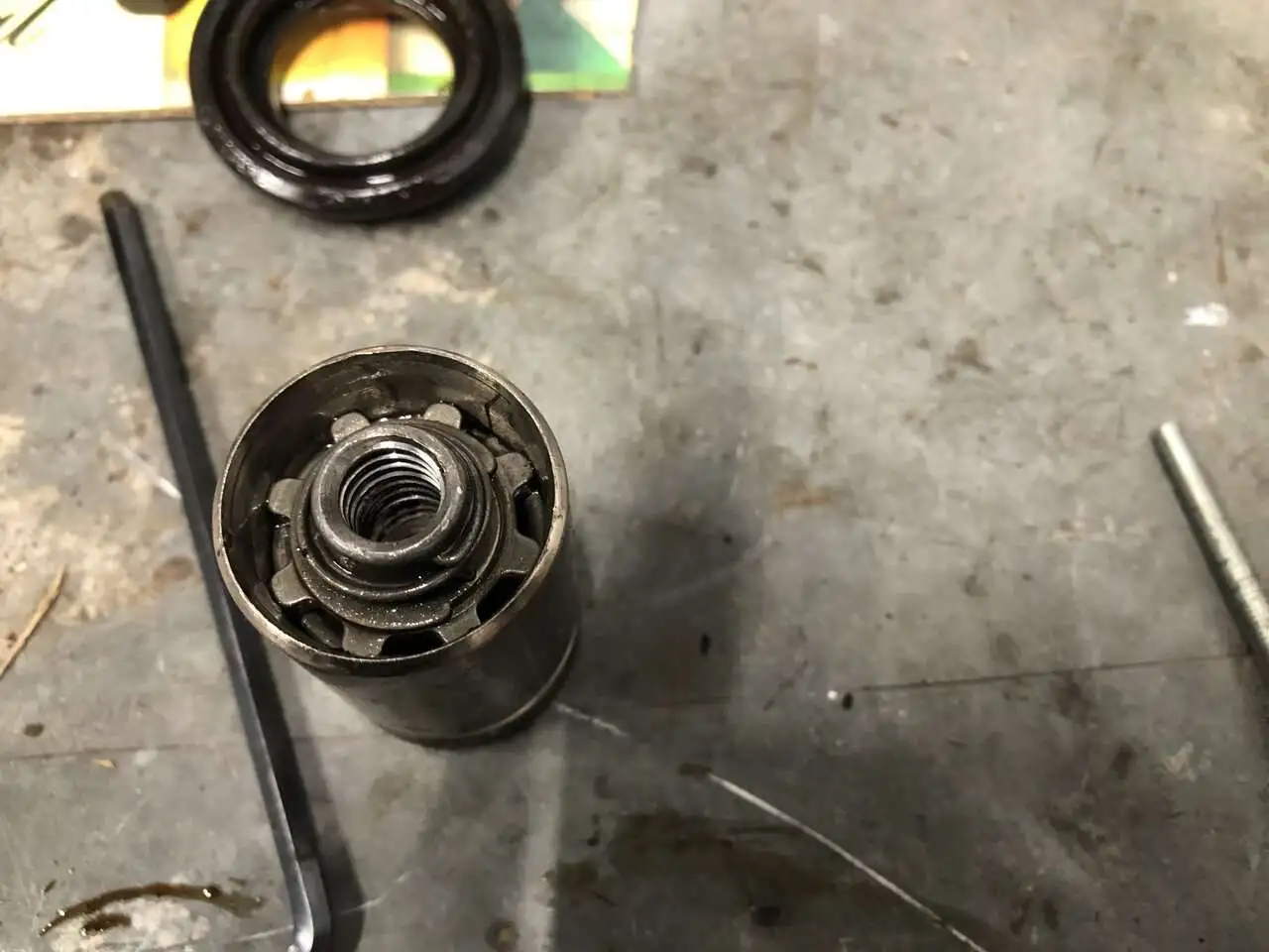

Decided to try the $5 caliper rebuild kit on my rear passenger side brake caliper after tearing the piston boot foolishly.
Wasn’t overly difficult to be honest. After using the adjustment screw to it’s maximum adjustment, I blew compressed air through the port for the banjo bolt and popped the piston out.
The piston was in decent shape besides the corrosion on the exposed edges. No scarring or blemishes inside the caliper either.
I only used the square cut o-ring for the piston and the dust boot from the kit. After installing it I limped it two blocks down the road to my friendly neighborhood mechanic to bleed the lines with a vacuum.
He said “you rebuilt that caliper? It looks good, no leaks. But don’t do that again!” 😂😂

Will, @Blue Pro5 , anyone.. Do you have any advice for loosening the bolts holding the front sway bar bushings? I've tried everything I can think of, including coming in from the engine bay above. I even bought a lonnng 14/15mm box wrench just for this project, but I can't move those bolts. I hit them with PB Blaster and let them sit, even though there's really no rust to speak of on the bolts because it's a Texas car. I think I've been under the car three or four times by now and I've basically given up on them. :cry:
A 14mm ratcheting spanner accessing through the wheel arch might do the trick, it's tight and a PITA. Get a bit if heat in there if you can (without setting the car on fire!) there might be some old loctite on there.
From memory one bolt needs to come out, the other bolt just needs loosening as the bracket is slotted and it'll slide out

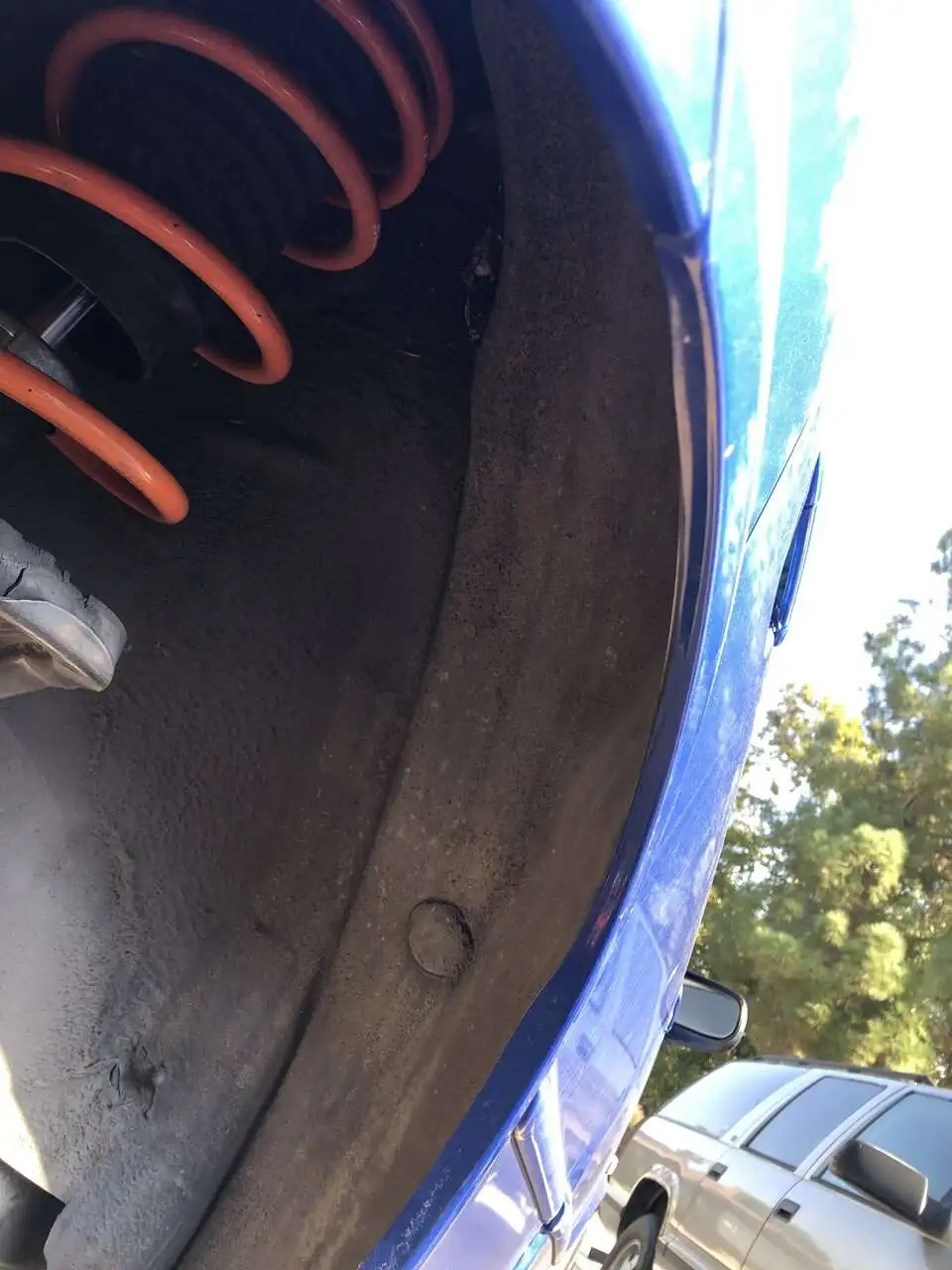

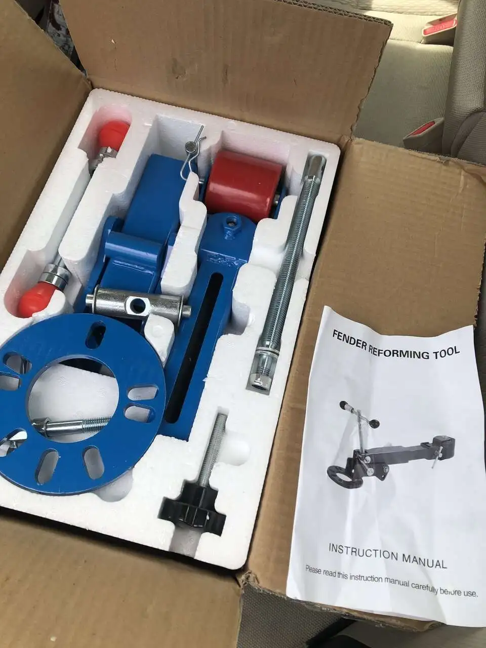

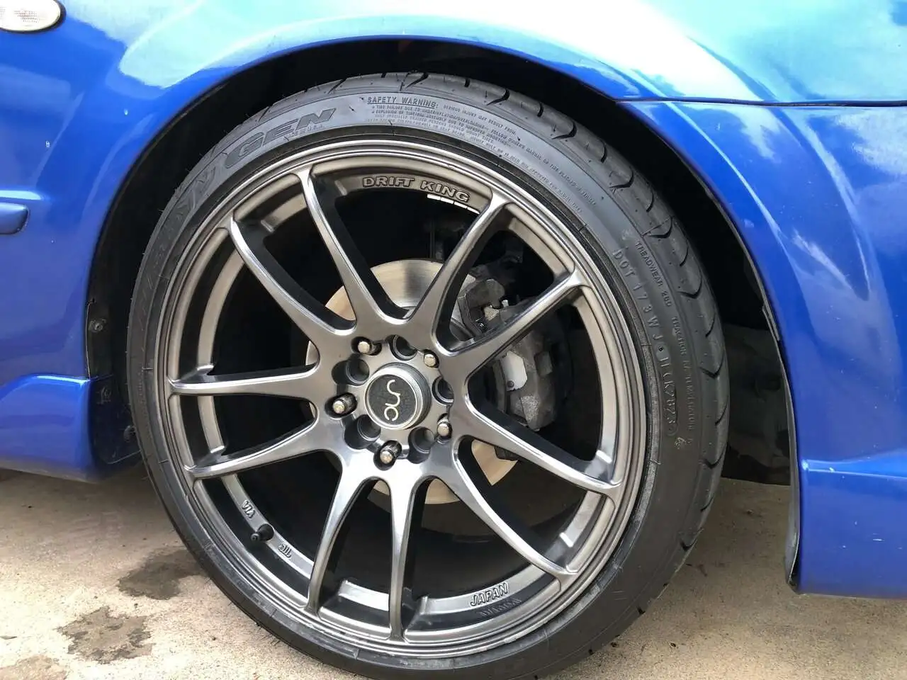

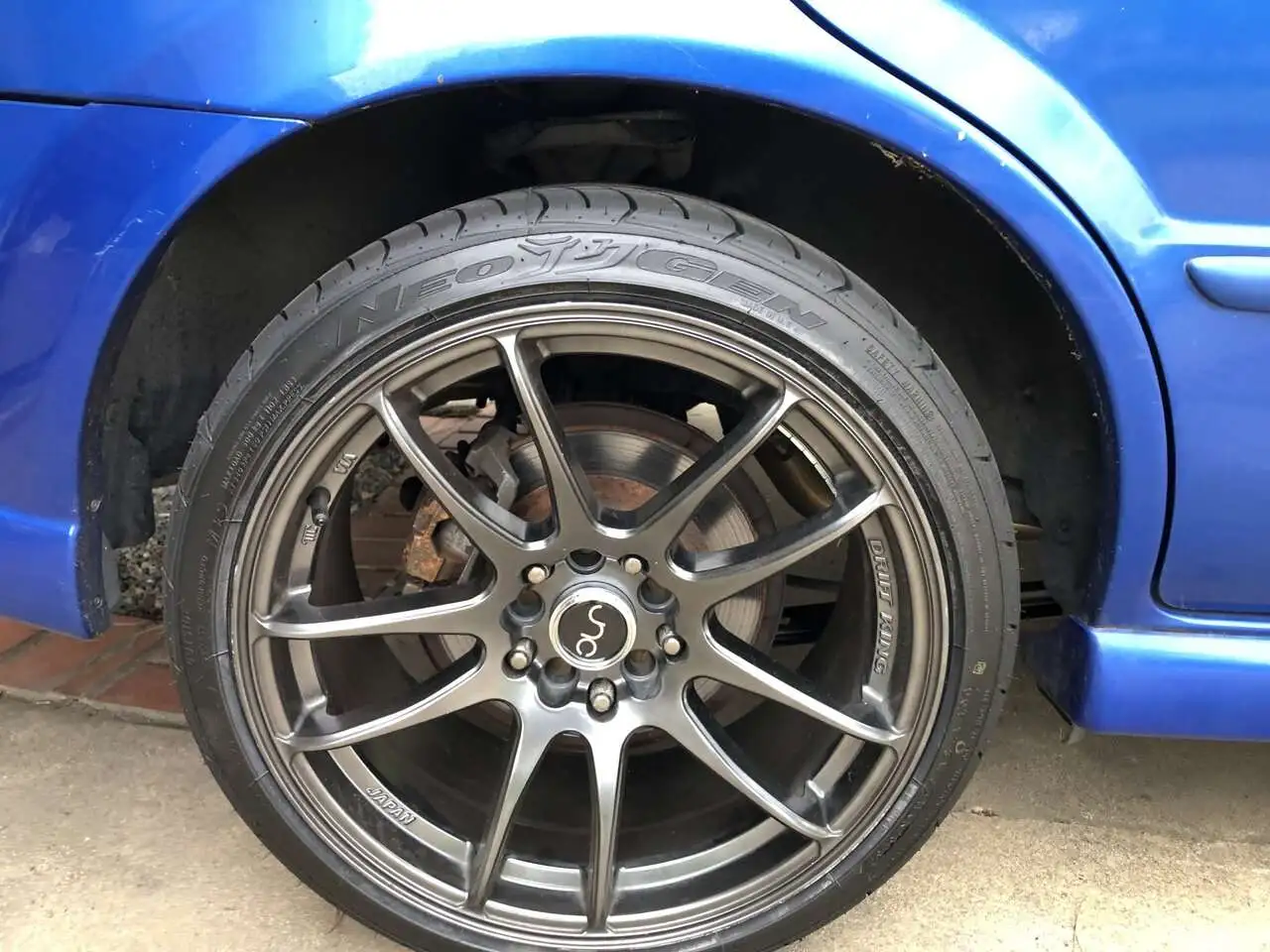

The new wider wheel setup rubs in the back. Bummer.

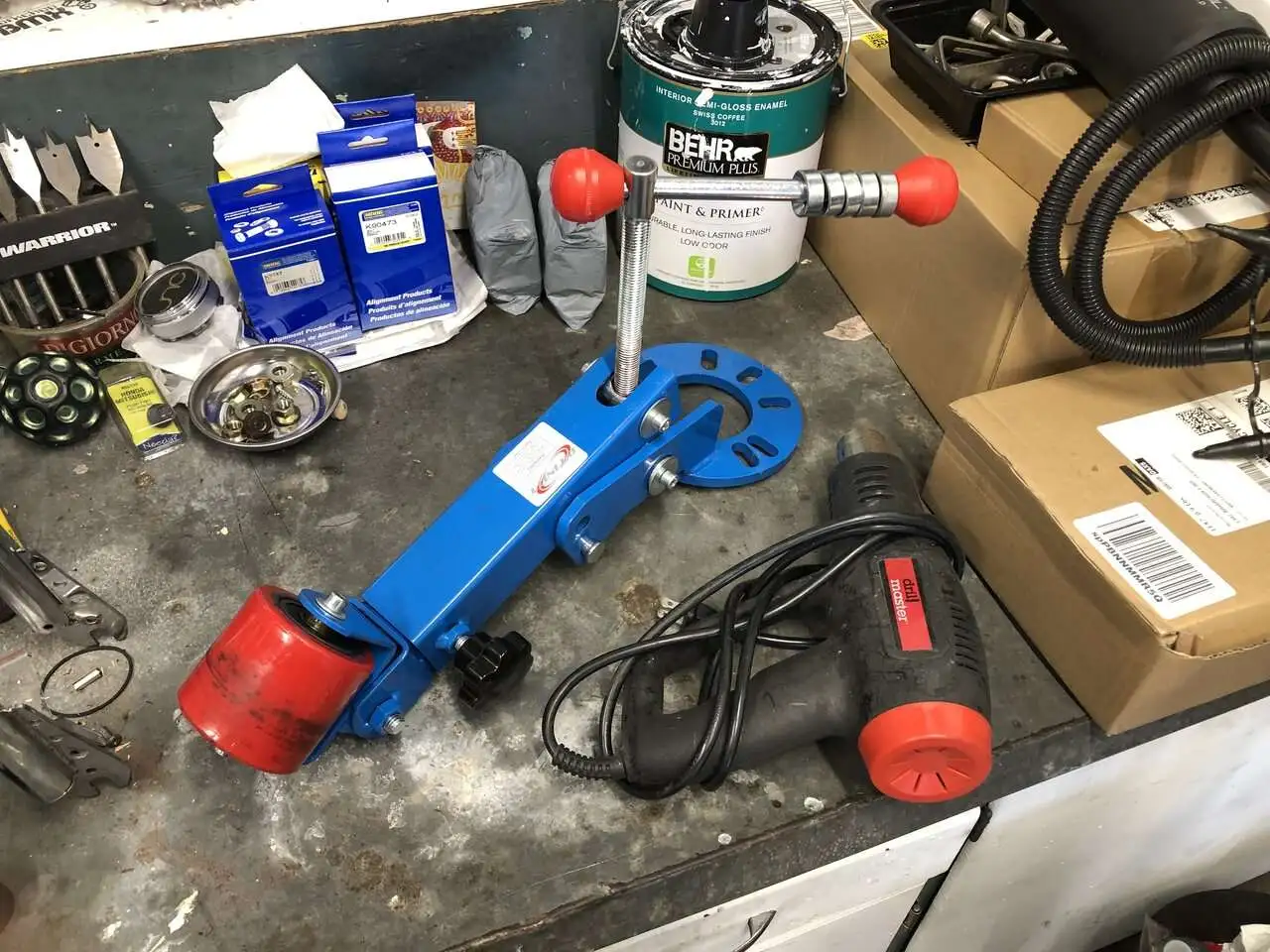

I couldn’t see myself spending $200+ to have someone roll the fenders, so I bought a cheap $45 fender roller and tried it myself. My thought was that even if it only lasted through four fenders, I’d still be ahead of the game.
I have a heat gun already, so it was game on. Tough to see it, but this pic shows the starting point with the horizontal lip sticking into the wheel space over 1/2”
Knockoff fender tool and the HarborFreight heat gun
