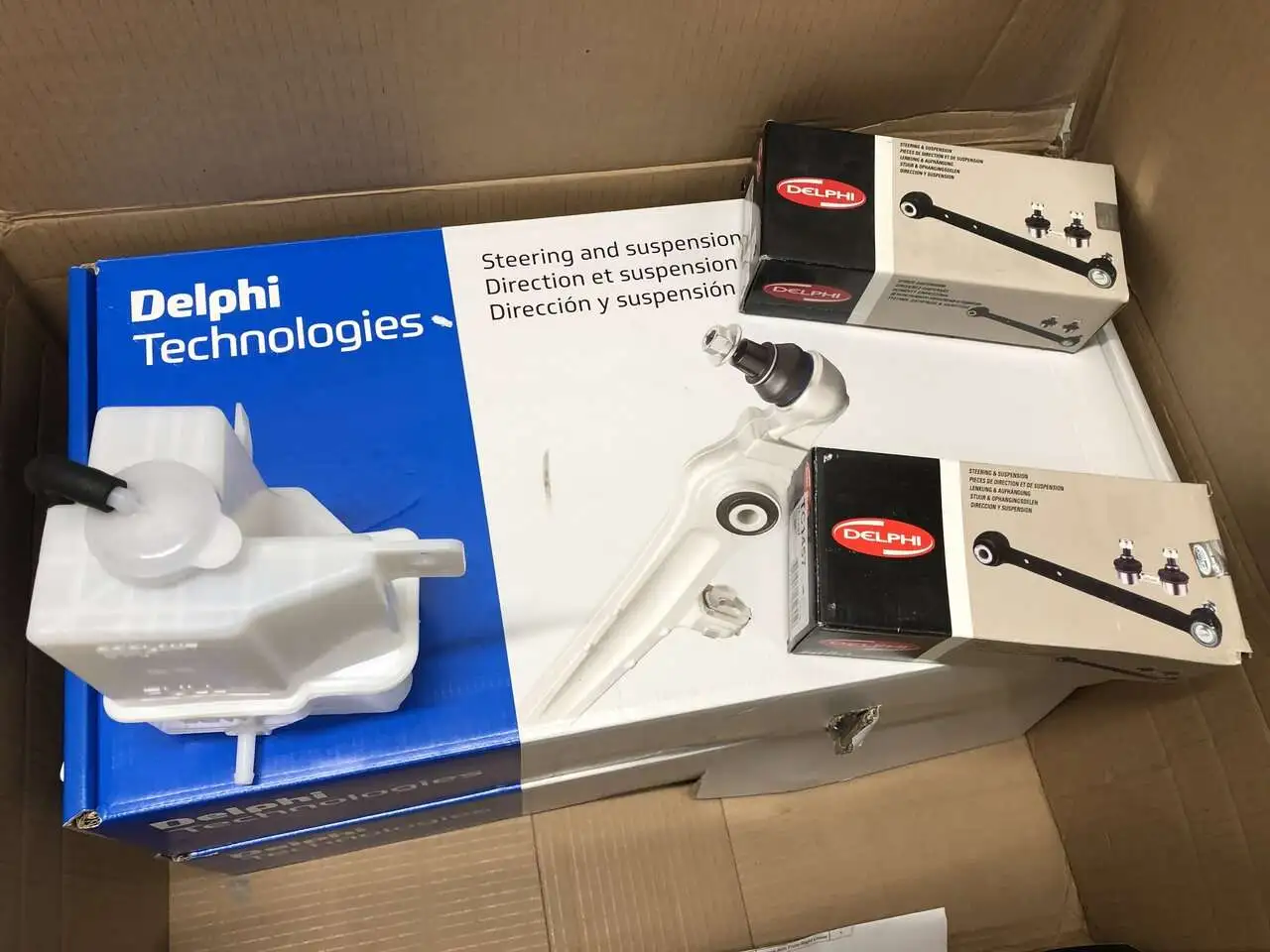

Delivery today!

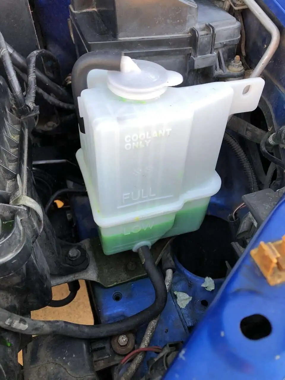

Started with the easy job. No more cracked and leaking overflow tank.

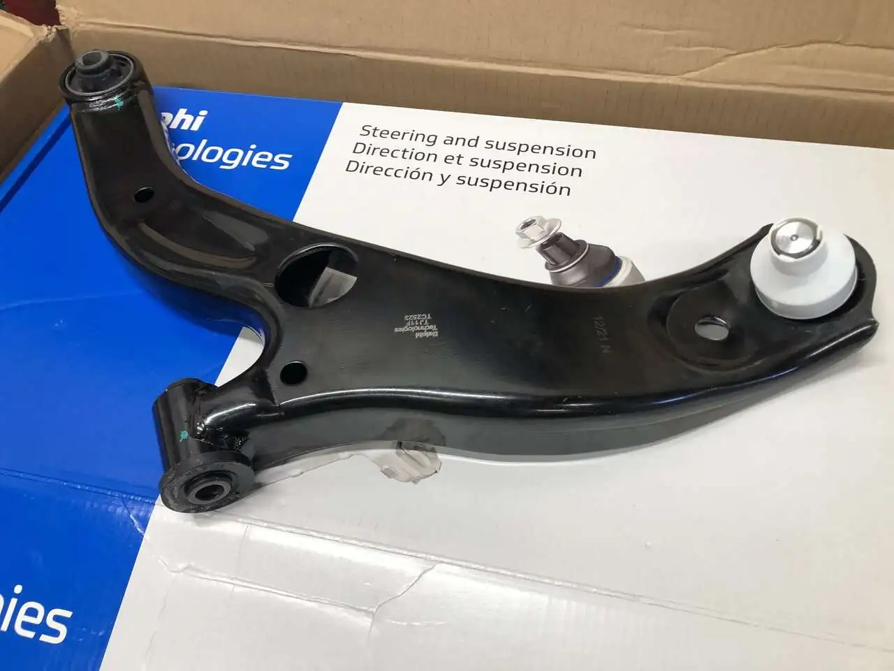

Still waiting on the trailing arms to arrive, hopefully before the weekend so I can tackle the suspension.

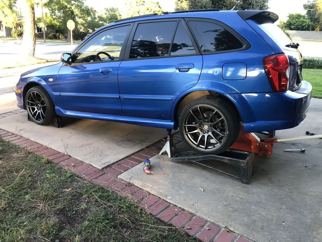

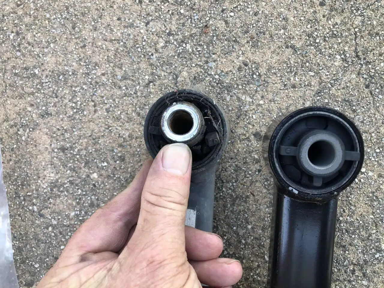

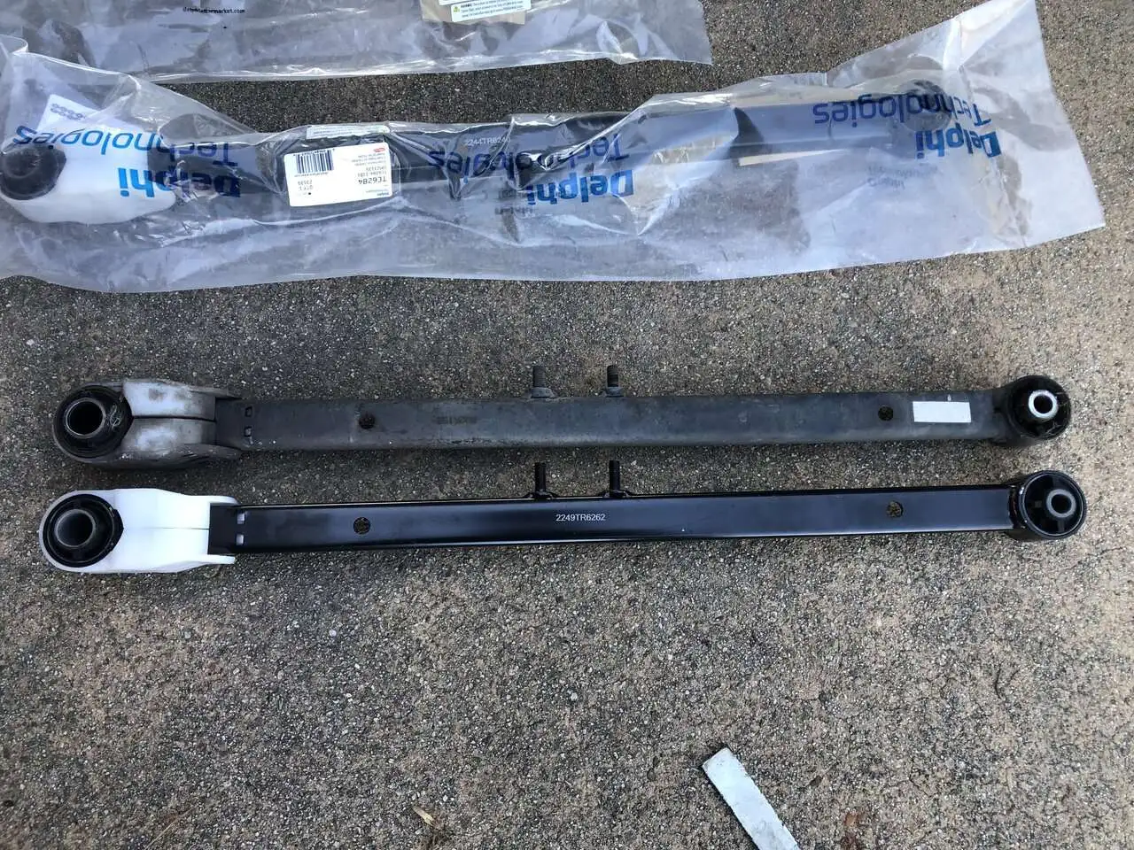

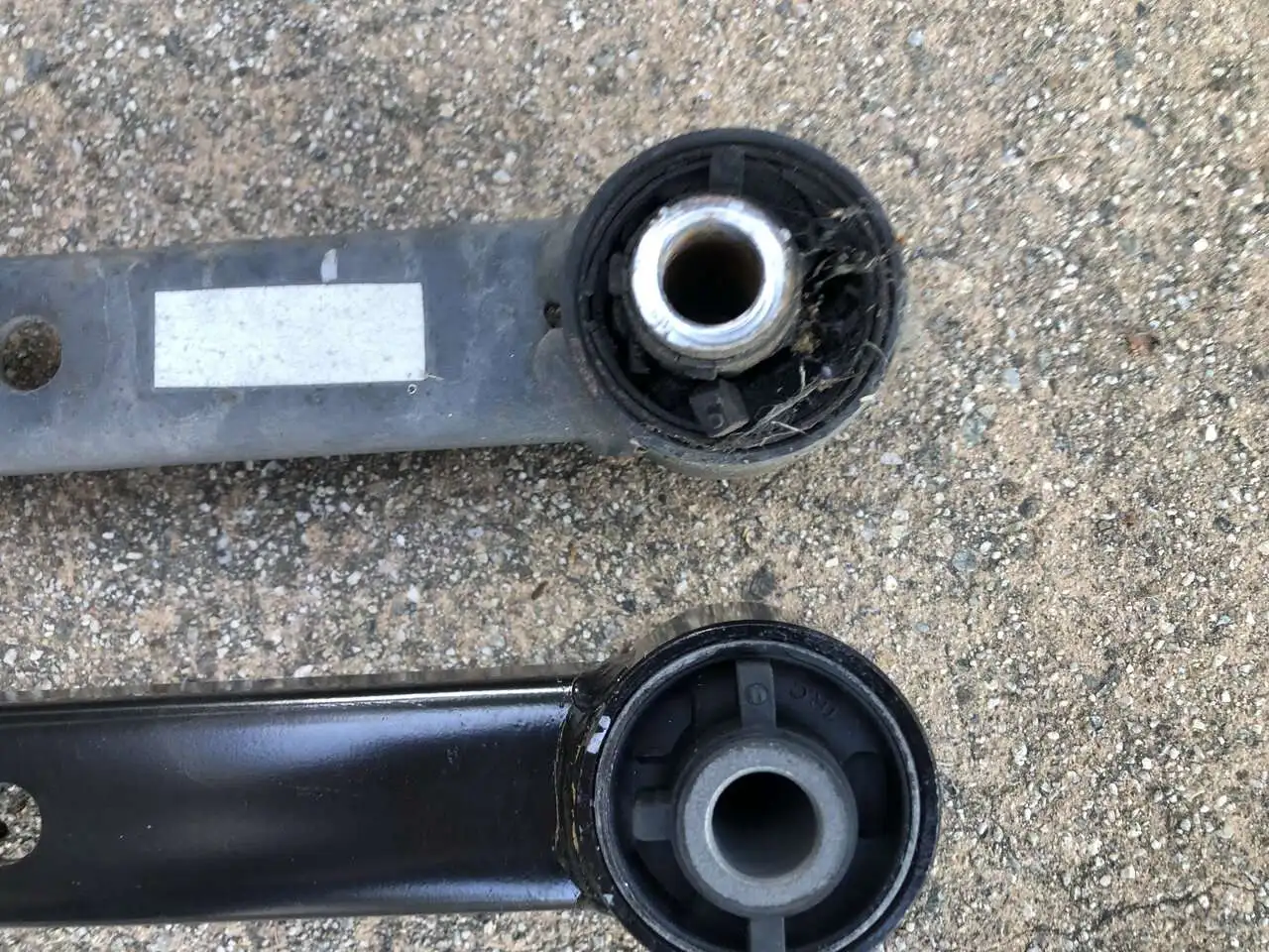

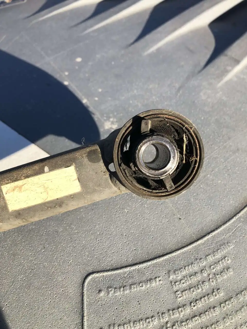

Since I had about two hours of daylight after work, I set out to replace the rear trailing arms.
Really not a tough job, because this car has been in California since the day I bought it new from the dealer in ‘03. Took about 90 minutes give or take. The forward bushings were shot.
I lifted it off the jack stands after they were installed and the bolts were finger tightened, then lowered the rear wheels onto ramps before torquing down the bolts.
Hoping to get much more suspension work done this weekend.

I took two hours just to get one bolt out of my rear trailing arms :p
(might have been the cross arms, the long bolt through the hub was very stuck)

Sounds like I need to start spraying that long bolt now, and on a daily basis. @LankyKiwi , is it supposed to be difficult to remove that bolt even with an impact? Thank god we have no rust down here in Texas to speak of.
I got my P5 new in late '02 and haven't been able to let it go. Was going to replace it with a BRZ and then realized I could just keep it and add a Miata. Problem solved. :p
An impact will make it a ton easier, and a good overnight soak with penetrating oil you should be right 👍
Getting the nut off was the easy bit, getting the long bolt out through the hub was the challenge 😅

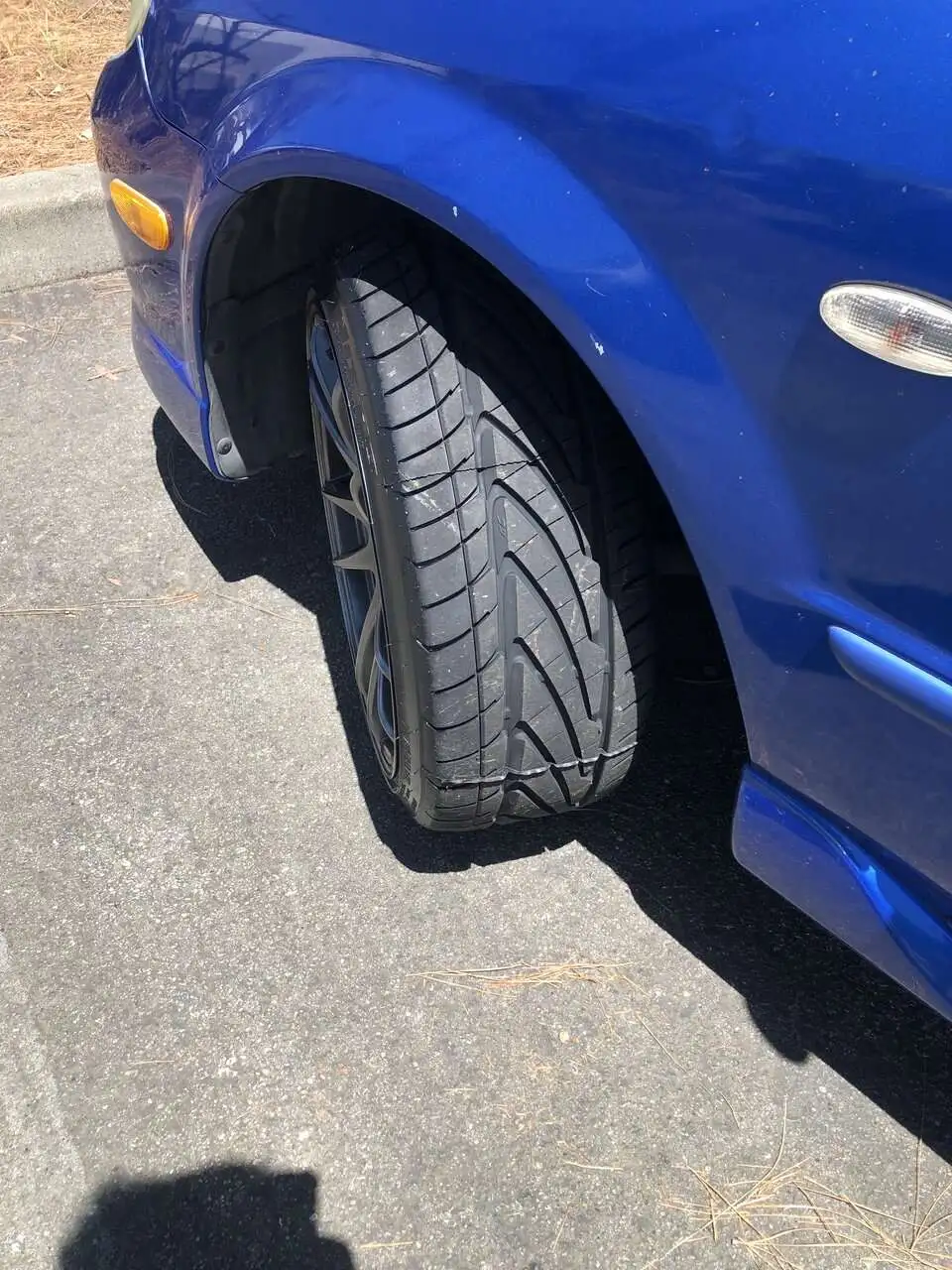

Got some fresh new kicks today. Man what a difference. Nitto NEO GENS
