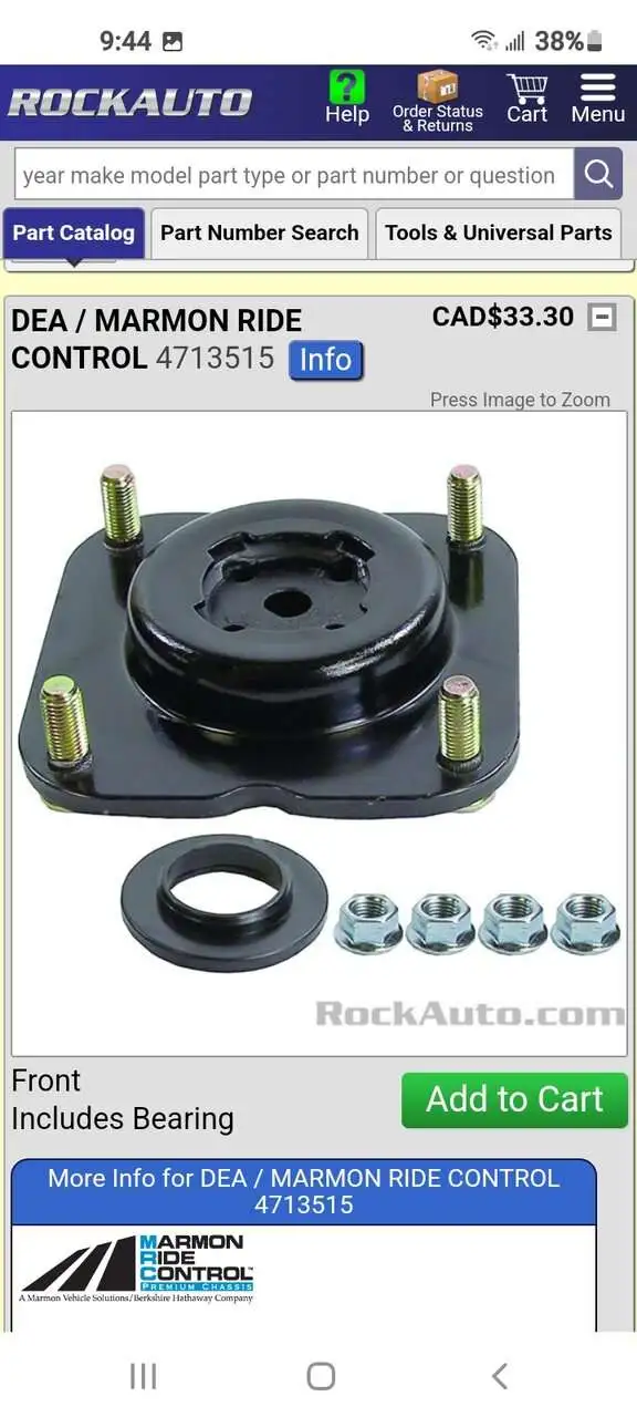

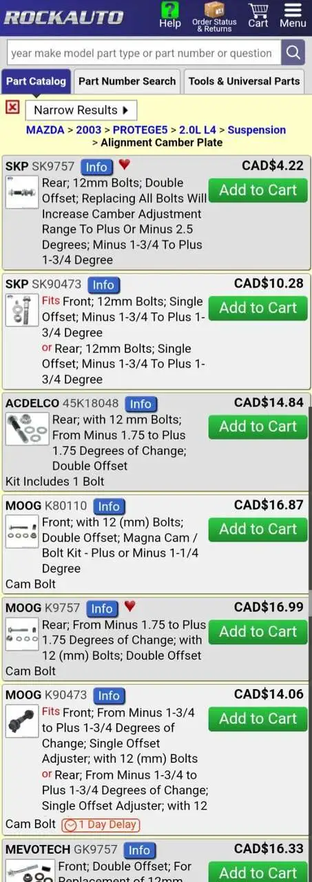

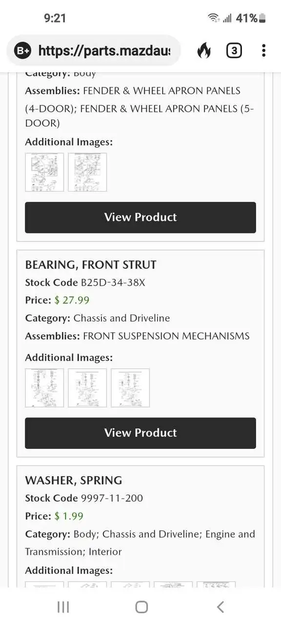

I found this on Mazdaparts online.

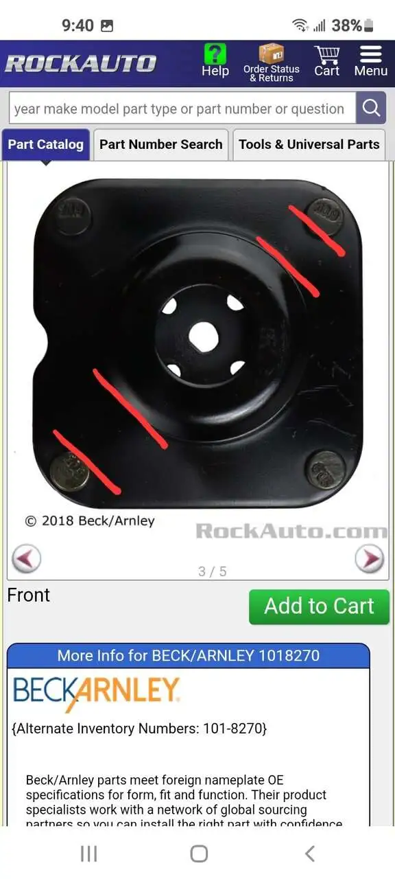

And it looks like the mounts at Rockauto are offset to allow for caster/camber adjustment.
And this one includes the bearing,..
There was only one guy that mentioned about his struts being centered and non adjustable, but he bought complete struts, and I think they were no-name struts off ebay?
I'm not really planning to lower the car at all, so I'd rather not *have* to do camber bolts. But are they just one of those things that is always better to have than not? They don't seem terribly expensive. I may pick some up just to have them, and if I need to install, I will do so.
The camber bolts aren't necessary if you aren't lowering your car.
They are used to keep your wheels flat on the ground after you lower your car.
They can be unreliable too because they can spin around in the bolt holes and throw off the camber.

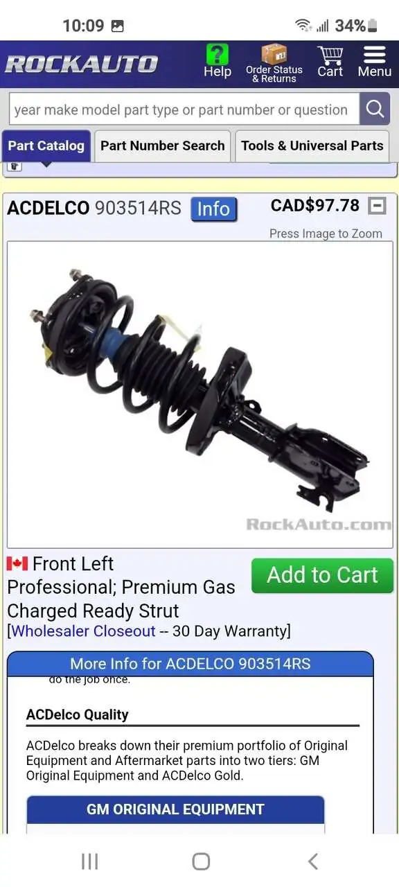

I personally like the AC Delco front struts. They are an OEM supplier for GM.
You may want to replace your front struts with complete struts.
Your struts probably lost a lot of their damping ability and the springs have probably sagged quite a bit as well.
Complete new struts would really tighten up the front end of your car, and you may be able to eliminate that clunk.

I will go ahead and pick up a set of strut assemblies for the front - I don't mind spending the extra money since they probably need to be replaced anyways, and I gosh darn hope that clunk goes away. I'll grab some camber bolts as well, but probably just to have for the future if I need them, since they are relatively cheap.

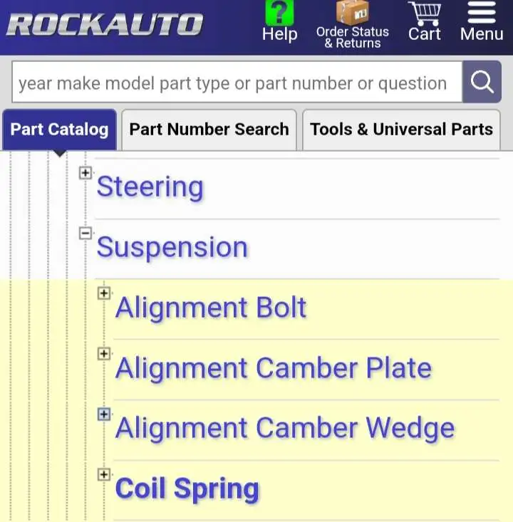

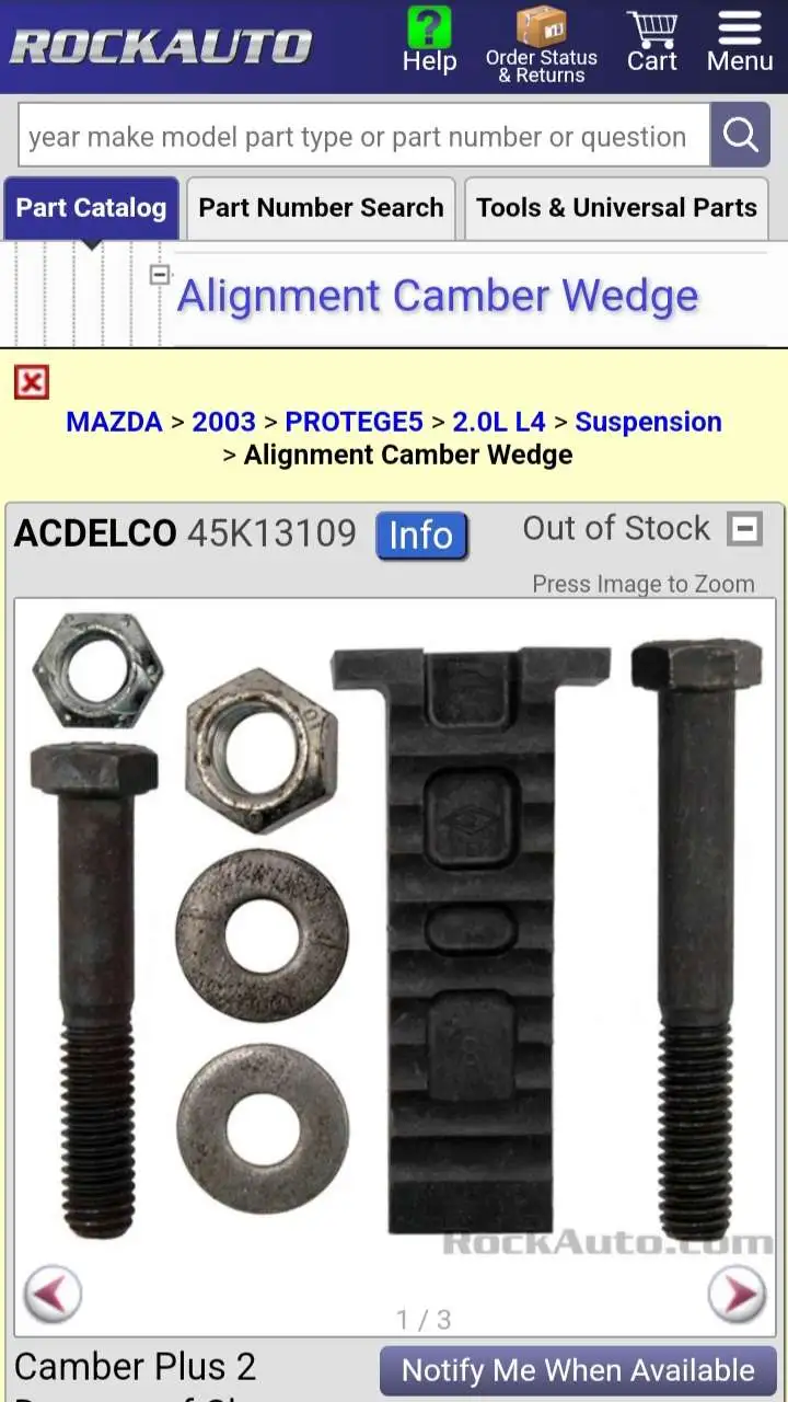

They also have camber plates and camber wedge.
The camber plates look like the camber bolts to me?
And there's the "front" and "rear" bolts.
Looks like some you can use on the front or rear, and some can only be used on the rear.
I dunno ??
I don't know much about it, or how many bolts you would need?
Try searching this forum for information on them before you buy something.

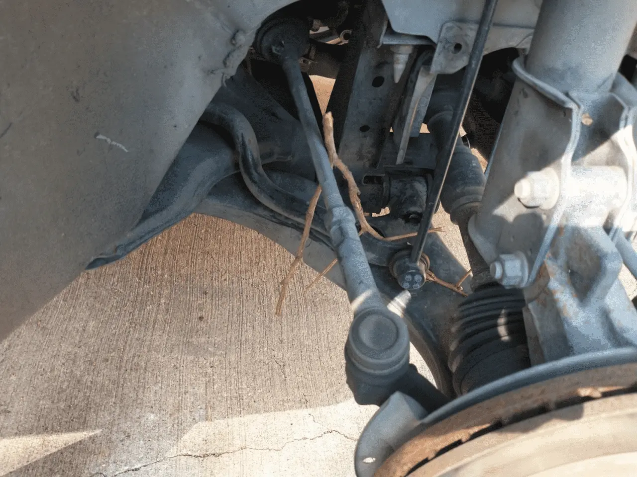

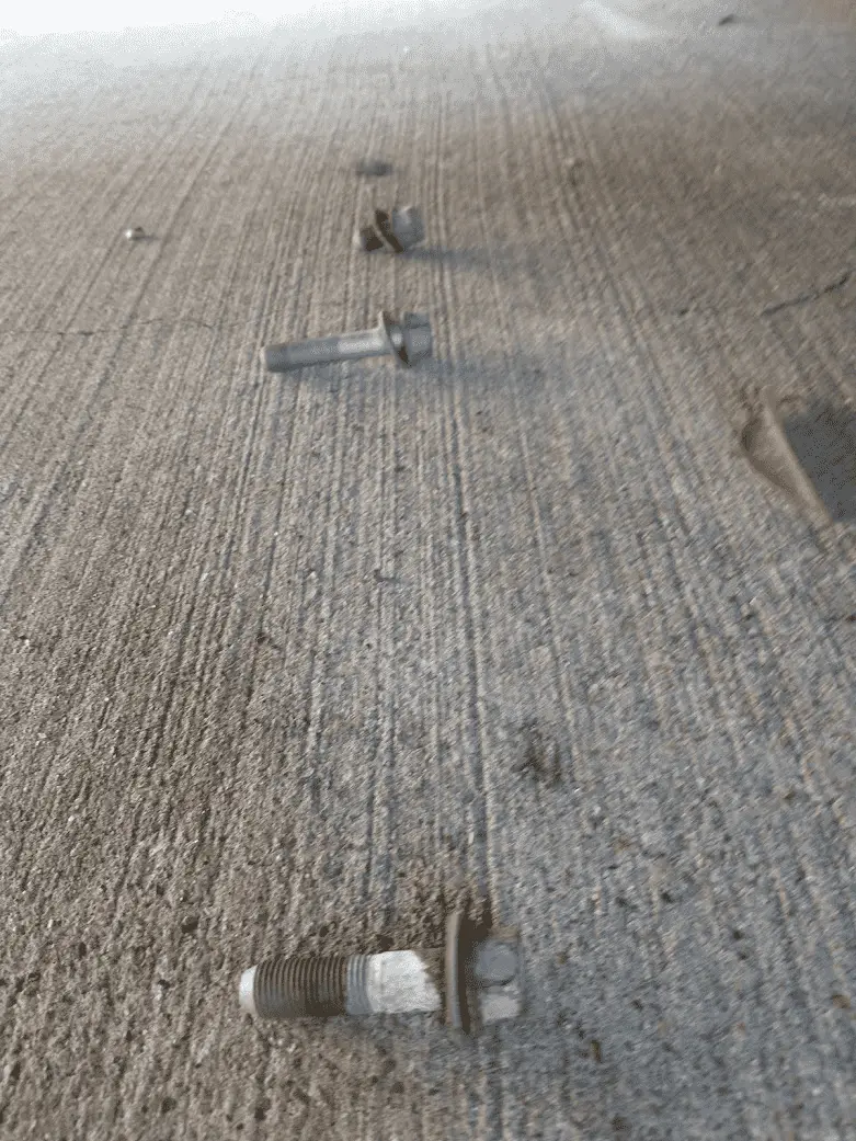

I replaced the driver's side LCA in 108-degree (that's 42 C for folks with more sane units of measurement). Heat index was 114 and I had limited shade. That was a huge mistake, but I took breaks and drank six bottles of water. My shirt became so heavy with sweat that it was like some kind of weighted workout jacket. Oh, and to top it off, we had a brief downpour in that 108 degrees while still in full sun. It was surreal. By the time I went back out it was a literal wet sauna. Man, everything hurts today and I had all kinds of crazy dreams waking me up last night so I didn't get a good night's sleep. Don't do this. Don't be me.
The key to successful installation *for me* was jacking up that knuckle to get the LCA completely horizontal. That allowed me to start the front bushing and the rear bracket+bolts with ease. DD, I've checked my other, new LCA and the original, removed LCA and the bolt hole on that rear bushing (or whatever it is) is boringly perpendicular to the rest of the part. So I'm not surprised that it was easy to install in my case. Now, I don't have OEM replacement parts, but some (NOS?) Beck Arnley ones, and they may be different from other brands.
My biggest problem with elevating that knuckle (which was a *requirement* for me) was that the floor jack was occupying the space where the ball joint needed to be when I'd swing the LCA up to get it horizontal. I tried turning the wheel all the way to the left or right to try and make some space, but in one of those directions, the end link contacted another piece of the suspension when I elevated the knuckle so that was a no-go. 😳 I ended up returning the steering wheel to center and went another route: Moving the knuckle fore and aft. In the end, I moved the knuckle forward a little farther than I wanted to as shown below. Hopefully I didn't hurt anything. After hours in the sun and an immobilized vehicle in my apartment parking lot, I honestly didn't care as long as I could get it moving to take it to a shop if needed. The other challenge was my not wanting to remove the cap from the ball joint boot until the very last minute. There are a lot of sharp parts down there including the knife-like disc brake shield, and I didn't want to destroy the ball joint boot.
DD, this is where I would say that removing the brake assembly, hub, and shield might help. If it allows more jacking options or keeps that ball joint boot safe it is well worth the additional minutes and bungee cord required. I will definitely do that for the other side. Also, if you're filming it like the guy in the video, it's a lot better for the viewer. :) Speaking of the video, I think the guy got the torque for the pinch bolt wrong (too high), and I can see from the service manual how he could have done that. I'll confirm that and if so, drop him a note in his Comment section.
Pics:
Found out what was making the noise after I removed my wheel 😉 (yes, it was there, but it wasn't making the noises):
Knuckle shoved to the front of the car while jacked, hopefully not too far:
Knuckle elevated with plastic ball joint cover installed till the bitter end:
Captured the order of the three different bolts for that rear bracket (actual LCA bolt would go in the empty space among them):
Today, six months after replacing the left LCA, I replaced the right one :p and it seems this has gotten rid of a lot of my remaining clunks. In fact, replacing the *right*-front one almost seems to have further quieted noises from my hitting bumps with the *left*-front wheel, which already had its LCA replaced. (?!?) Is it possible that road impact to the left-front wheel is referred to the right-front wheel via stabilizer bar or body, whereupon it (previously) made a clunk?
Surprisingly, the ball joint pictured below wasn't that bad. Yes, I could move it with my hand, but it wasn't exactly sloppy. However, based on the cracked bushings at the other two corners of the LCA (and the improvement I feel in the ride now), it was past time to replace it.
The order of installation I took this time was different: 1) front bolt 2) ball joint 3) four rear bolts. I did one thing different this time that helped: I removed the two 17mm bolts holding the knuckle to the strut, which is not normally a requirement. This made it easier to both fasten the ball joint and jack up the knuckle in order to get the LCA horizontal and install the four rear bolts (no spring resistance with the strut detached). The only caution is that while jacking up the knuckle with those two 17mm bolts undone, the strut can collide with your CV boot and the stabilizer bar can contact the LCA. I made sure that I stopped jacking up the knuckle before that happened.

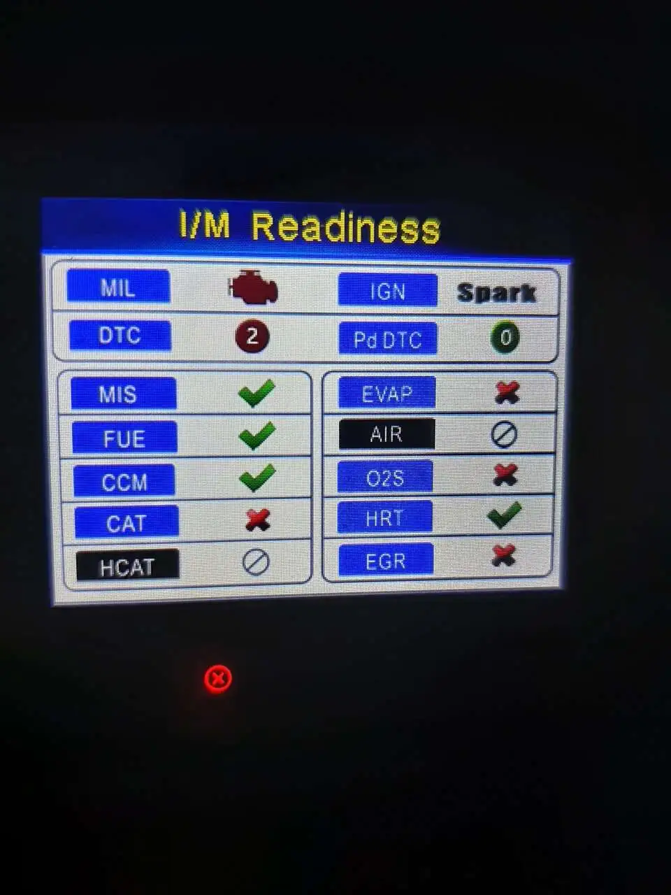

Funny that you posted this just now. After my P5's passing inspections easily for 20 years, it failed twice last week with both CAT and EVAP monitors showing Not Ready. I didn't know these monitors even existed. I had only ever dealt with actual trouble codes like your P0300 one. I had recently disconnected the battery, but after a week or two of driving, testing the battery, and swapping out the ECU with a spare, I just couldn't reset those two monitors. I then finally followed Mazda's prescribed drive cycle steps to reset the CAT readiness monitor (Google for that) and it totally worked. That left only the one bad EVAP monitor which was enough for me to pass inspection. I imagine the EVAP monitor will reset on its own over the course of the year, but if not I may follow the prescribed drive cycle steps for its monitor as well.
The guys at the inspection/oil change place didn't know about readiness monitors either, and that was a surprise. One of them even told me that I'd certainly fail a third time since I hadn't taken the car to a mechanic. :D Then again, they are all pretty young and don't have a lot of experience. I have to do some of my own inspection testing when I go there because none of them can drive a manual.

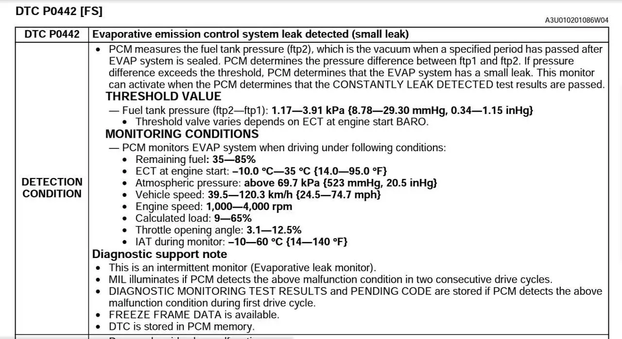

Don't forget your monitoring conditions.
Your fuel level needs to be between 35%-85% for the system to be monitored.
