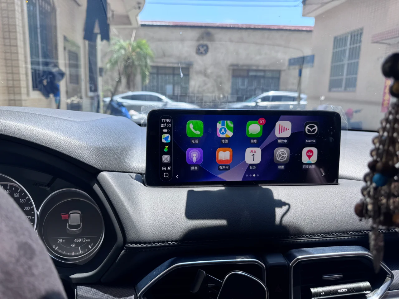

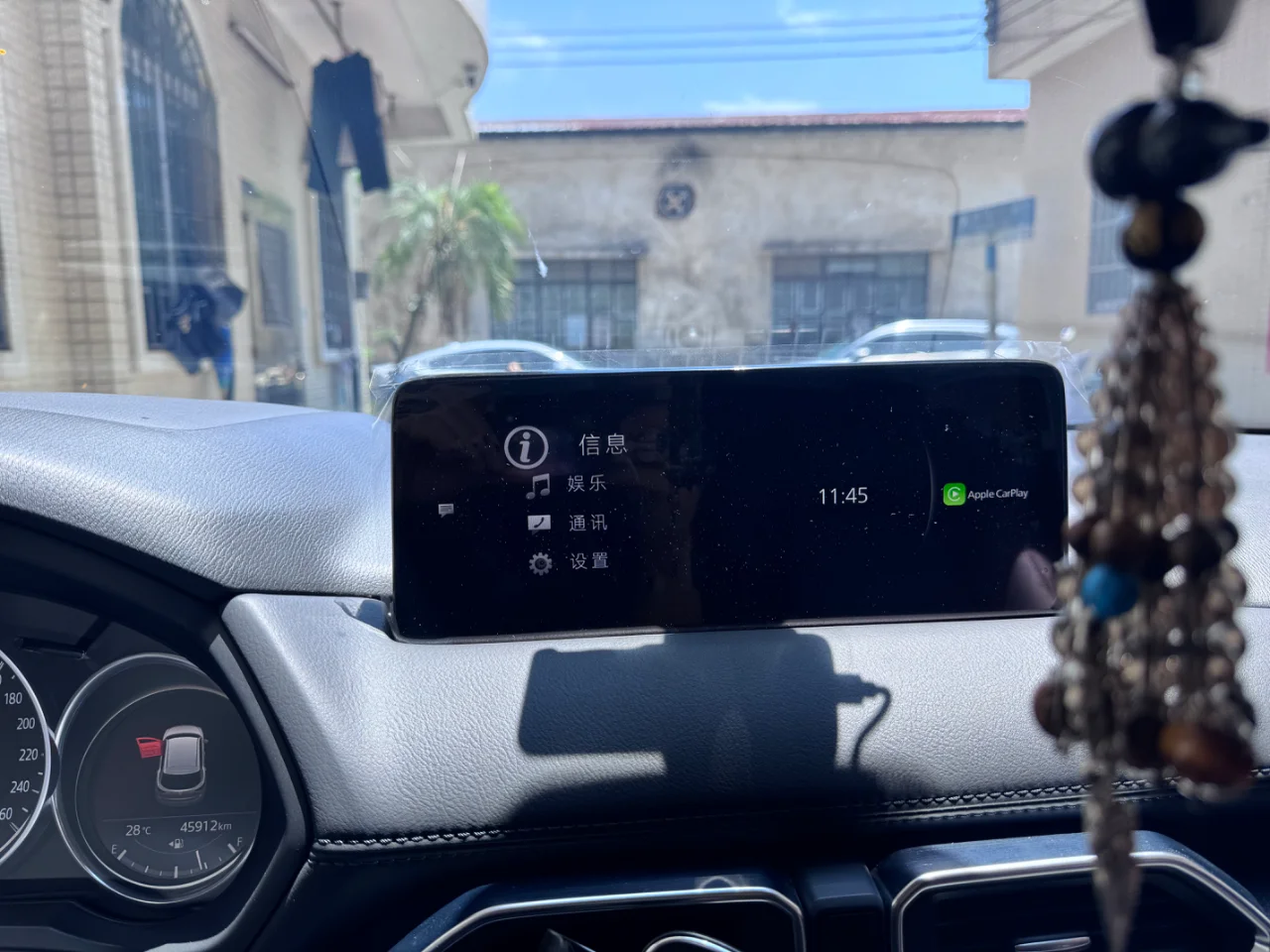

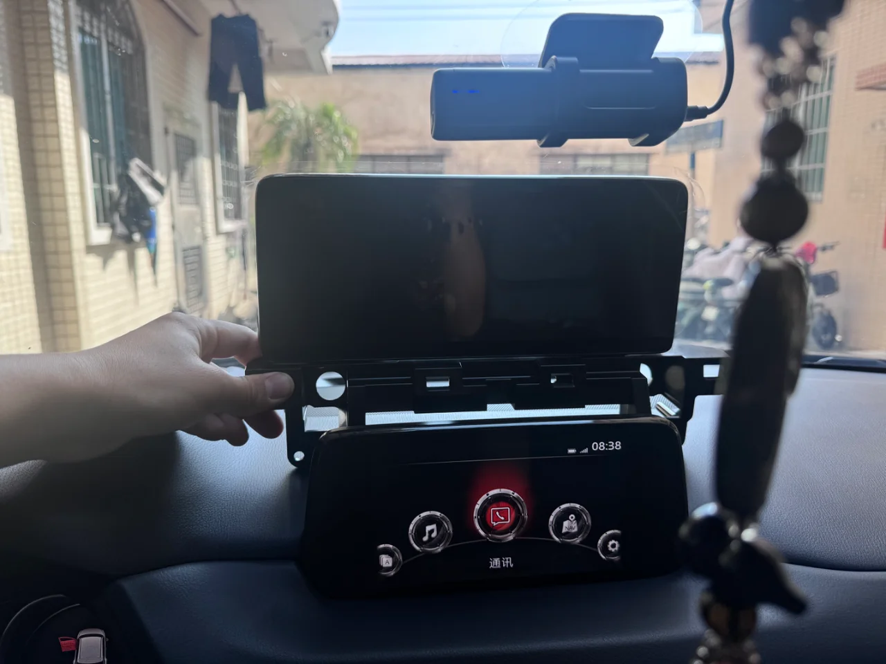

No problem, I have a 2018 model and already got the 10.25-inch original screen and head unit installed
