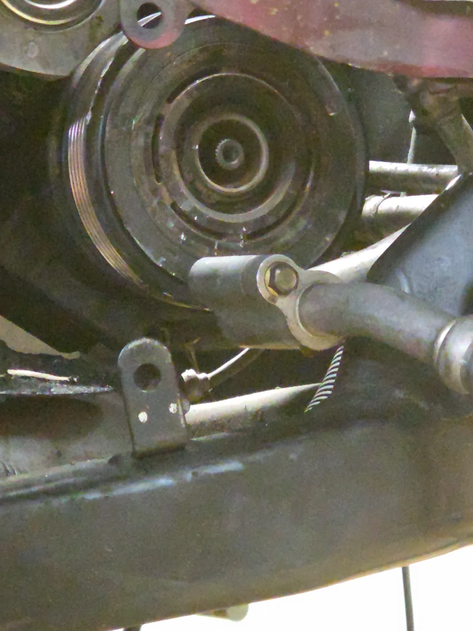

Started some assessment and testing what needs attention first. #1, the AC compressor pulley bearing is making a lot of noise and that prevents hearing much else going on with the engine. So it is going to be the first repair. I don't intend to pull the compressor, but am trying to make as much room as possible to get to the pulley. I also took a stab at the headlights and it seems they will clean up and polish well.

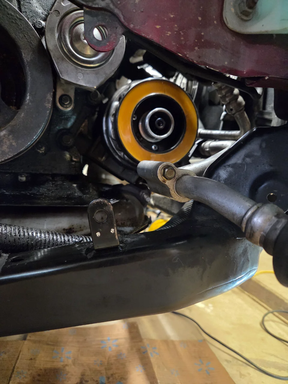

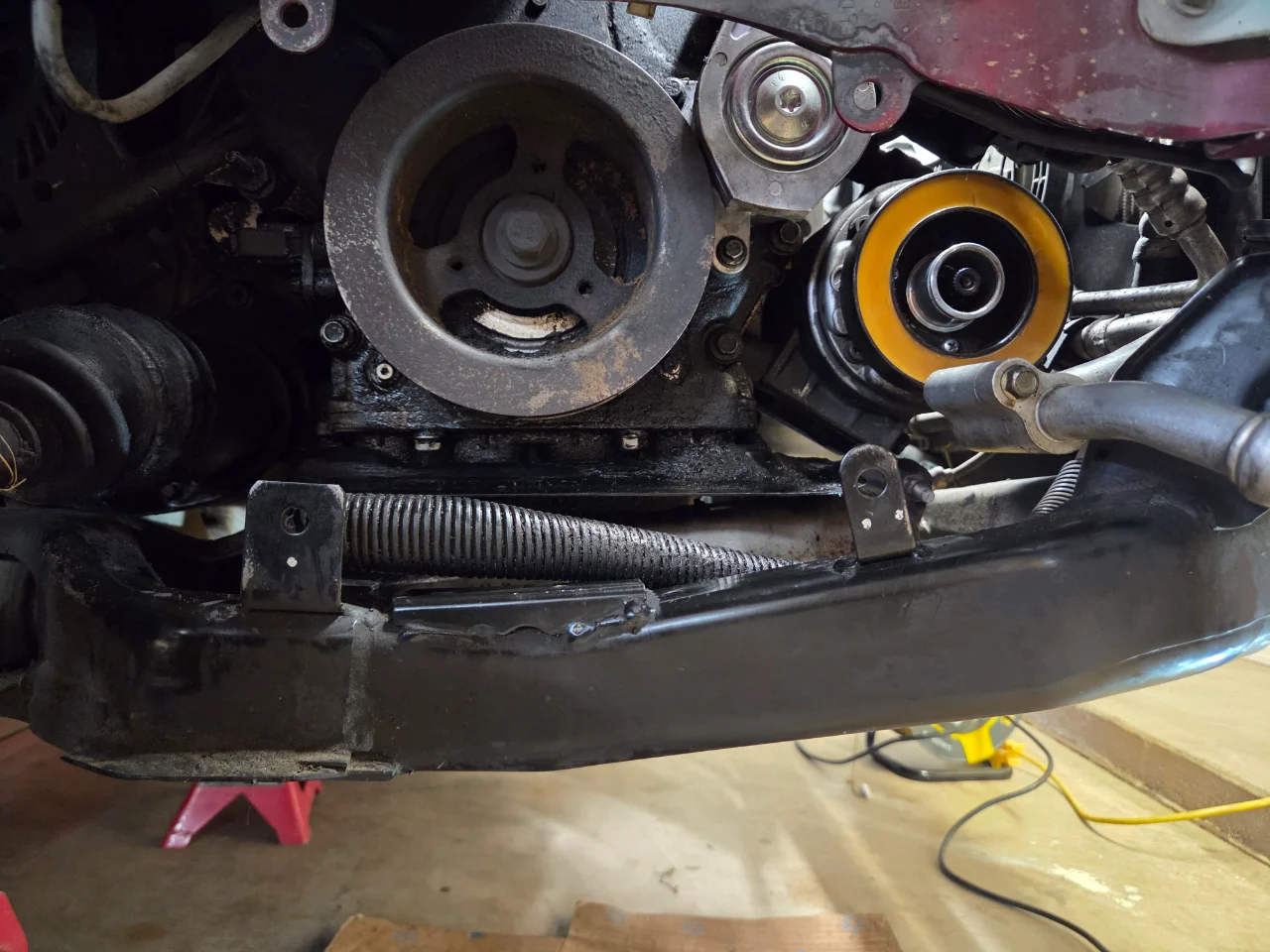

Worked the first repair on the Swagon. A/C compressor had a bad pulley bearing. Got a kit with new coil, pulley with bearing and new clutch. A few hours of wrenching and everything was back in place and working well without a groaning pulley. Now I can hear all the other sounds the engine is making. Noticed the deteriorated torque mount underneath and believe the passenger side engine mount may be shot as well, based on sounds and shaking. New mounts all the way around is on the books now. Spark plugs and coils are also on the way. Looks like I have some oil leakage, but not sure on the exact source yet, so that will take investigation.

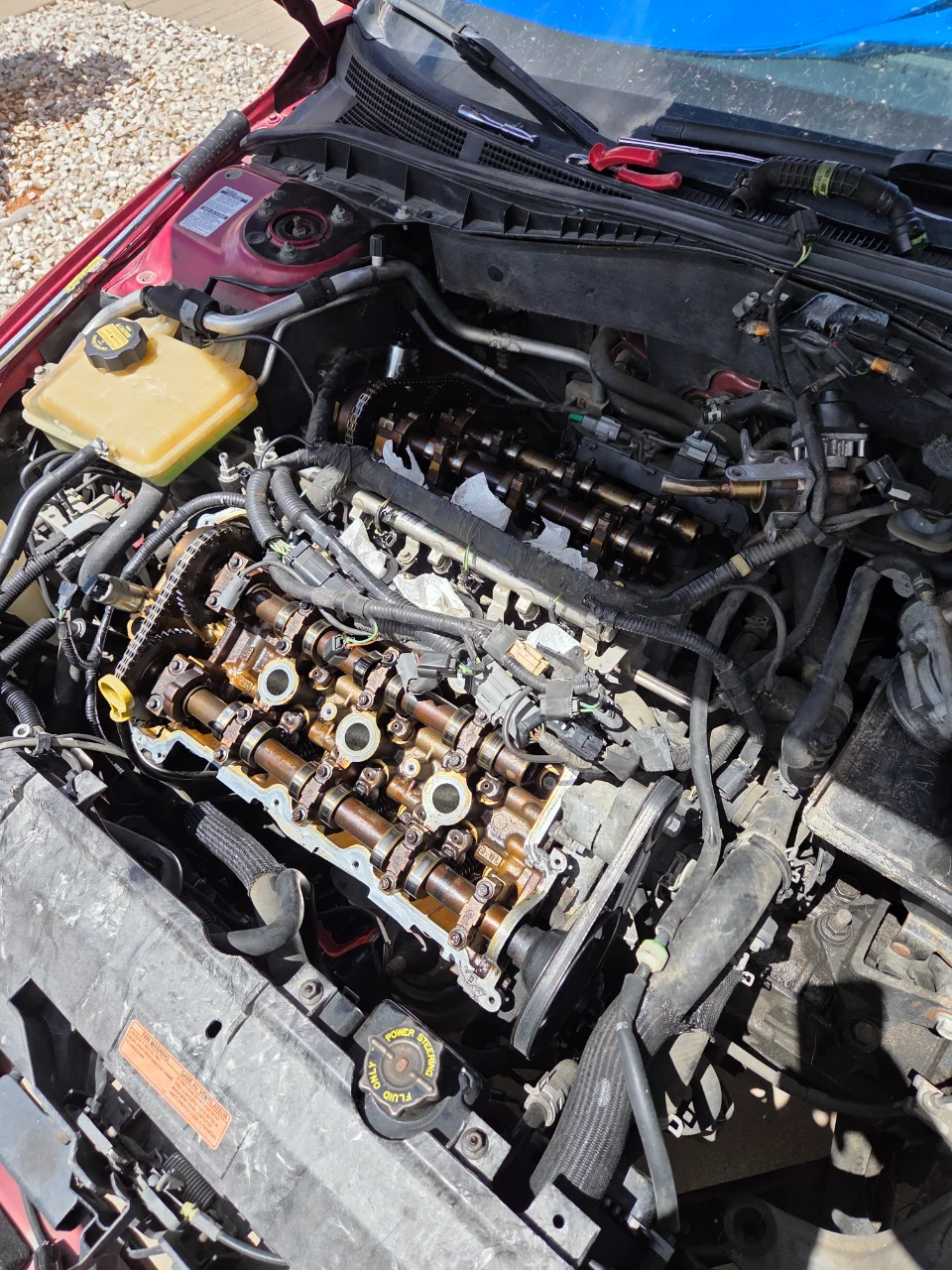

Finished another round of work on the wagon. Pulled intake, coils, plugs and valve covers to check the cam cap bolts and then new gaskets, plugs, and coils on the way out. And the valve covers got cleaned and painted. Definitely runs better. I have a new torque mount on the way to replace the badly worn one.

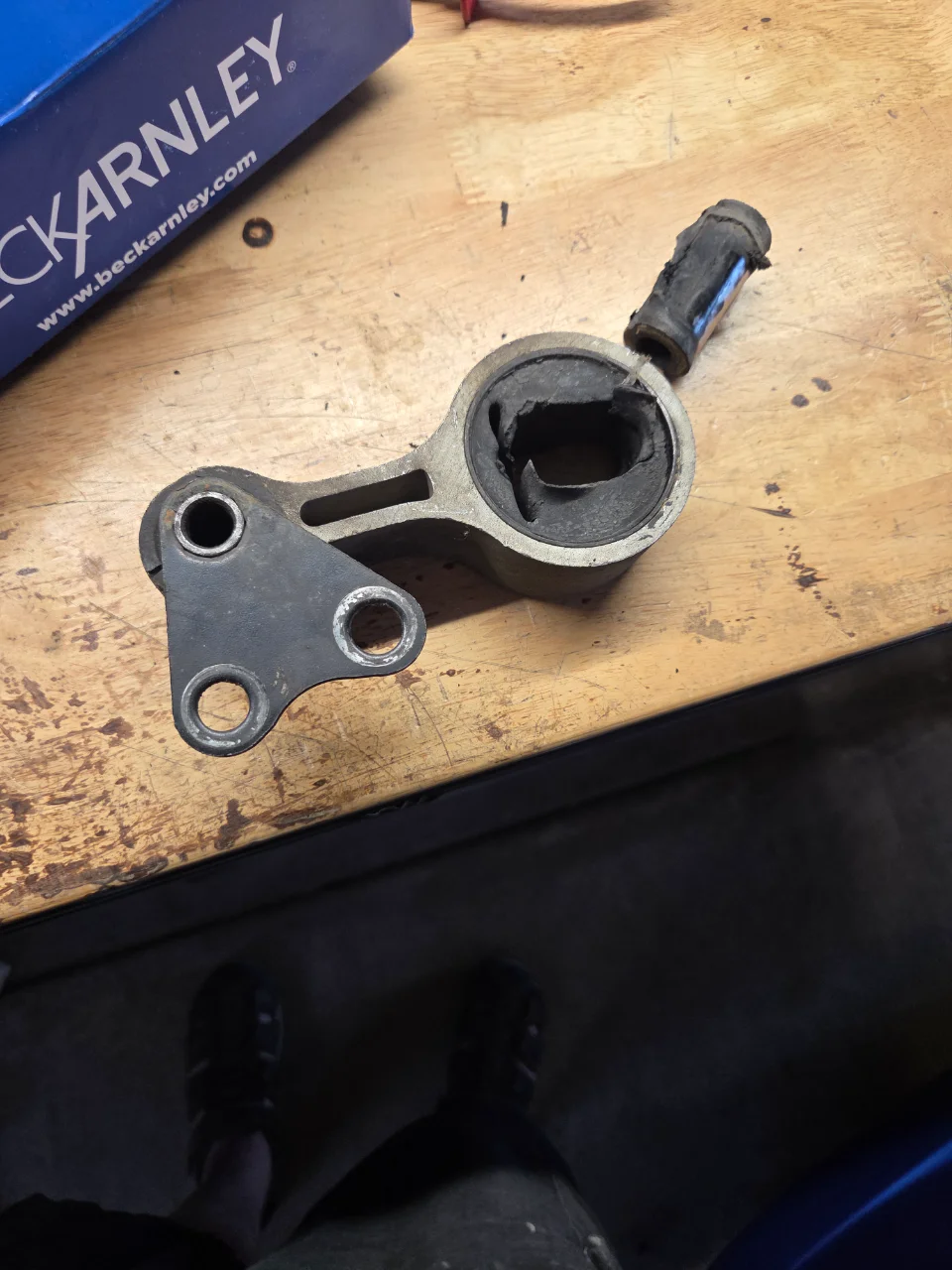

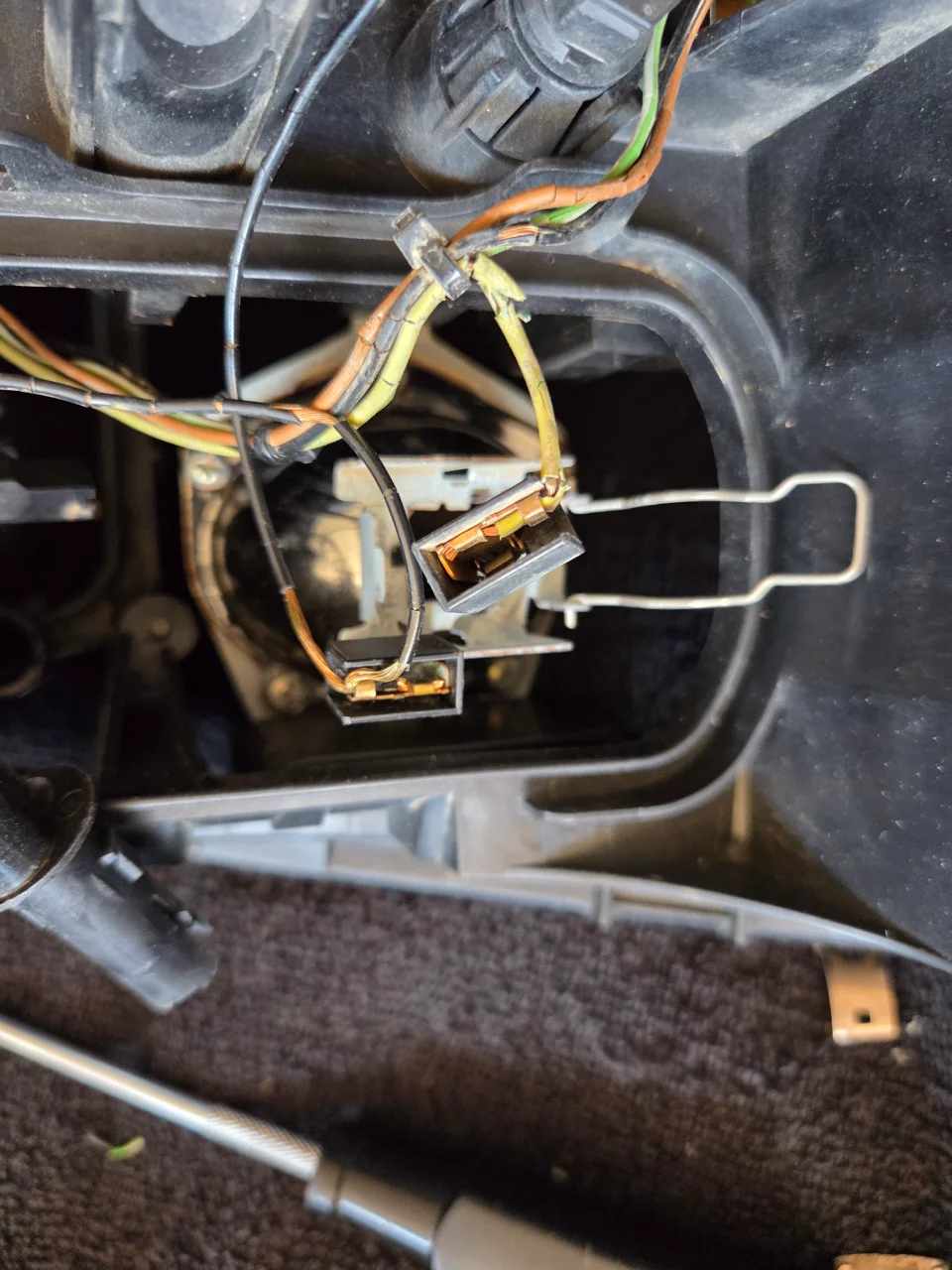

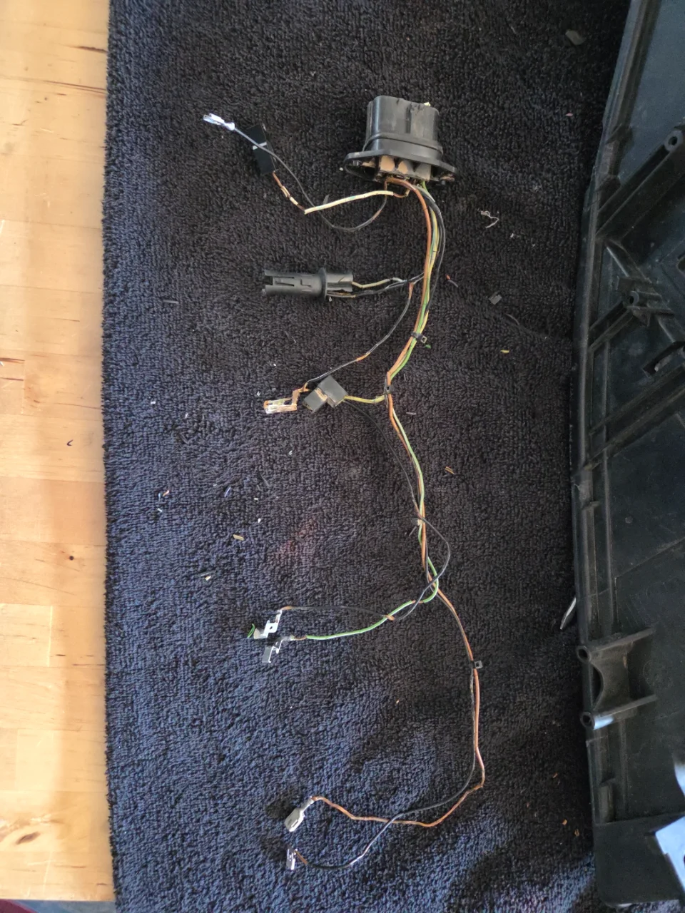

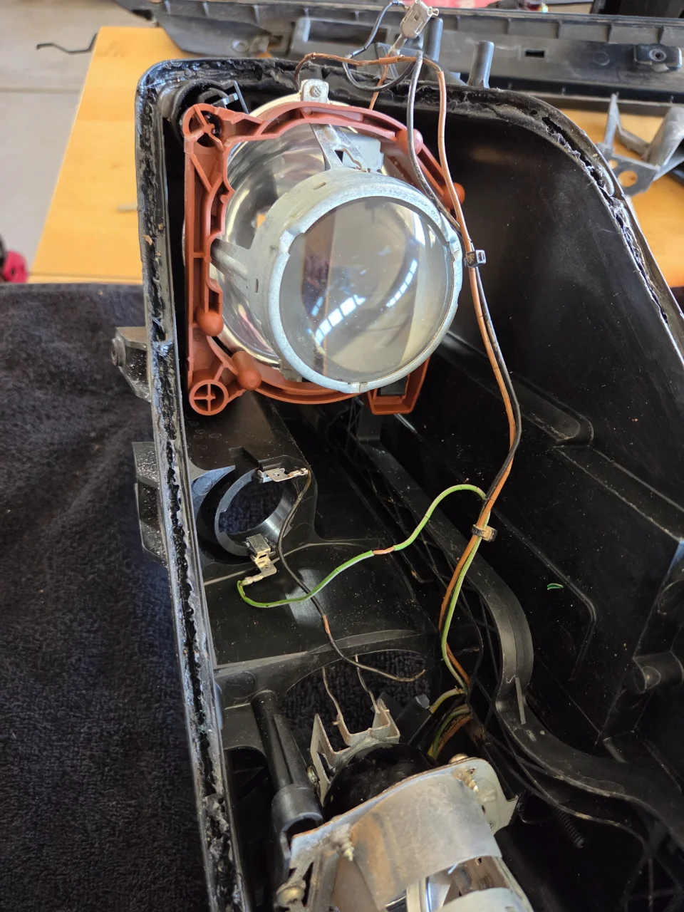

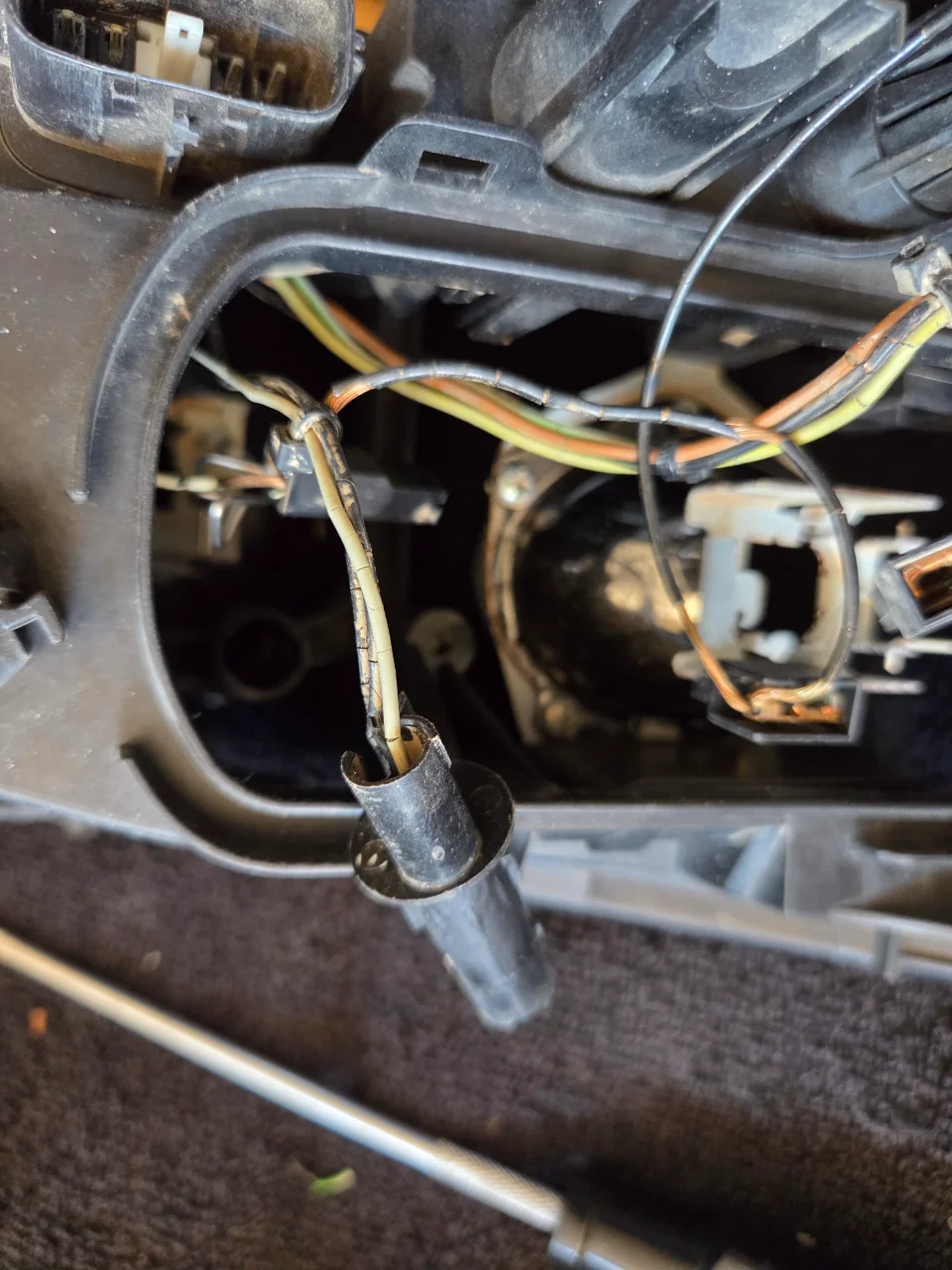

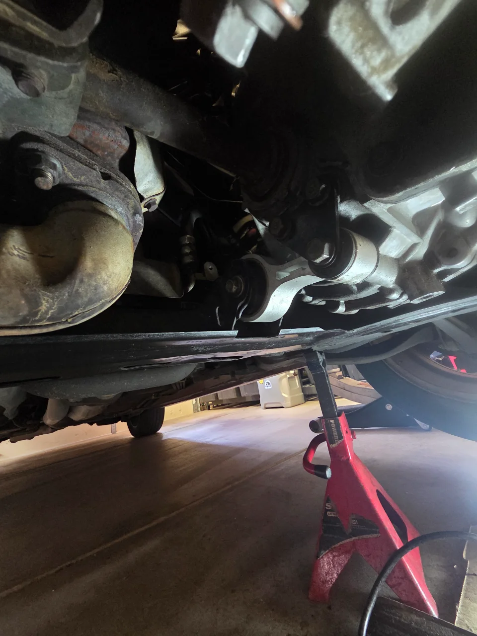

New dogbone in, this is what the old one looked like. Also started messing with the headlights. The lenses can be saved, but when I looked to change the bulbs, I saw the wiring inside the assemblies was total crap. Destroyed by years of heat, the insulation is cracked and coming off many of the wires all the way back to the single plug. Got the harness out and thought of rebuilding, until I found them online. $25 is much better than hours of frustration trying to rebuild tiny wires and connectors

Yeah those wires are toast.
Literally. 😂
A little bit of duct tape and they'd have been fine. 😁
That dog bone looked pretty bad.

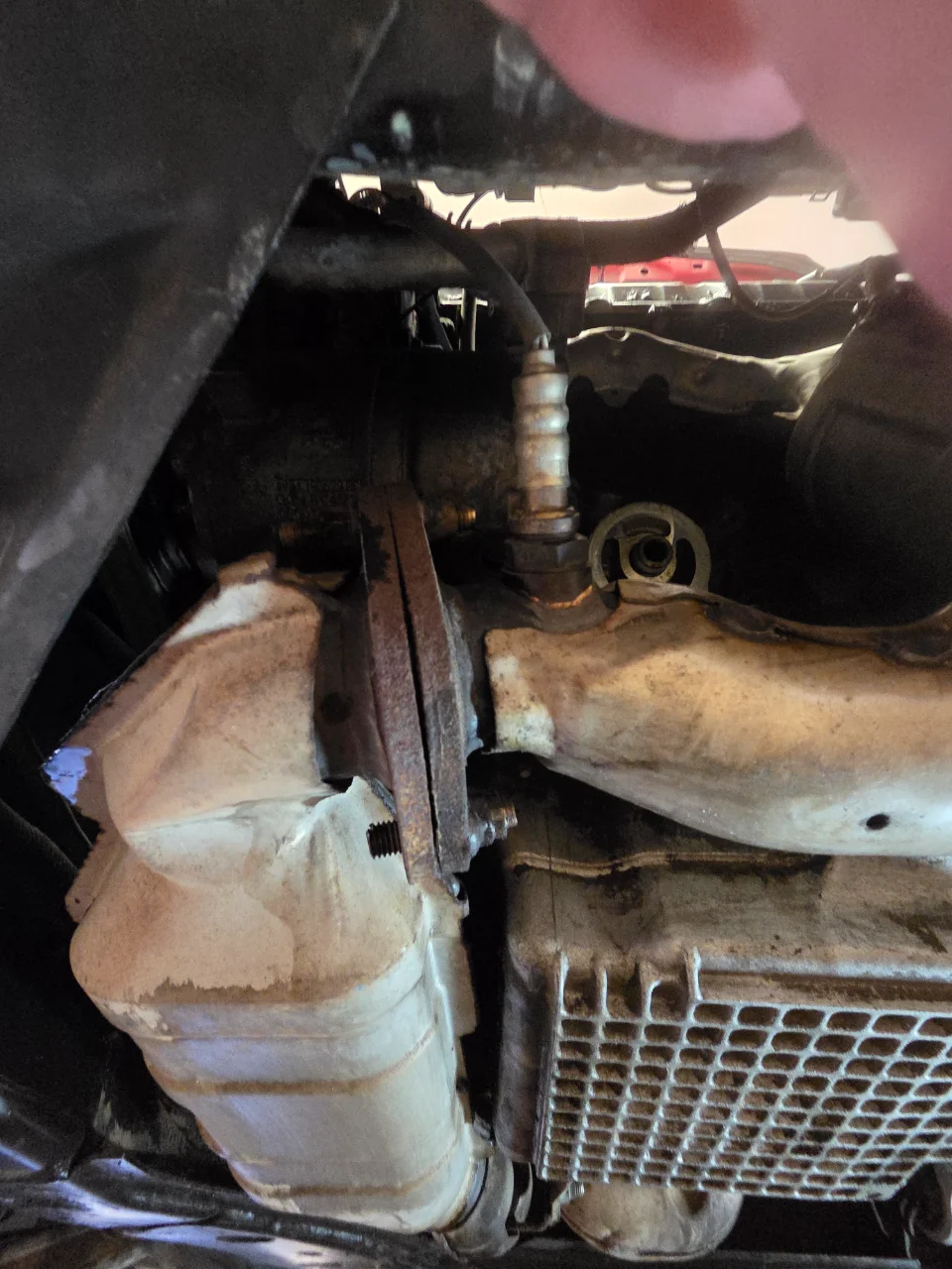

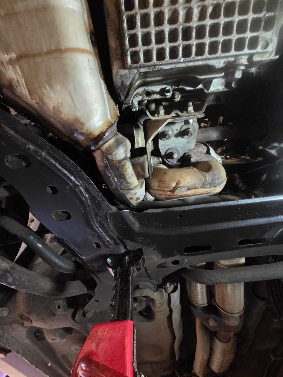

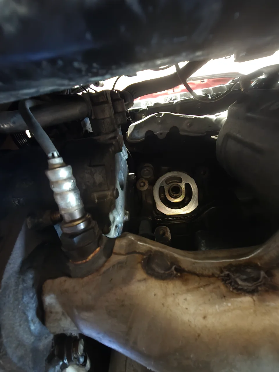

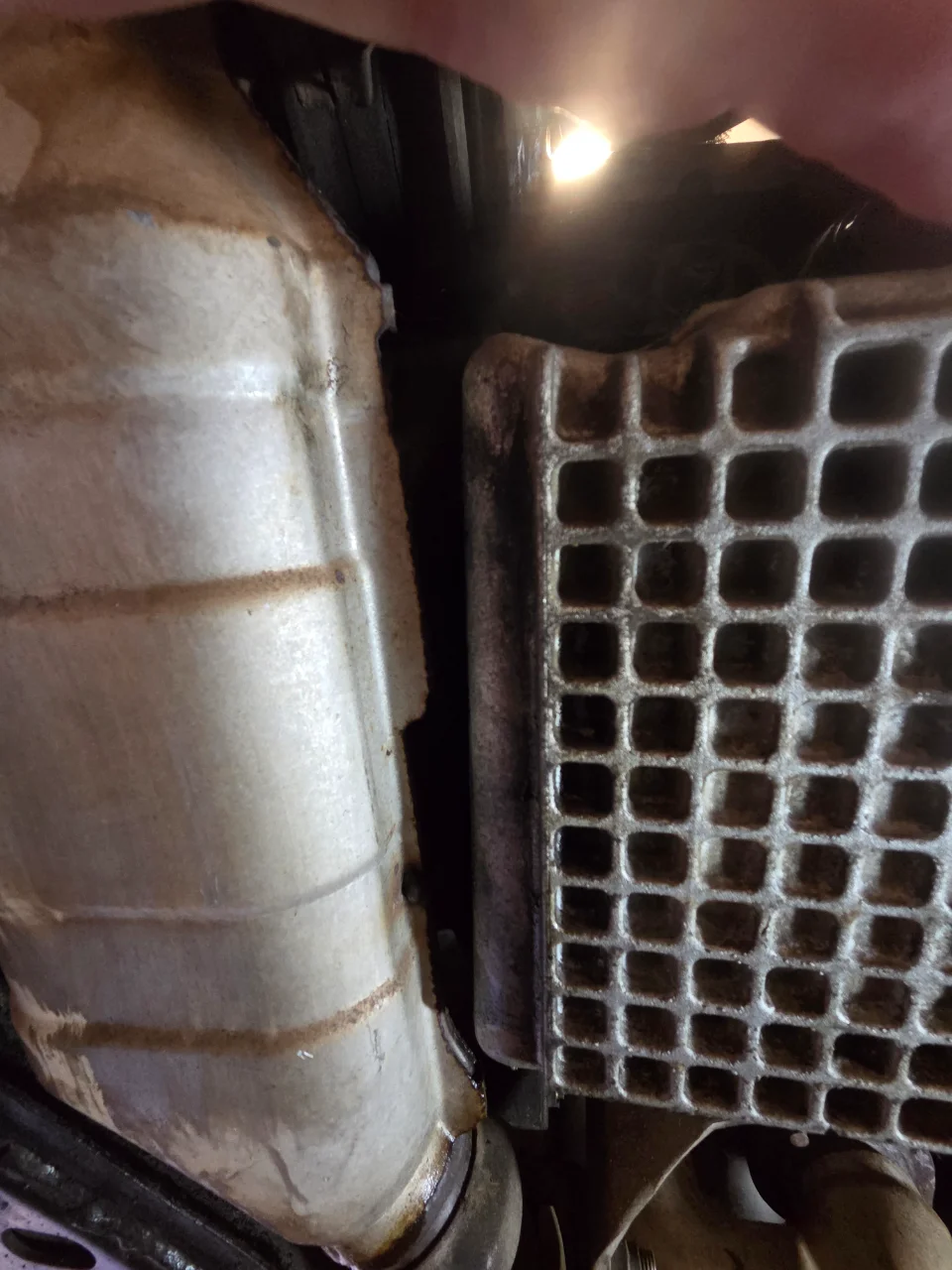

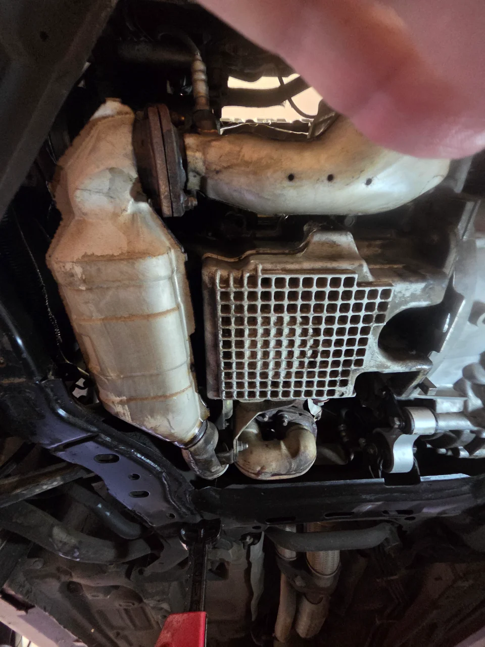

Well, the oil pan gasket job didn't go as planned. I had watched a video that showed it to be very accessible and easy to remove. However, the gentlemen already had the front exhaust manifold/second cat removed. It runs under, and very tight, to the front of the oil pan. It is a lot of work to get out, more than my sore body wanted to do for the day. I cleaned what I could underneath, drained the oil, found the oil filter loose (hopefully the cause of most of the leaking) put a new one on, and filled it up again. Engine is running smooth (my son and I did a Seafoam treatment last weekend) and it seems to drive fairly well, despite still needing more attention to a variety of systems. Here are some pix of underneath, including the new dogbone I put in a few weeks ago.

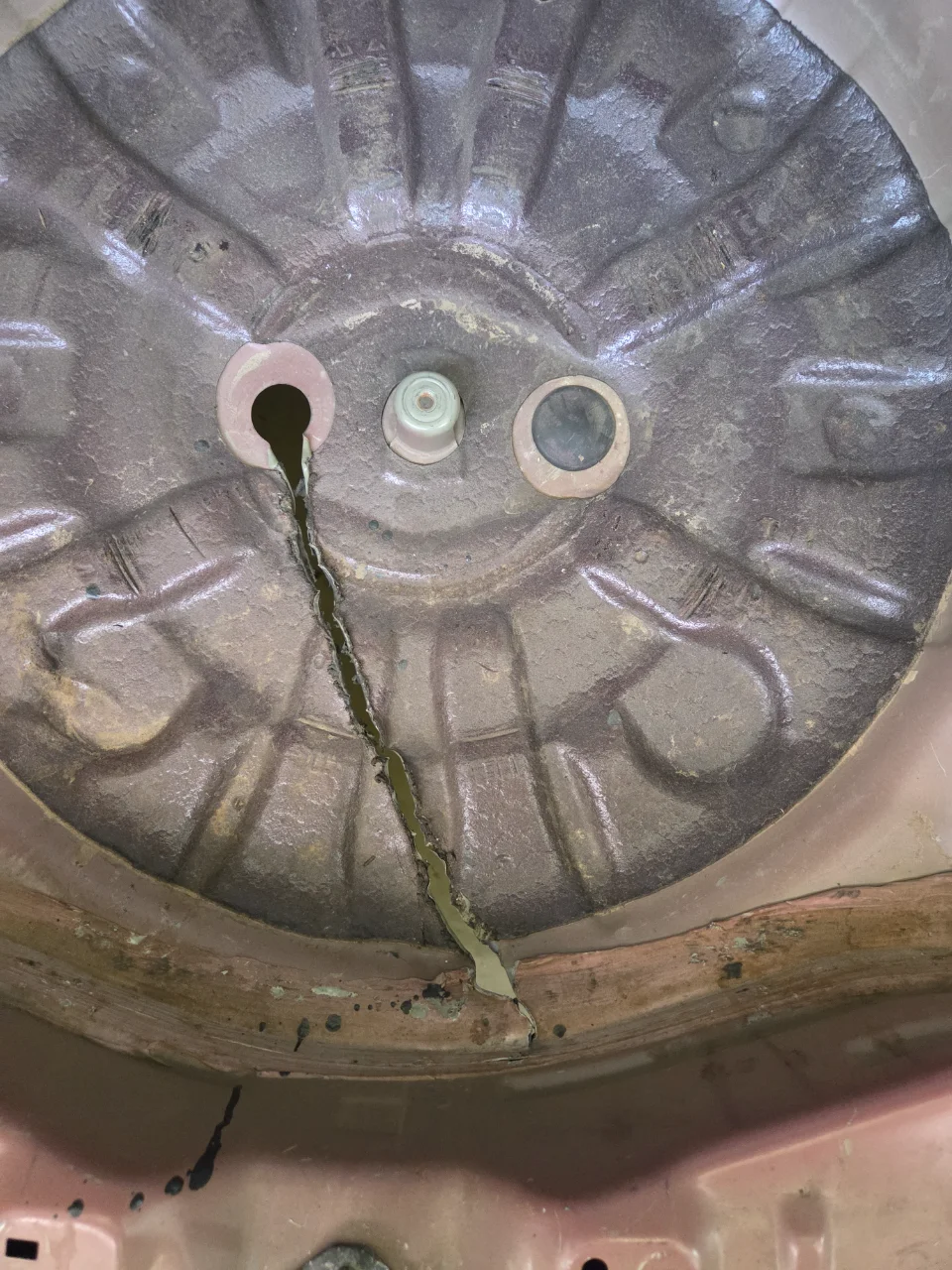

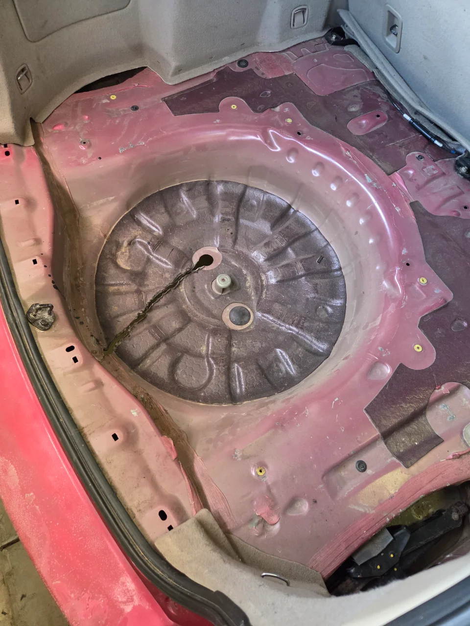

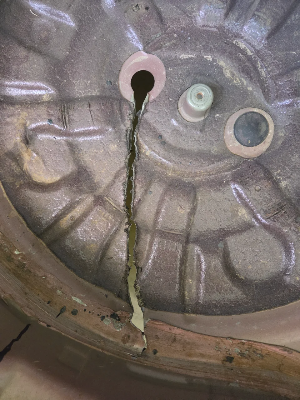

This is a peculiar situation in the spare tire well. I have to assume the car was stuck at some point in its life and someone thought to attach a tow chain hook in one of the drain holes in the spare tire well. I don't believe it went well. I am contemplating how to fix this. Anyone with ideas?

Nice fingers in the photos. 😂😉
Don't feel bad I do the same on occasions. 🫣
Not the best flowing setup Mazda could've made from the looks of it. 😏
Fiberglassing it or hammering out the metal flat again to have welded closed again would be my two options. 👍
Will probably have to fiberglass it top and bottom. It curled the metal pretty good so flattening and welding may be out of question.

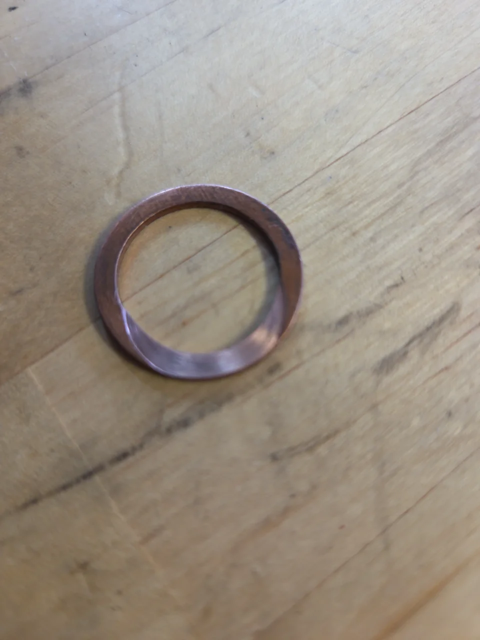

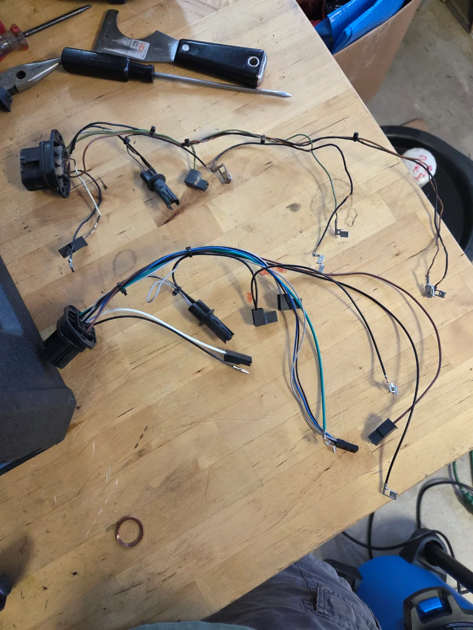

So, stoopid me. I reused the copper crush washer on the oil drain plug. Don't do that! Get a new one. Always. It started dripping immediately. See picture of the actual washer. That is why you don't reuse. New one is in and torqued to spec. Oh, and also, I got in the new inner headlight wiring harness. Old and new shown.
