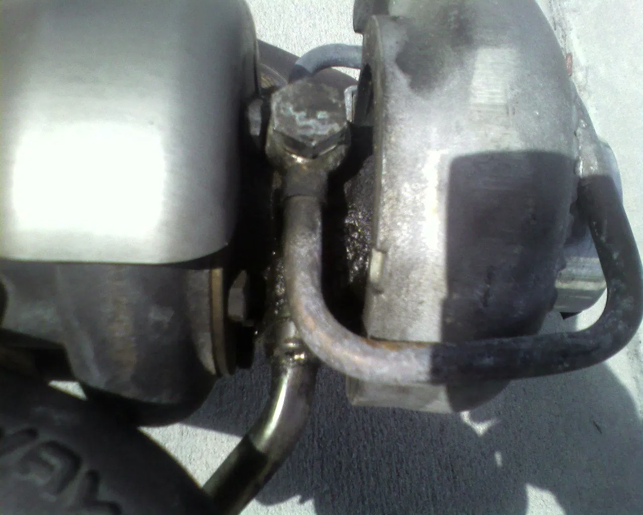

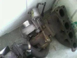

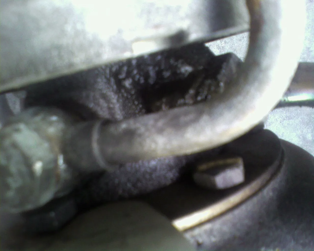

on another note i just got an msp heat shield, manifold and turbo in today. already had the j-pipe from the pro5 sitting around and connected. got some pics of the turbo and was wondering if i should be concerned with this oil on the inside of the turbo by the flange.

nah, mine had that too, on the first start up it should burn off and u'll be good
when i painted mine i put it in the oven and it burned for a good 10 minutes until it stopped
EDIT: oh and if ur using the stock oil lines, looks like you are, your going to need the msp crank girdle, or our going to need to tap your stock one if u want to use the stock oil drain
most people just take an aftermarket one and drain to the oil pan

whats that??(boom03) i am not sure what i am going to be using. i just bought the turbo, turbo manifold and s pipe from another forum member and they just got here today. every thing else looks fine including the turbo. it seems to spin fine with no play

its the part that goes underneath the crankshaft and it supplies the oil to the crank pretty much, they sell it on PG, the reason u need it is because the stock protege crank girdles dont have the hole for where the stock oil drain hooks up

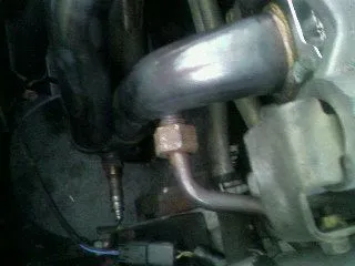

i see in the pic that u have the coolant lines, the gold metal tubes, but i cant really tell if u have the oil lines, jut go with a braided steel oil drain, u can use the stock oil feed but i think its rubber or silicone and braided would be the better way to go
yes callaway makes all the stock MSP turbo components
is this the oil what your turbo looks like?
the part with the silver heat wrap on it is the stock oil drain, if u take off your stock exhaust parts, or header idk what u have, ull see that there is nowhere for that to hook up to

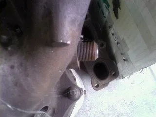

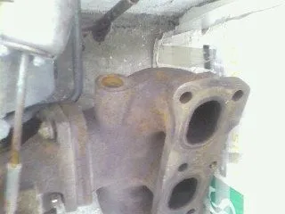

call me stupid but do you mean this thing that is poking out on the p5 header and the space in the msp that needs something to be screwed in. the last is the whole mani, turbo, s-pipe, and j-pipe section. i should just get all those those three line braided to connect huh?
no..the oil is not all over the header just by the turbo all collected and sh!t
ok so from the looks of it, the dude u bought the turbo from just straight cut the oil drain hose lol so your going to have to have a stainless,
and im not sure what you were asking about the p5 header and the msp but thats the egr that screws onto the p5 header lol a turbo is actually a really easy concept once u get how it works and were everything goes
edit: saw your response and thats good that u dont have oil and stuff all over your turbo, just tighten the oil lines maybe add some thread locker and you'll be set
