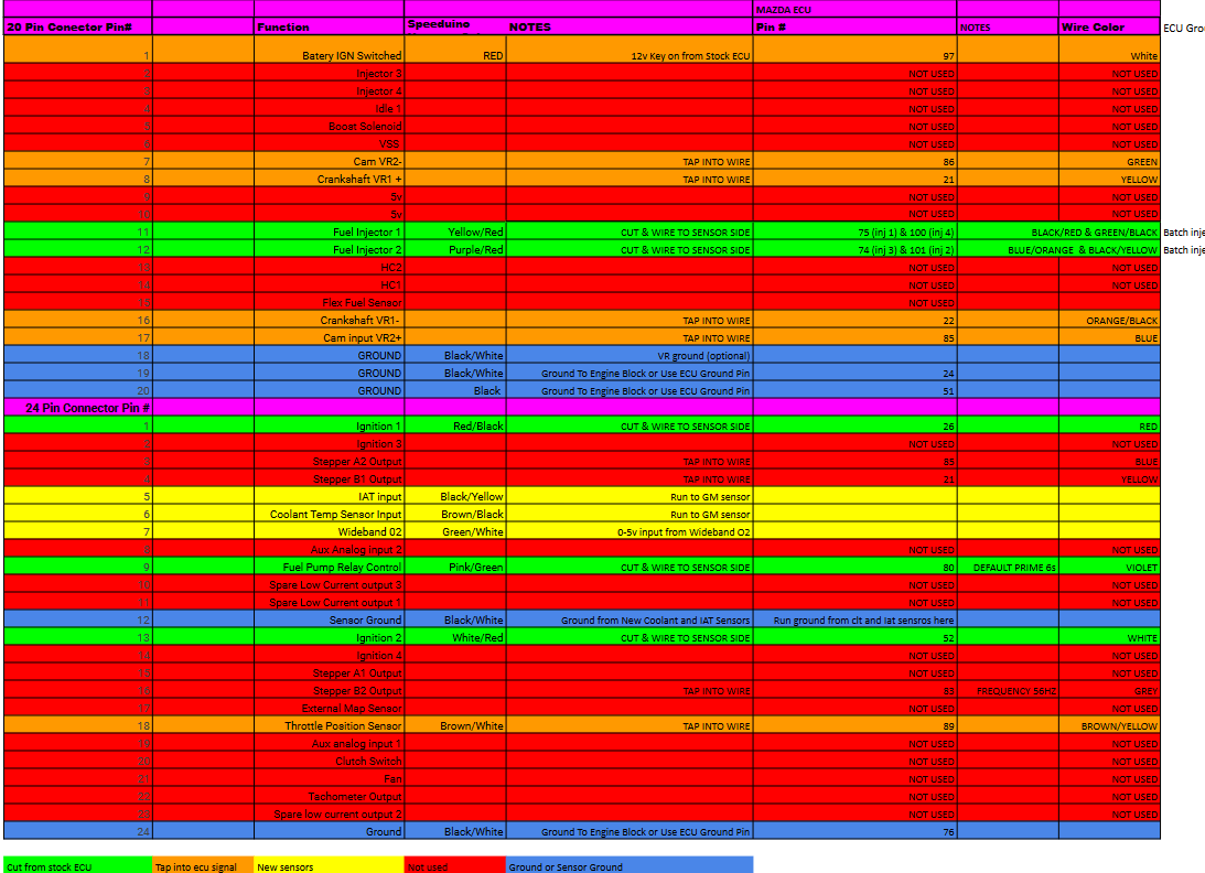

here is the wiring diagram for it to run in piggyback.

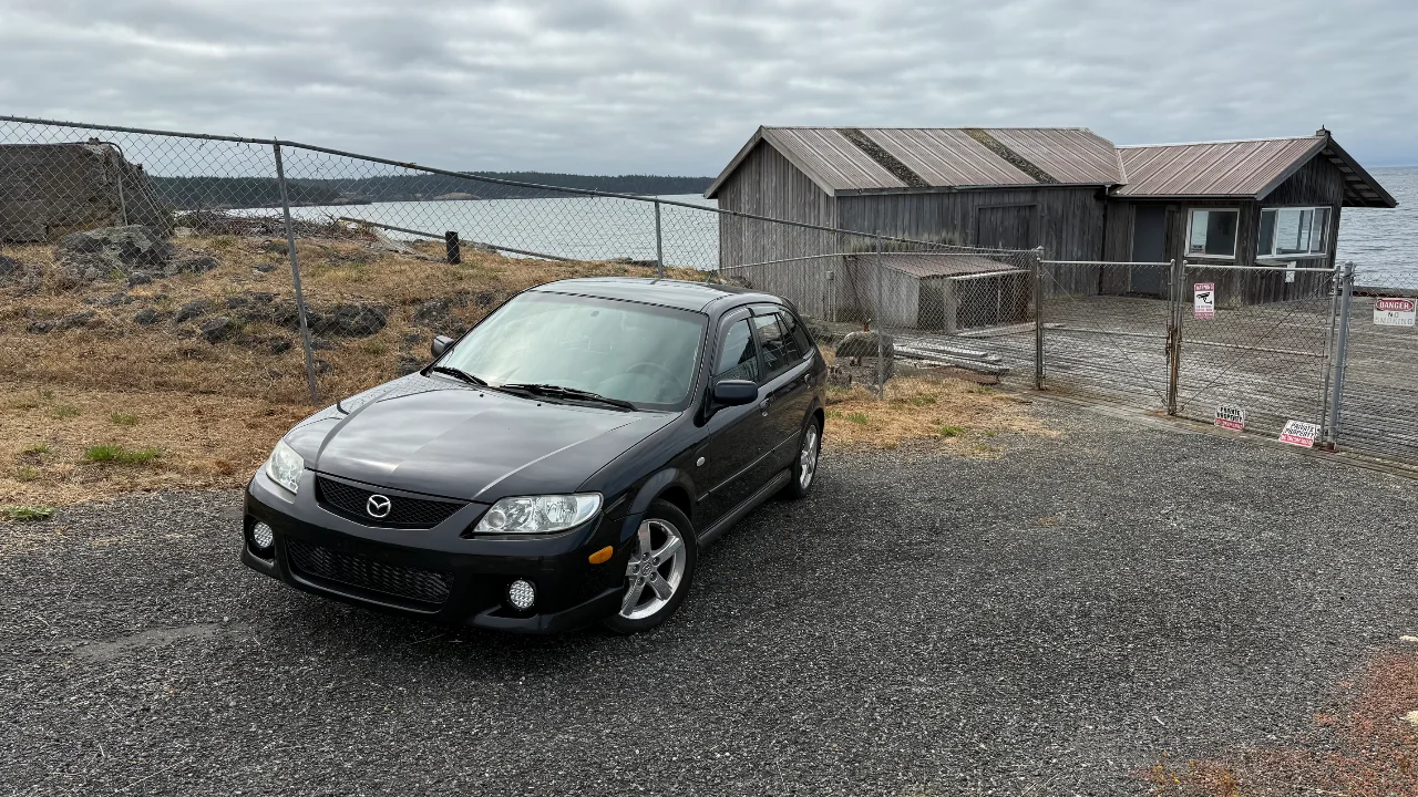

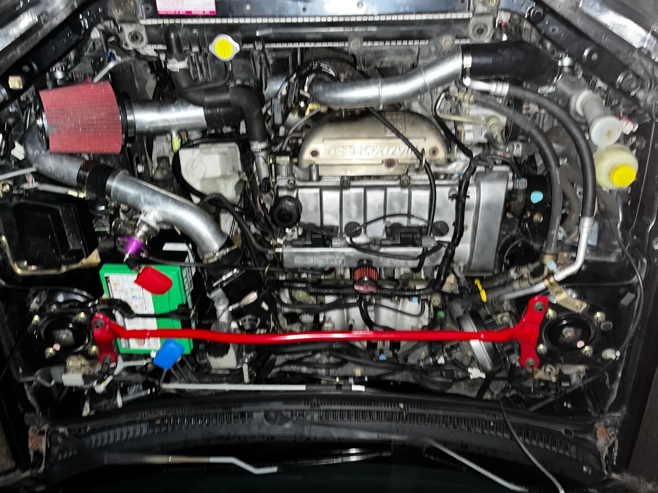

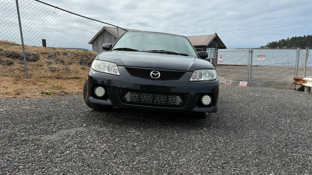

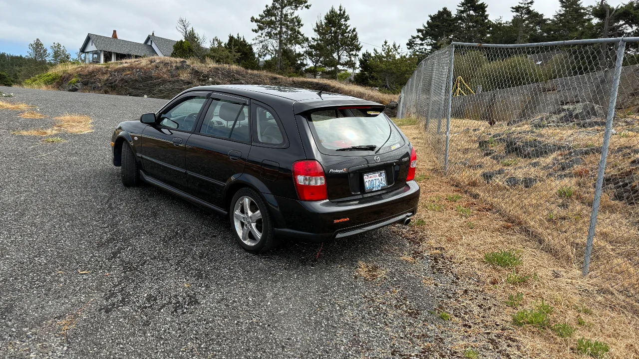

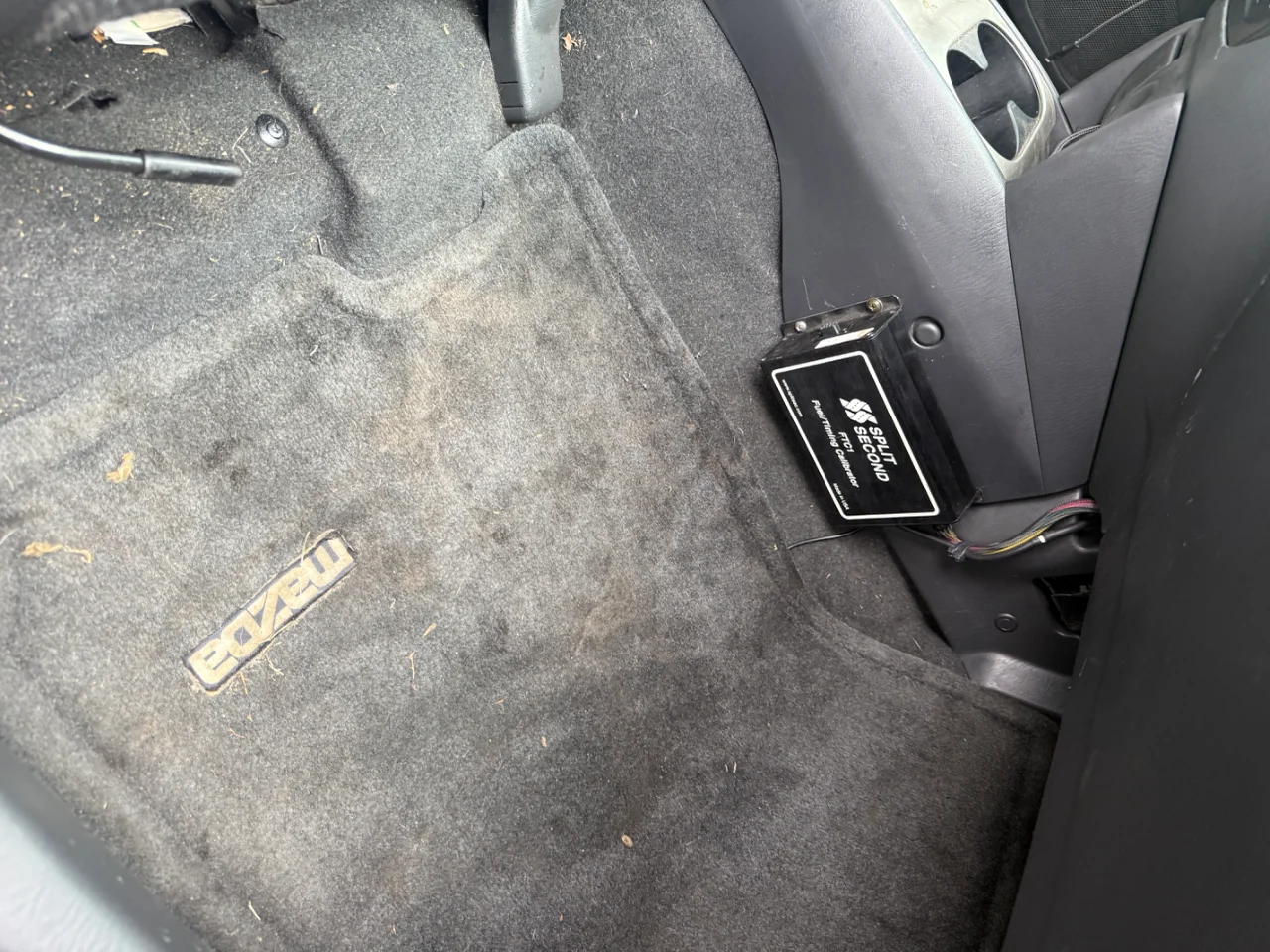

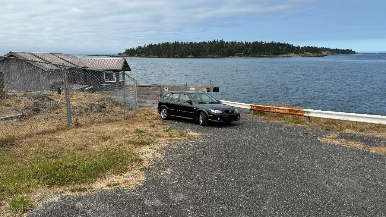

I have an update: car is running well with 5 psi of boost. I recently installed a split second FTC to retard the timing by a few degrees and added a lentech valve body. It shifts like a dream under boost and the ATF is still bright red after 3000 miles of driving. I added a corksport radiator which necessitated an external transmission cooler. Do this even if you don’t have an aftermarket radiator because the stock cooler is literally just a tube that comes through the bottom of the radiator. I need to add 440cc injectors due to the stock ecu becoming unhappy at higher maf voltages. Here’s some pics and feel free to ask questions!
