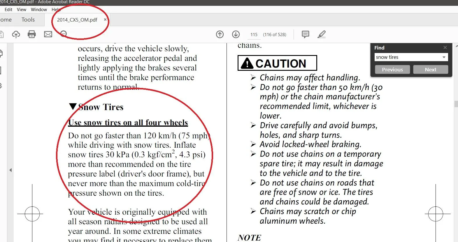

Thanks. Must be new info for the 18s. It's not in the 17 manual. Not even a mention of running 17"s [except Mexico], or anything about snow tires at all.
I asked because it sounds strange to me. Why would one run them so much higher? Maybe they're thinking that 17's are in a sort of high load situation? I don't get it. Any ideas?
Where did you find that recommendation?
It was mentioned to me on another thread. I looked high and low in the owners manual but finally found it (for my 2018) on page 3-54 "Winter Driving" where it says under the topic of "Snow Tires" : ..."Inflate snow tires 30 kPa(0.3 kgf/cm2, 4.3 psi more than recommended on the tire pressure label (driver's door frame), but never more than the maximum cold-tire pressure shown on the tires."
Been in every manual since at least 2014....
attachment.php
Thanks kdaug and madar for the references. I stand corrected.
