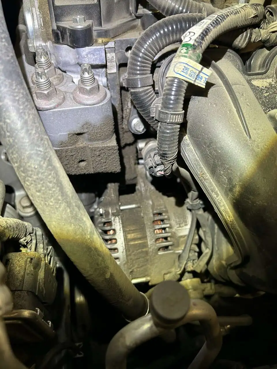

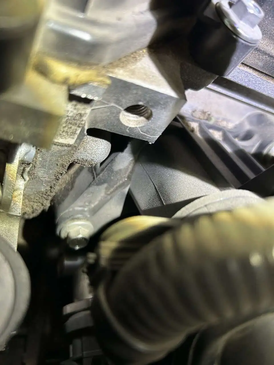

Source of oil leak? 2017 CX-5
Where would you say the source of this oil leak is? 2017 skyactiv with 85k miles

You'll want to clean the whole engine compartment up with some foamy engine degreaser and go from there.
IMHO, a person should regularly clean the engine compartment a couple of times a year as needed.
+1 on cleaning things up to pin down to valve cover, timing cover, tensioner, or something else
Once you clean up… you could use a light coating of talcum powder if you think it will still be hard to pinpoint the leak
My guess is the timing chain cover leak. It’s a common problem for the 2.5L NA due to the unique 2-piece cylinder block design IMO. Clean the engine first to confirm like others suggested. But I wouldn’t bother to fix it unless the leak from timing chain cover is substantially significant.
