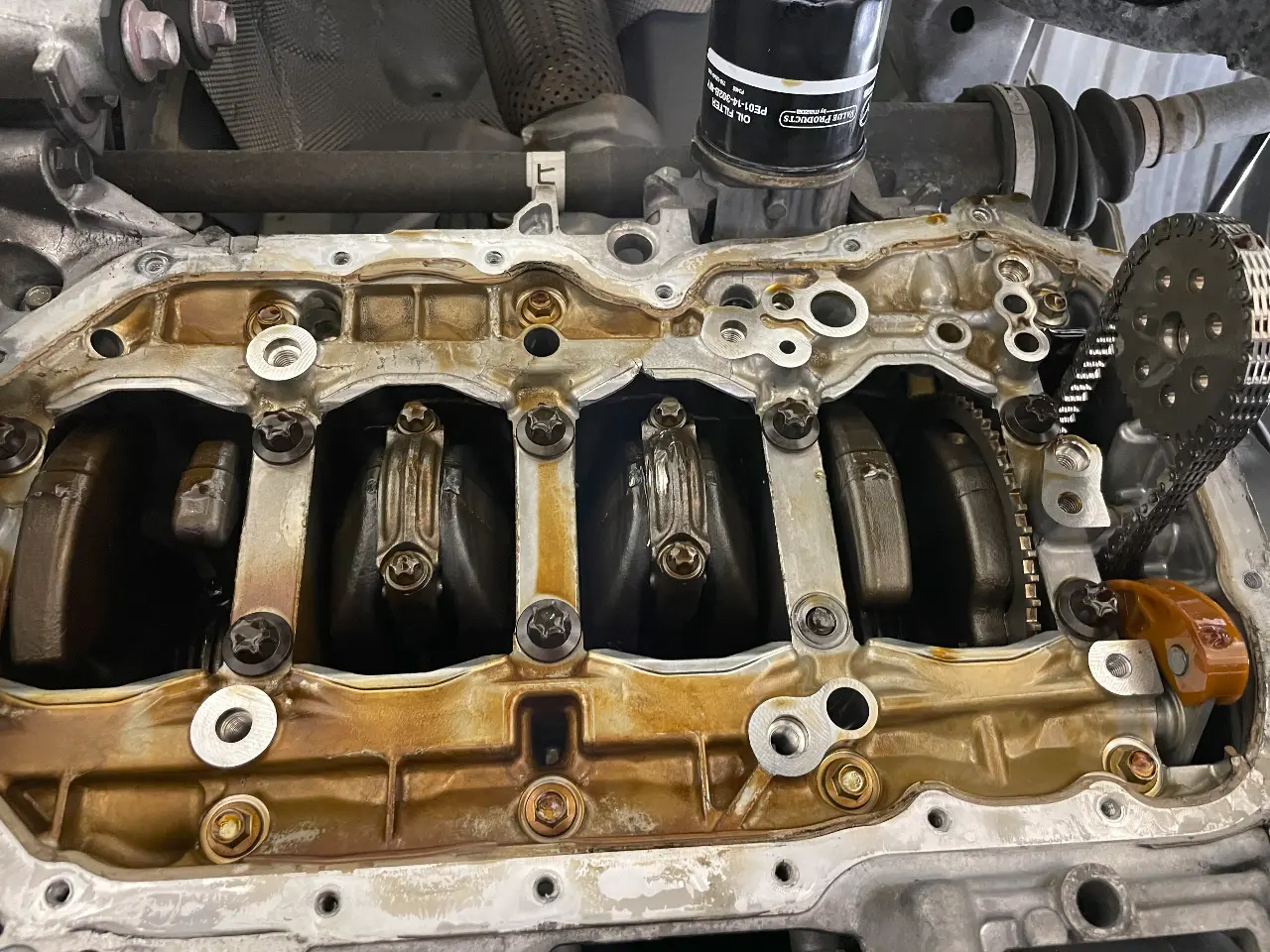

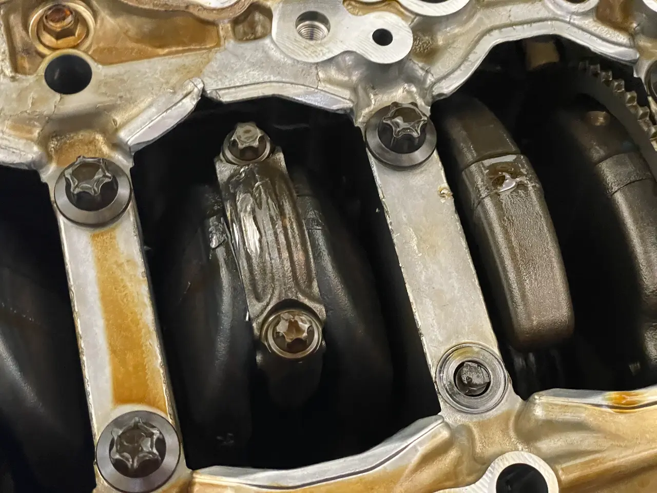

2017 CX-5 2.5L Crank No Start issue
From the dealer today:
"Engine - Long Block: Upon removing camshaft sensor, found metallic debris present on sensor magnet. Sent borescope through sensor mounting location and found several teeth ground off of cam gear due to improper lubrication. Vehicle unable to start due to timing issue caused by damage to gear. Engine replacement necessary due to high likelihood of metal chunks traveling through oil passageways. Service includes all necessary gaskets and fluids, as well as belt tensioner, water pump, and spark plug replacement due to mileage. Several components will be transferred from existing engine..."
Quote to replace is $8,446.30. I can only think that I must have not replaced enough oil when i did the change a thousand or two miles ago. Must be the lower cam gear because the top ones looked fine. There is no way around an engine replacement in this case? It doesn't make sense to drop that cash on it when it is only worth 10-13k. My options are probably to pay someone to rebuild and replace OR go with a new engine. I'm not sure what to do, but the car is useless as it sits.
I had a feeling that is what happened... there's no "lower cam gear", there's a crank sensor gear in the crankshaft that got damaged/moved out of position from whatever came apart
how are they certain it was "improper lubrication" did they say/measure how much oil came out?

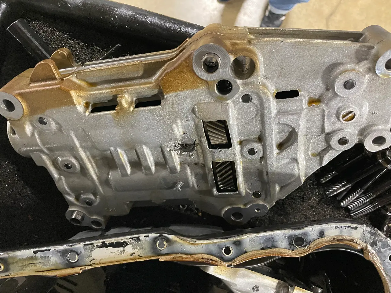

there was 2016 CX-5 at my dealer with the same "no start" issue you got... one of the crank bearing cap bolts sheared off, damaged the lower engine block, the balancer shaft unit, and possibly the crank sensor gear, 7 months ago... it wasn't a lubrication issue... don't know if it got fixed by the dealer or owner took it elsewhere, since that car had 140-160k miles on it (don't remember clearly)

Well, they are probably right. It was probably a quart low, but I had just changed the oil no more than 2000 miles ago. I have never had evidence of a leak so I don't really check between changes since I don't usually drive that car.... that's on me. But when I pulled the valve gasket a couple of weeks ago, one of the plugs was soaked in oil and the gasket had definitely been leaking into the plug hole.
What would you do if this was your car? I was thinking of pulling the engine myself and taking it somewhere but this generation CX-5 engine also has to be lowered out of the car, correct? I don't have a lift..
I feel so guilty, I must not have filled the oil enough after changing it last time. I just don't know what to do now. It doesn't seem like many owners have to go through this based on how hard it is to find info on rebuilding/removing these engines, so it is on me. I'm just not sure what to do now.
I feel so guilty, I must not have filled the oil enough after changing it last time. ...
No way "a quart low" would cause this. It would have to be nearly empty to cause an oil starvation issue and you would have low oil pressure warnings.
Maybe some debris or gunk or ?? blocked some oil passage or poor maintenance before you acquired the car has it sludged up 🤷‍♂️. Idunno what happened but a quart low didn't cause it. Don't beat yourself up.
The engine in our 2014 failed some years ago due to no oil. There was no evidence of leaks like oil on the ground, so I now think it was not filled after the last oil change. Also, there was no warning light or anything until the rod knock started :(

these engines MIGHT burn oil, depending on how you drive the car, and what kind of oil you used
like I said... did they say if it was low on oil? running out of oil or low oil usually gives you even more damage than what you saw.... the sensor "gear" doesn't get lubricated so the only reason why it'll get damaged is because of something that ran into it, such as a chunk of metal
the pics I posted clearly shows it wasn't lack of maintenance or low oil that caused the engine damage... it appears to be metal fatigue or some sort of stress that broke it... looking through the parts catalog, over the lifespan of the SkyActiv-G 2.5, I can see they revised the engine block 5 times, head once, the pistons and rings once, the balance shaft unit once... of those revisions, only the block and balancer shaft revisions went further after your engine was made for your 2017 model year... the last year of the changes that applies to your iteration of engine was in mid 2018... anything afterwards for the "same engine" was for the newer ones with cylinder deactiviation
Yeah dude, no way this was a quart low. My 2017 either leaks or is burning a little bit and I need to top up. I've had it to the middle and bottom of the dipstick. This motor was ran dry for a looooooooooooooooooong time. This reminds me to check my oil.
