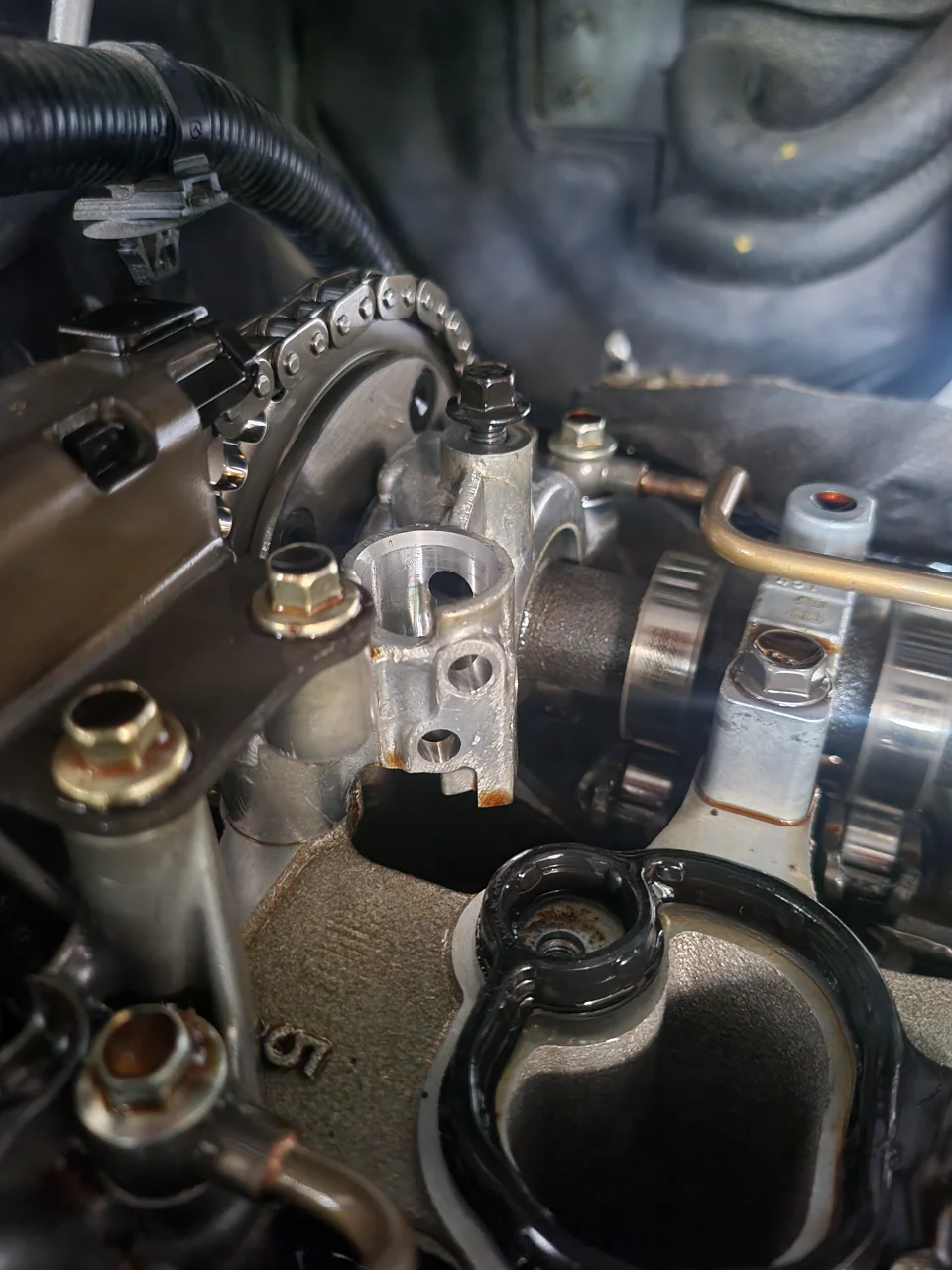

Today: ran to autozone to get the only crank sensor in stock. No improvement. At this point worried about timing maybe being off?? Pulled the valve cover to inspect. In doing so, I unfortunately broke the plastic on the VVT solenoid so I will replace that. Timing at TDC looks perfect with a tight chain and no visible wear on the guides, cams look good. There were a couple of scratches near the solenoid. I will post a picture if I can.
Unfortunately, I'm at the end of my expertise. I'm going to order and try OEM camshaft & crank sensors plus a new solenoid, at which point I have no more tricks.

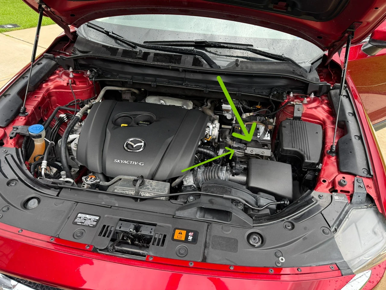

Wow, this is really an interesting situation! From what I've googled so far, it looks like there is a bad communication with the ECU. I would unplug the ECU connector, inspect the wiring and contact pins, maybe apply some Stabilant 22 and reconnect the connector to ECU. Then I would try to clear the codes and see what happens.
Thanks for the suggestion. While I have the valve cover off waiting for a new gasket and VVT solenoid, I won't be able to try starting it but I can definitely inspect. The ECU is the same as the "PCM" correct? I really think I may have some sort of electrical fault somewhere. Is there a way to basically factory reset the ECU?
I don't know how to reset the ECU and I believe only the dealership has the fancy tool to reset/reprogram, I am not even sure what exactly they do to it. Here's a picture of the ECU location.
Thank you! I was thinking this was it, but wanted to make sure. I pulled off both connectors and sprayed with contact cleaner. Reconnected and waiting for spark plugs, vvt solenoid, valve cover gasket (for a leak into spark plug hole), OEM crankshaft sensor. I'm doubtful these parts will fix it but I'll definitely give it a shot

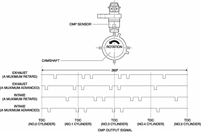

dont take my word for granted but it kind of looks like its the same type for both even though its 2 separate sensors.
Dont forget the O-ring as well.
You can also check the sensor out and check its voltage if you are good with electronics. Check wiring and connectors as well.
Sensor is magnetic and attracts metal crap, a good visual look after remov may also show whether its clean.
Usually they are simple sensors and not just die so easily.

* Output voltage varies with crankshaft rotation.
Fail-safe
Intake CMP sensor
DTC No.​
Fail-safe function​
P0340:00​
  • Set the electric variable valve timing control to the maximum cam retard mode.
Exhaust CMP sensor
DTC No.​
Fail-safe function​
P0365:00​
  • Stops the fuel injection.
  • Stops the ignition.
