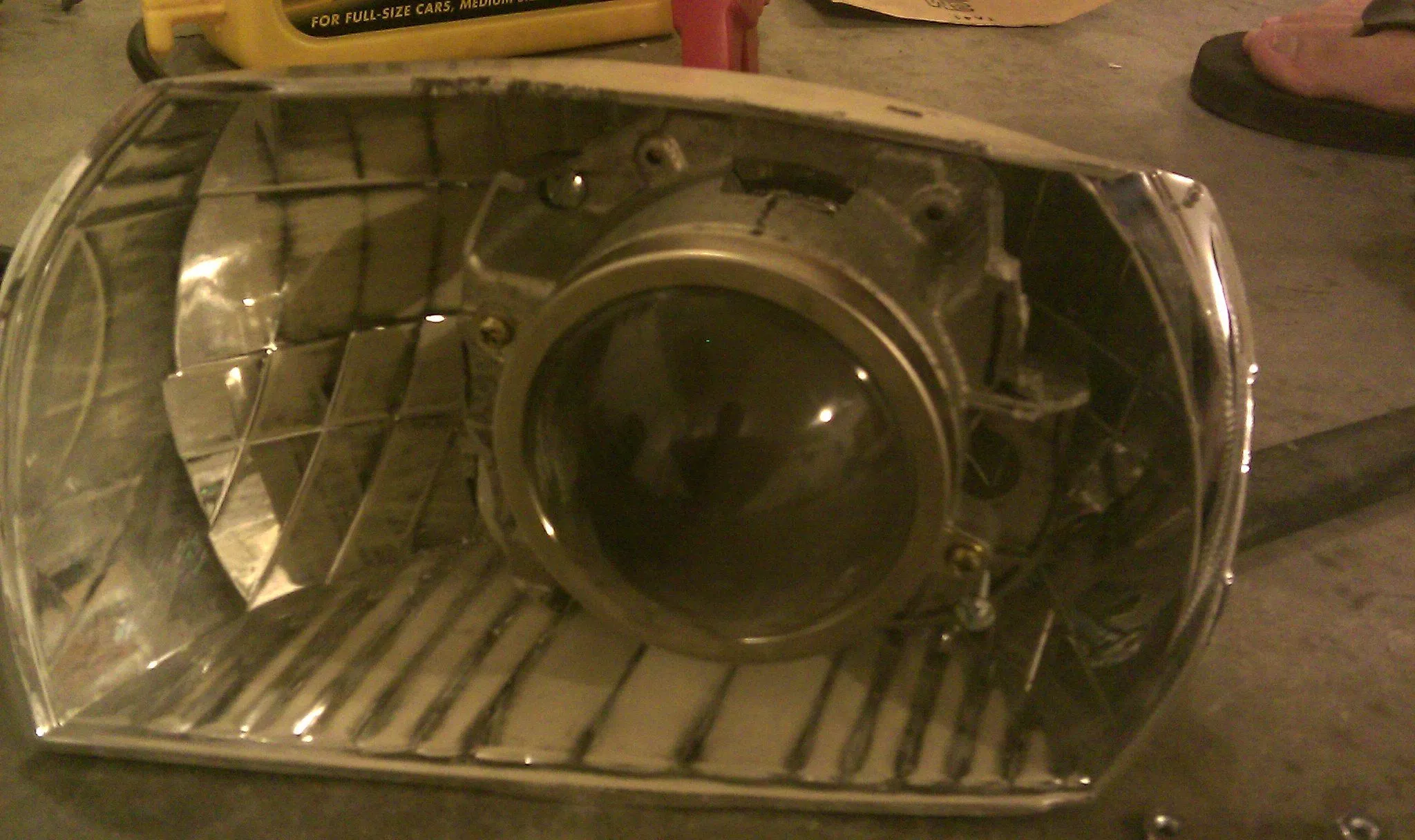

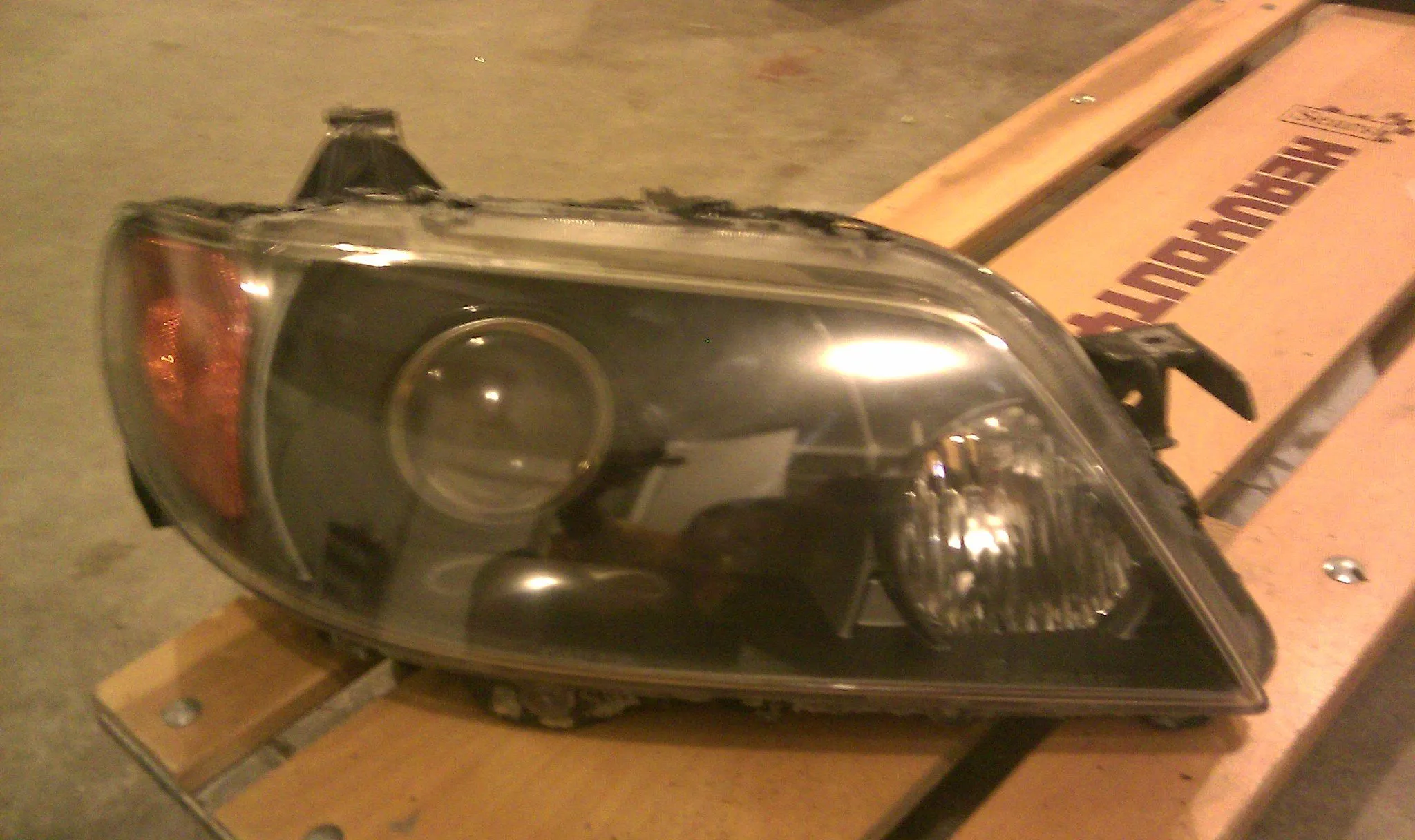

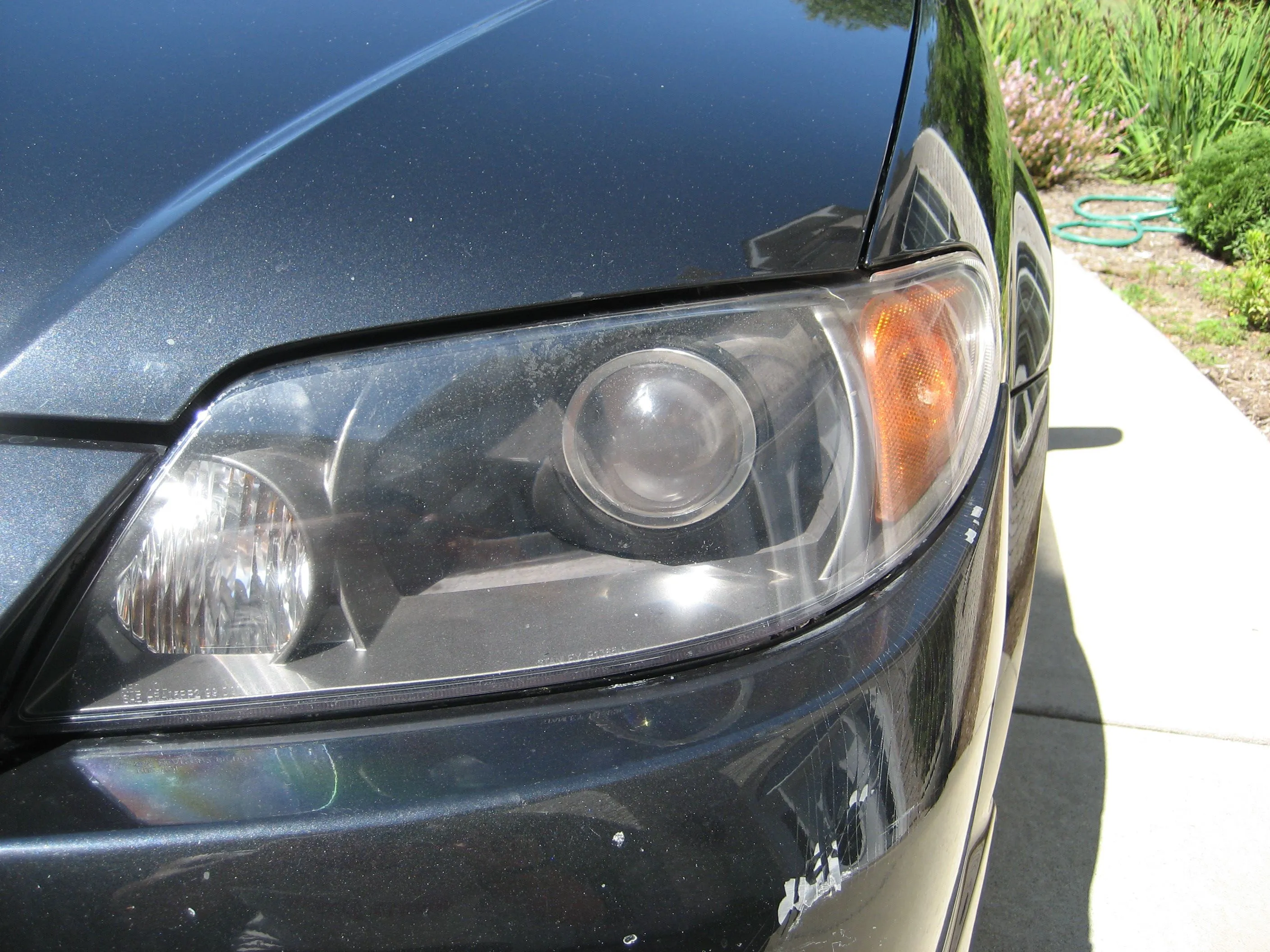

My friend and I have been workin on a Retrofit for my headlights, here are some pics of what we've got done so far.

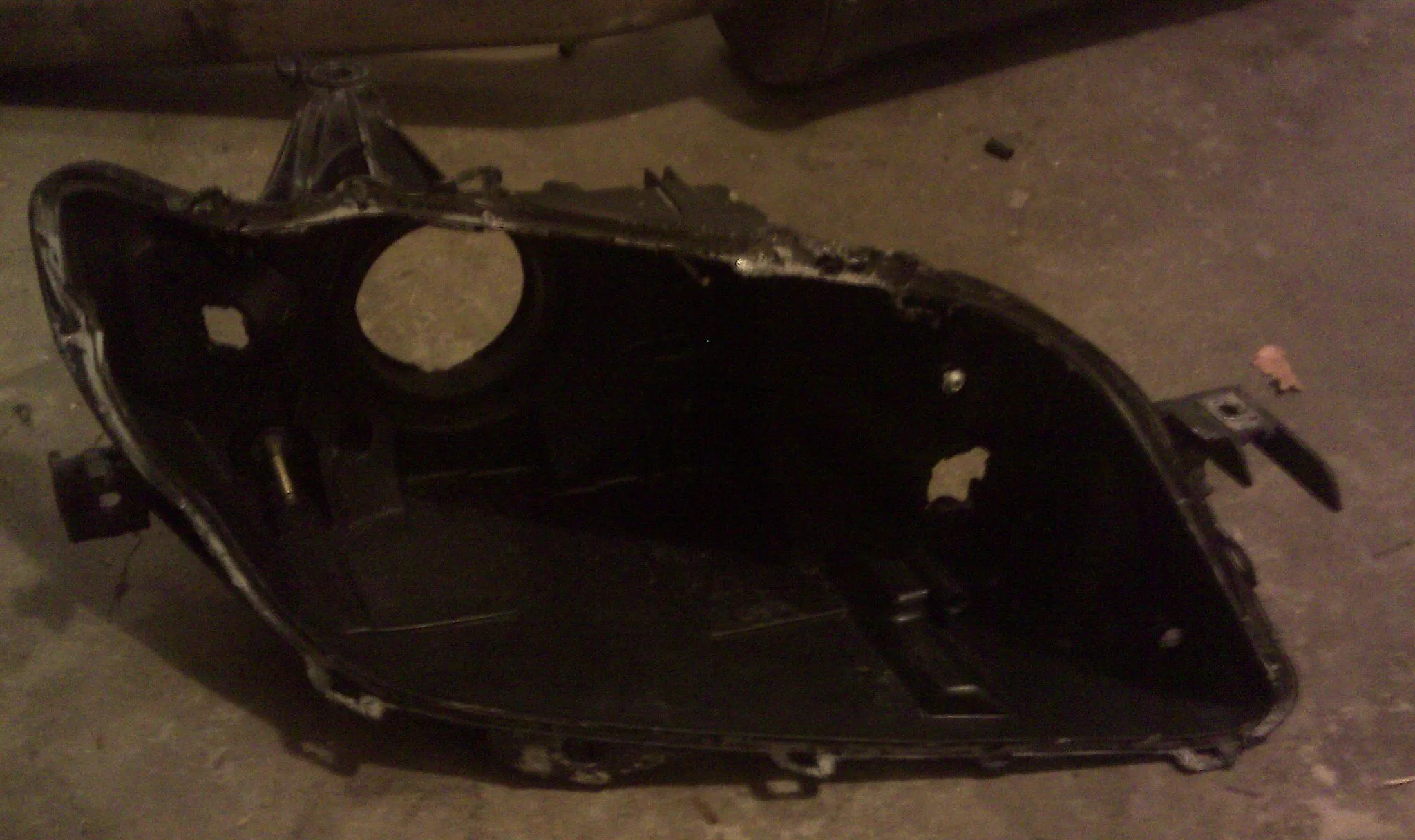

Here some of the cut off

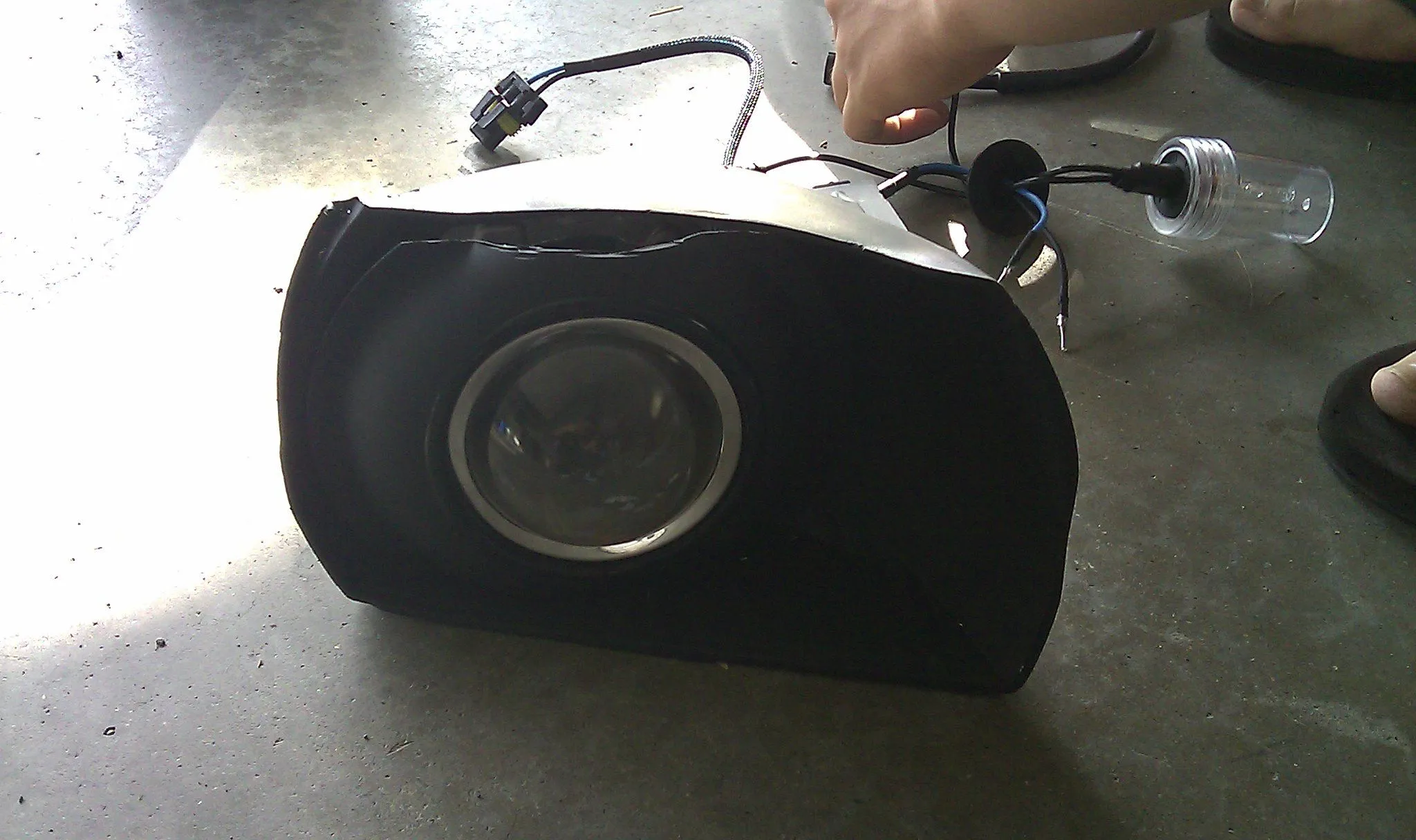

Im using GTO projectors. My friend had some laying around so he just let me use them. Ya its actually only 3 nut/bolts, there wasnt enough room for 4.
Should be sweet. Get some pics later on in the progress.

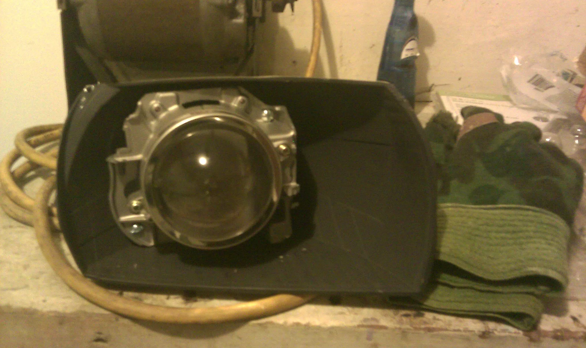

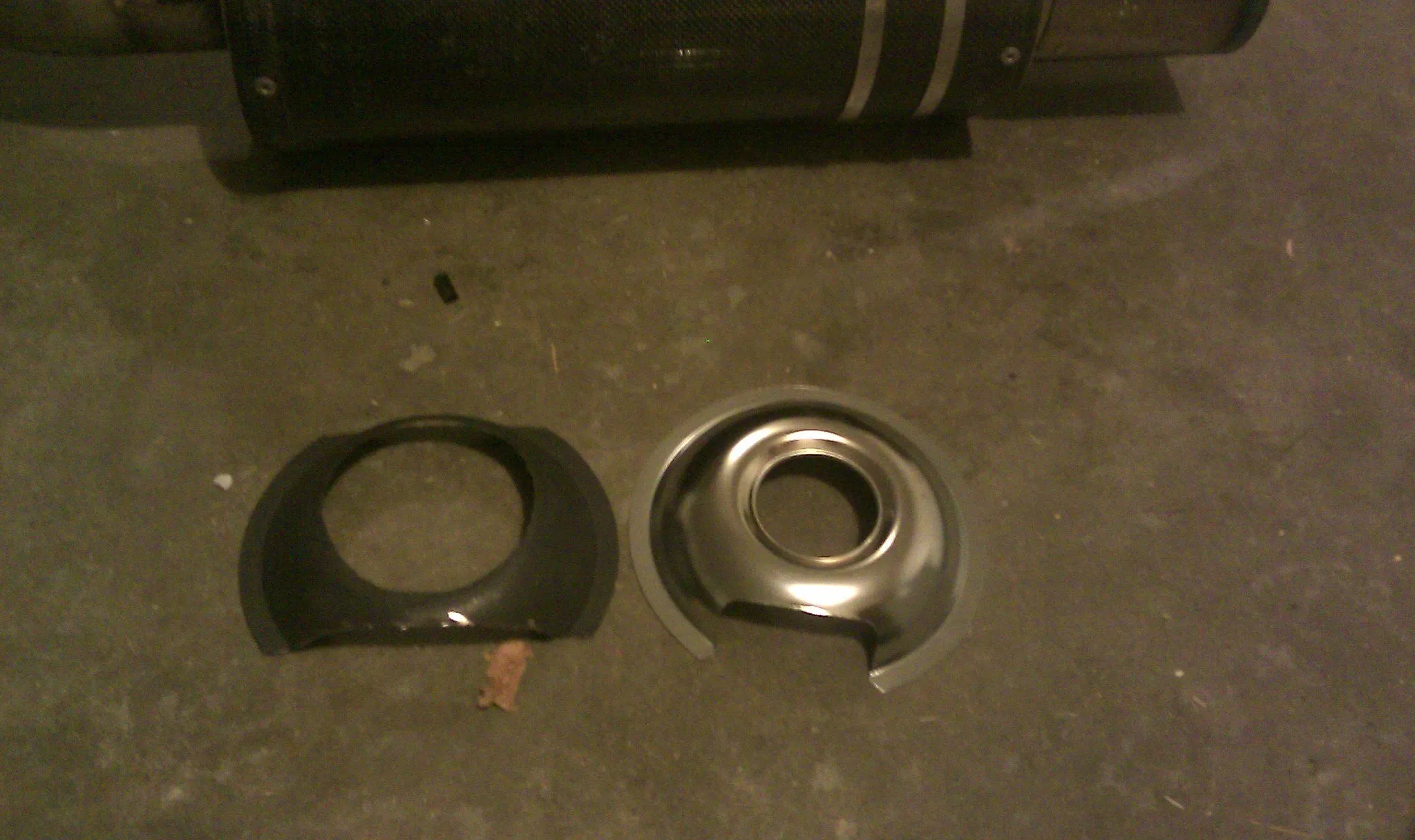

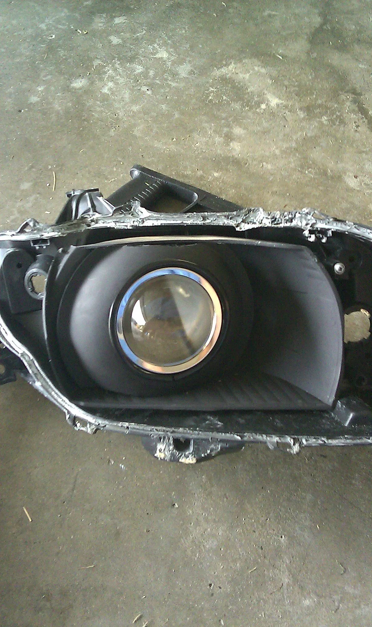

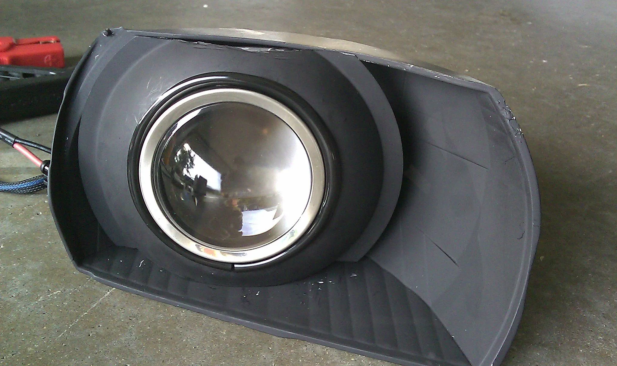

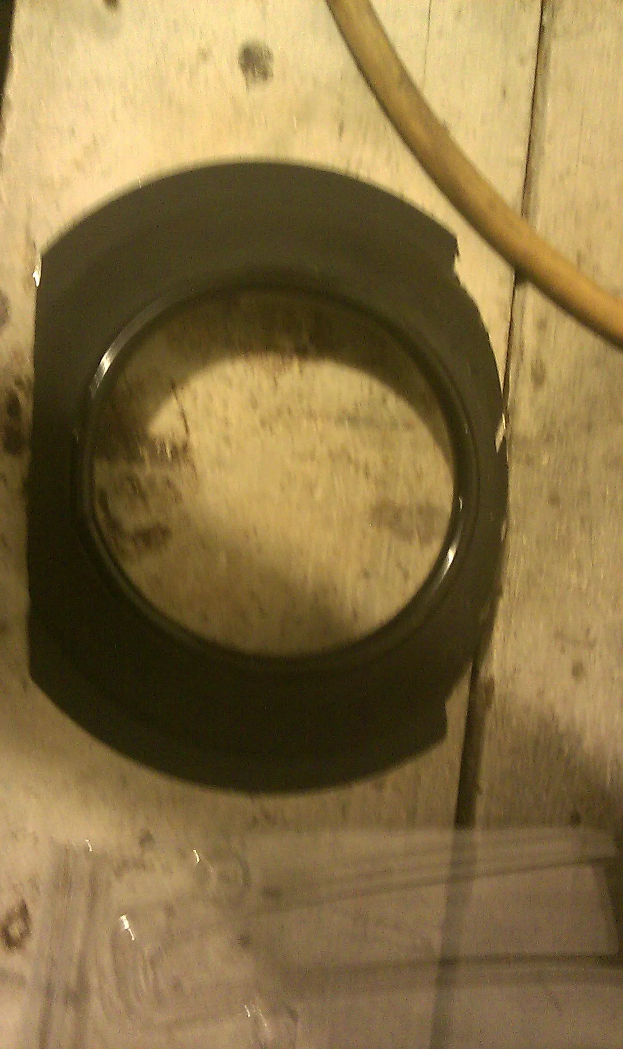

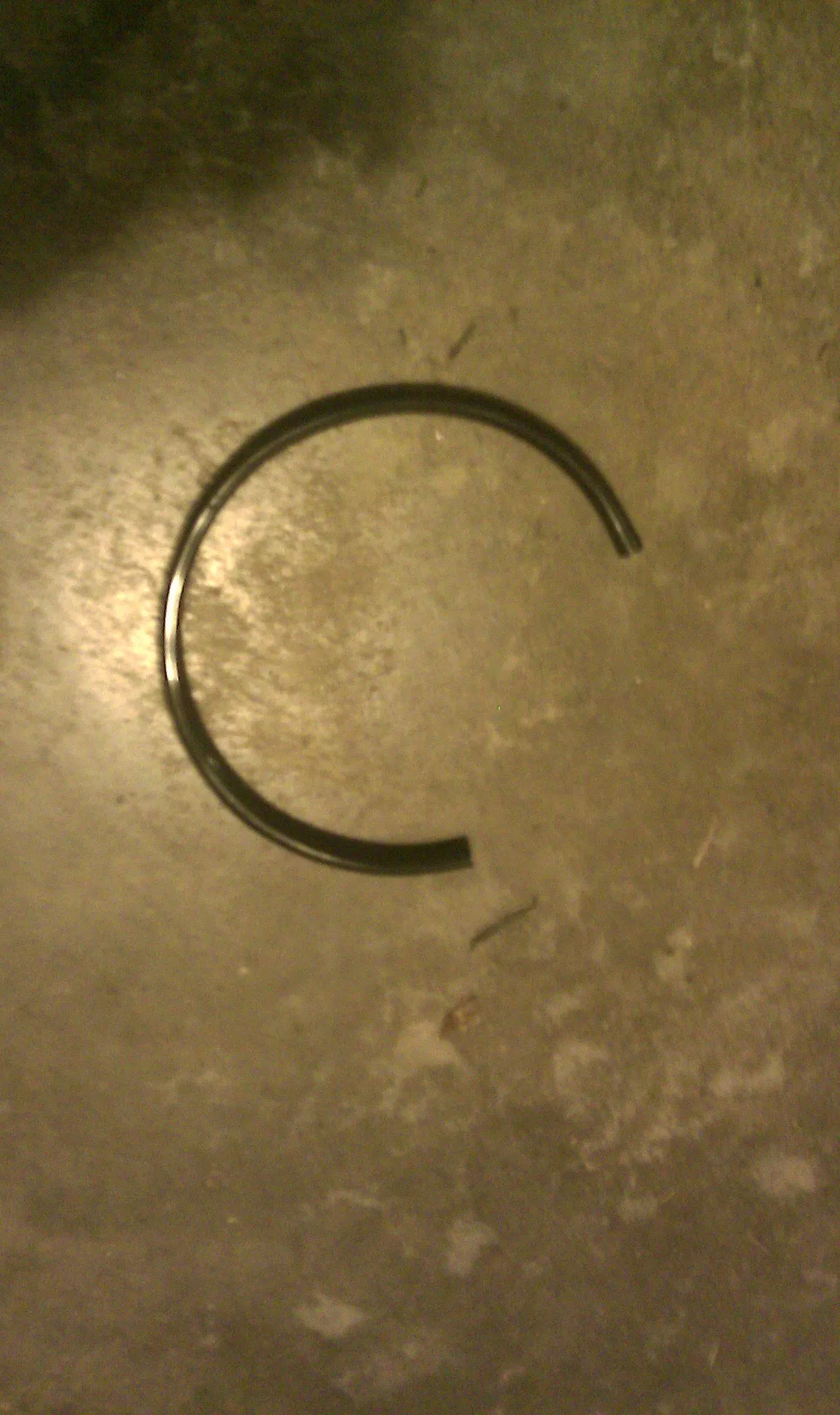

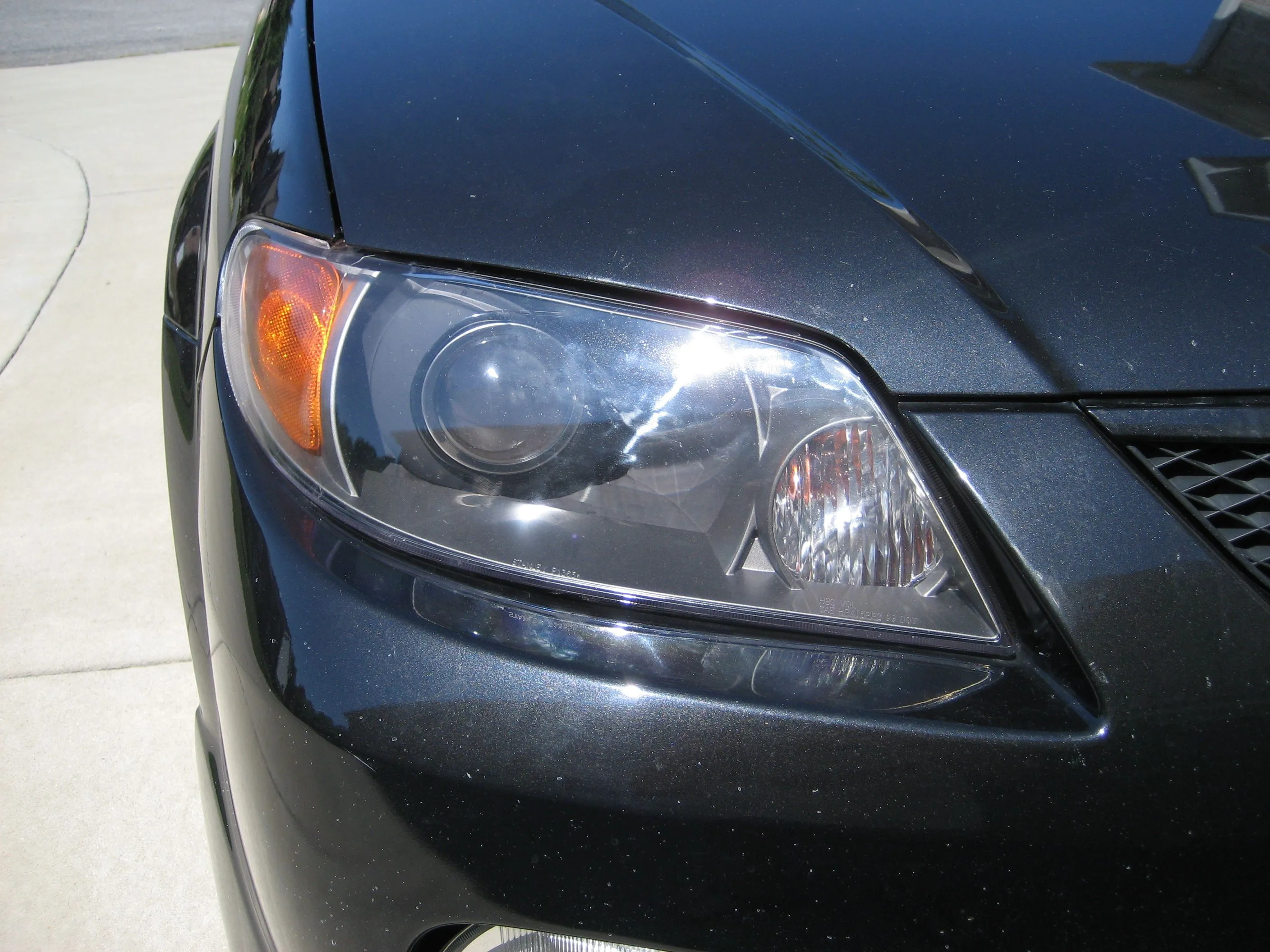

UPDATED! Posting some pics of what we used and how the retrofit turned out.

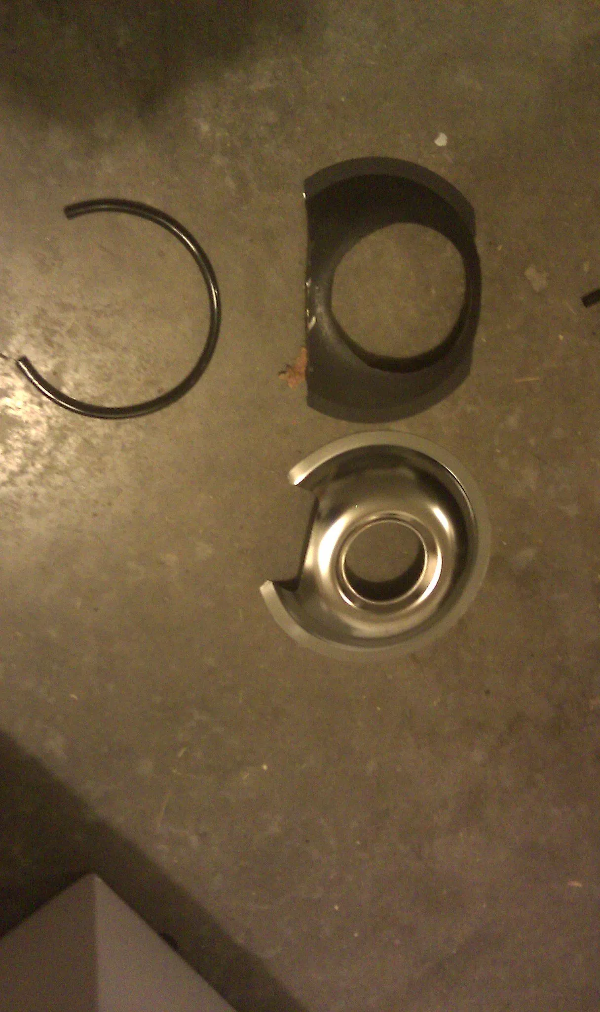

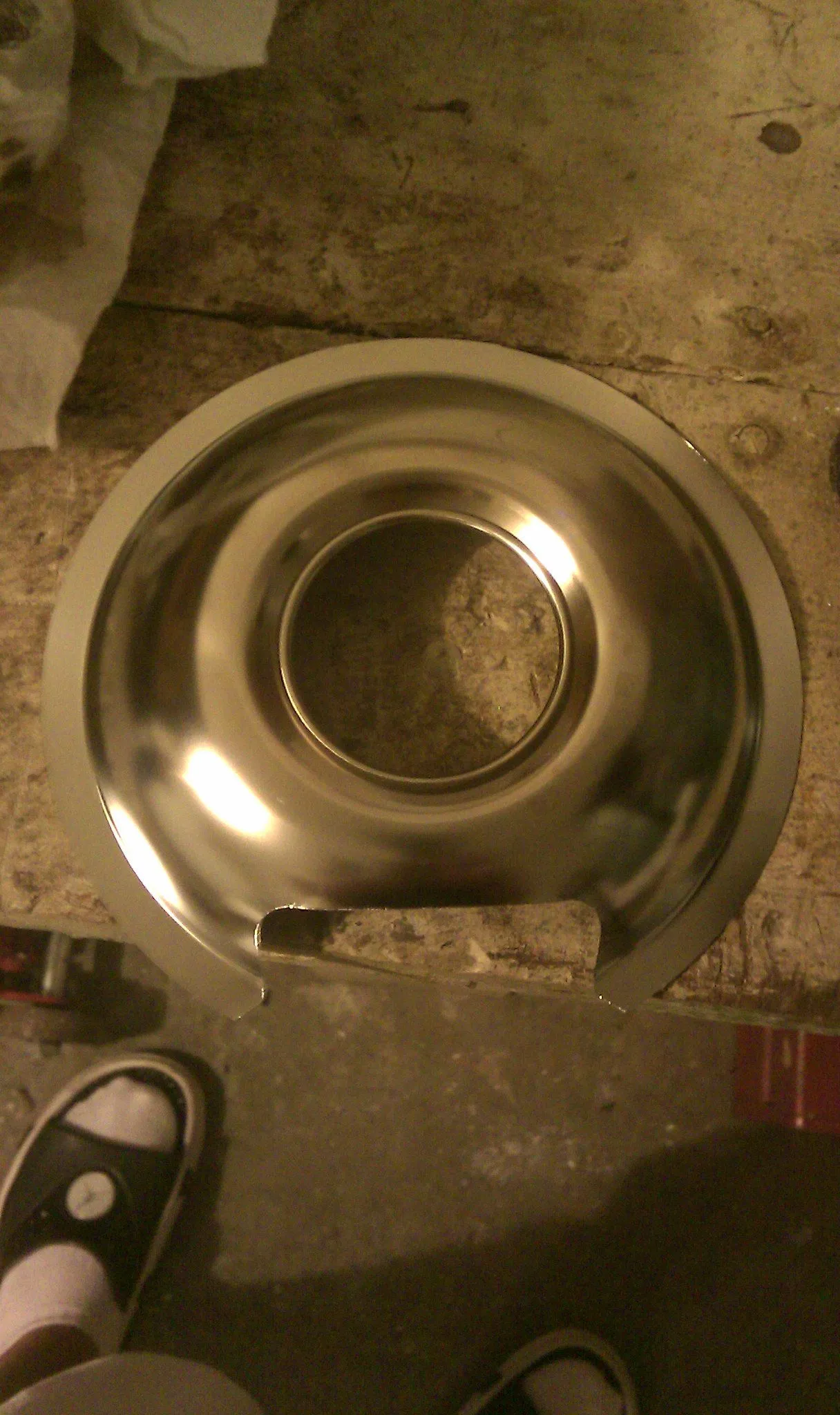

We used a drip pan for the shroud. And some hose to make a ring that covered the sharp edges in the center part of the shroud.

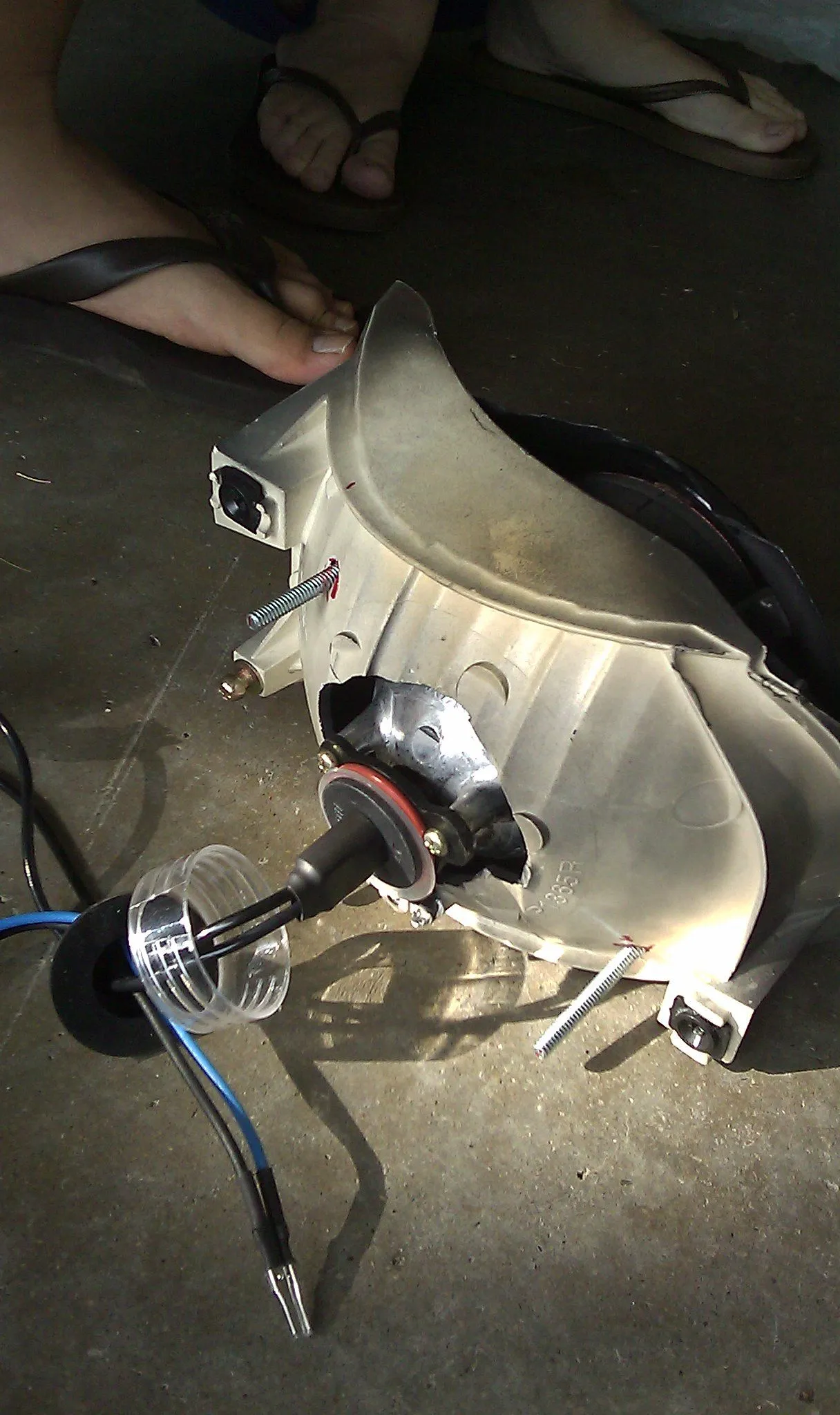

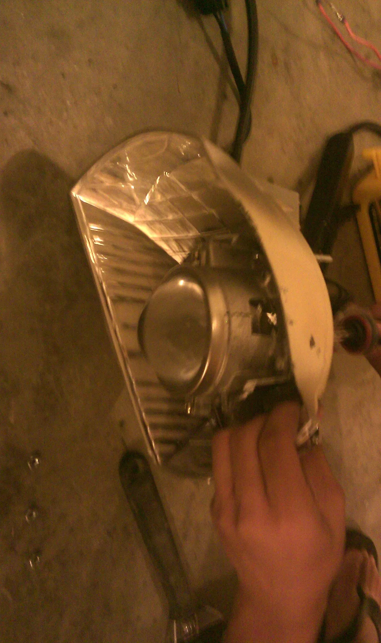

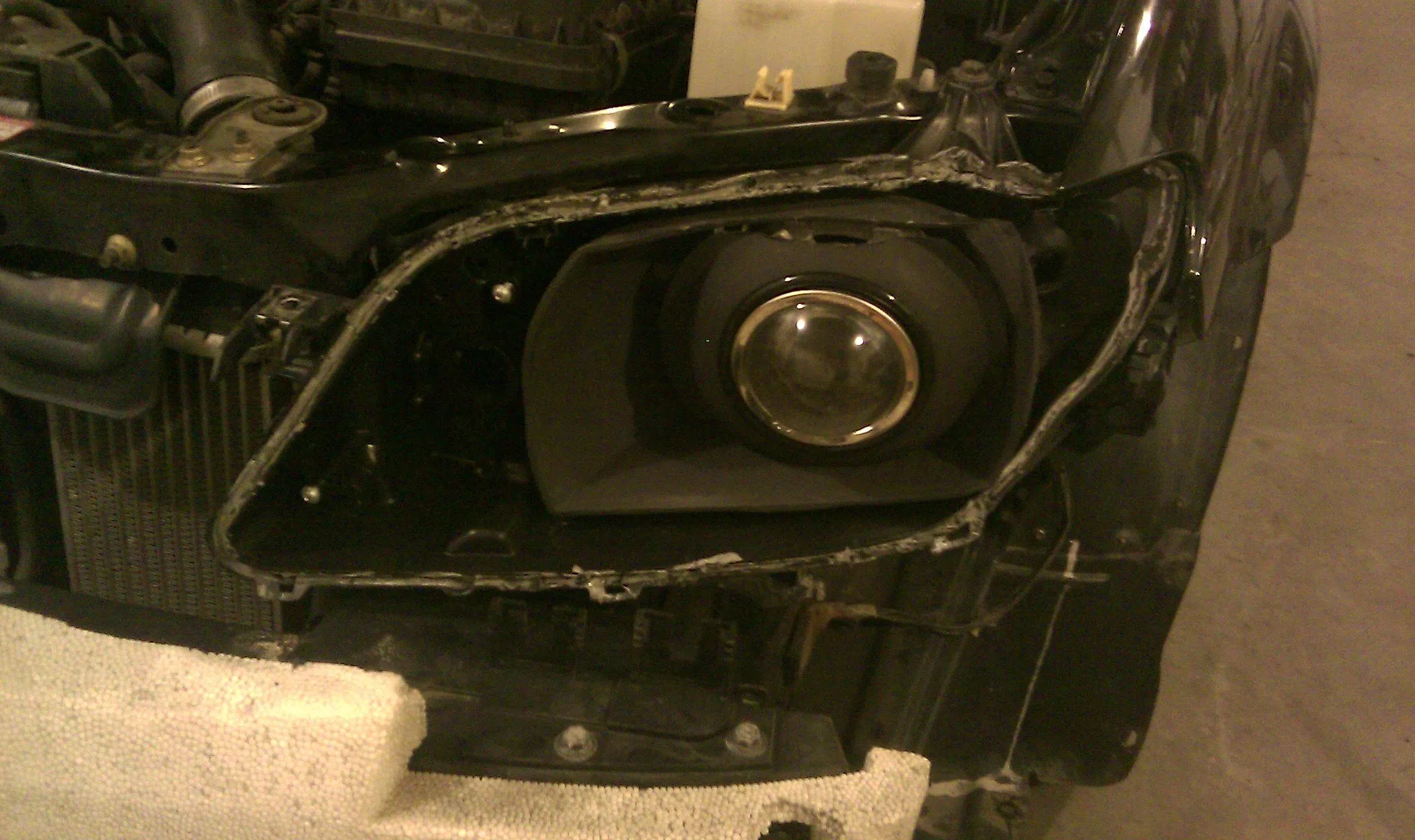

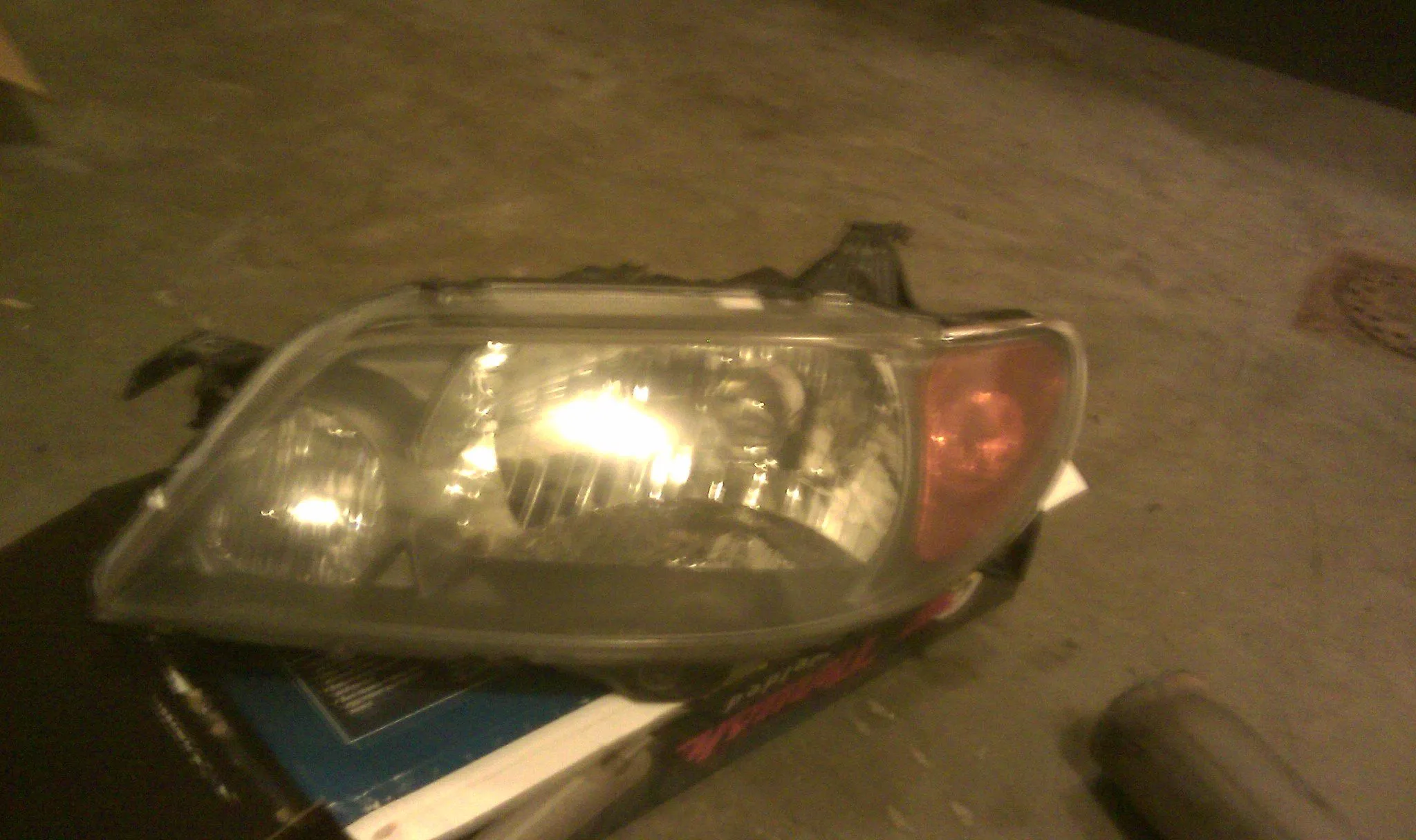

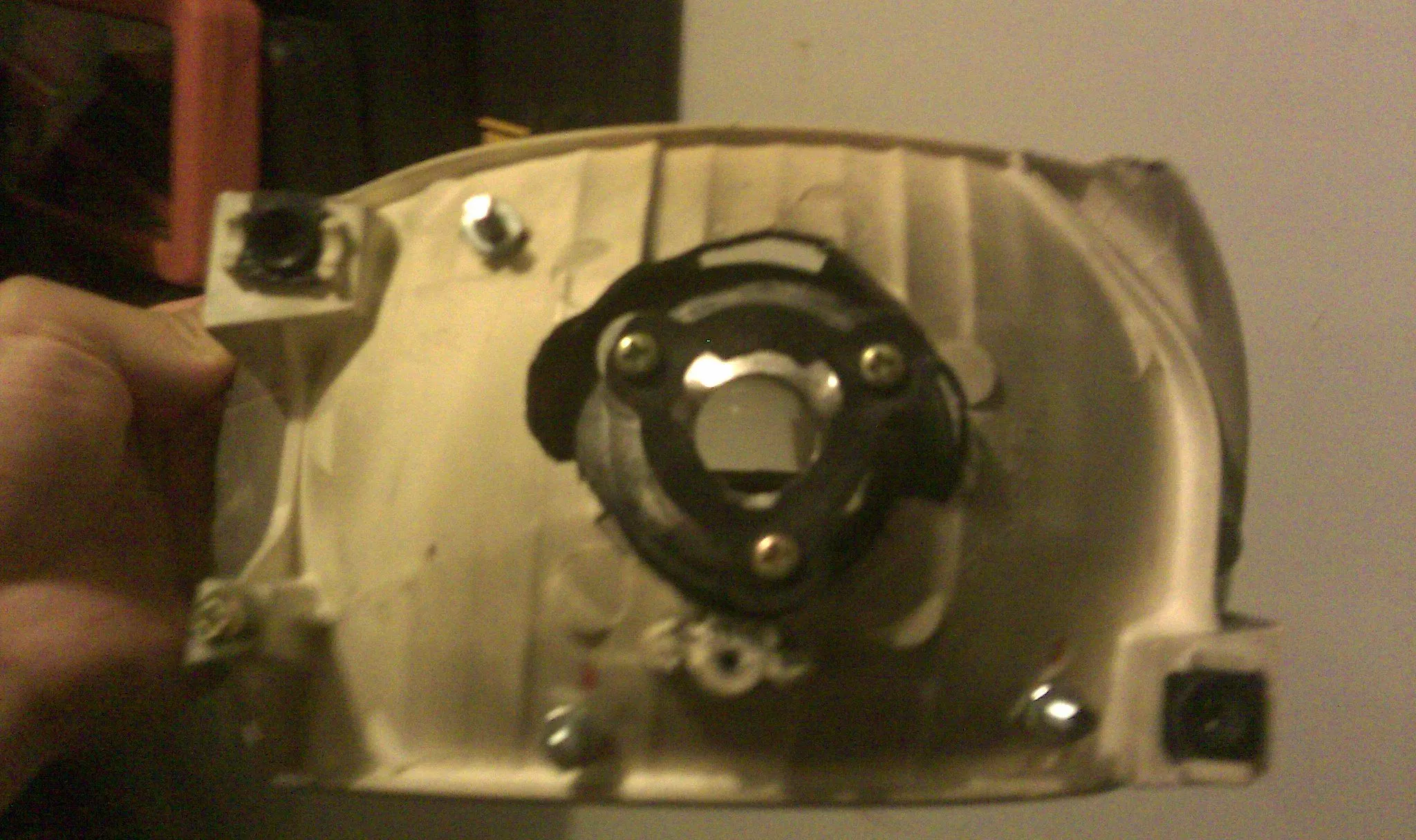

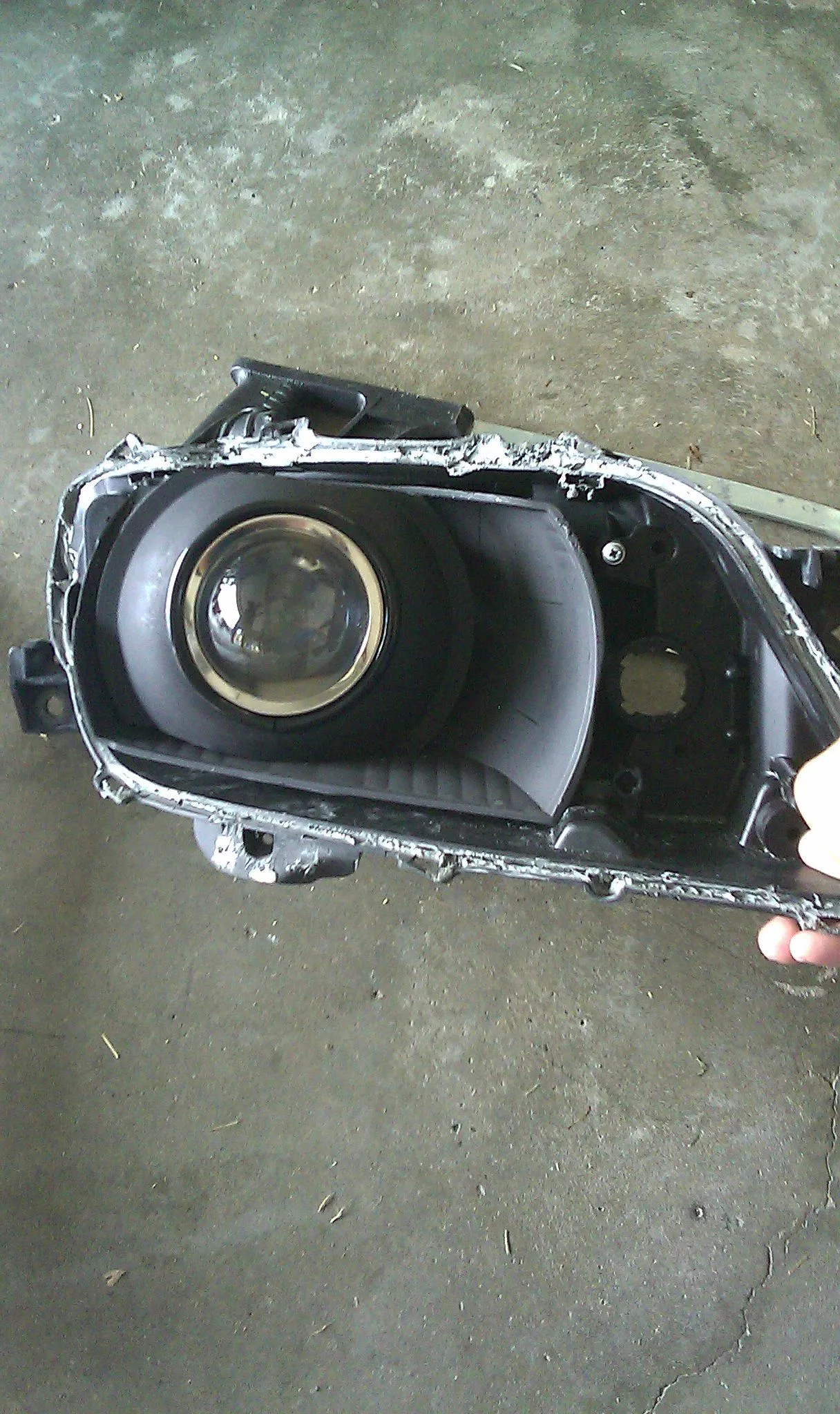

Headlight that we took apart and mounting the projector.
Mounted projector, painted everything with black hi temp paint.

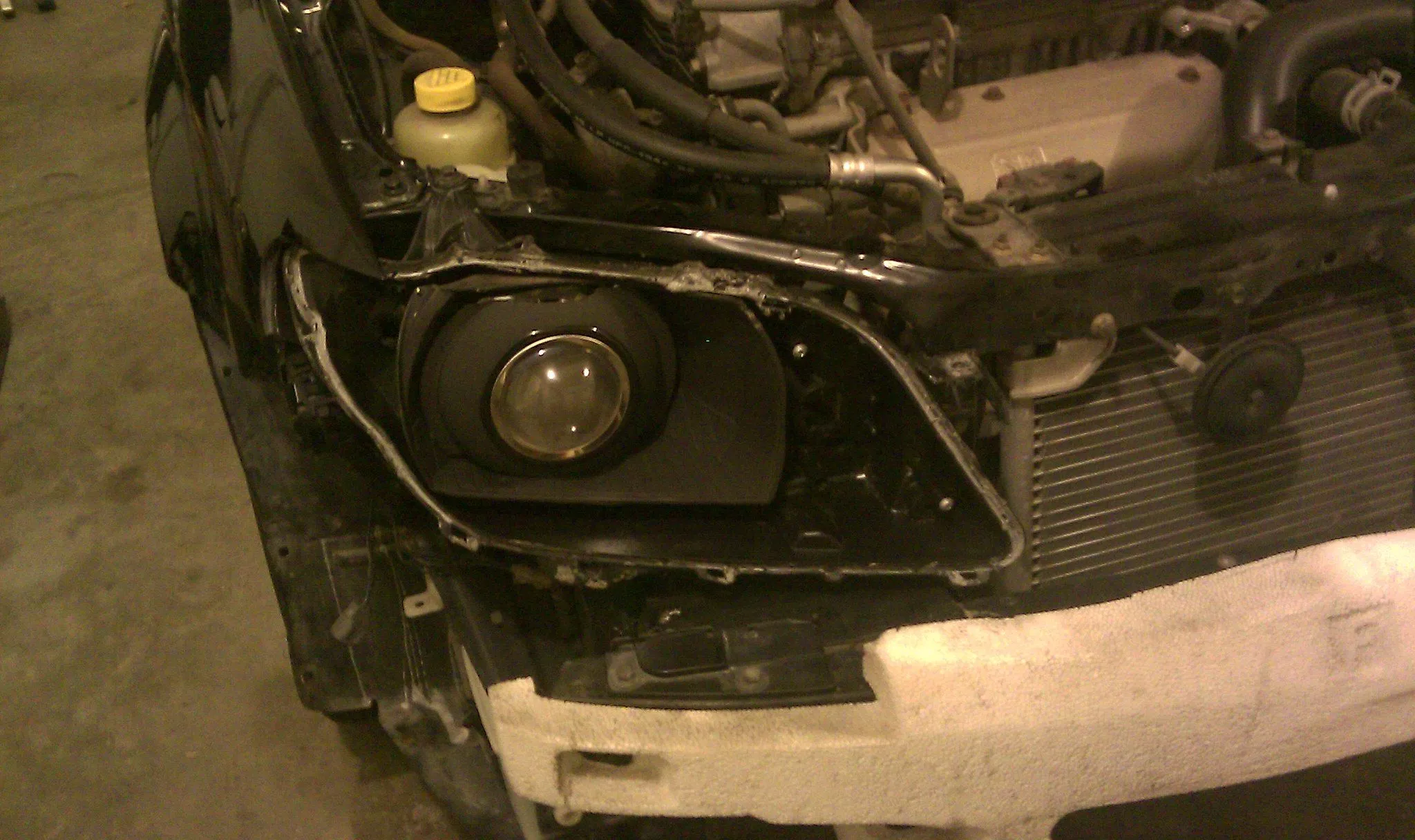

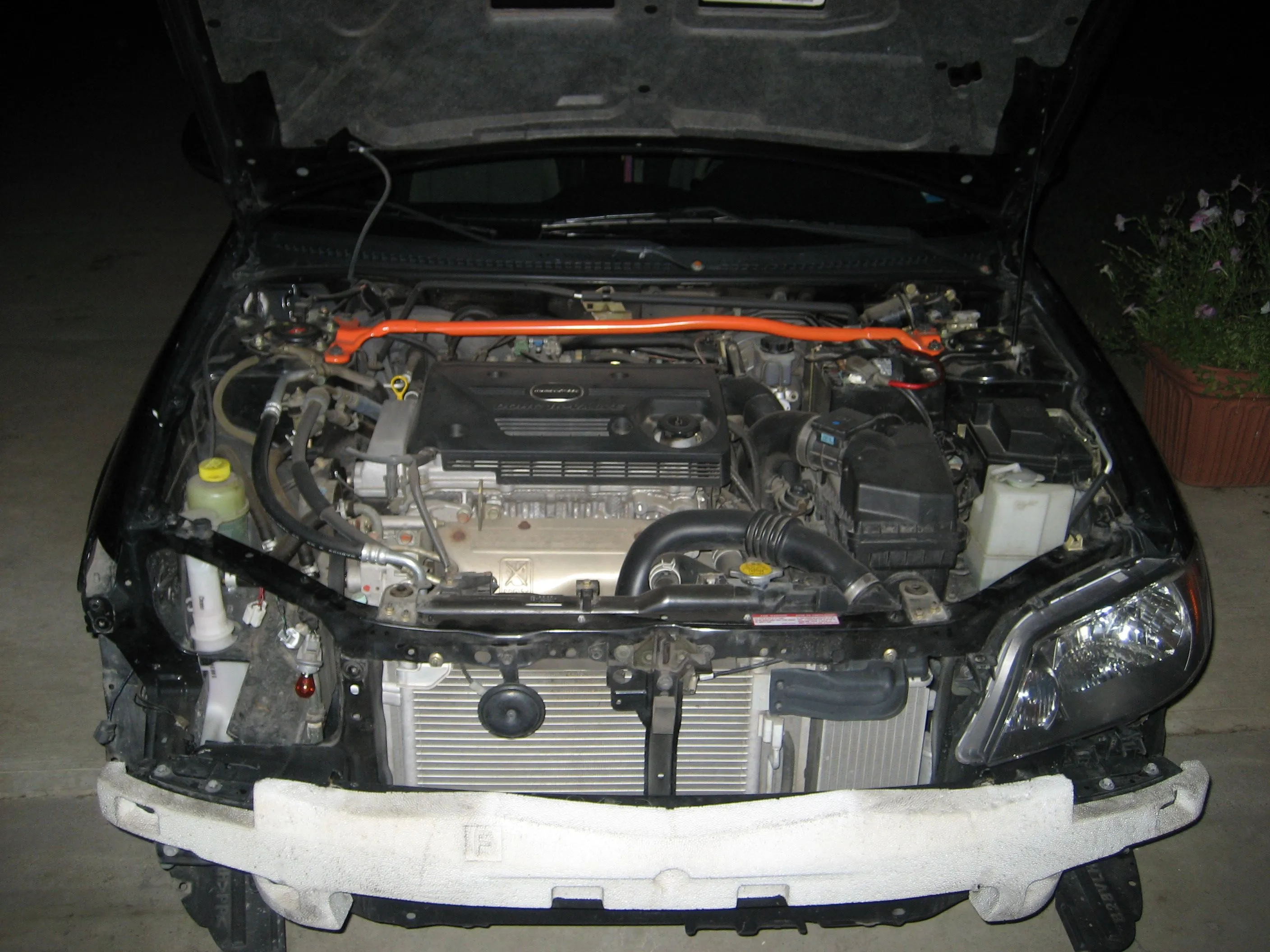

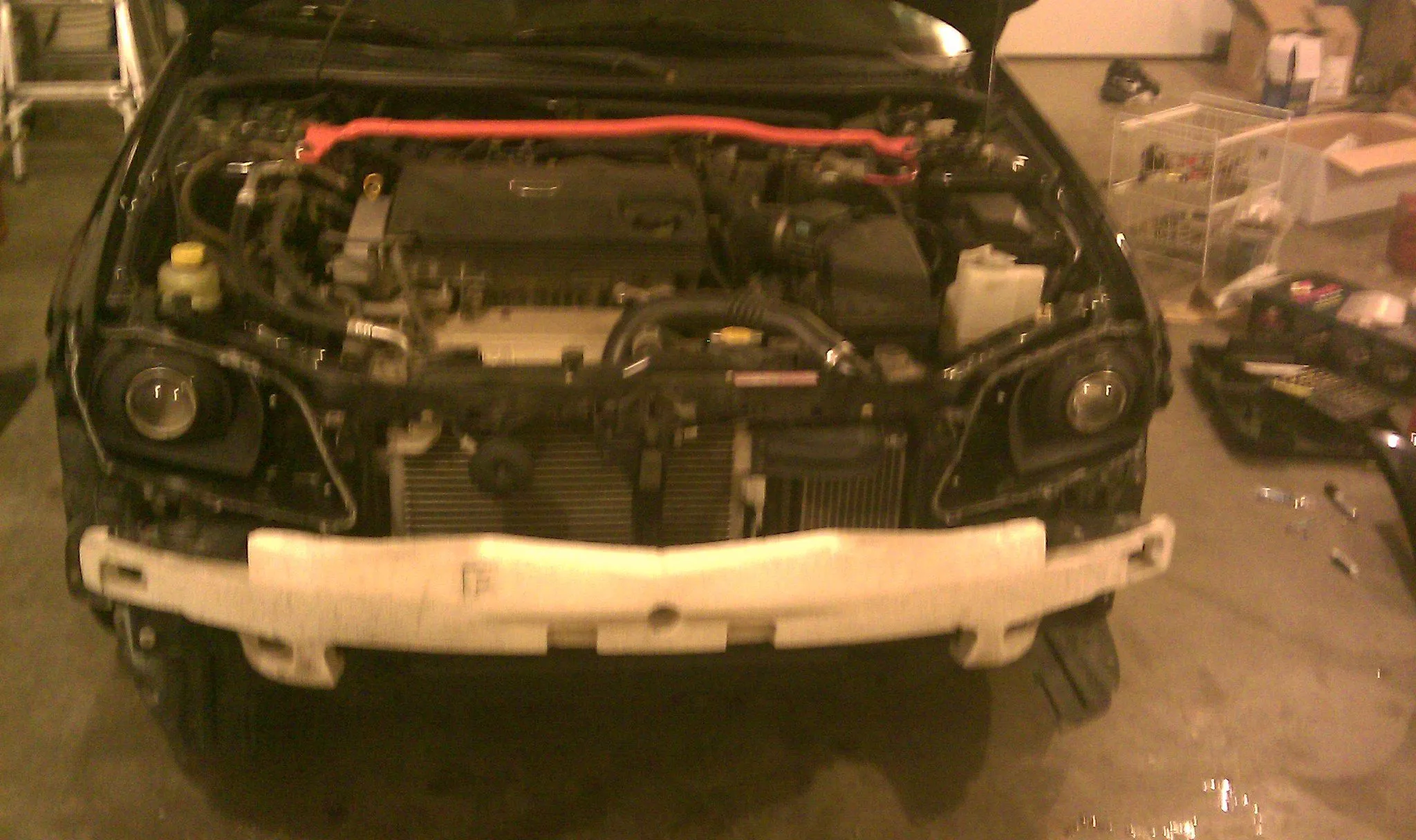

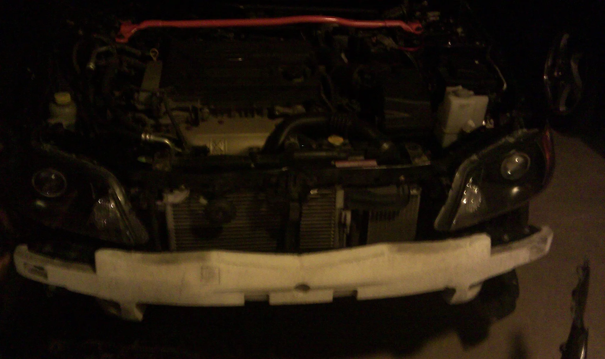

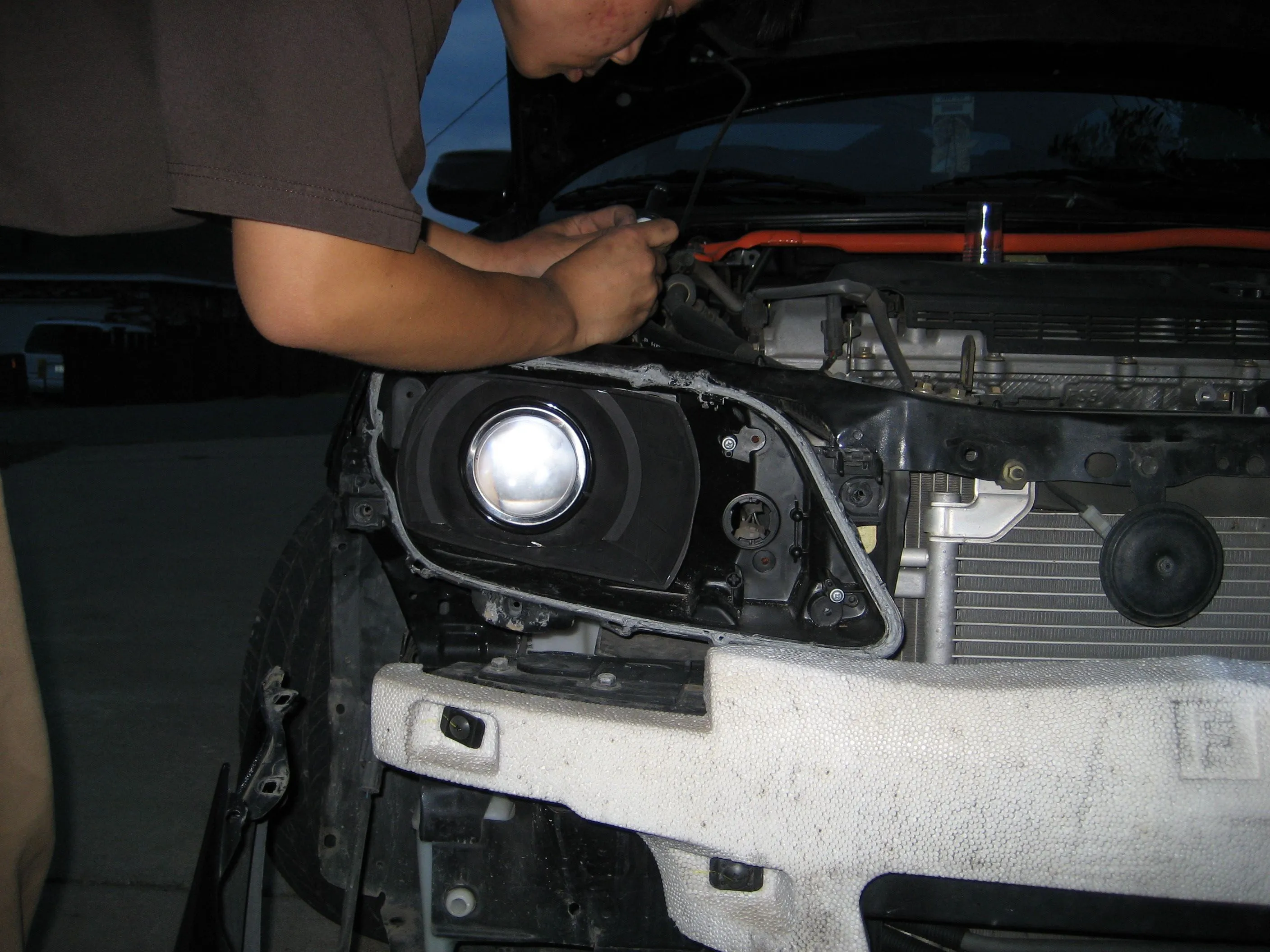

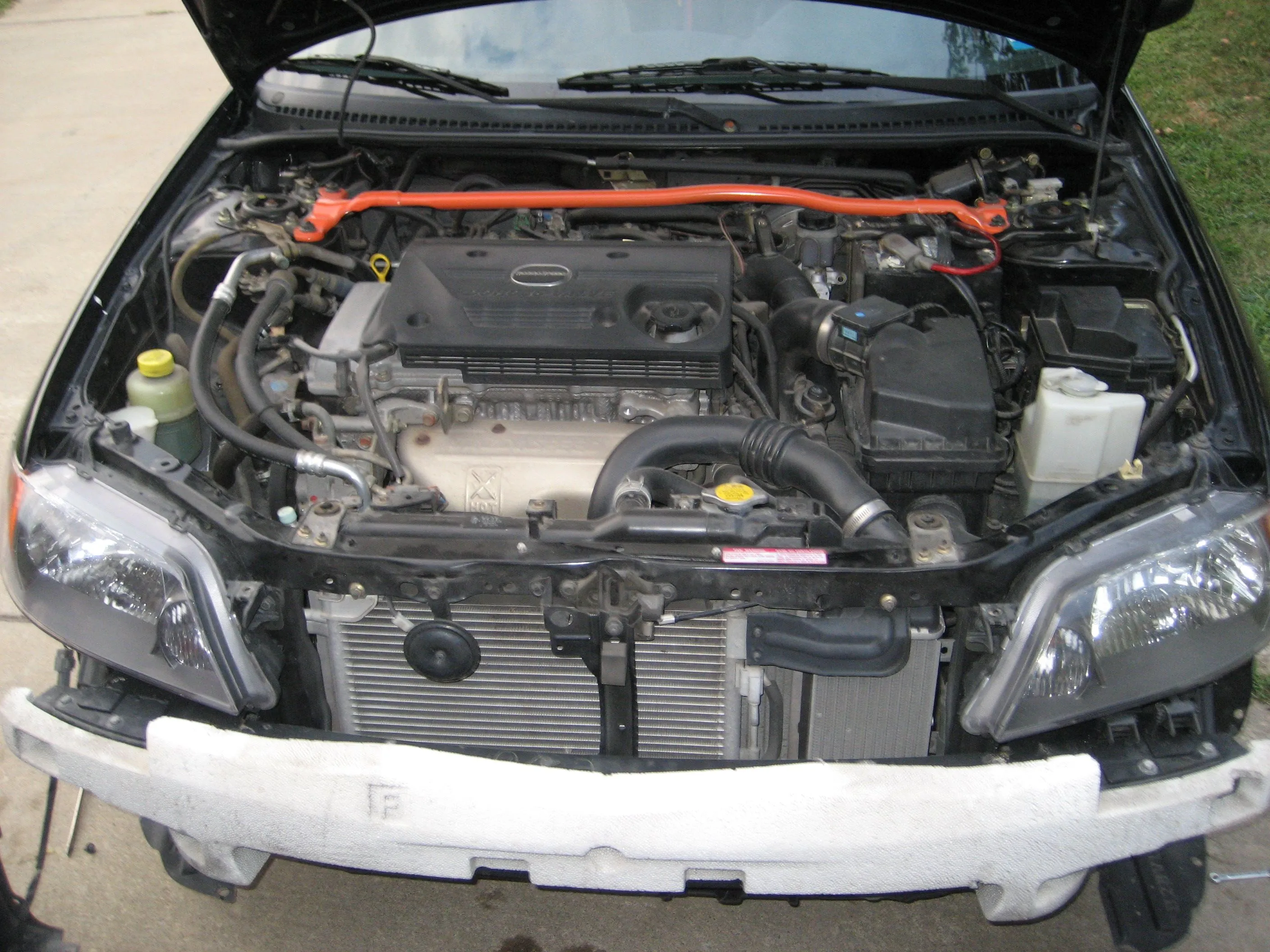

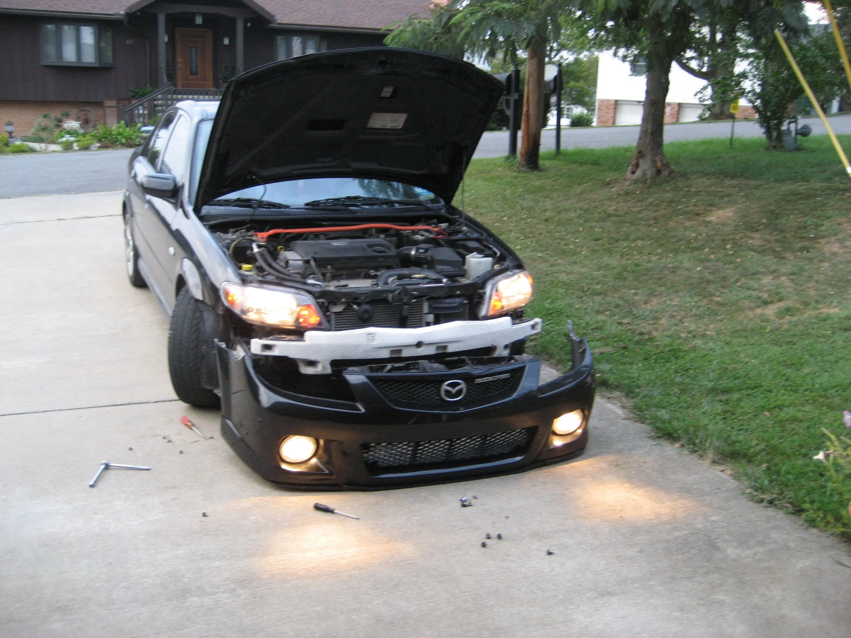

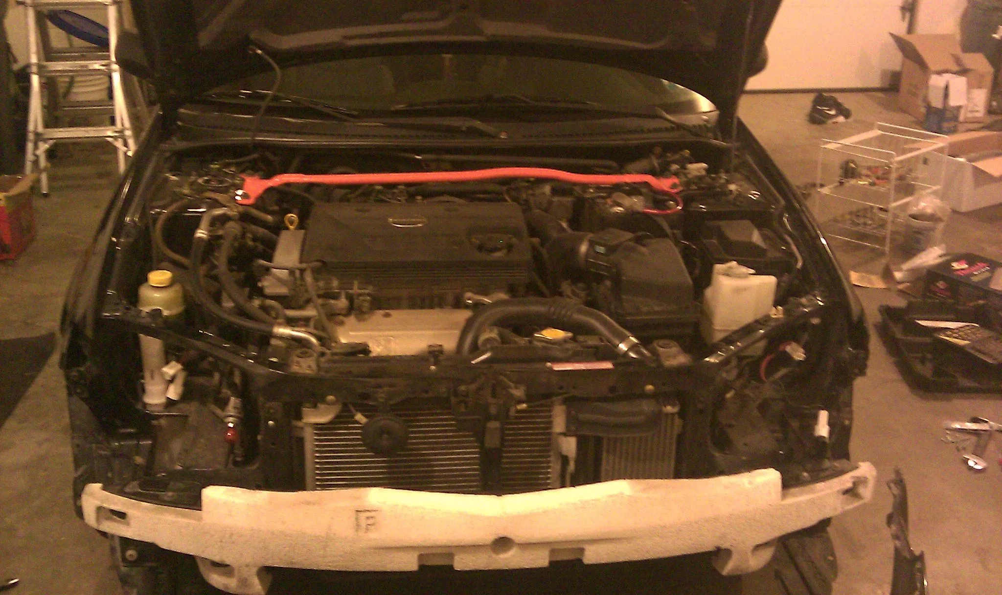

Front Bumper and Stock headlights out! Retrofit headlights in!

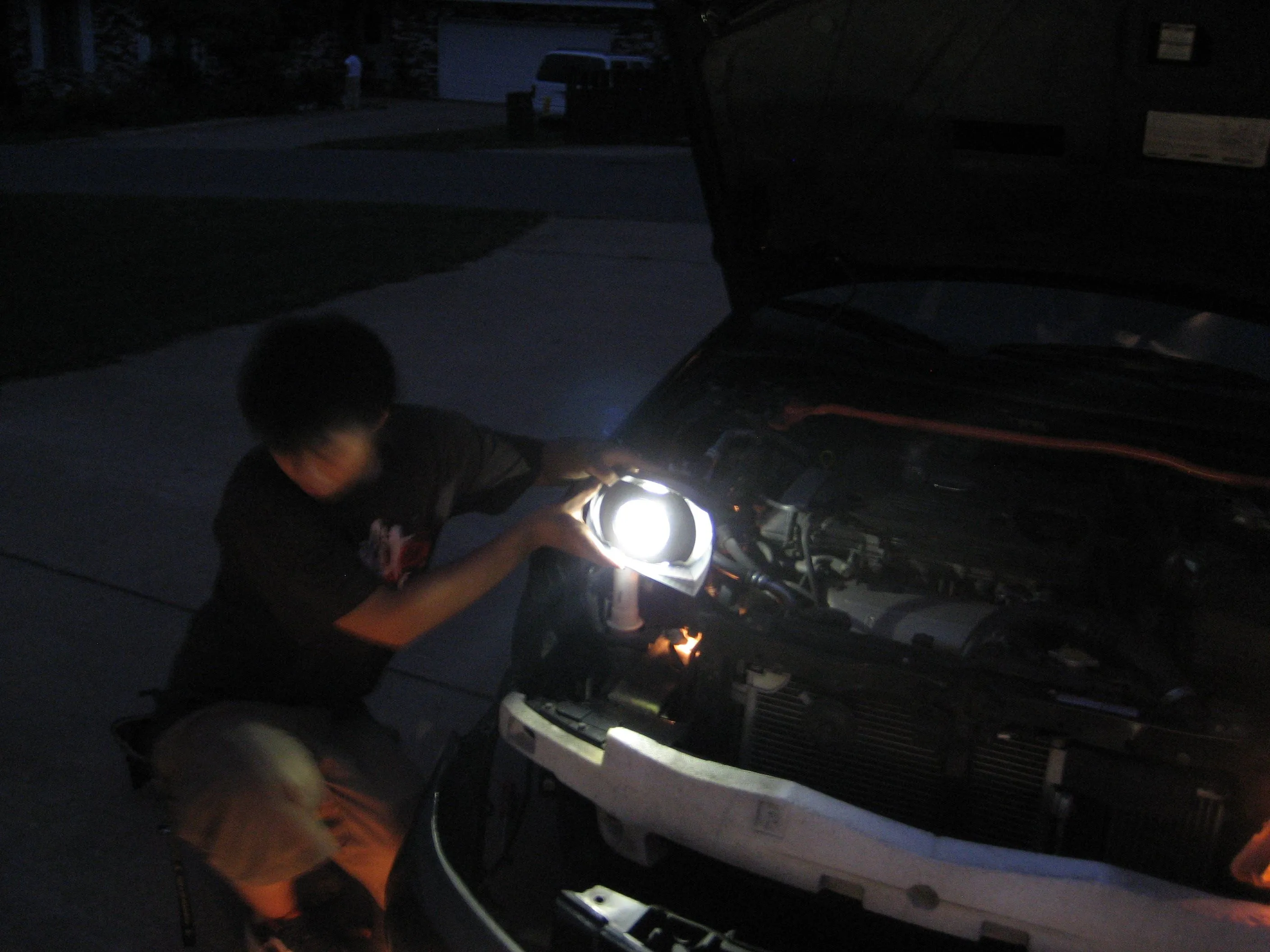

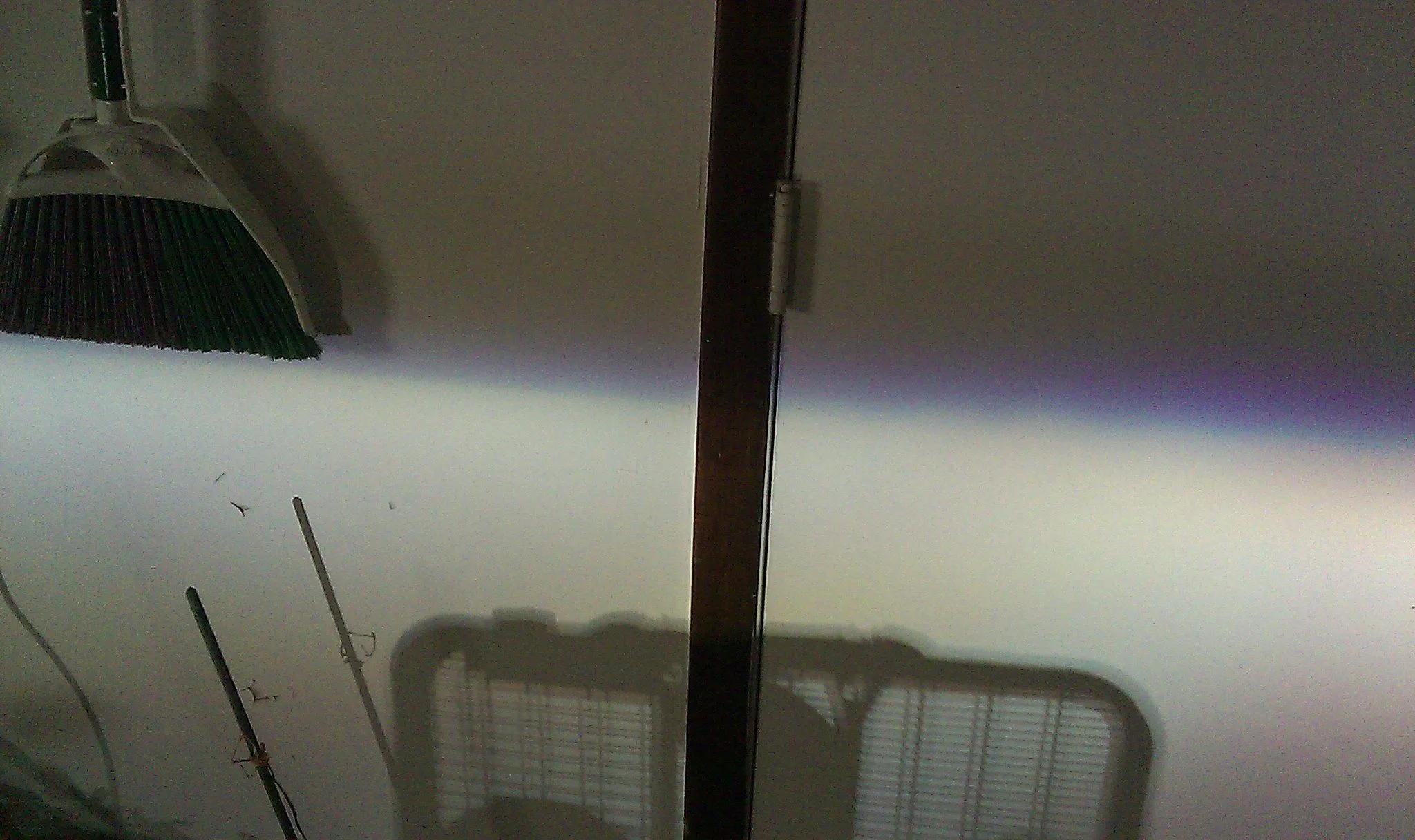

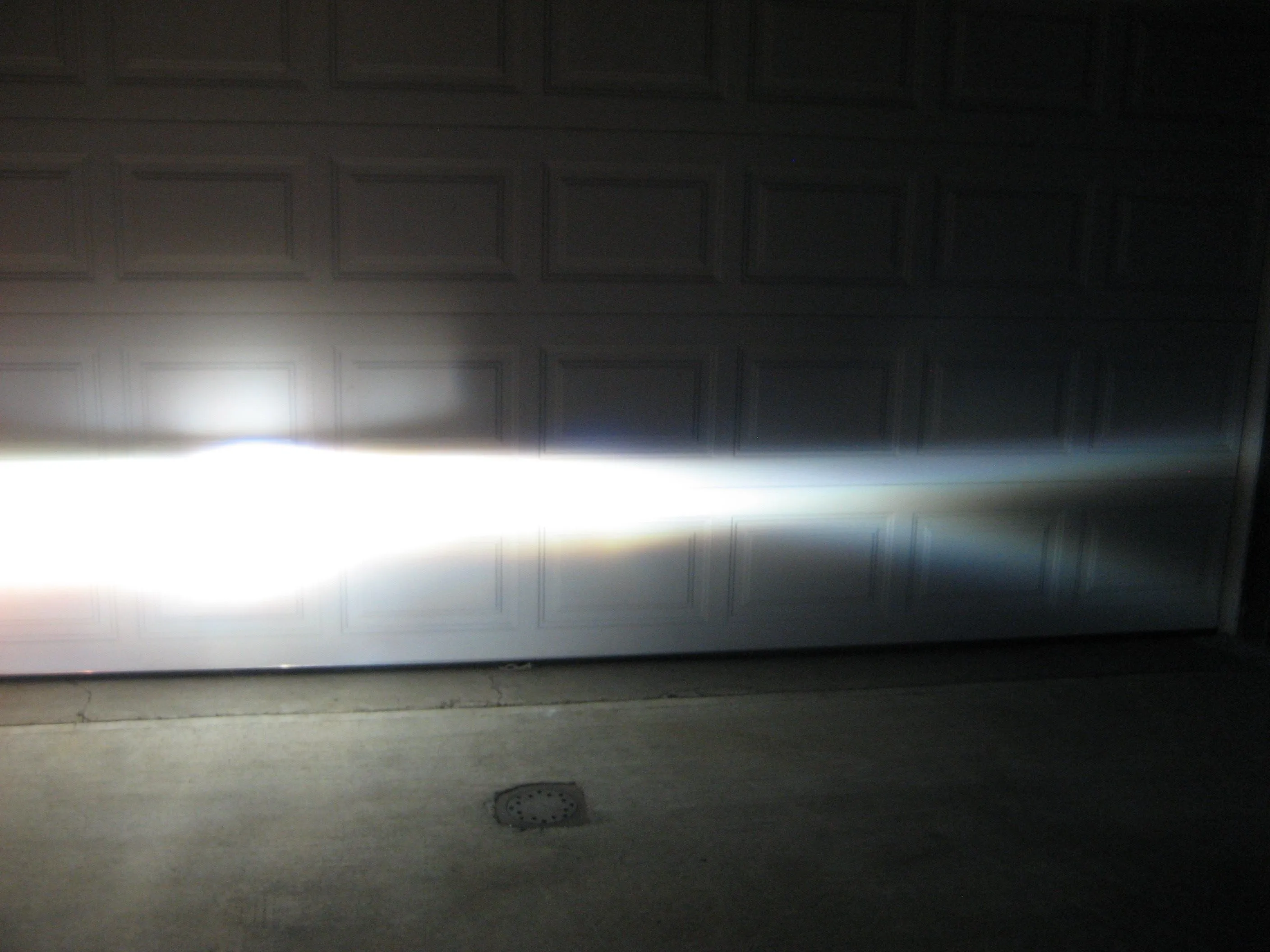

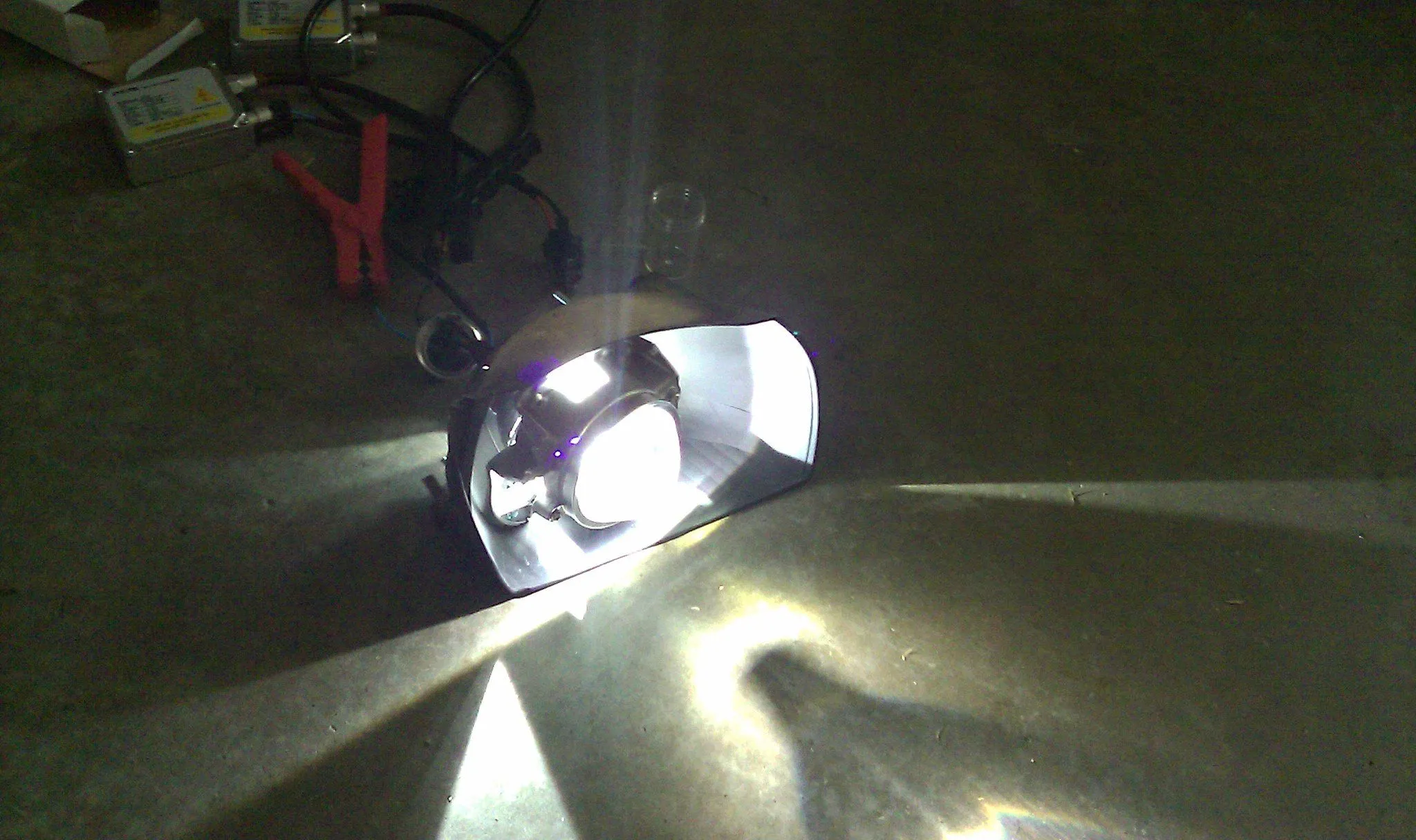

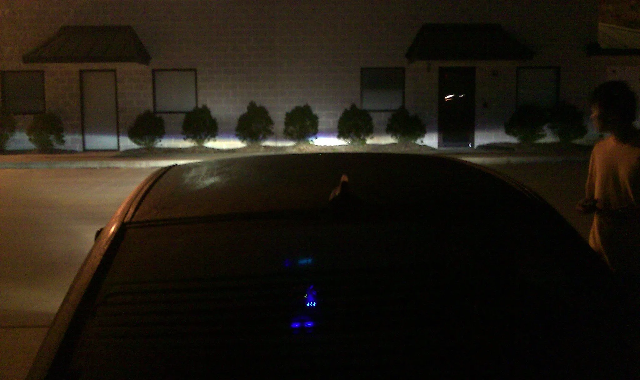

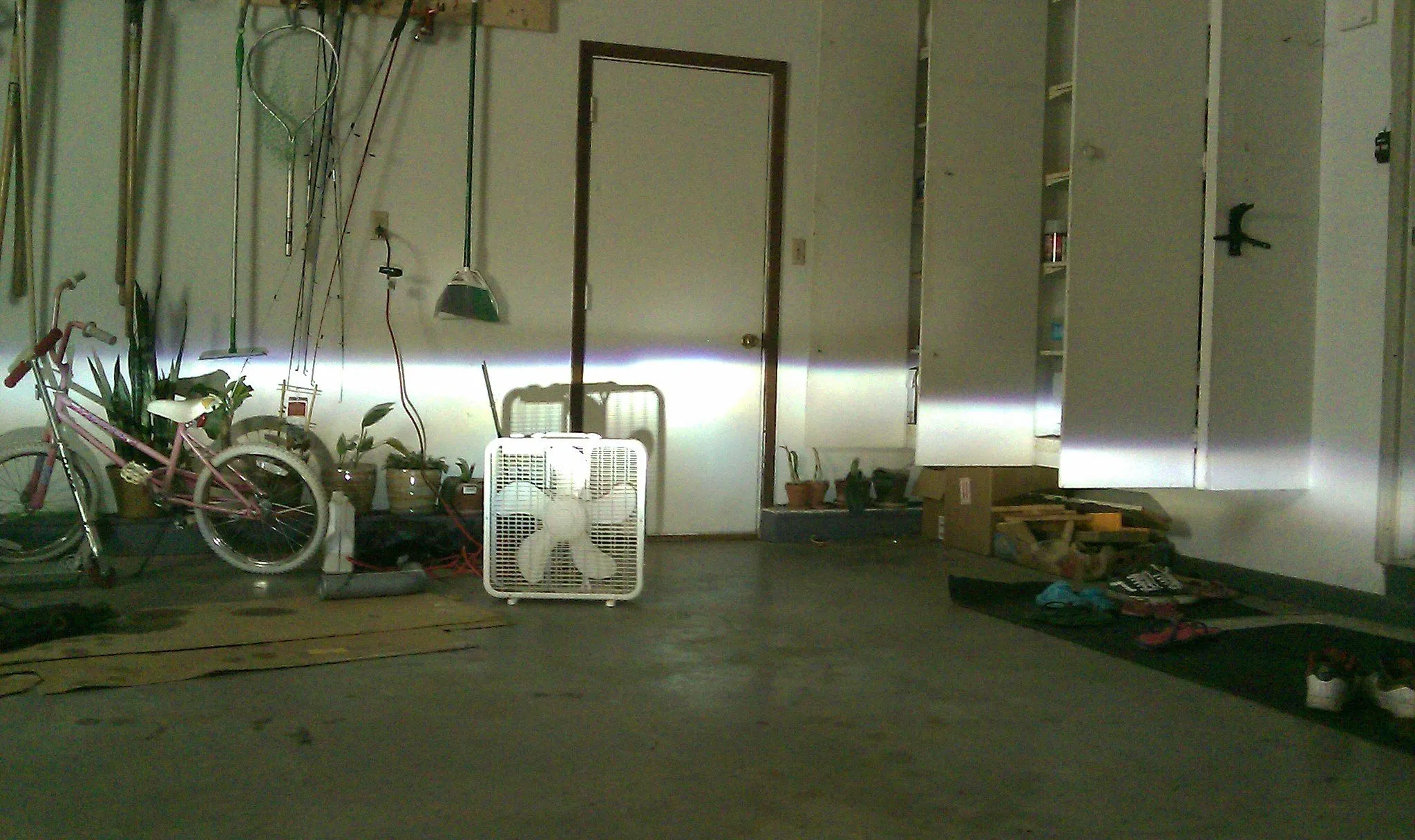

Aiming the lights/ Cut off

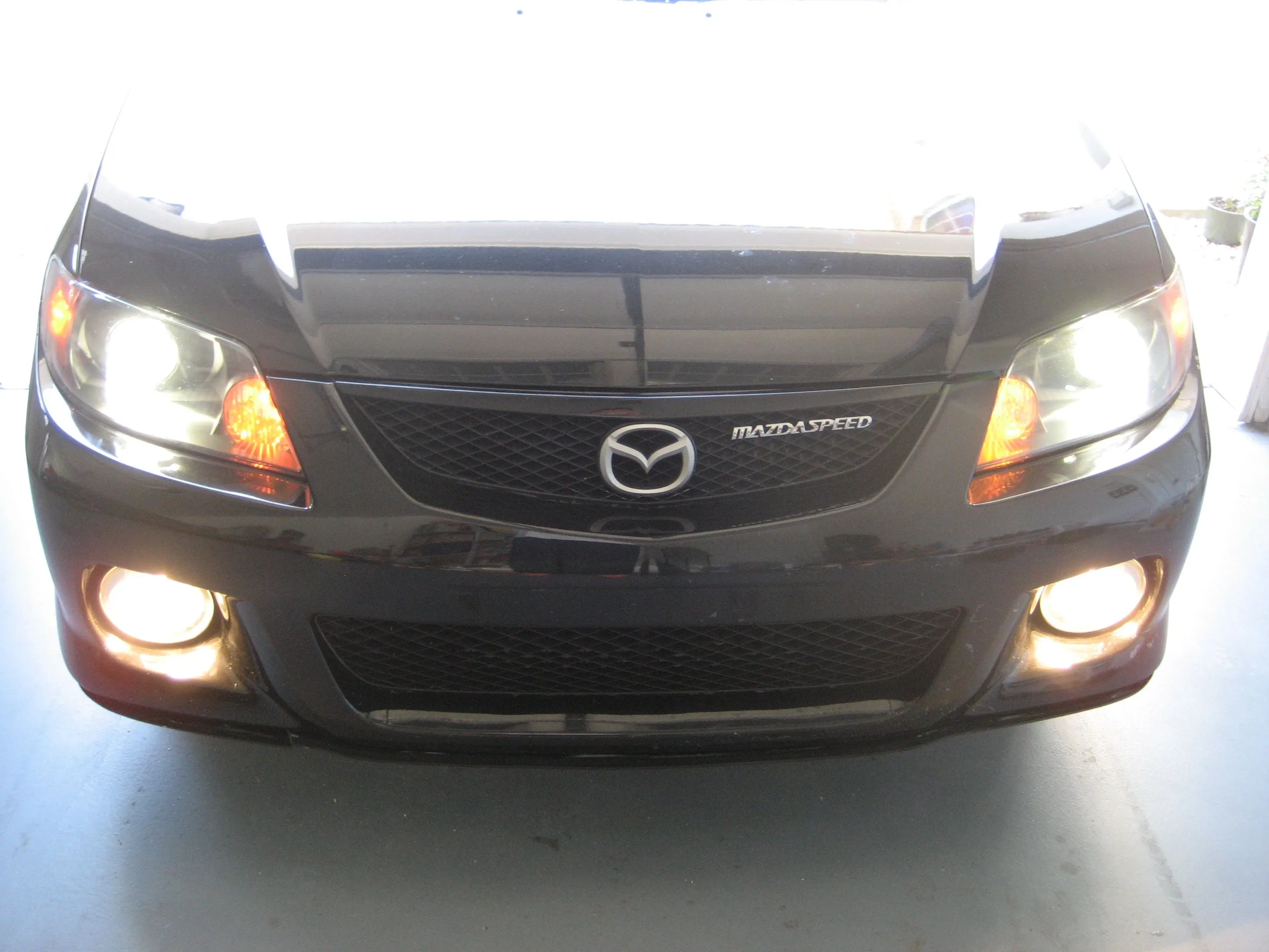

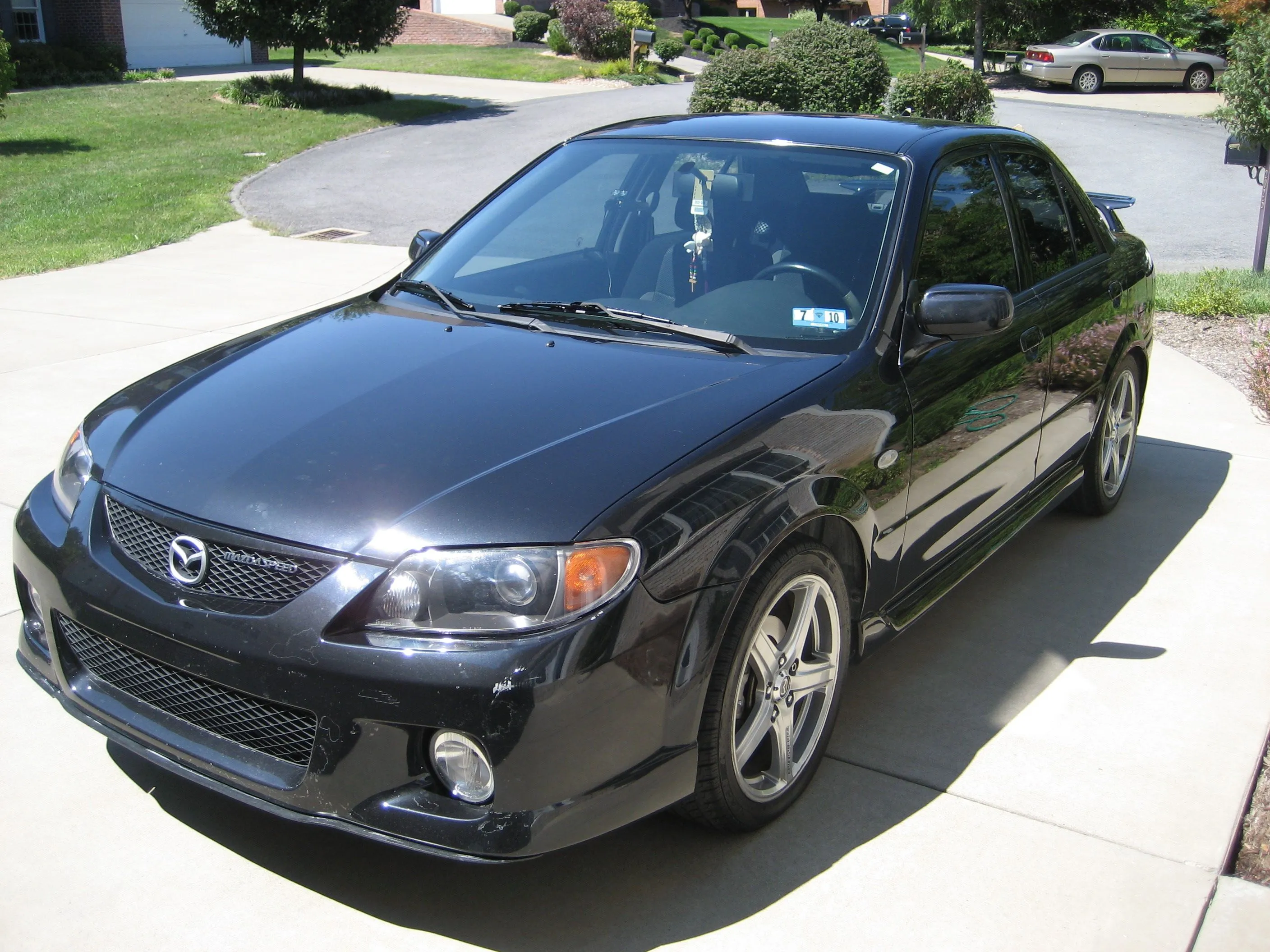

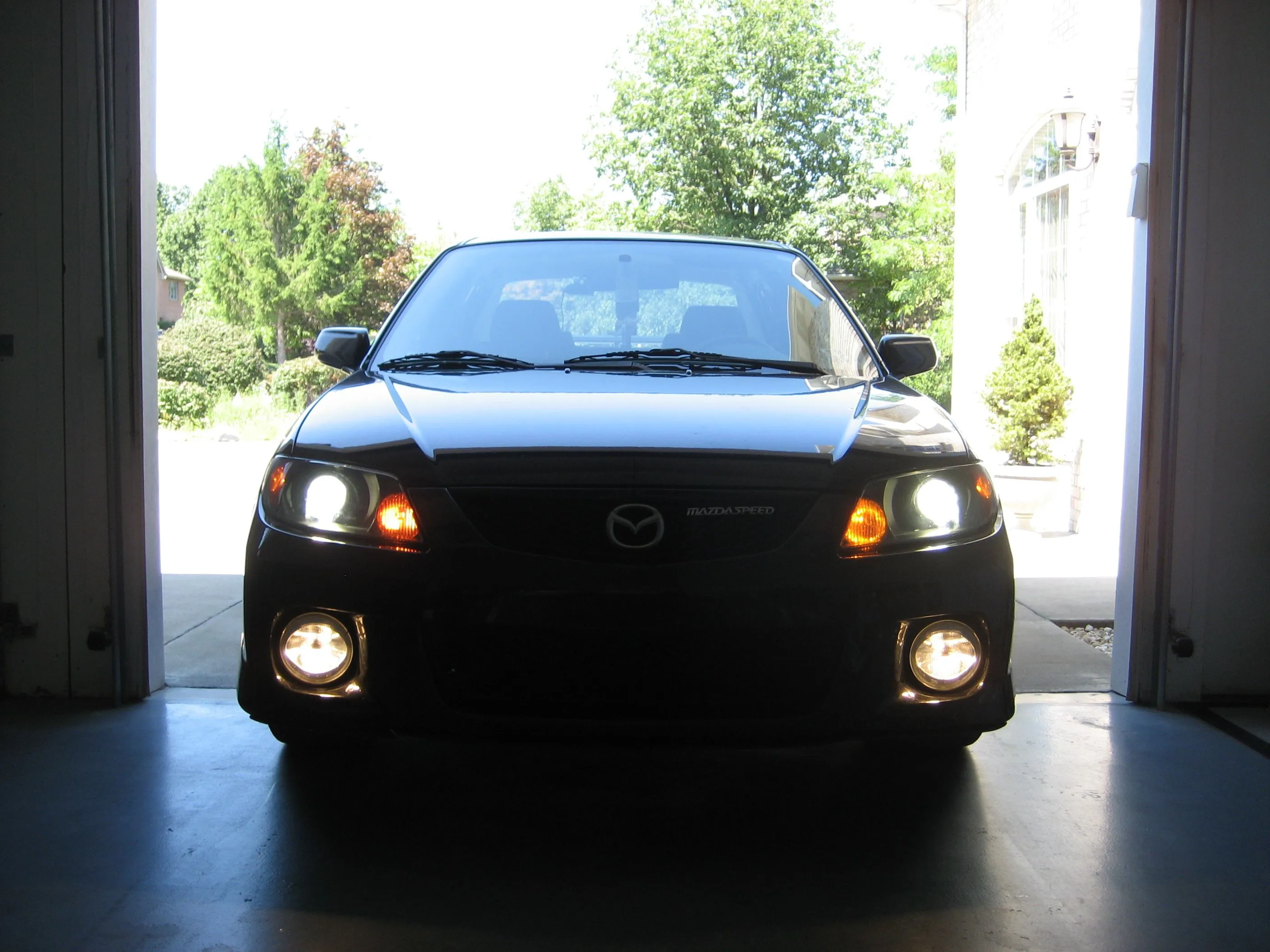

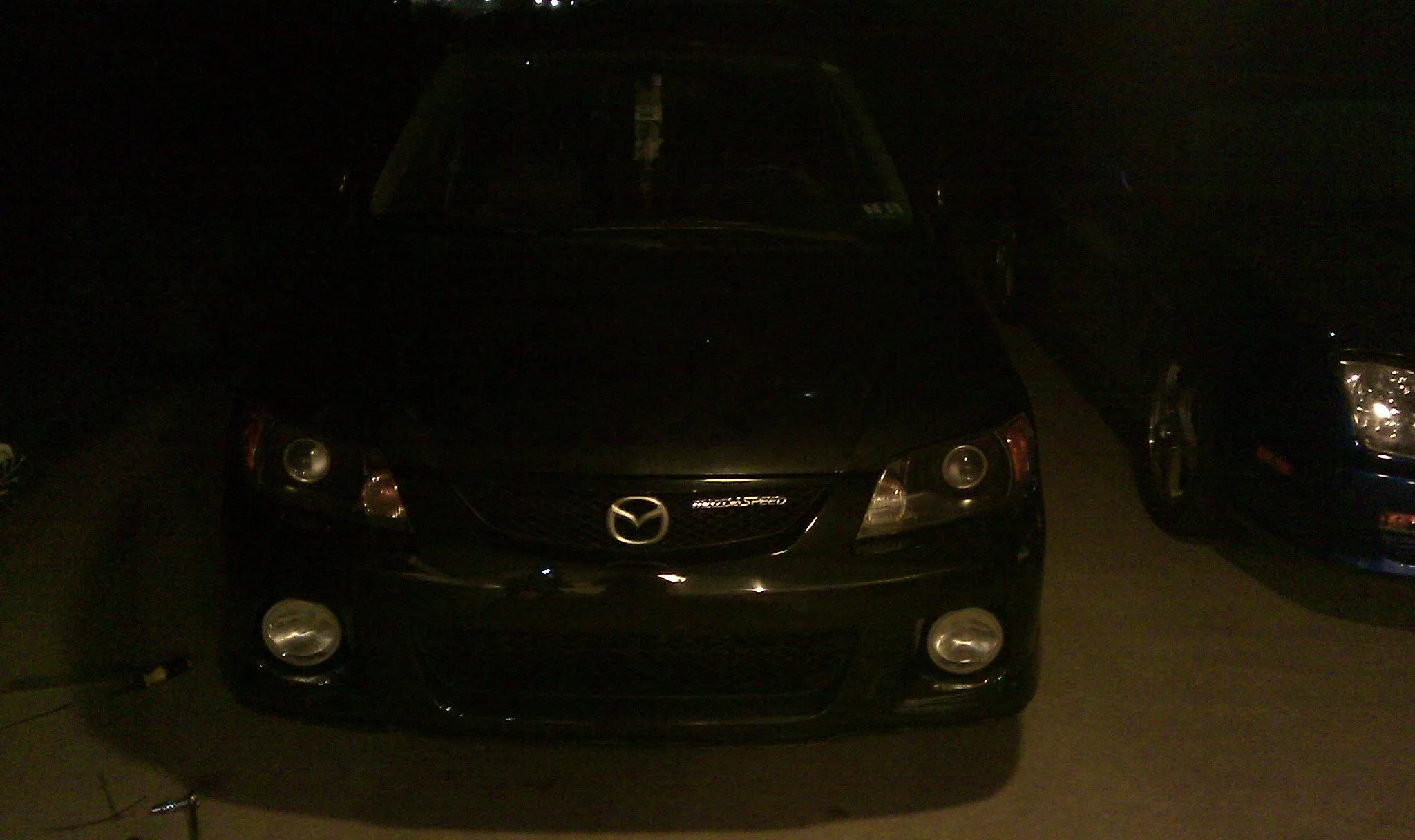

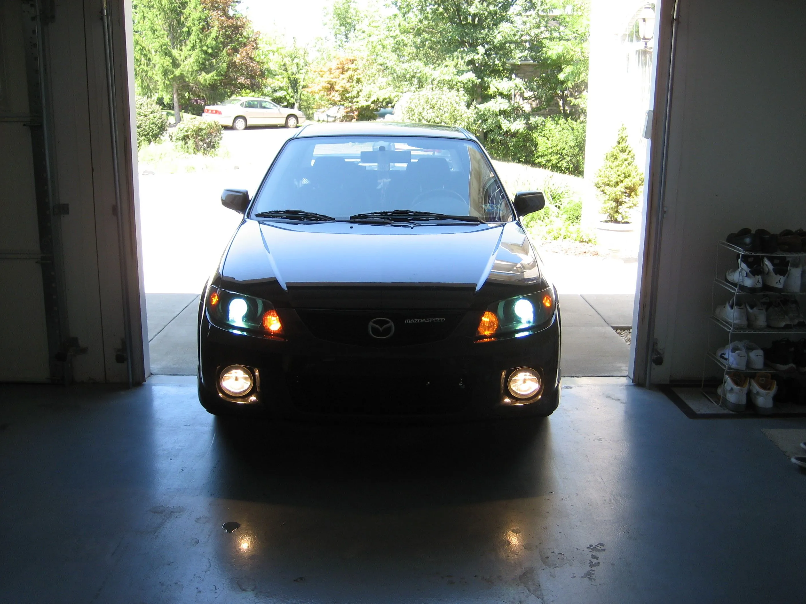

DONE! Tell me what you guys think(nana)
