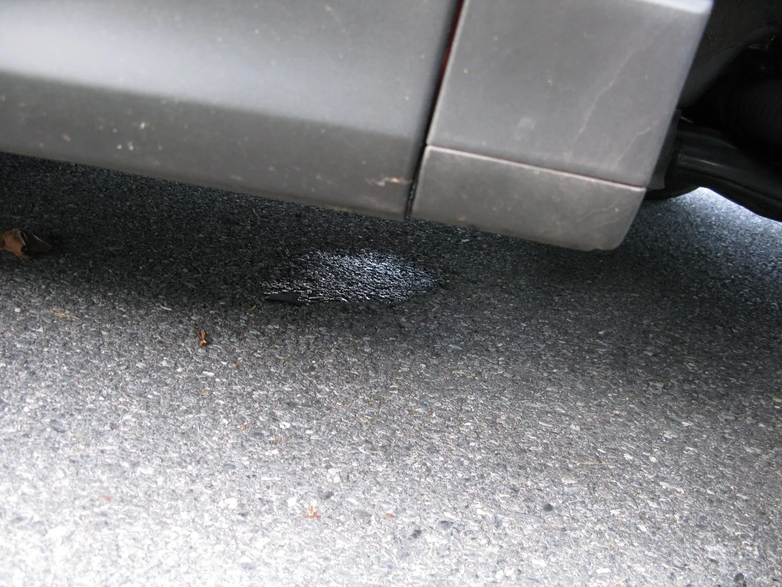

Here's the thing, when my a/c is on I DO see water dripping underneath the car, and no, I don't here water sloshing around when I make a turn.

Don't know about a clogged tube, was dripping pretty good when I got home. Made a puddle within a minute or two of shutting down

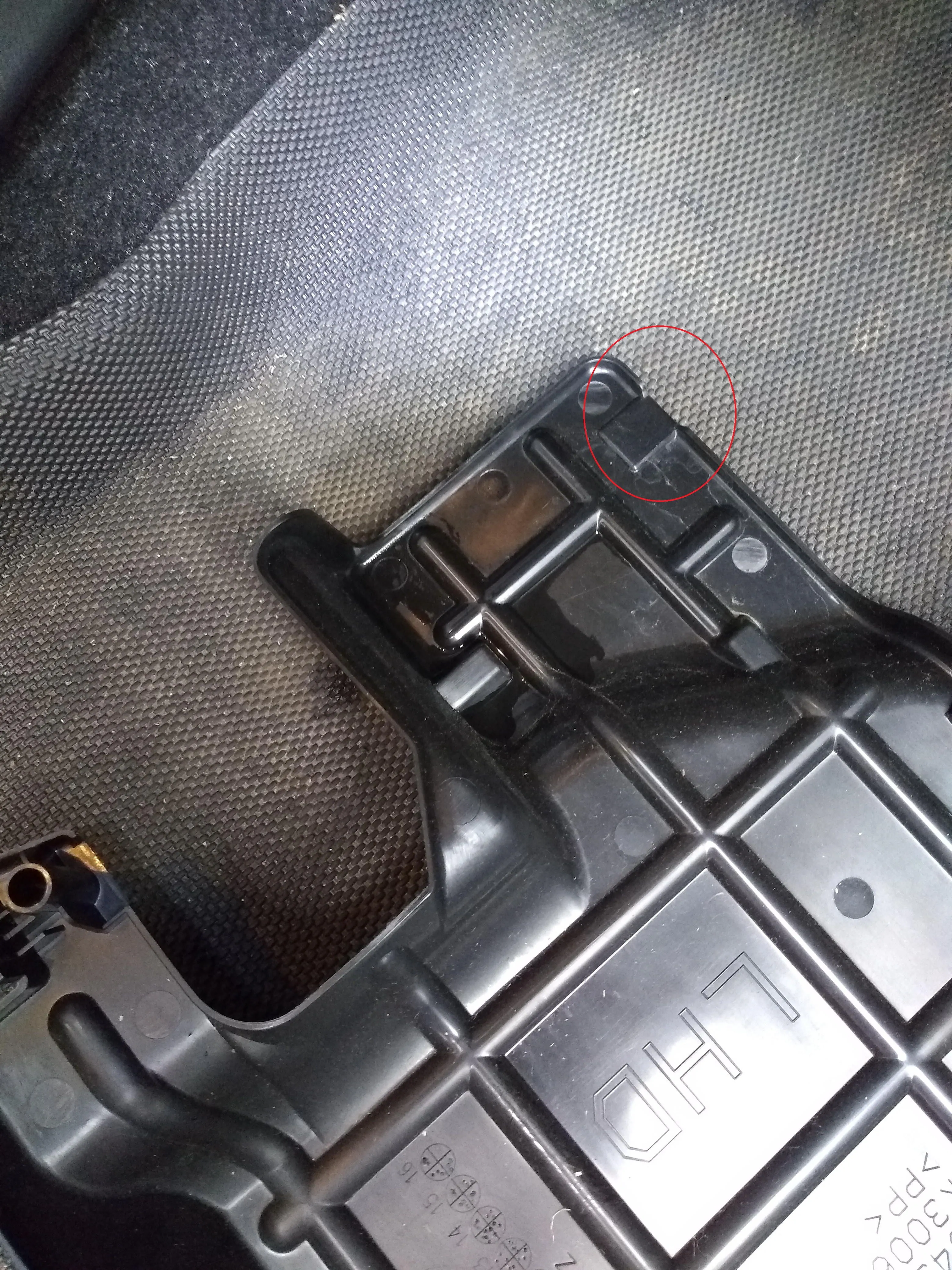

Saw the video in this link about where water would be coming out if this little hose got clogged, it's where I'm seeing water. Pulled the panel out and gave the drain hose a squeeze to see if I could hear anything squishing around in there. Gonna be pulling this hose off when I have more time tomorrow, looks pretty simple and straightforward. This thing drains in the dumbest place behind a heat shield. Could be that maybe I have a partial clog, maybe something is moving around in there to cause an occasional clog. We'll see.
And this looks like a drip tray to catch anything leaking from underneath. Notice the relief circled in red. Gets mounted right under the fan where leaks would occur according to the video.

Wait that panel cover. The water came from the section nearest the front passenger tire right? There may be a seal leak from that section. Gotta use a flashlight to inspect up that way.
