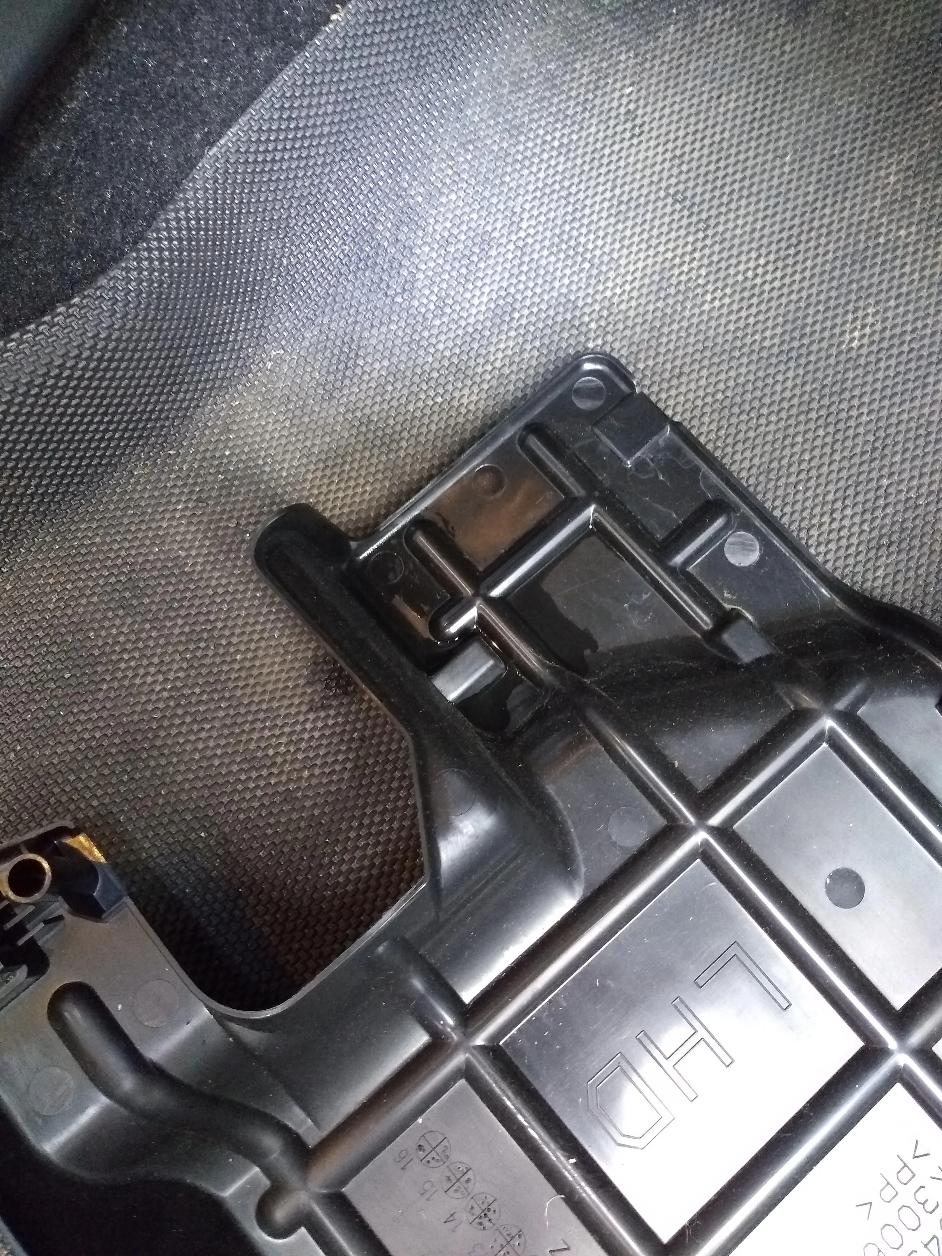

Ran into this issue as well, felt some water collect on the tray below the fan which eventually leaks onto the floor. I'm not parked under any trees or anything so this is kind of weird.

Check the DIY section on how to remove the blower. (2 wire clips and 3 screws).
I would then inspect inside the inlet connected to the blower with a flashlight. Let us know if you can see the condenser/evaporator coils (sorry always get them confused.) inside that inlet. Said coils could be blocked and/or having ice accumulated thus creating a small pool of water when it melts. Then check if the drain tube is clogged. A product such as KlimaCleaner can keep the aluminum fins clean and help clean out the drain tubes. You may even used a long stick or something to unclog the rubber drain tube.
I would then inspect inside the inlet connected to the blower. Let us know if you can see the condenser/evaporator coils (sorry always get them confused.) Said coils could be blocked and/or having ice accumulated thus creating a small pool of water when it melts. Then check if the drain tube is clogged. A product such as KlimaCleaner can keep the aluminum fins clean and help clean out the drain tubes. You may even used a long stick or something to unclog the rubber drain tube.

I*m not sure that it*s in the right place for condensate. Has it ever had a windshield?
Replacement? No. Forgot to add that it only happen during heavy rain....could very well be a windshield leak. A/C gets cold. Doesn't that tray look like its designed to catch water?
^ no that's just a cover panel
