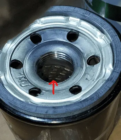

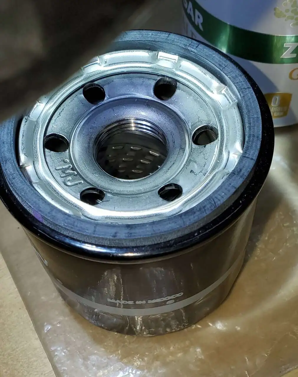

Went to Mazda dealer to get a Mazda oil filter. Only filter they have available for my 2017 Mazda CX-5 (non turbo) was the Made in Mexico Mazda Value oil filter # PE01-14-302a-MV
I inspected the inside of the filter prior to install and found that most of the punched oil holes were closed and the remaining open ones were barely even open to let any oil into the filter. Suffice it to say, I did not install it and will return this defective filter.

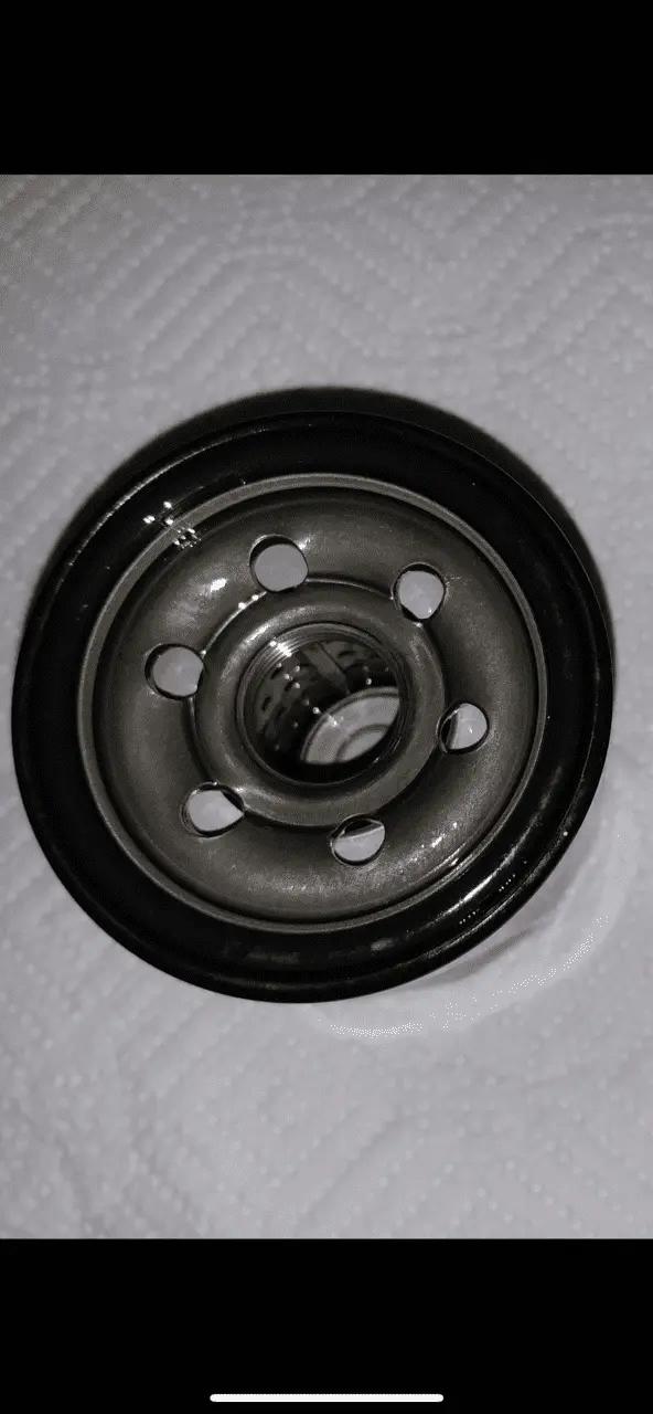

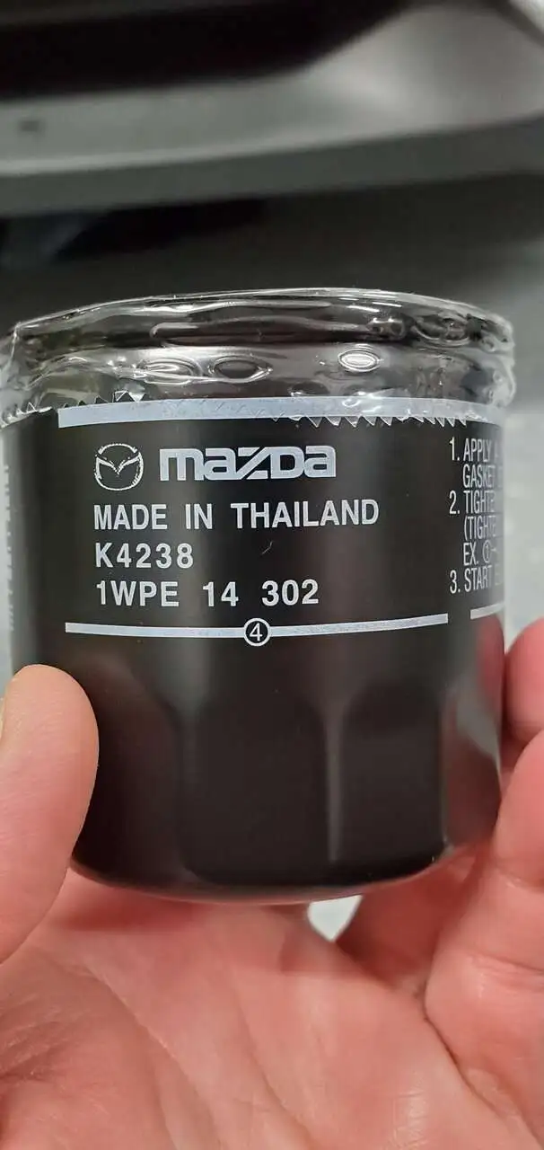

Fortunately, I had a Made in Thailand # 1WPE-14-302 in my cabinet and used that.
Huge difference in the quality of the oil filter holes on the two filters. The Made In Mexico filter should be recalled as the filter holes are non existant and most of the oil will bypass the filter element. Lesson learned. Will only go with the Made in Thailand or just get a Wix or Mobil 1 filter going forward. The Mazda dealer is sending out these filters on cars and who knows what the long term damage will be?

what do you mean holes are closed?
its not clear but from the picture holes are visible.
there is a membrane usually. same on the factory oem
Depending on the engine, some filters spec out an anti-drainback valve, some don't. Not sure which engine gets which though, but that absolutely is a thing.
I think he's talking about the perforations on the ID, not the end.
It's hard to tell though, they might not be straight through, but more like 'louvered' punches.

aha that makes sense :) didnt see that on my mobile phone. With the zoom its a bit more clear.

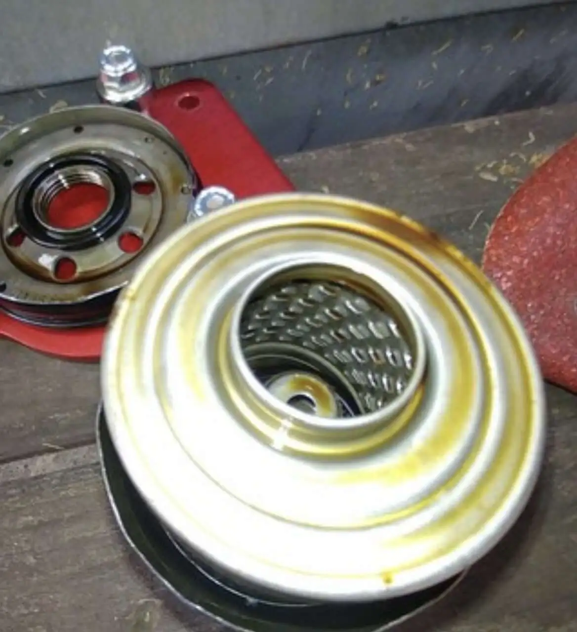

Interesting internal construction. There was a cutout picture of the Mexico filter on other forums. may be a comparison will show if thats how it is or this one is defective indeed.
While I didn't check the mexico filter(it was all my dealership had), I can assure you the oil still passes through, even when not under pressure. I always fill up filter before install and pour oil into the center of filter...it soaks in and I need to keep adding oil until the filter is 3/4 full. If the oil seeps through the "louvers" without pressure, it should easily pass when under pressure with engine and oil pump running. While I agree the Thailand filters appear better and I plan to get some, the mexico filter is in no way appears to be extremely detrimental to engine, at least short term.

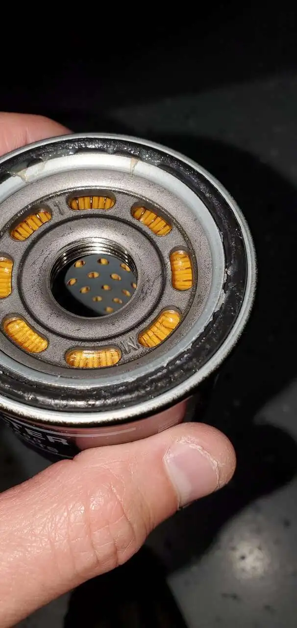

here is what I found. not the best picture but its clear how it looks.

I agree, if they are louvers, oil flow should not be an issue.

Yes, the louvered slots, most of them are not even open. The remaining ones are barely open. Unlike the Japanese and Thailand filters, which have numerous large round openings.

If the louvers are CLOSED shut, how are they supposed to work?
More than half the louvers in this filter are closed due to a faulty punching system at the factory. I've seen plenty of louvered filters and they are fully punched and open. I don't have an issue with properly punched and open louvers. These louvers were not punched properly and are closed shut. The picture doesn't show it clearly but I viewed them under light and they are closed shut.
I have to agree with littlebear / Lbear that at least this Mazda OEM “Value” oil filter he just got is defective. There‘s no way an oil filter has so many “louvered” punches in its internal filter element. I do believe it’s an isolated case and it definitely will restrict the oil flow once it’s installed. Remember the uniqueness of Mazda OEM oil filter used on SkyActiv-G is “High-Flow”, and it won’t work like a “high-flow” oil filter if there’re “louvered” flow holes!
Please contact Mazda North American Operations and complain. This make us questioning that how does Mazda handle the QC at least on its OEM parts, and they shoul simply drop the entire line of “Value” parts!

I always chose the Thailand Filters
1-wpe-14-302
and have never had an issue. The Japanese filters do not seem as easy to find in N. America.
