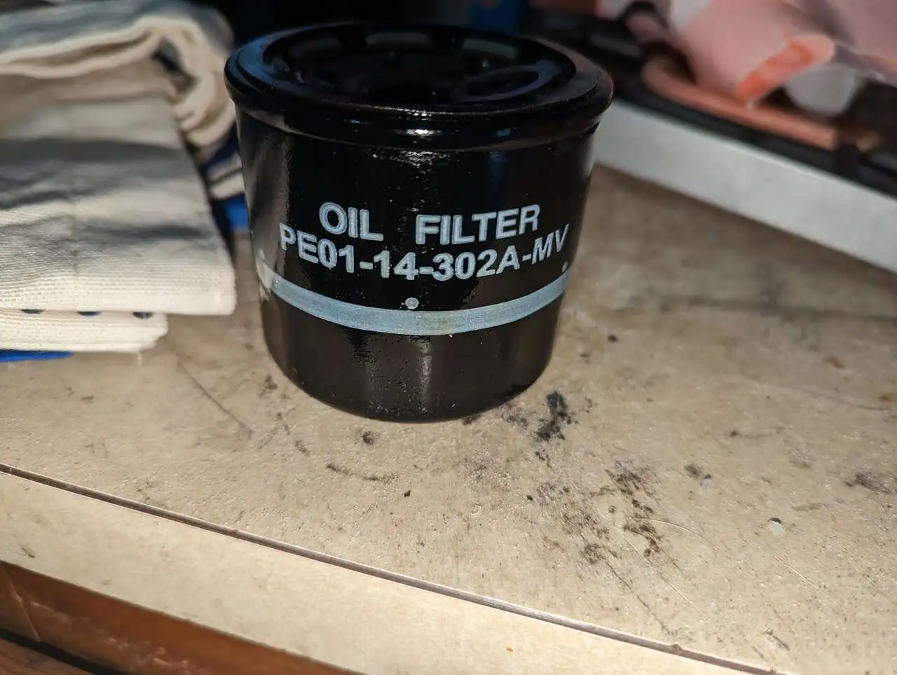

Just did the first oil change on my 2019 cpo Touring. This is what came off the car. If the dealer is using these I’m going to say these are safe to use. I replaced it with the same model number.

That is a VALUE filter, the lowest quality and cheapest of the 3 versions. The dealer only uses it to make more profit on the service since it barely costs them anything, not because its the best choice for your engine. Personally, I don't buy or use anything that is "value" line when in this case you should spend the couple extra bucks and get either the Thailand made filter, or best Japanese Tokyo Roki filter and not have to think about whether this Mexican made filter is any good with suspect quality.

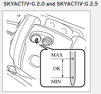

Obviously, if you have a preference to fill to the max line, you may need more oil. I think most would agree that being too close to the min mark is unacceptable. Usually I fill to at least halfway between the holes and it's perfect for 8000km OCIs. But we're getting off topic at this point. We do have other threads that cover this topic if you guys want to continue the conversation there.

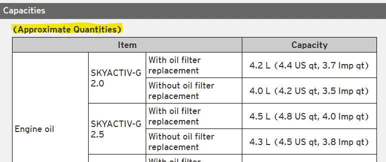

Yes - I ike the oil fill topic ! Its a " grey " area indeed -- Dealers tell you one thing ,and actually filling with exact spec amounts puts the level 3/4 up closer to the max line - ( at least on my N/A ) - It calls for 4.8qts w/ filter in the 23 owners manual - I put 4.9 -- its still acceptable but not at max. There must be overfill tolerances that exceed 1/2 quart
5 quarts puts my 2022 CX-5 half way between full and 1 quart low. Is this a factory attempt to kill DIY?
