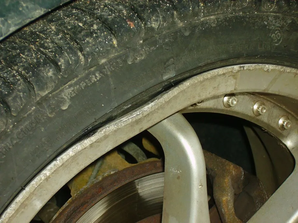

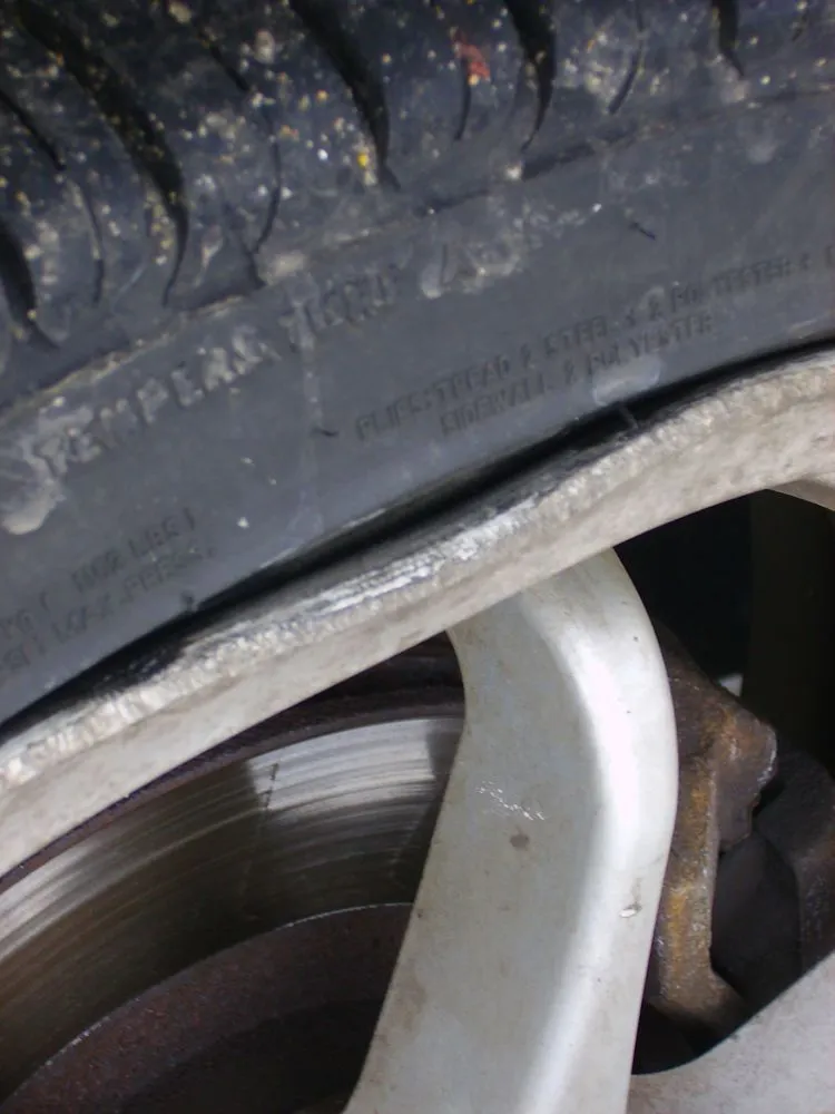

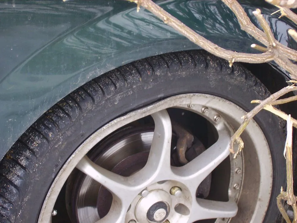

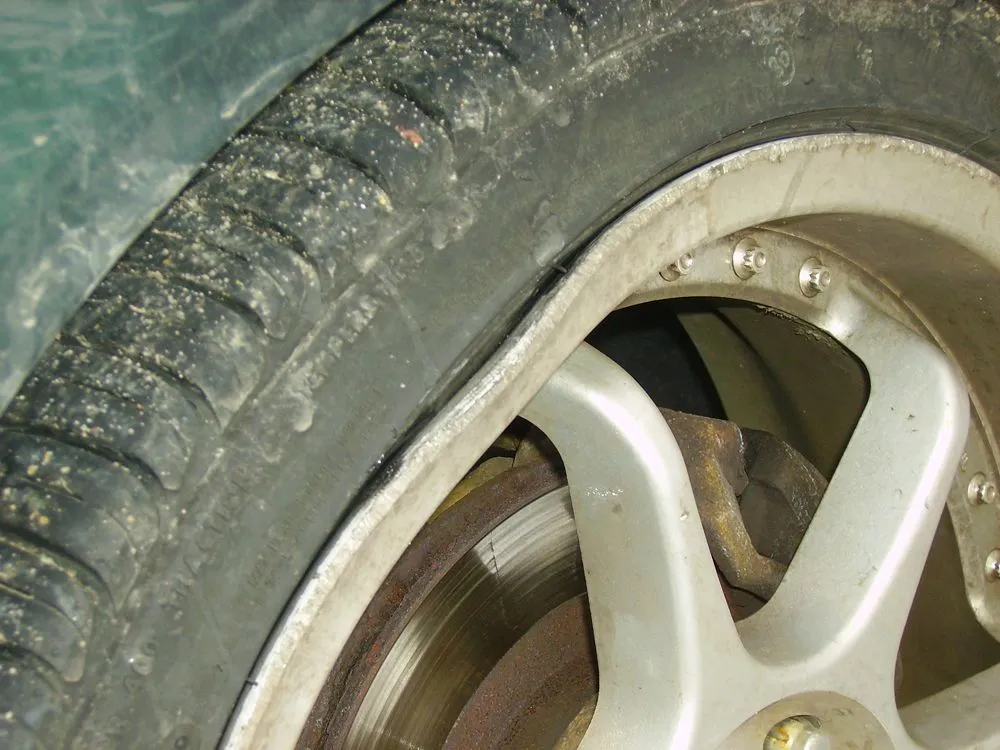

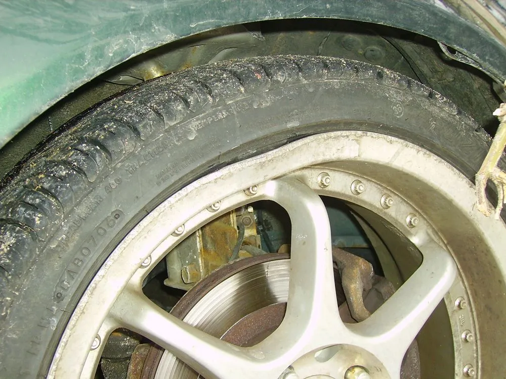

so this is the dent that i'm talking about...there's a lot of curb rash there too, but you explained how to fix that so well that i was wondering if you knew how to fix this?
yeah a pothole did this when i was going under an overpass where its dark and didn't see it...i was surprised that it didn't pop my tire...it does leak slow, like every two weeks i have to fill it back up (not that much of a biggie, but still prob not good for the tire)...
any ideas?

that looks pretty bad
you should maybe send it in to get repaired or something
doesnt ur state have something to file a claim for pothole damage?
hawaii does
heres a link to the process in hawaii which may or may not be similar to whereever ur from
http://www.forumshawaii.net/vbb/showthread.php?t=311055
my rim has this dent but it didnt seem to affect my car at all
That rim is definitely bent...I know there are companies that specialize in fixing bent rims, so I would do a google search in your area...it will probably be pricey (it might even be cheaper to replace the rim) but I would get it taken care of one way or another. Is it a front wheel and are you getting vibration from it? I would switch it to the back to avoid drivetrain vibration.
there's really no wobble or vibration at all, the only thing is that i have to do is fill it back up every once and while from air loss...
but it is prob a safety issue in the future...
i'll see what i can do when i rotate my tires.
