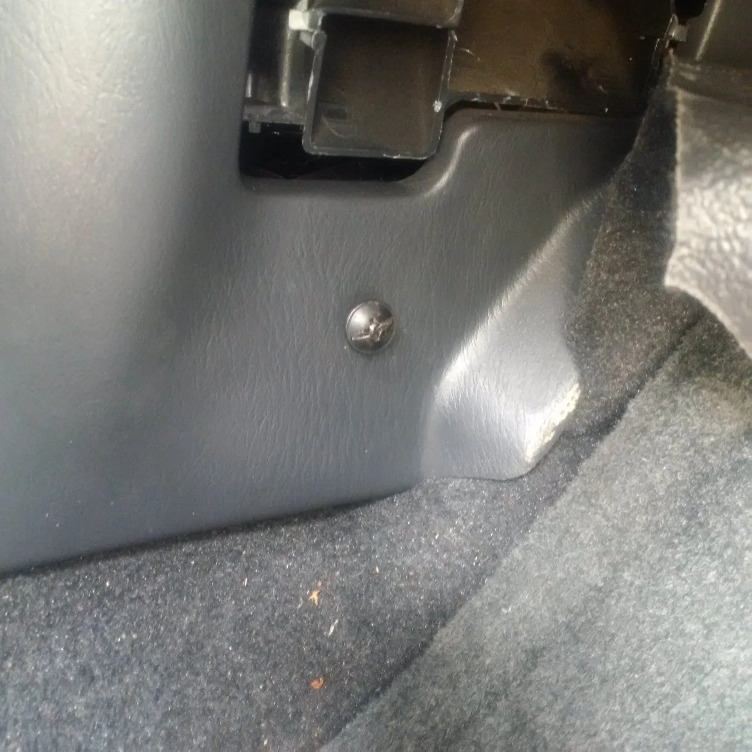

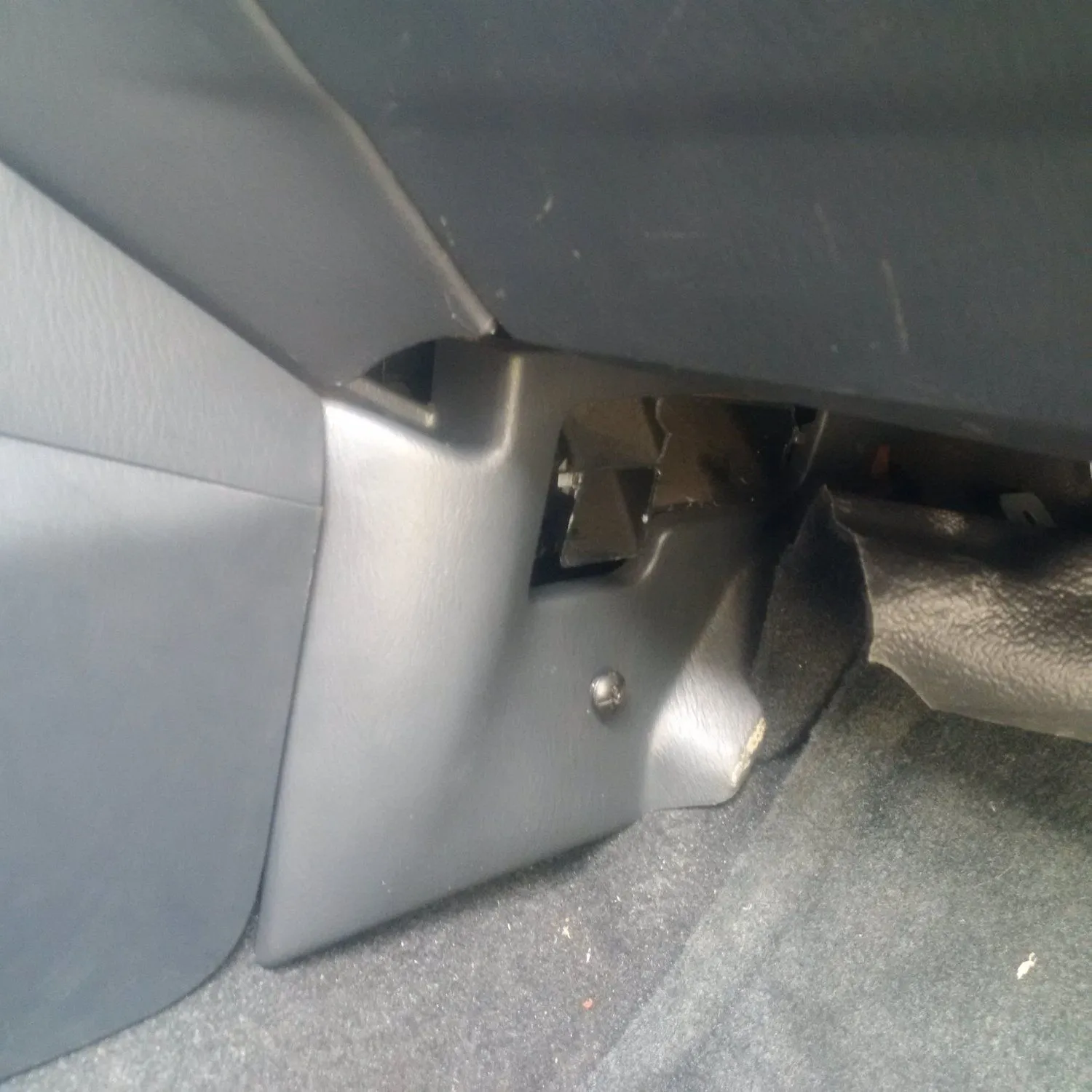

Hey guys. Based on some research on this forum, I beleive the a/c drain is clogged on my 2003 P5. I believe it is behind this piece of trim on the passenger side. I loosened the screw and it is really loose on the left side, like it should come right off. It seems stuck in the top right corner however, not coming off. Any idea why?

... I loosened the screw and it is really loose on the left side, like it should come right off. It seems stuck in the top right corner however, not coming off. Any idea why?
There is a plastic hook/tab on the plastic cover.
You need to pull the cover towards the seat to remove it.
I looked behind that cover and I couldn't see a drain tube.

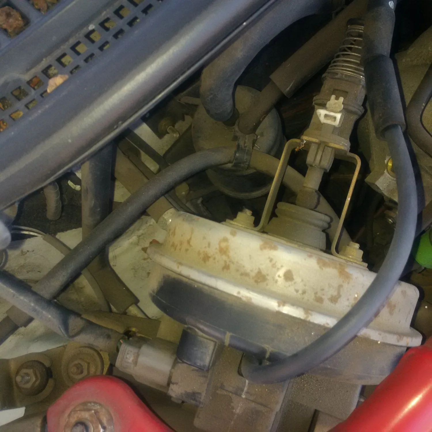

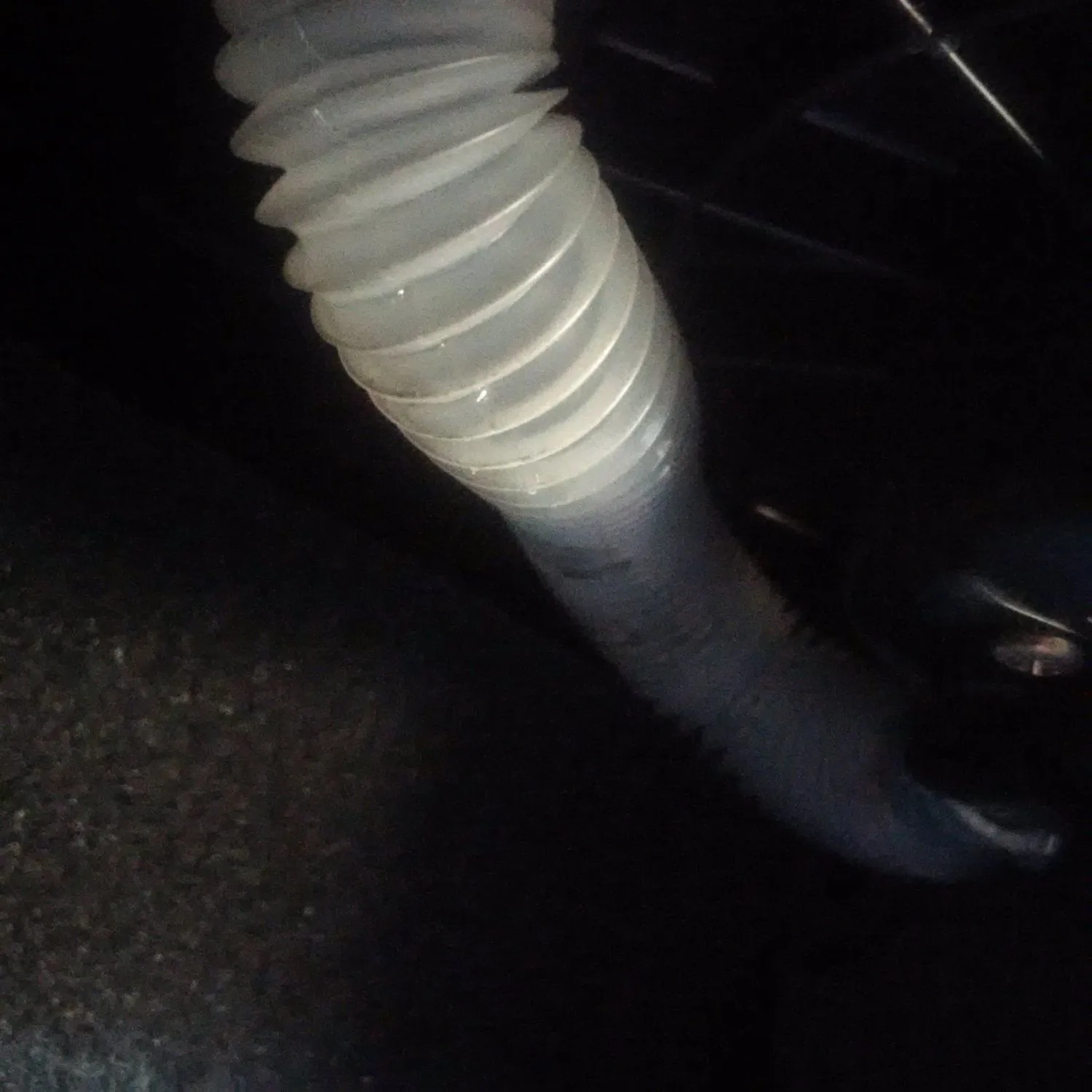

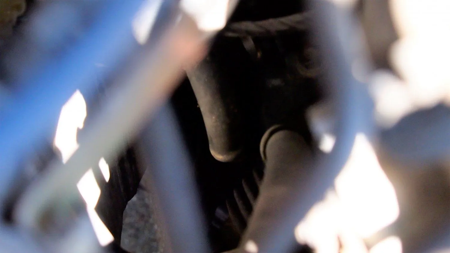

Thank you for your help. I guess I was chasing down the wrong hole. I checked the engine bay and think I may have found it. There is a short rubber tube coming out of the cabin on the passenger side, roughly in the right place. I tried capturing a picture, but it was difficult because it appears hard to access underneath other parts. Do you think that could be it, in the second image?

I don't really know?
Does your carpet only get wet when the AC is on, or does it get wet when it rains, ?

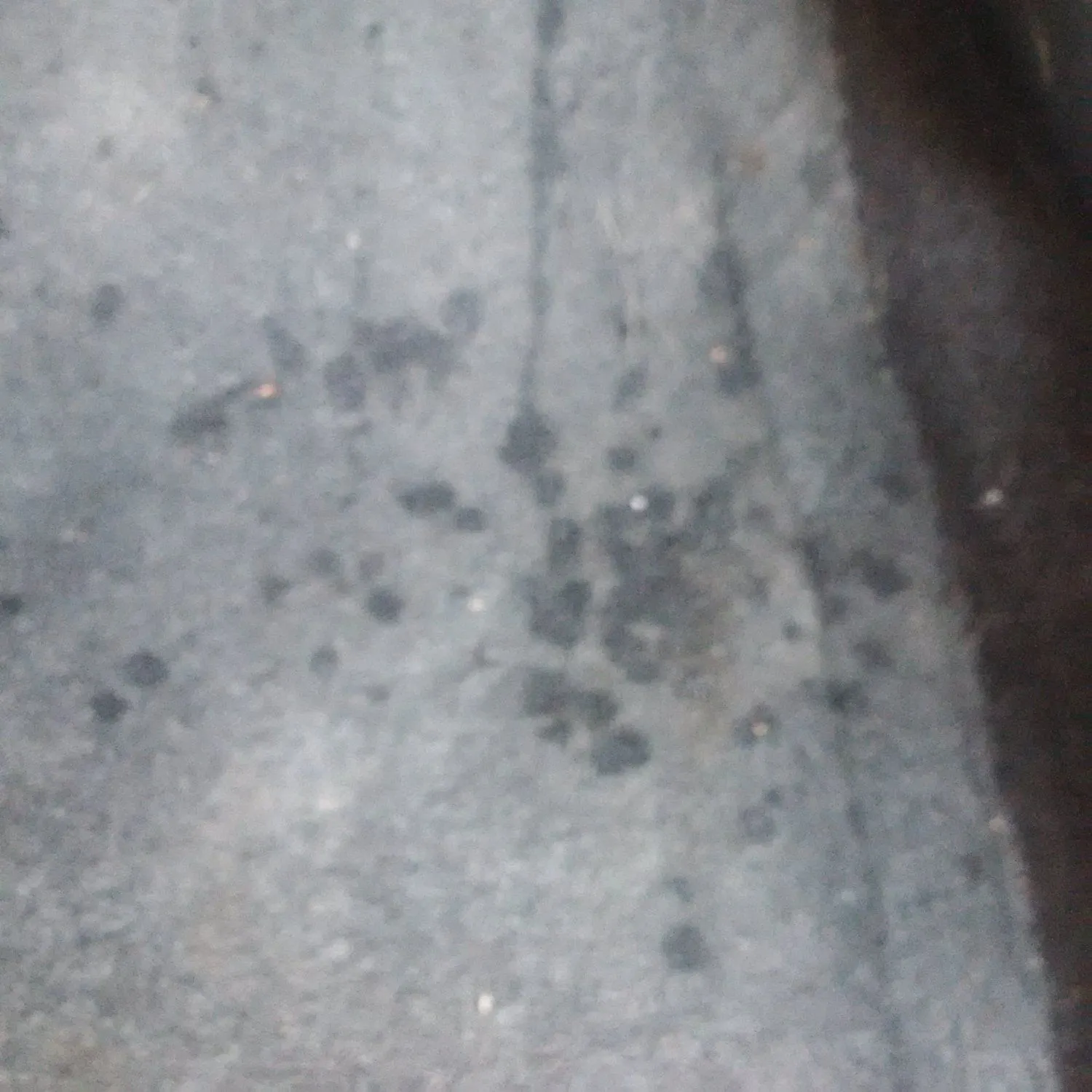

Only with the ac running it drips from the ac down into the passenger footwell. I am quite certain that it is the ac, since it hasn't rained in weeks and I have not driven through any standing water. The first picture shows the area underneath the glove compartment.

It seems to be an issue with other Mazda models as well, such as the Mazda 6 and CX5, that the ac evaporator core drain clogs. Then water builds up and spills eventually. I wasn't able to find a writeup for the P5 though

You can blow compressed air to clear the drain.
Thank you, I will check it out. I read about the compressed air or a bent coat hanger, but was having trouble finding the drain. If that tube in the engine bay is the drain, I am not sure that I can get to it.

If you are sure it's only the AC drain, then just try to blow it out.
I definitely hope it's not as bad as cheesehelmut's issue. I was able to squeeze underneath the car in the passenger wheel well and reach the drain from below. Blew some compressed air into it and water started coming out. Hopefully that took care of it. I'll have to see when I run the ac on my next longer drive if the water comes back.
