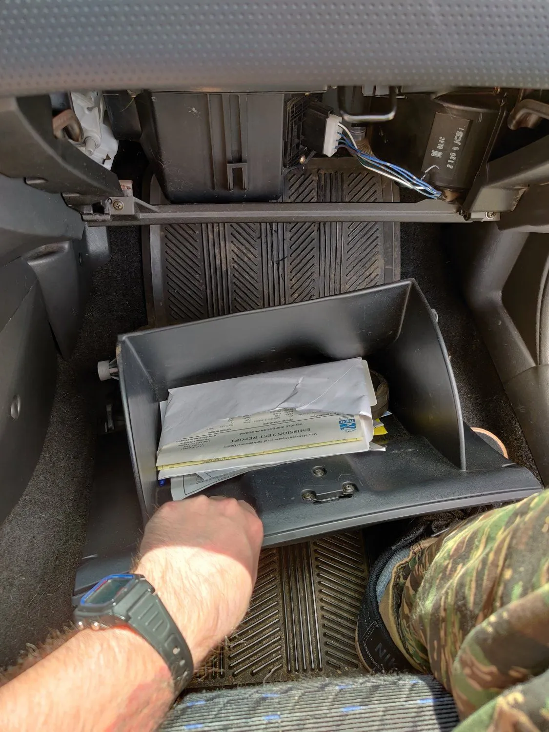

I kinda forget but I think you reach in and push the corners together and it releases it forward.
Helllls yea you guys rock. Lol hopefully can get it back on

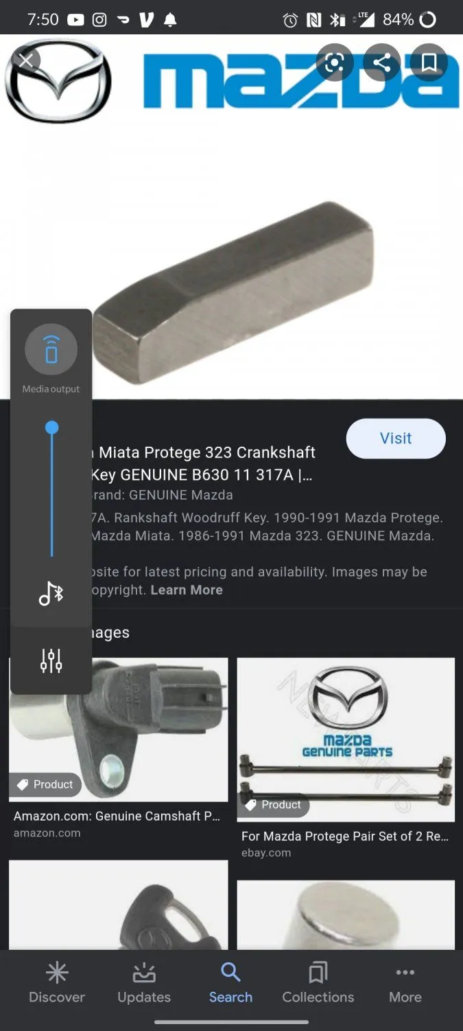

Do you have a torque wrench?
Source a new OEM crankshaft key and bolt and make sure to tighten it to the specified torque. Also apply a few drops of GREEN Loc-Tite -NOT RED!- to seal the threads.
Improper torque causes the harmonic balancer to wobble damaging the crank's nose.

No doubt. If I had to get a tow I may be out around 300 anyway or more. Okay thanks man I appreciate the advice. I love this forum already. You guys are really helpful. I'm gonna have my mech do the gasket and belt. Hopefully Ive got most of the parts. Still need that spring it looks like. Do I need any more belts and do I need that crankshaft key?
Just the two accessory belts.
Make sure you get the right ones. The ones for AC and power steering if you have those options.
(I think all P5s have both?).
I reused my crank pulley bolt and key.
