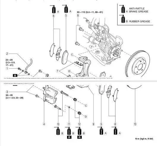

Like theblooms, I usually use OEM brake parts as most of time the OEM brake pad kit comes with all the necessary hardware and grease (not on Mazda though). You may want to get new shims、guide plates (springs)、and rubber dust boots (for slide pins as those are marked “R” in workshop manual).
Front:
Rear:
I use silicone-based AGS Sil-Glyde for “rubber grease” and moly based (black) brake grease for “anti-rattle brake grease”.
You need some brake tools to push front caliper pistons and push and turn rear caliper pistons making enough space for new pads. Watch the brake fluid level in brake fluid reservoir on brake master cylinder as brake fluid may be overflowing while you’re pushing the piston in. Some suggest to release the caliper bleeder valve to let the brake fluid out when you push the piston, but I’ve never done that way unless I plan to change the brake fluid in the system after the brake job. You can rent special brake tool set (especially for your rear brakes you need a special tool to “push and turn” the piston) for free from AutoZone.
Front:
Rear:
