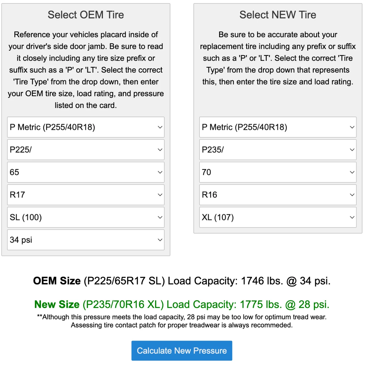

This calculator might give the best pressure:
G91A are 100H but I couldn't find that.
I put in P225/65/R17 and got 100SL. It sayds optimal load is 34 PSI. But I thought you could lower psi by 10% of OEM so 3.4 but I did 4.
I guess air back up to 34? What are the consequences? I dislike the harder ride :(
On the other hand I calculated snow tires at 235/70R16 with 107XL.
The Michelin X-Ice Snow SUV is 106T for reference and I was told the optimal is 28 PSI?

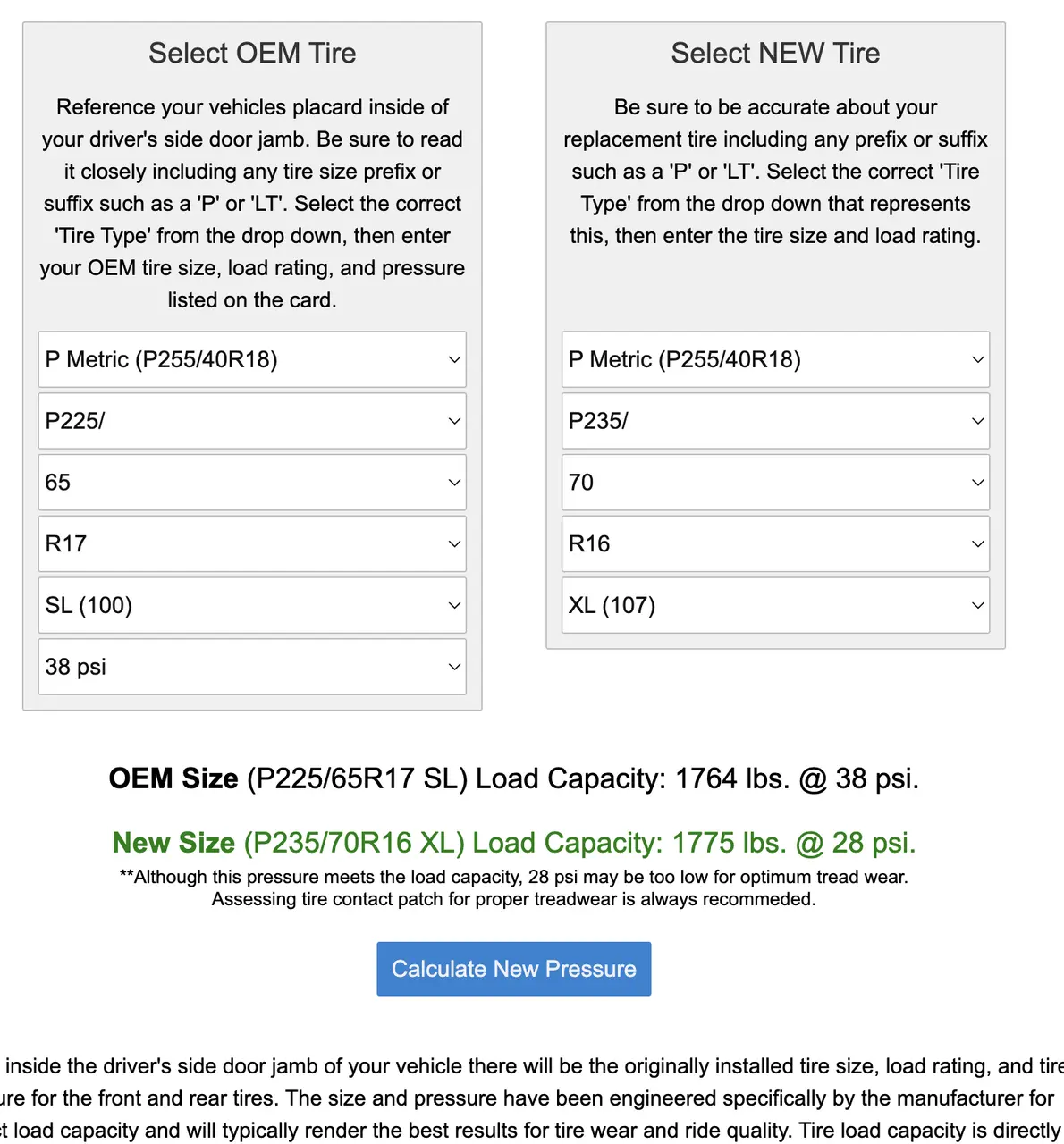

I believe Winter tires as a rule of thumb should be set 3-4 PSI higher than the placard so 38 PSI.
I still got 28 PSI.
Yeah, I don't know about the preferences the app has for the load, but there are other tire pressure calculators out there as well. Maybe try a few of the other ones to see how they compare.

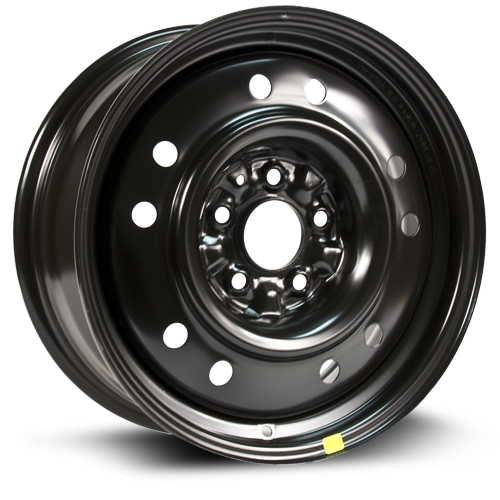

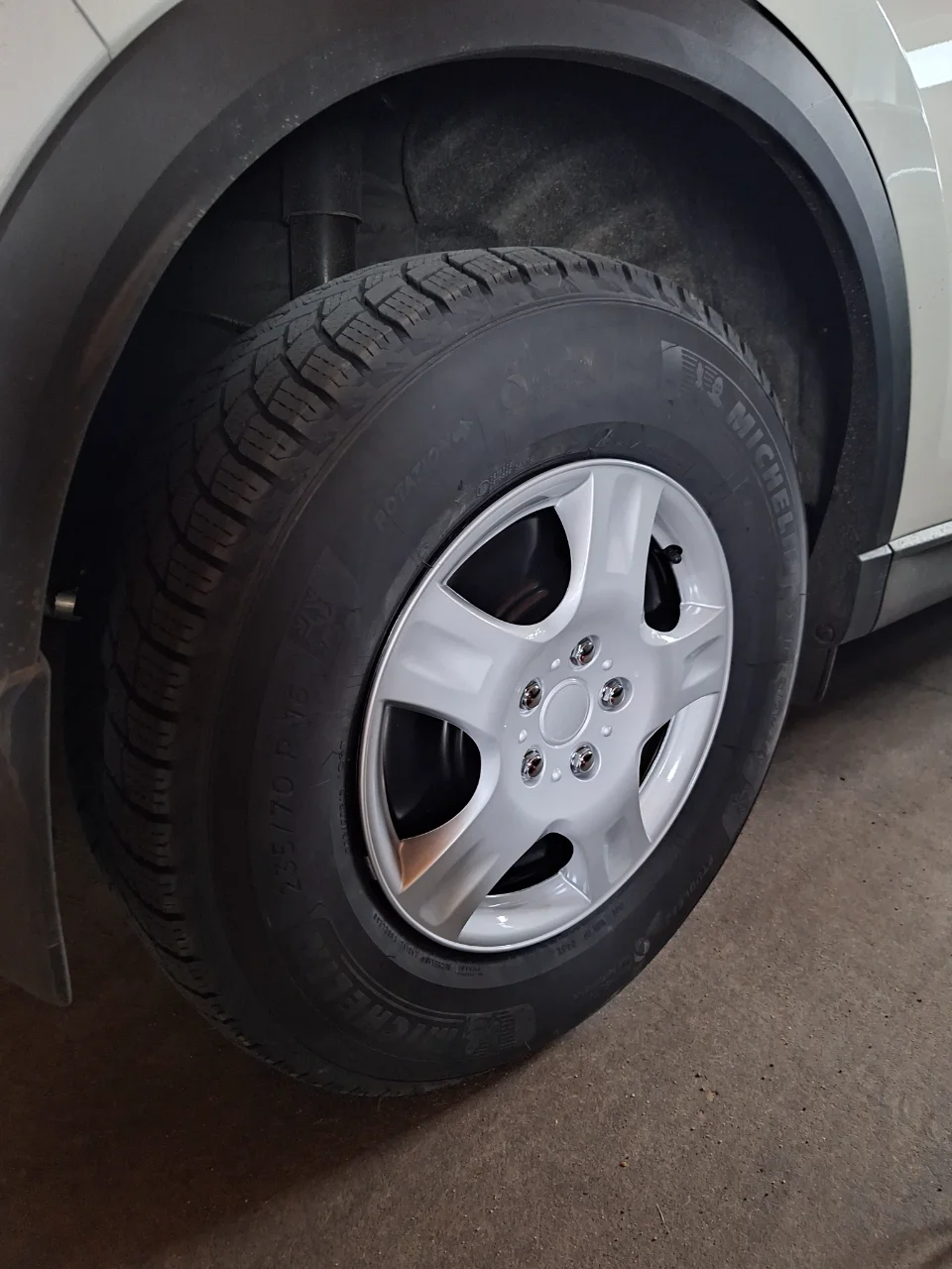

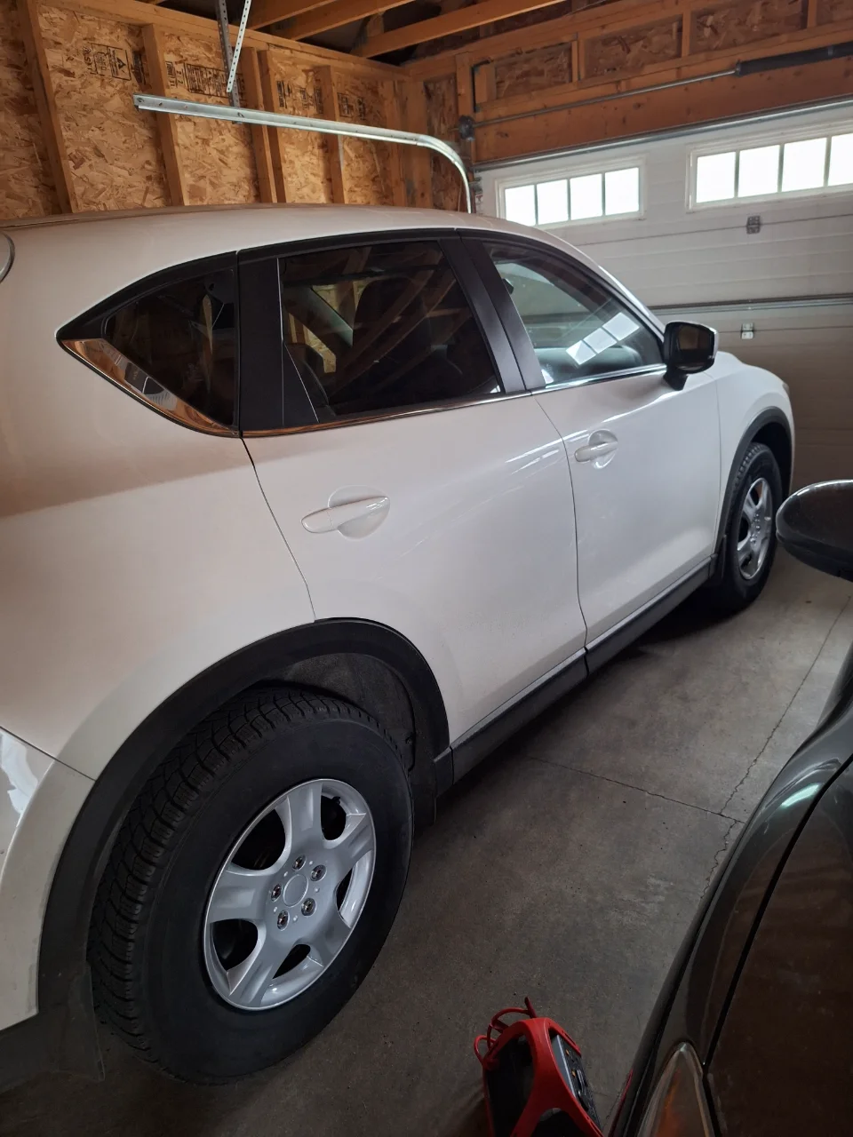

I just got new winters. Used $63 steel rims.
These are on Michelin X-Ice Snow SUV tires 106T (235/70R16) at 32.5 PSI.
This winter tire is a soft compound but surprisingly rides abit harsh vs the Yokohama Geolandar G91A 100H (225/65R17).
I was curious why this is. Shouldn't a thicker sidewall like the X-Ice Snow SUV be more cushy over bumps? Is it the load and speed index going from 100H to 106T which means a stiffer tread to compensate for heavier capacity?
Is it appropriate to power PSI to 30 but also winter is coming so I'll lose 1 PSI every month?
X-Ice Snow SUV tires made on 25th week of 2024 so fairly fresh.
Thanks

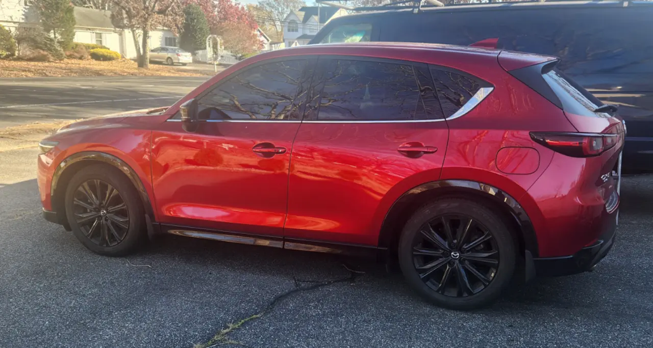

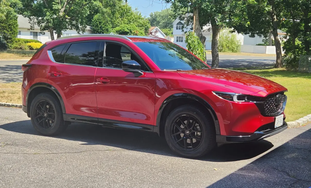

This is even with the 19in stock wheels. Ive have had 18s on the stock suspension before with good tires, but the effect was hardly noticeable. Which is what led me down the coilover journey. Pic with 19s lowered and pic when I had 18s on stock suspension for profs
