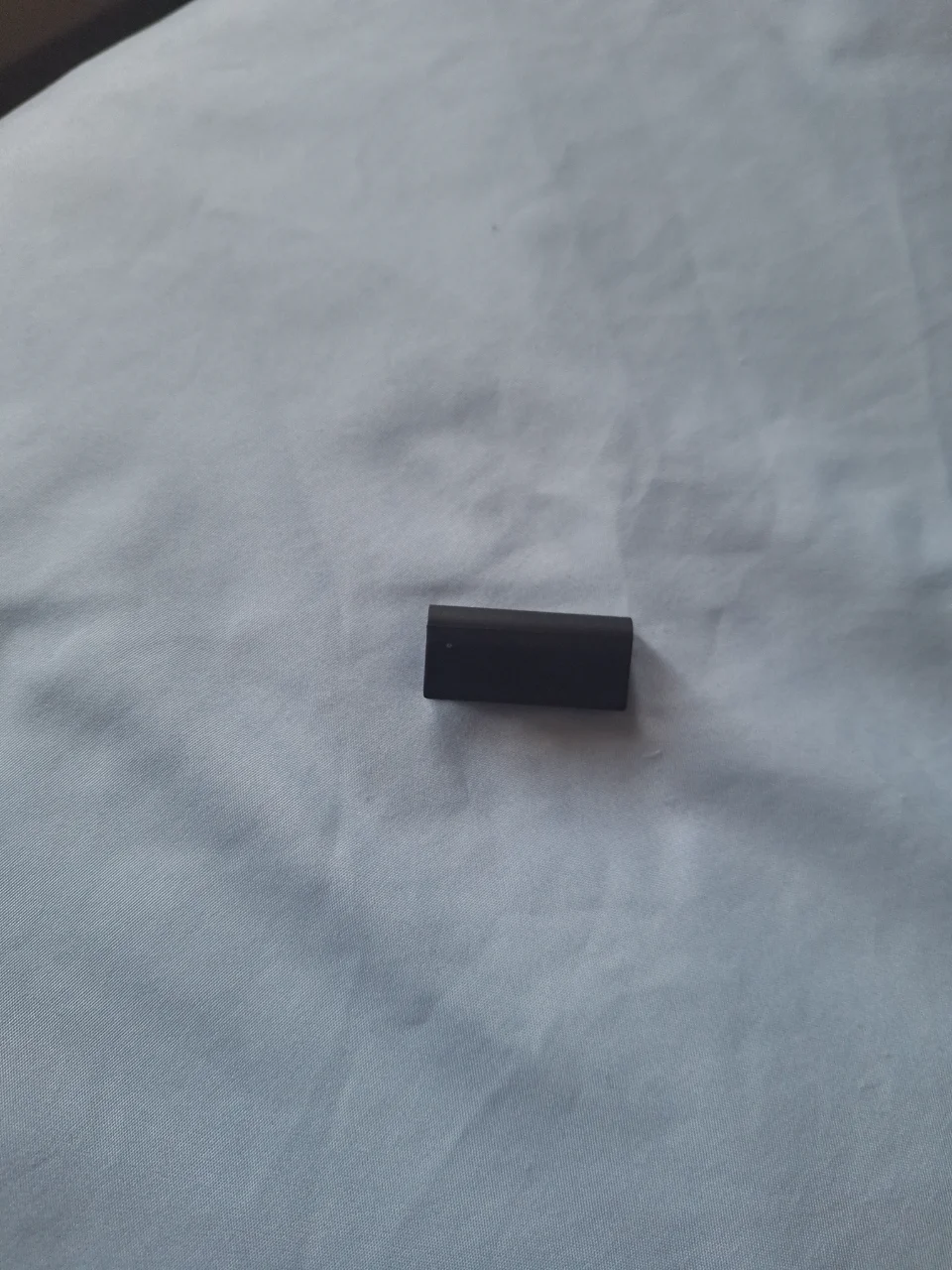

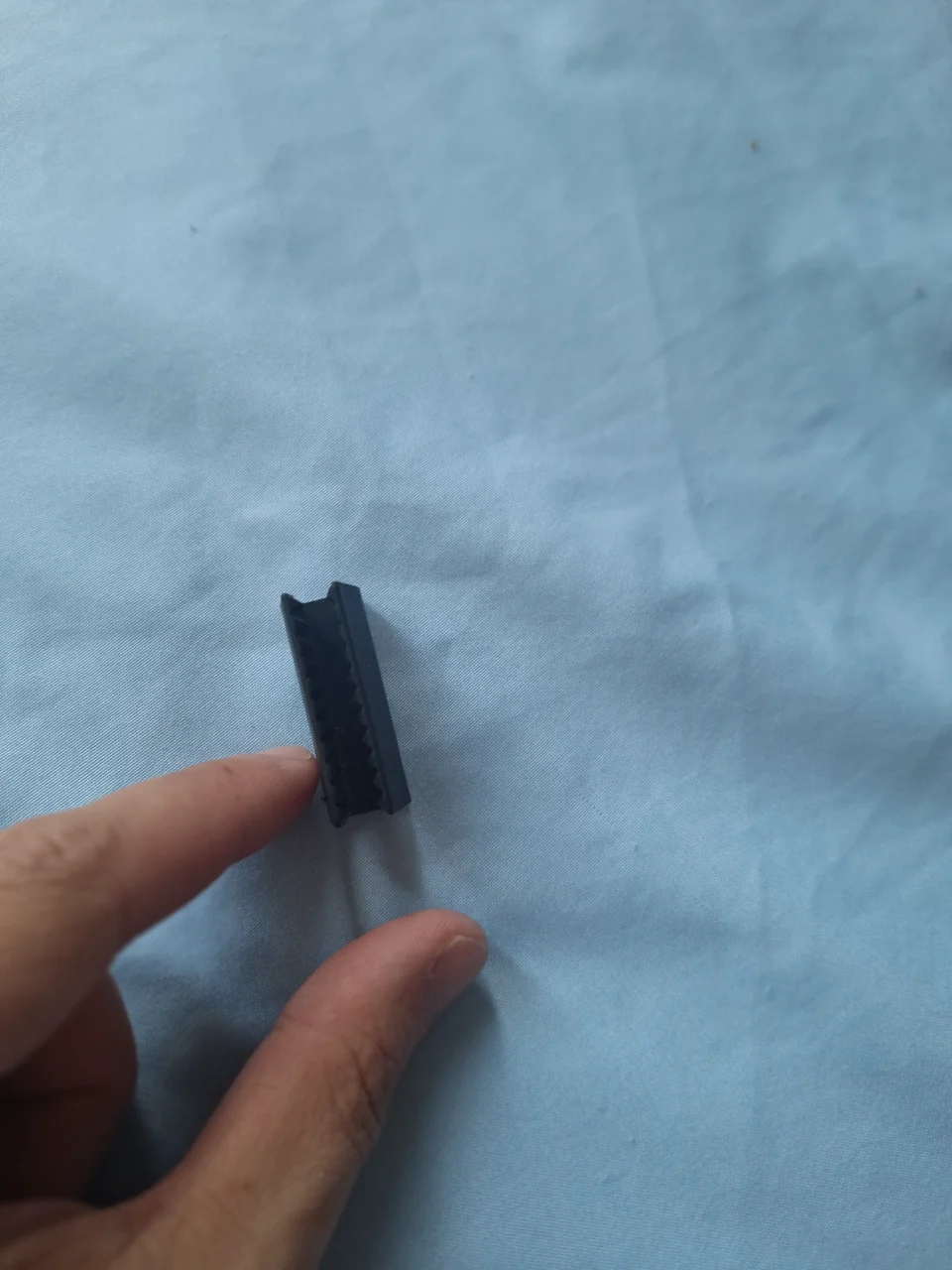

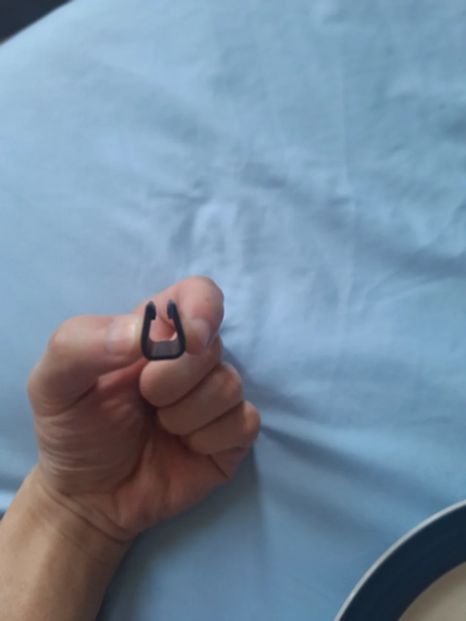

Also backseat had a clip that fell off during service. Could you help me identify what it was for?
