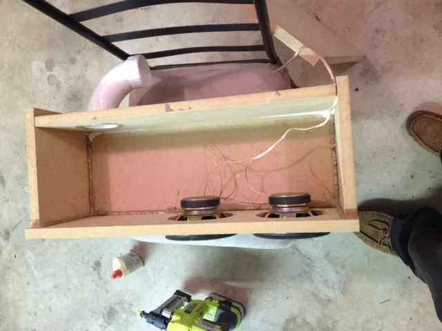

Well, here is the thing I have been working on. I am making a sub box for the 2 using the 2 6.5" door speakers from the Miata. It actually works surprisingly well. Ported box tuned down near 30Hz. Using an old Crossfire CFA142 amp. The main issue I have is that when I turn it up, there is a certain point where the radio just stops working. I mean the screen works just fine, but nothing comes out of the speakers. Anyone have any idea as to what that might be? I am thinking that the car has a current loop on the battery and if it sees too high of a current it shuts something down. I am planning on looking in the factory service manual tonight to see if it says anything.

Well I got the problem solved. In short because I spliced into the factory rear speakers for the input of the amp through RCA cables what was happening was that when turned up the voltage would be high enough to break through a diode in the amp which prevents you from having + and - slipped on the amp input. When you break through the diode it basically would short out the speaker signal which caused the radio to go into a safe mode. I added 2, 20Kohm resistors on the signal going to the amp to lower the voltage and it works fine. Sounds damn good.
