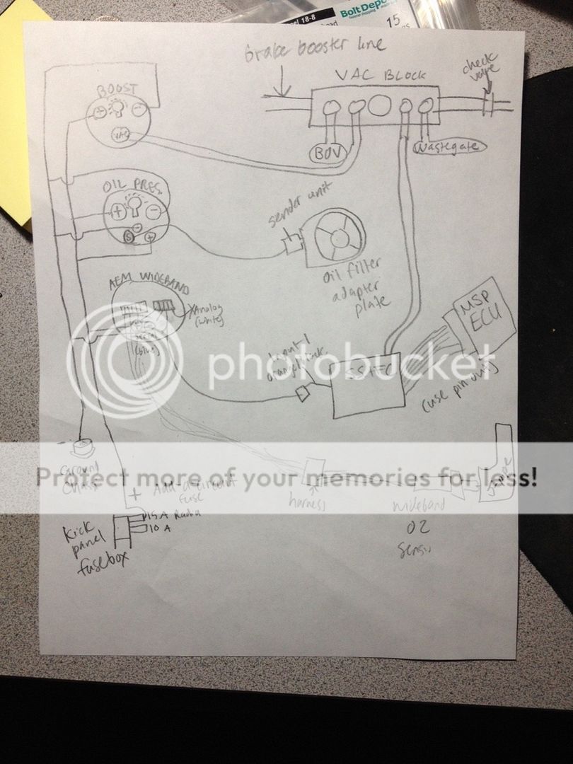

quick little update of the gauges installed
and here is a very useful diagram i created, took a few hours of research to piece this together.. some of you may already know this since it is pretty basic stuff but it will also help a lot of people out there looking to install gauges
