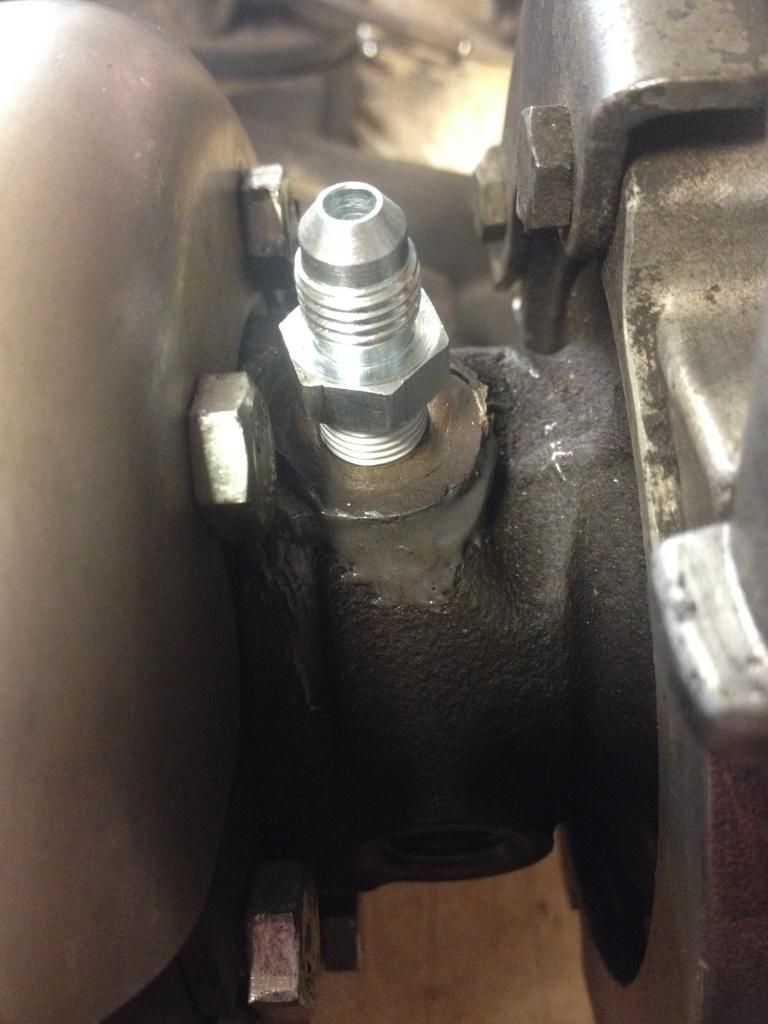

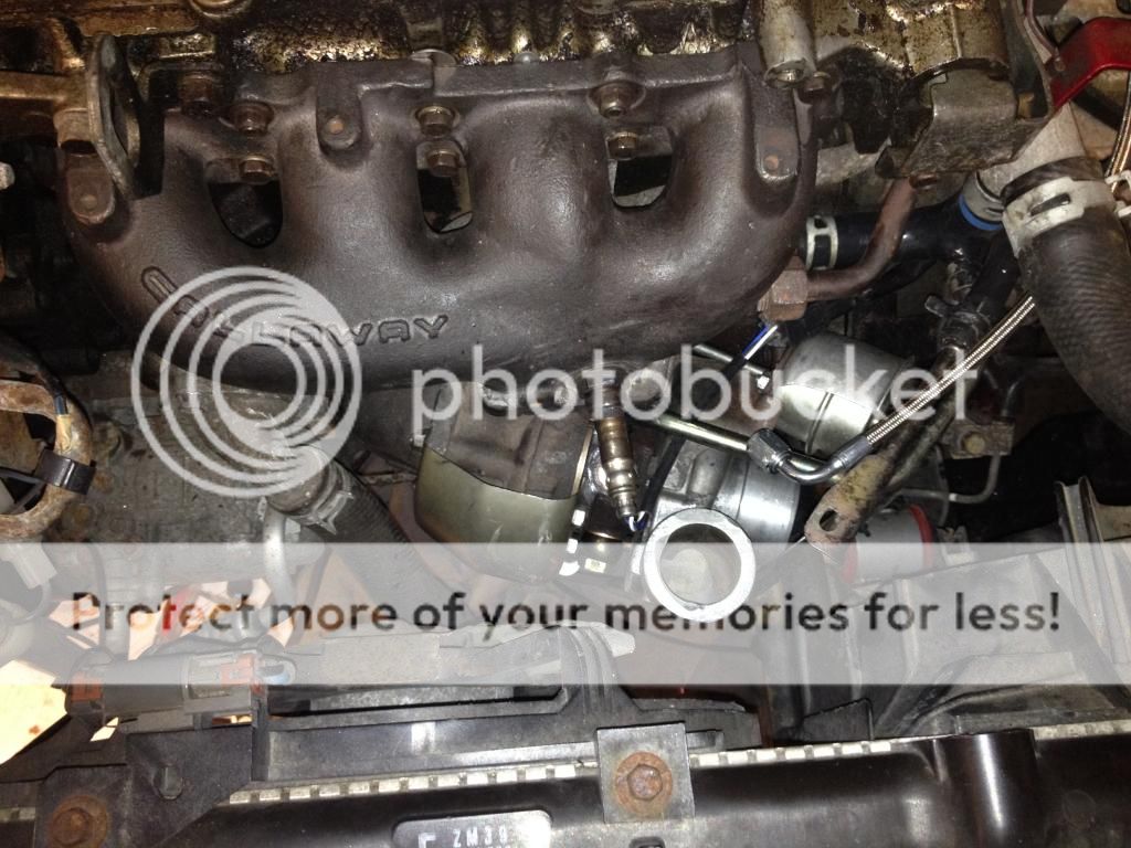

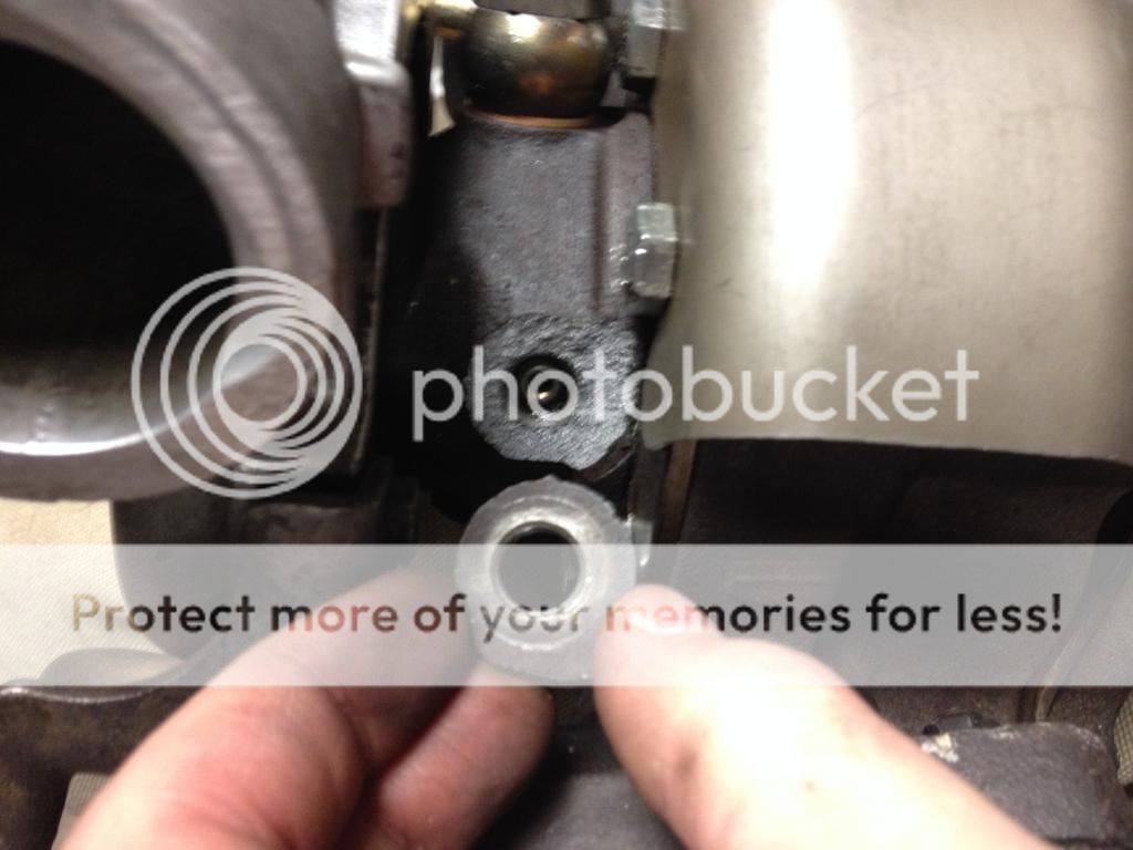

Oh no! Cast iron snapped on the oil inlet on the turbo
Its alright... maybe some JB Weld will hold up...
Lets hope that theres no leaks!
Ebay fmic piping... quite possible the best routing ever done on a p5, just saying... LOL!

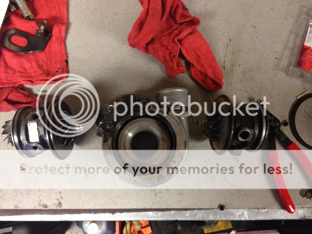

Long story short, thought I was done and was ready to go... JB weld failed and leak galore. shops couldn't weld it, not enough meat. Got a replacement CHRA from the g-pop shop, very good service from them!

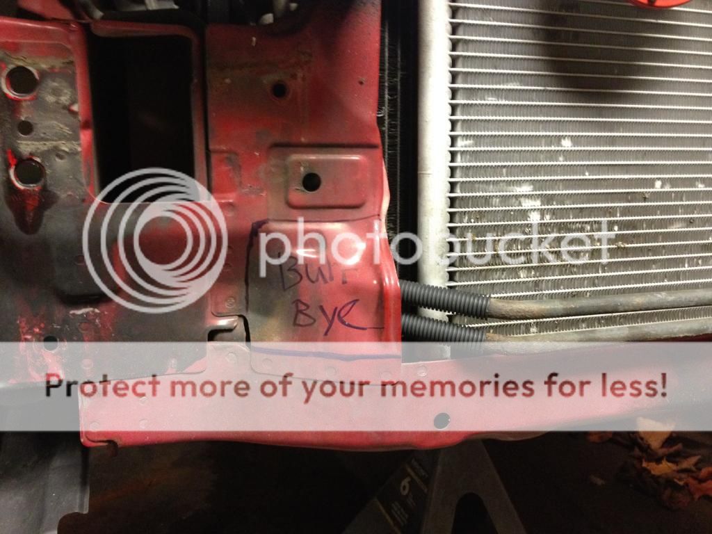

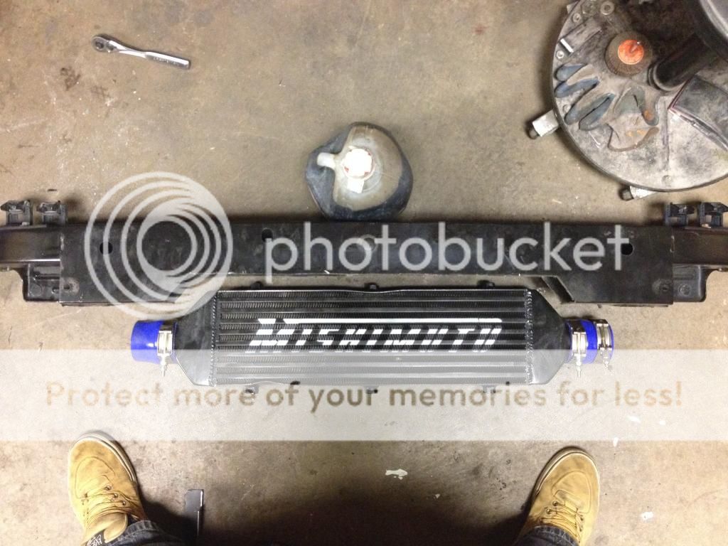

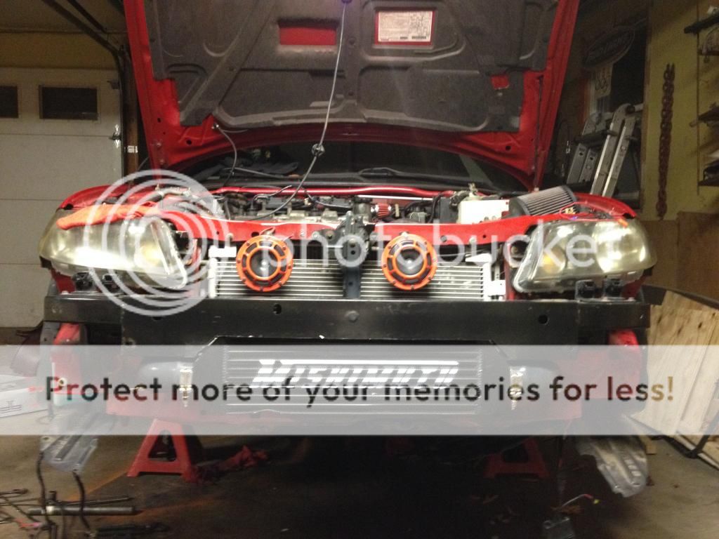

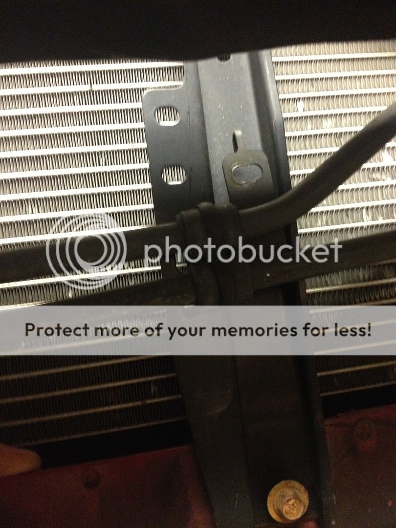

While I waited a week for the replacement CHRA to come in, I decided I better do it right this time... 1.5" notched crash bar for better fitment

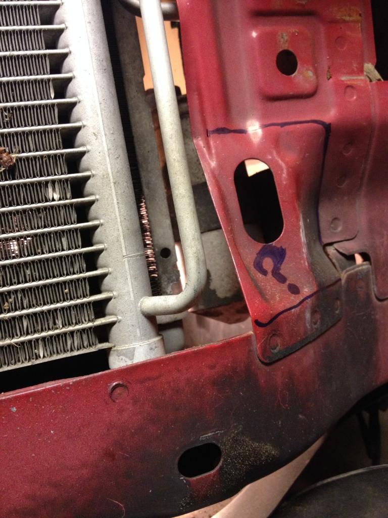

Just like the picture says... cut it out so the 90* couplers I ordered would feed nice and smooth like
wasnt sure what to do on drivers side, wanted to run up the hole for the CAI, but ended up cutting this out. very good decision!

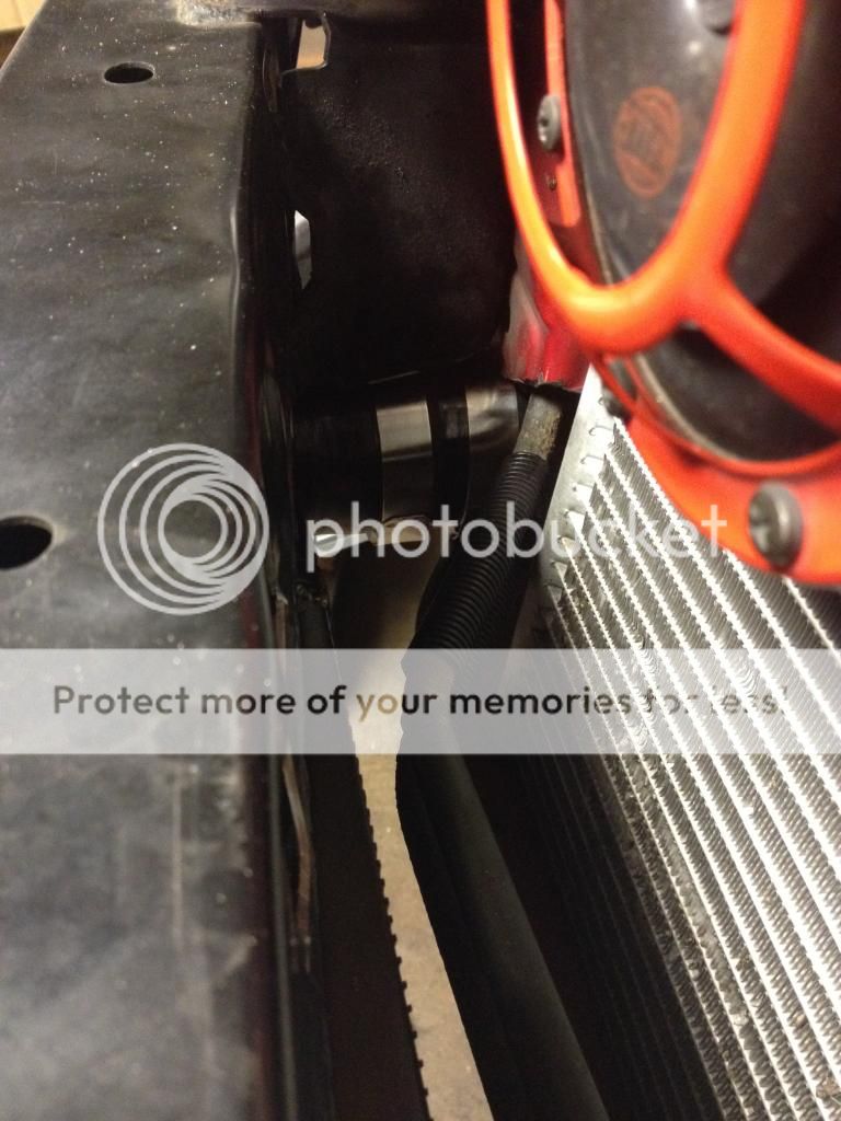

Notice the location of the A/C cylinder. this will need to be moved (see in later pictures). I disconnected both lines then rotated the cylinder 90* backwards, keeping the top facing forwards. use a self tapper and stock bracket to mount it in place, then bend the lines carefully to meet the top of it. the top of the cylinder should be facing forwards now.
This needs to be moved up.. used a self tapper to get it as high as i could to allow clearance in the cut i made

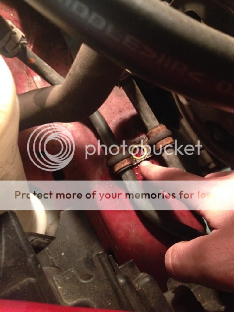

Make sure you take out this bolt and another one that are holding the lines in place... if i tried to bend mine they would SNAP!

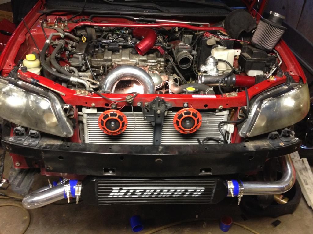

This is, imo, ideal placement for any fmic on a protege (depending on size of core)

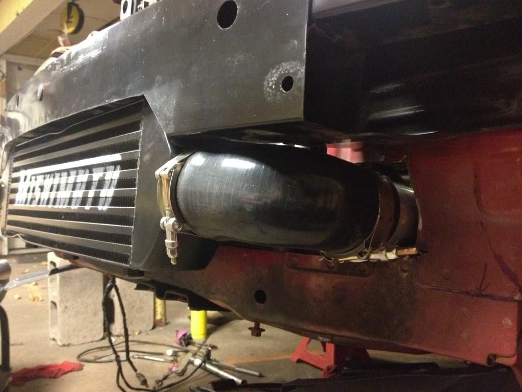

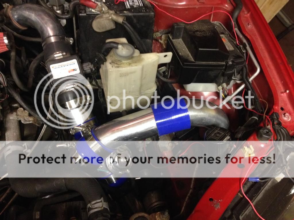

Some pics of how I routed it... I had an ebay piping kit with straight couplers and 2 of each of the following: straight pipe, U bend pipe, 90*, 45*

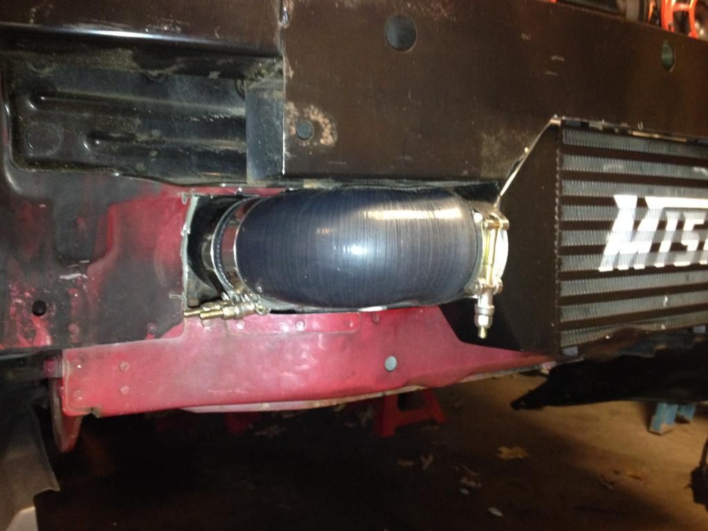

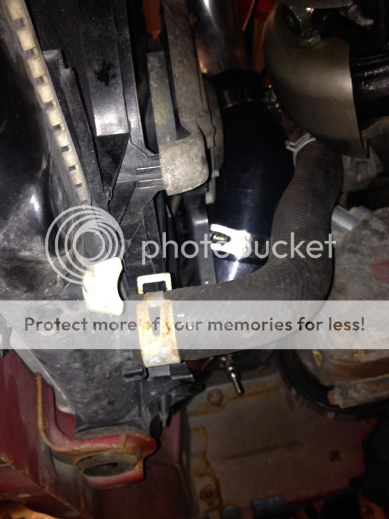

I ordered 2x 90* couplers and 2x 45* couplers.... for future reference I would recommend getting 3 of each to make your life a lot easier. i used both 90s off the intercooler and both 45s on the hot side so the cold side wasnt as good as it could have been but hey it still works

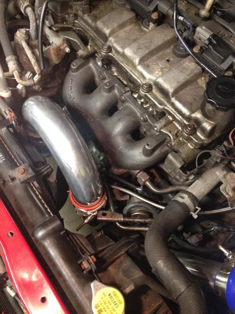

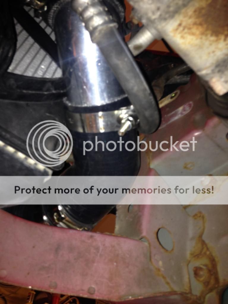

hot side
(from underneath)
cold side:
cold air routing... notice the a/c cylinder relocated
some more cold air

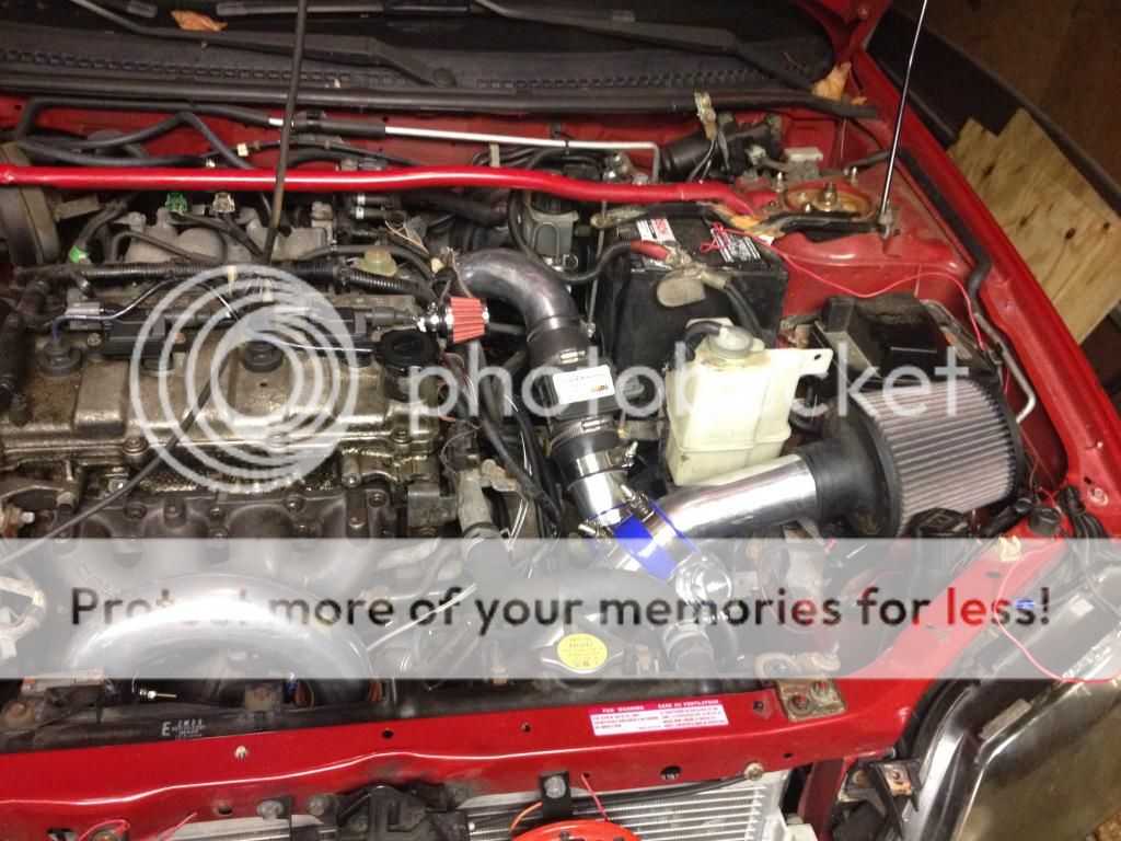

but in the end i decided to go short ram... i can interchange whenever i want with those pipes i cut and couplers. maybe in the summer

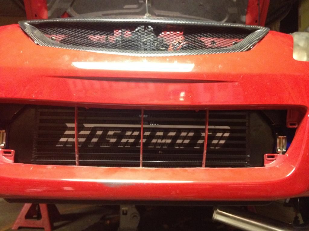

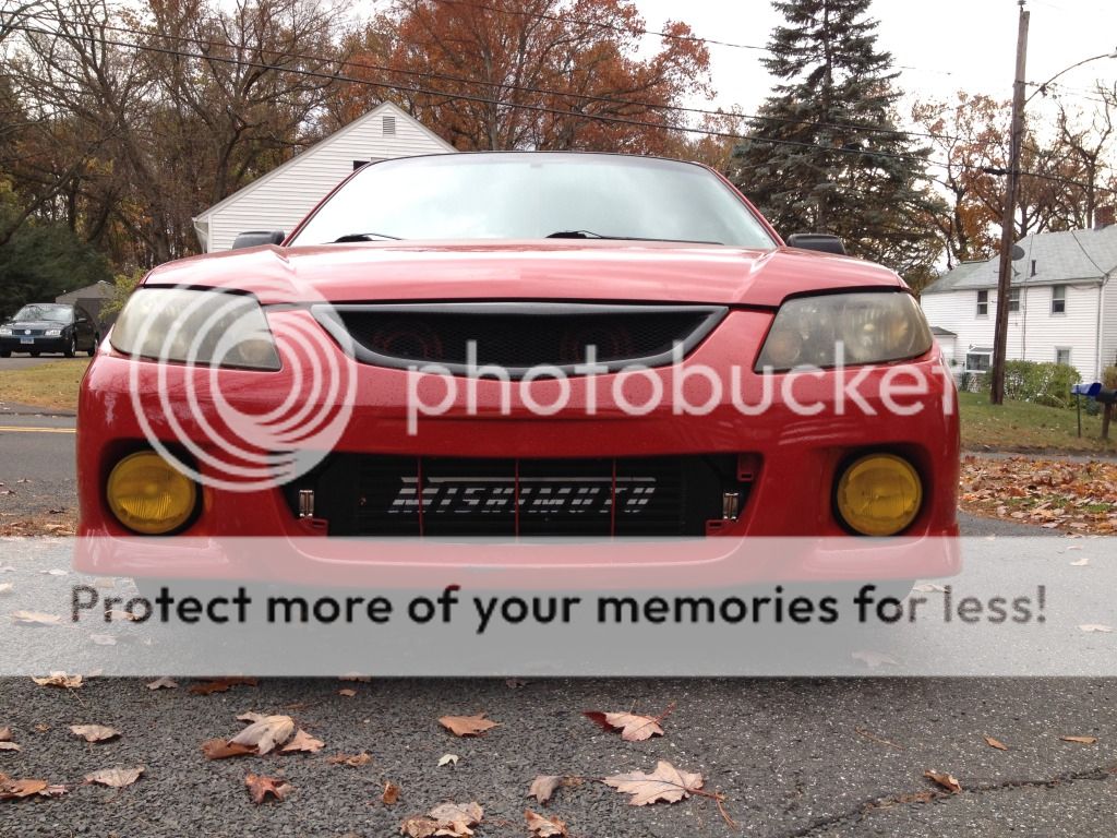

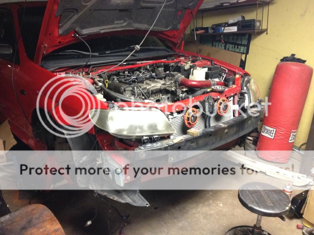

And here she is with the bumper on, such perfect fitment!

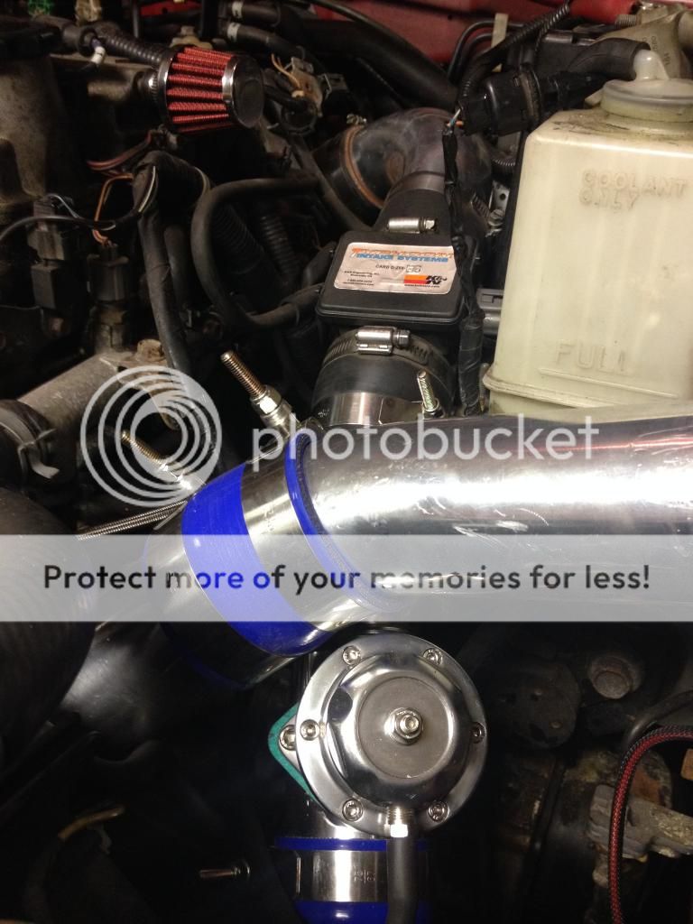

Road ready! I still need to redo my vac lines because I didn;t use the brake booster line. Probably going to run the BOV off the brake booster and also the wastegate . right now i have them both off the nipple sticking out of the top of the intake manifold.

also how did you attach the intercooler to the bar? also how are you going about with the oil return line? so far your build is coming out great and im asking because im planning on turbocharging soon as well
my headlights are due for a scrubbin
the crash bar has a top, bottom, and middle flat horizontal layer going all the way across. i notched it up to the middle one front and back side. measured and drilled holes into the middle layer and cut areas on the back of the crash bar to get a wrench on the drilled hole with a bolt and washers.
