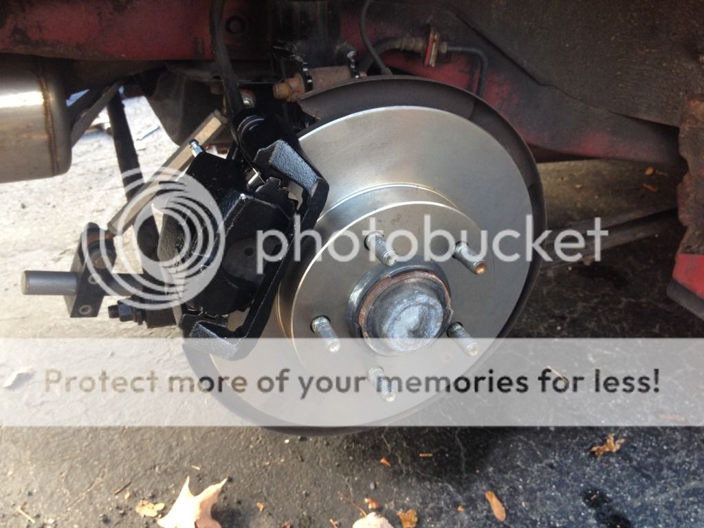

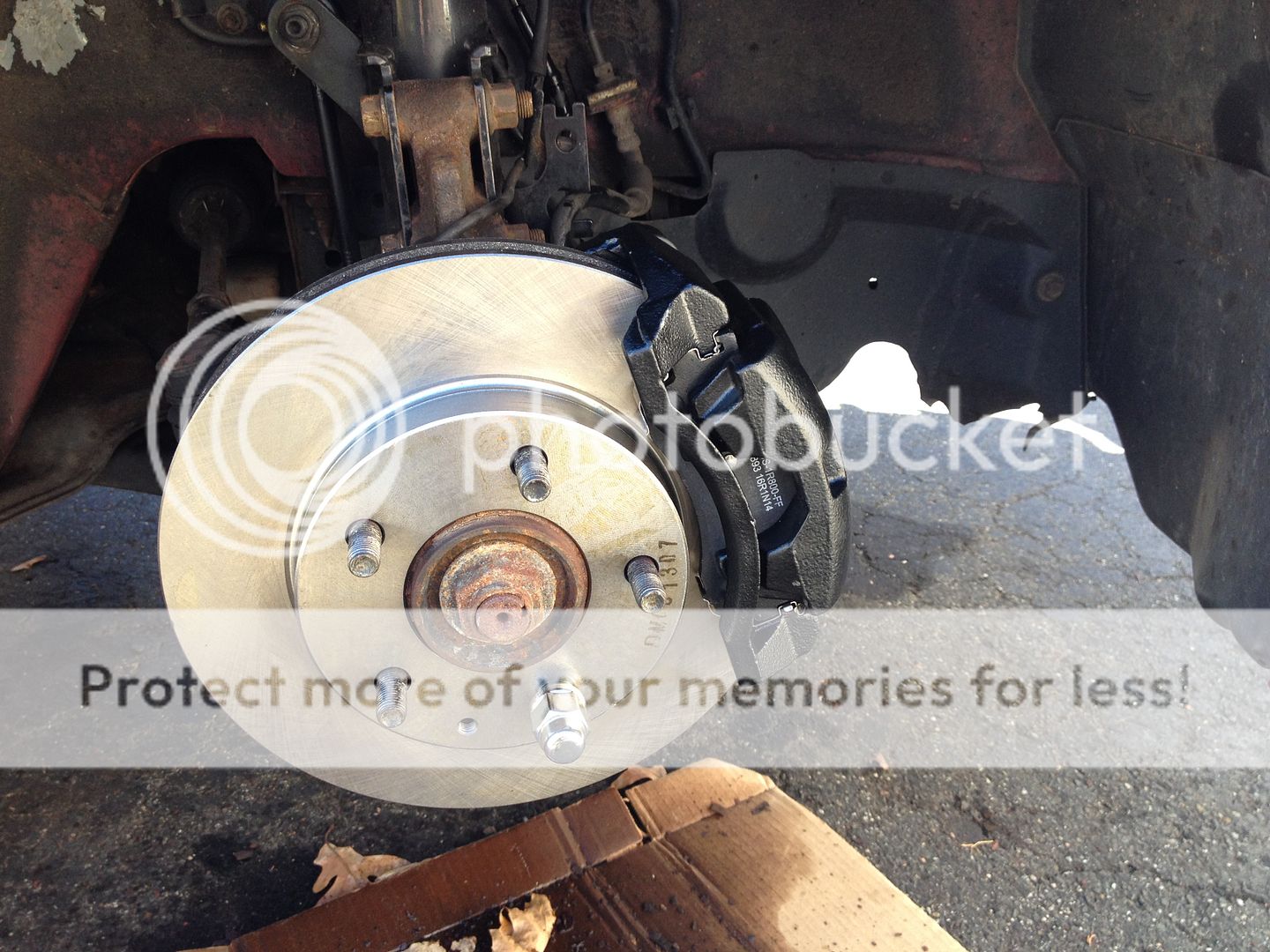

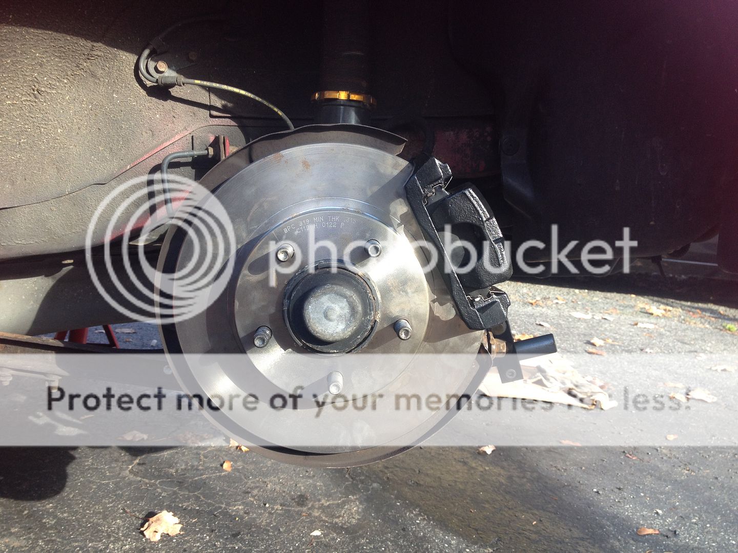

new rotors, calipers and pads all around and installed vibrant vacuum block in the brake booster line
