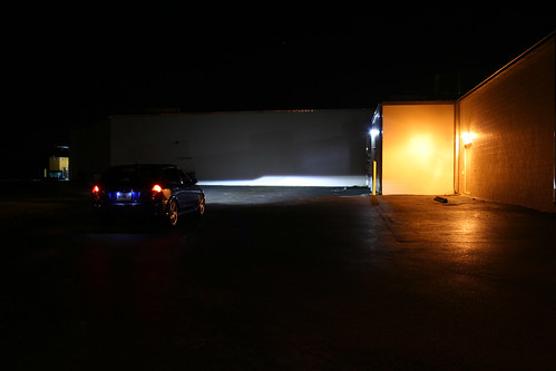

cutoff went from this
to this
Yes you can "NO"

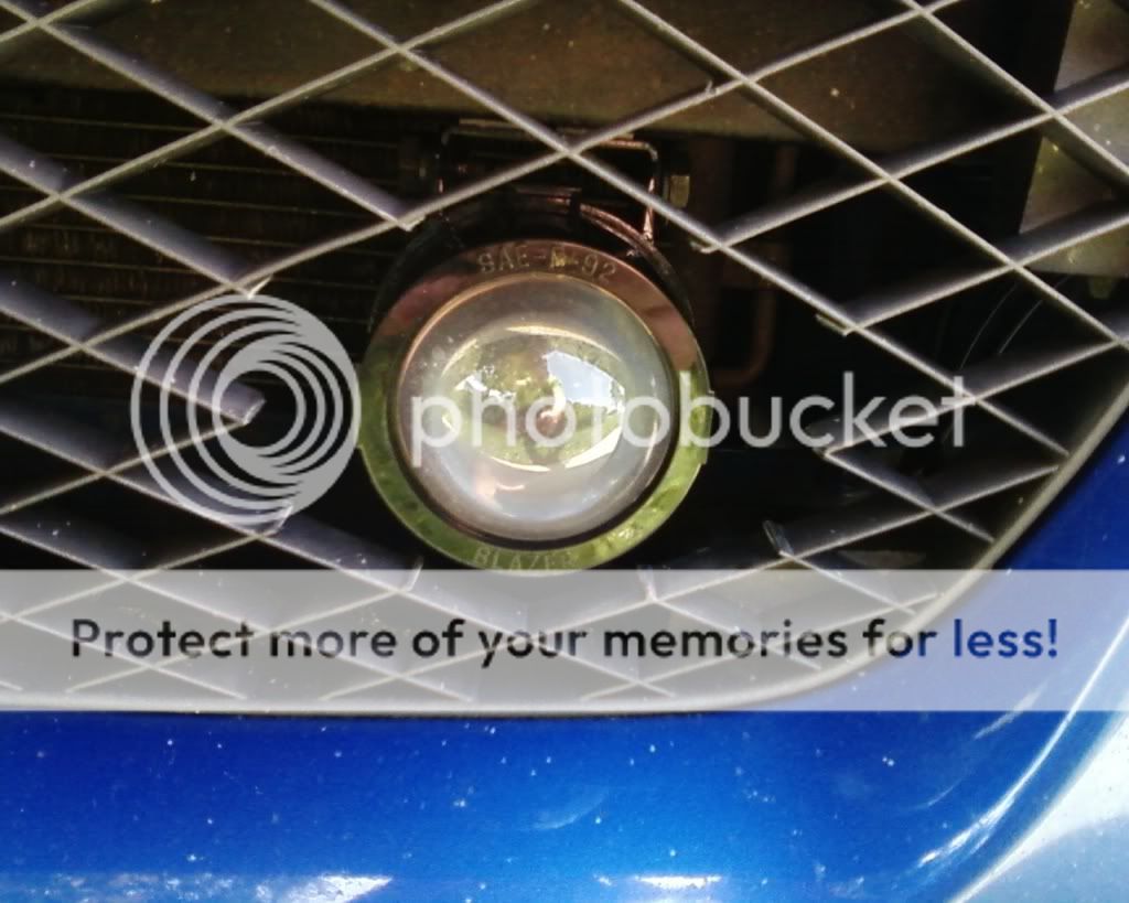

I mounted em to the subframe and it isn't even, so they kinda "V" into the center. It's A LOT worse on Callie's.
Still trying to figure how to fix it. How'd you mount yours? I Just used automotive trim tape and they hold great.
I might double up on the outsides to kinda aim them more horizontal.

here's how mine are mounted
and here you can see the V pattern (i know it doesn't look like it in the photo, but, it raises up on either sdie which really annoys me)
and here it is, you can see it shooting up above the low beam cutoff- and yes, the headlights were aimed too low in these pics, they have since been adjusted
interesting. im thinkig of mounting fogs behind the front grill like that, but not cutting out like that. looks good
thats a really good idea Pro5x2, maybe it will get rid of my x style cutoff lol and plus they wont stick out as much as they do now from being on the bumper, so how did you do it just cleaned of the metal and placed some double sided tape on them ???? I love the whole "conceal" type set up looks good behind the stock fog light covers, at least you get a wider beam then i do
they won't fit behind the grille with the HID's sticking out the back of em
As it was, they BARELY made it in like that without sticking through the grille too much
but, i like how they are not beind the grille. I get even light instead of it coming through the honeycomb grille
oh, wait, yours are currently behind the grille? That's exactly why you're getting "X" patterns!
