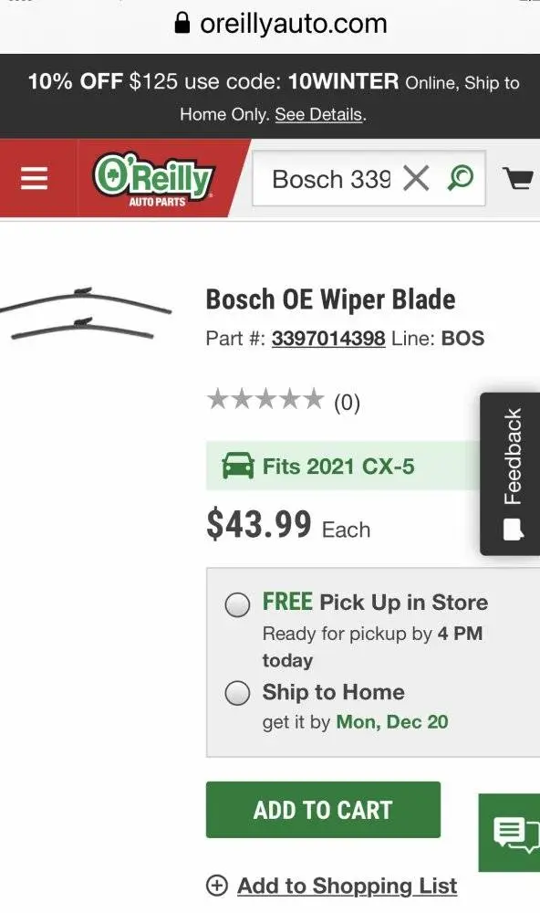

Here’s another proof that https://www.amazon.com (commissions earned)https://www.amazon.com (commissions earned)from Europe does fit 2021 Mazda CX-5 based on O’Reilly website who carries Bosch “OE” Wiper Blades with the same Bosch part number.

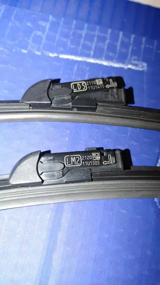

Anybody recognize these?:
It’s Mazda‘s proprietary wiper hook used on gen-2 CX-5.
Great, thank you. I know that's the Mazda shape, but wasn't sure if they were the OEM parts. Glad you could confirm. So I can get back to stock with some replacement rubber.
