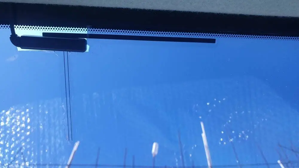

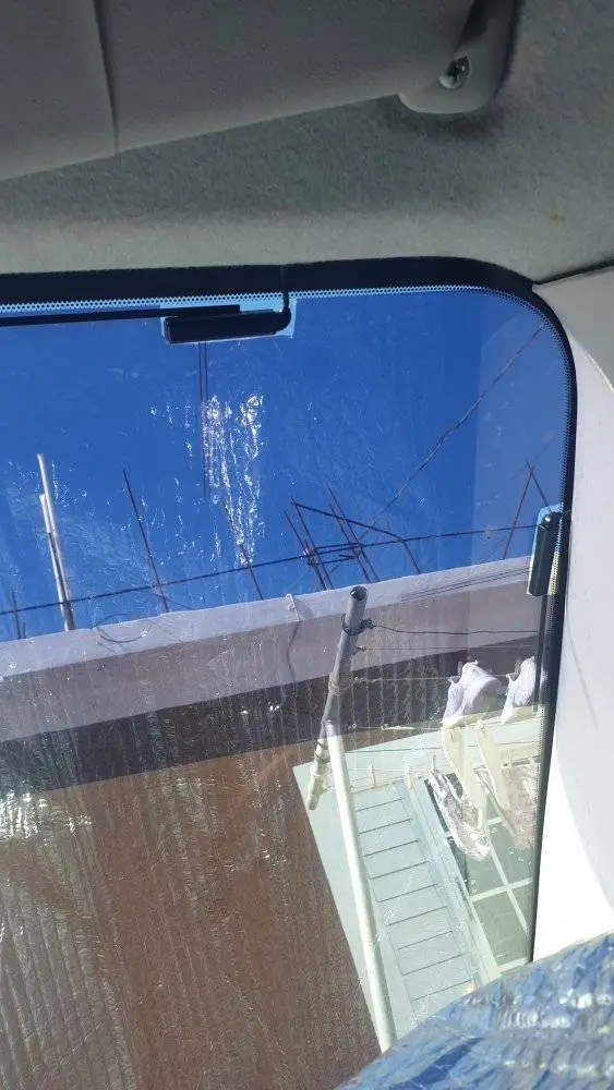

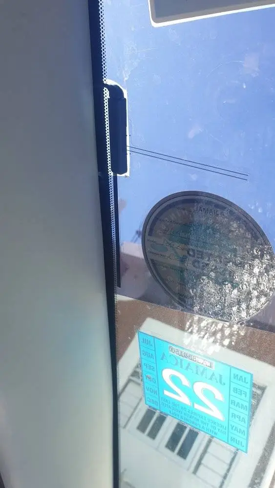

Does anybody know what these are for on the windscreen. I'm gonna get a windscreen replacement but I don't know if these are Sensors or not.

It can be associated with either a heating element, or a signal antenna of some sort. Being that you are in Jamaica, I'd presume it's the latter. It seems aftermarket to me. So, whomever is going to replace your windscreen, what ever it is now will probably be removed. Is there a tint film on your windscreen? It seems to cover the whole thing.
It can be associated with either a temperature element, or a signal antenna of some sort. Being that you are in Jamaica, I'd presume it's the latter. It seems aftermarket to me. So, whomever is going to replace your windscreen, what ever it is now will probably be removed. Is there a tint film on your windscreen? It seems to cover the whole thing.
Ohhh okay. That's how I got it when i bought the the vehicle from Japan, but I couldn't figure what it was for... yeah the top part of the windscreen is tinted but it's tinted around them.
Do you have an external radio antenna? I'm thinking someone deleted it and added this kind of thing.
Oh. Yes I have an Atenta at the back... However the Infotainment centre has a TV option on it. So do you think it could be antennas to Pick up TV stations ?
Good chance of it. What infotainment center do you have? Google it and I bet you will see those antennas in the installation package for it.
It's actually for the Infotainment center. Thank you 🙌🏾. I don't use the TV in the car so i won't replace them when I replace the windscreen. Thanks again.
