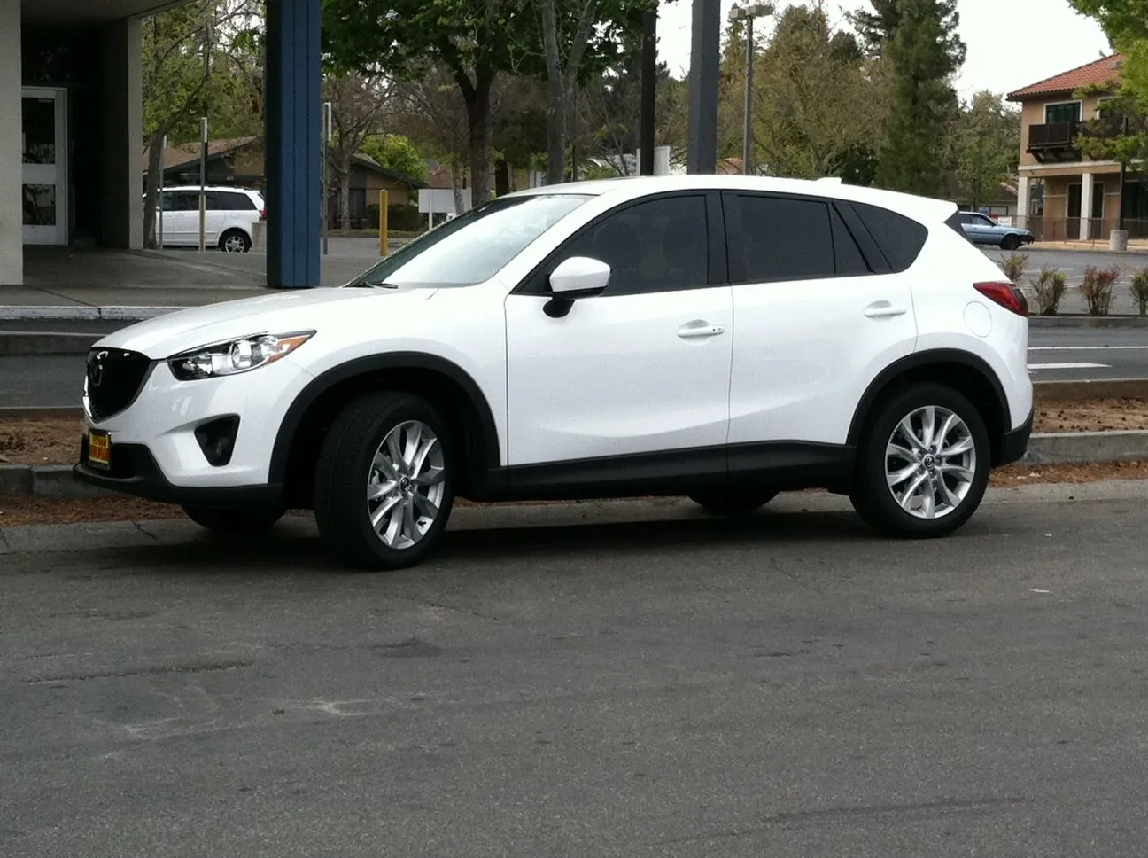

CX-5 side.webp^ Looks good, very OEM-like on rears.
I have 35% on fronts, and the factory rear tint is near 20%
