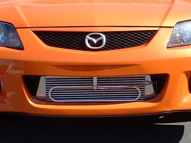

I have this intercooler in my car and didn't have to cut much. 2 inches into the front crossmember and about 20 inches long accross the crossmember. The intercooler fit perfectly into the bumper. Welded some bracket to the crossmember and it is mounted solid. I will be selling a smaller version of it in my turbo kits, comming next month.
Very nice setup. The Cryo is overkill but ever bit helps!!
Thanks! That Nitrous ring is the difference between winning or losing to a 5.0. It gives about forty more HP's. I fill the bottle a least twice a week. You intercooler look killer in your car!!

Thanks for the props. I wanted to keep it behind the screen to keep the car as stock looking as possible...
