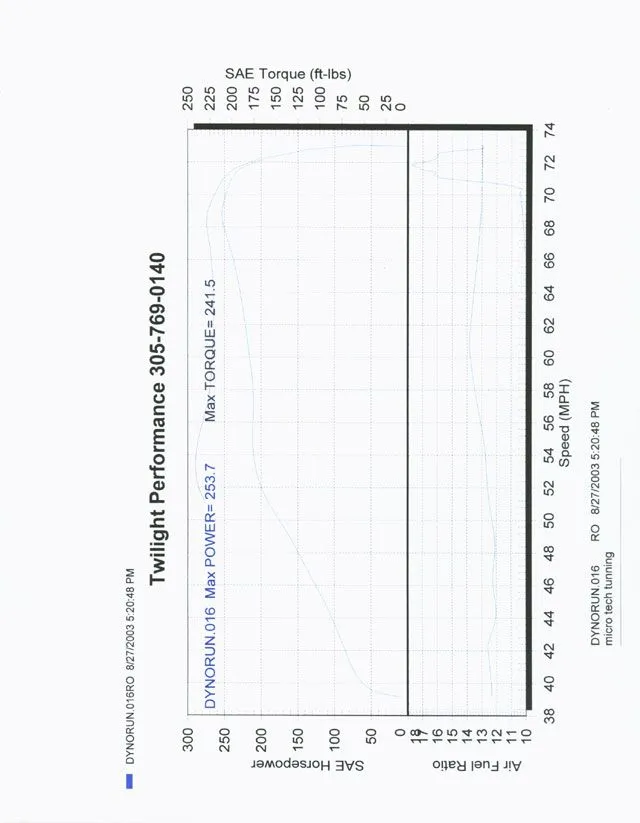

What about Terry's 253 whp with the Microtech system, and the only problem he had was a slipping clutch that hurt the numbers.

Here's that dyno from the Microtech for reference... posted by Terry back in 2003. 253 whp at 13 psi (one of the best numbers at 13 psi that I know of) with a slipping clutch.

p.s. 253whp @13psi is awesome man. I'd like to see more microtech info.
