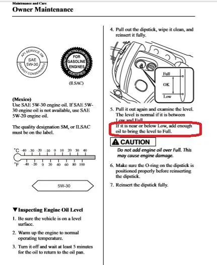

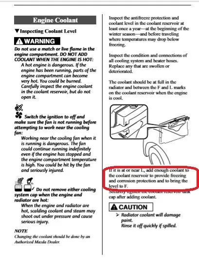

Then why our owner's manual always says adding enough oil / coolant "to bring the level to Full"? ;)

You always manage to leave enough out to make yourself look right. The few words before that line for engine oil are "if it is near or below low". Incidentally, while you're reciting the owner's manual, do you see what it says after the big caution warning right after that for the engine oil? Do not add engine oil over full. This may cause engine damage.
Where did I say we want overfill the oil? (uhm) Is this because of this post of yours?
