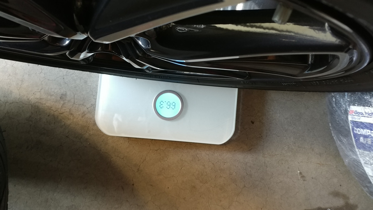

My OEM's pizzas with factory Toyos (with 900 miles on them) weighed 66.3 pounds. My 20" TSW Sprints with BFG 245/45 gForce Comp 2 tires weigh 59.4 pounds.
OE Toyo A36 tire weights 29 lbs. So the OE 19" pizza wheel should be ~37 lbs?
Sounds about right. The OEM 20" rims on the CX-9 weigh 39.5 lbs each. I replaced them with 22" rims that weigh 36 lbs each.

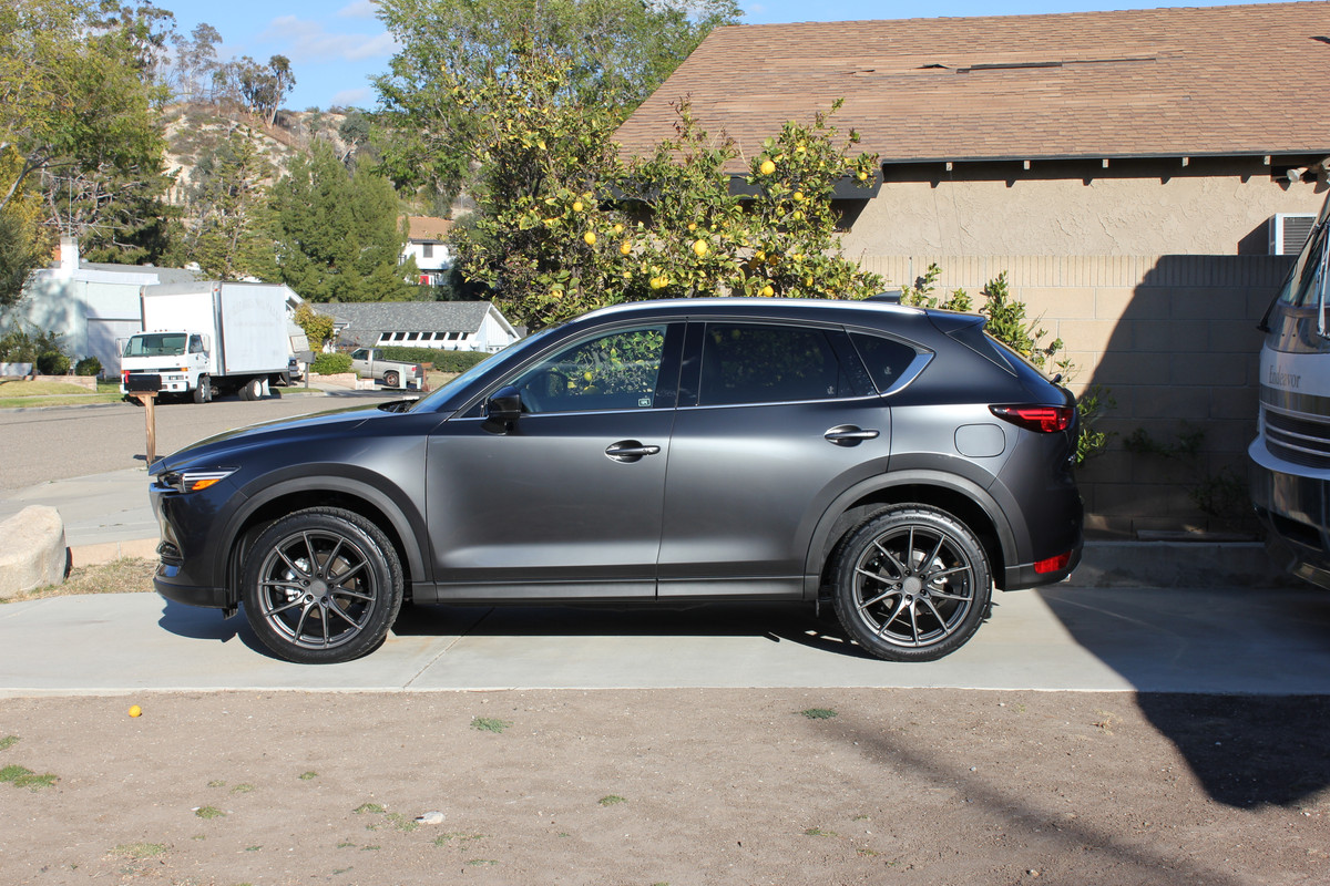

I'm not sure how much my 20's weigh but I definitely feel a difference compared to stock pizza wheels and tires. I'm currently on 20X9 wheels with 235/45r20 tires which overall diameter is a tad smaller than the stock 225/55r19. Car feels lighter on its feet and mpg is pretty much same or a tad better than when I had stock wheels. I never had the chance to compare and measure actual weight between both tho :/
100% agree...ours is definitely more responsive with the lighter wheel/tire combo. Handles much better as well.

Dont have the 19s but I am curious as well. I weighed the stock 2019 OEM 17s with tires and they were 49lbs.
I added 20 inch asanti ABL-13 with 255/45/20 tires and they weighed in at 59 lbs.
So far MPG hasnt changed much at all. Just finishing my second tank and its still roughly the same.
