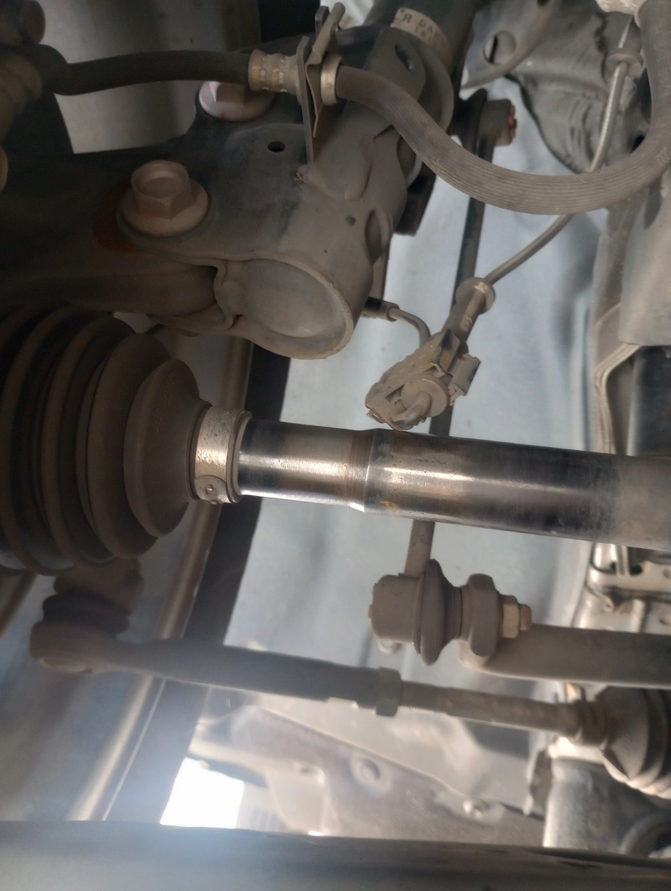

Was under my wife's 2019 CX-5 taking off the splash shield to drain and fill the tranny when I saw this. Is this the wires to the Wheel Position Sensor and where does this thing mount? I'm pretty sure it isn't supposed to hang and polish the axle shaft!

Protruding tabs should snap into a (square/rectangular) hole in a "bracket " portion of the strut. Check the other side for reference assuming it too hasn't detached. My driver side one kept detaching years ago so I just zip tied them to something adjacent( some kind of "bumper thing" ? --- can't remember).

Does detached Wheel Position Sensor manifest itself in any way? Isn't it part of ABS, should it light up something on the dash?
