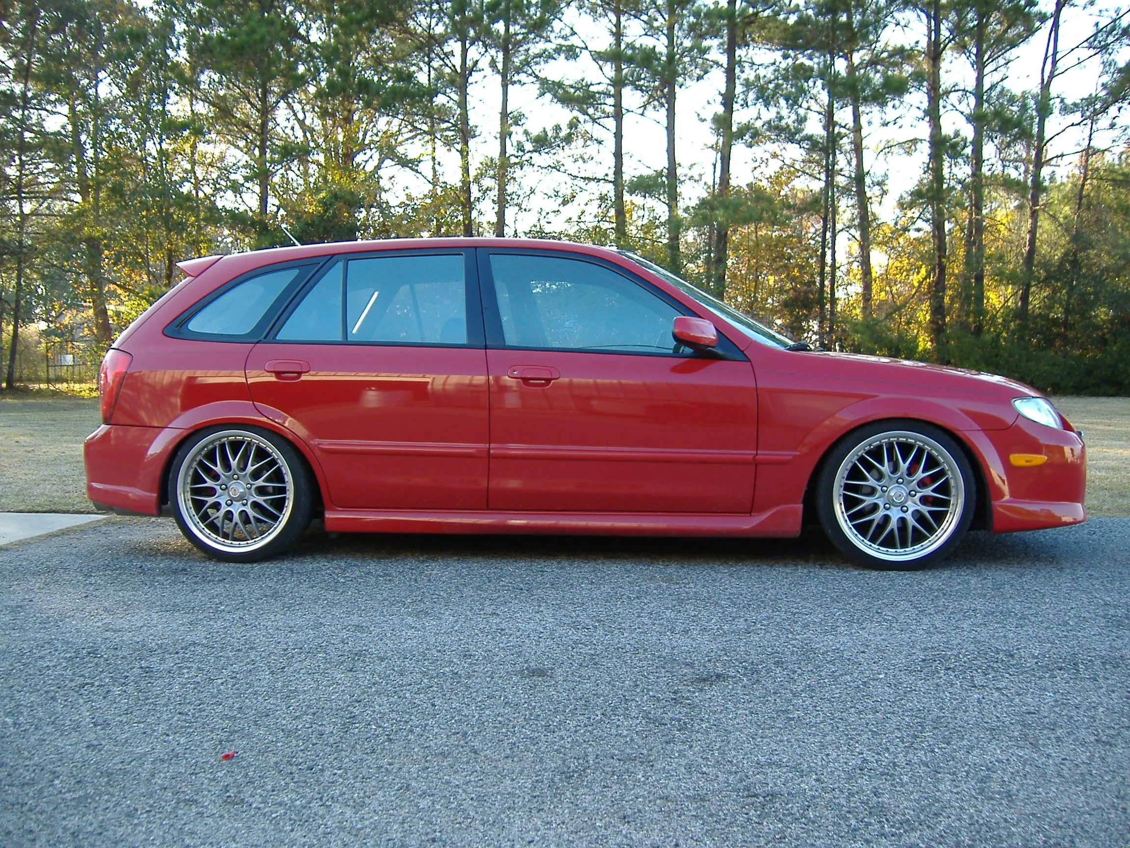

18x7.5 50mm offset w/ 215/35/18 on my P5 Just clear perfectly. You can get your fenders rolled or take your wheels off and machine off that extra .080" from the backside. I know it doesn't sound like much but it is enough. Verify that you have enough clearance from the back of the wheel to the strut first.
