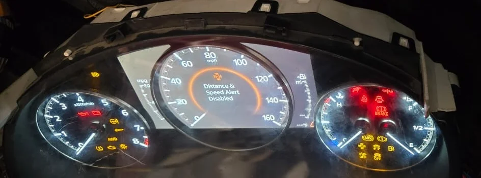

the key can unlock the car and there are lights in other areas of the car like the radio the ac the roof. The car won't even crank. We bypassed the bcm just to see if the dash light will come on and it did with all the lights on the dash on
the ignition isn't showing on the dash.

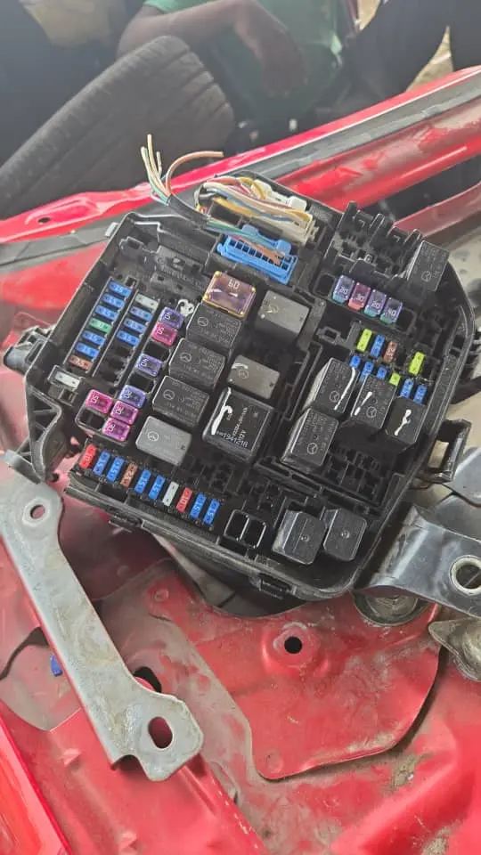

Attached is the shattered fuse box replacement

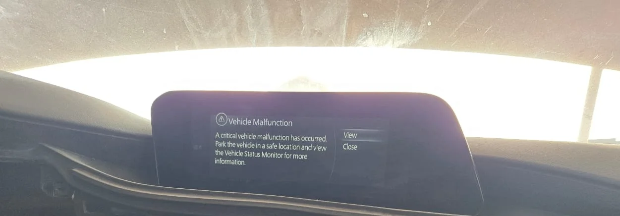

basically all the lights in the car is on apart from the dash light only blinking the security indicator light. just to check if the dash is faulty the mechanice bypassed it from the bcm and all the light with the error code came on but as you know the car wouldn't start that way

one picture shows how scattered the fusebox came and the second shows us rearranging it and putting it all together
What was rearranged in the fuse box? If it was shattered, you should replace it. Many things can go wrong! Right now you are chasing the unknown.
I'd recommend you replace the entire fuse box, if it was hit, go through the wiring diagram and make sure all wires are correctly connected.
Thanks the entire fusebox has now been replaced and rearranged. the technician keeps saying he things the bcm is faulty. i don't believe that at all. i believe this is a minor issue tho. he is now able to scan the car but the only thing he gets is that it can't communicate with ECU or BCM. i think this car needs to somewhat be reprogrammed due to the collision it had. the BCM isn't corroded, the rusty metal is as a result of it's location in the car

Here are a few images of what it is so far
I believe the mazda software will point us to the right direction
however the bcm isn't corroded just the bracket
